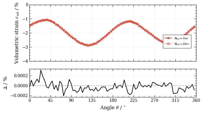

Compare the volume strains obtained with and without the B-bar method
The figure below shows that the B-bar method improves the strain result significantly.
def inner_mesh(filename: str) -> pv.UnstructuredGrid:(click to toggle)
    "Return submesh inside a radius of 0.065."
    mesh = ot.MeshSeries(Path(out_dir, filename))[-1]
    radii = np.asarray([np.linalg.norm(cell.center) for cell in mesh.cell])
    return mesh.extract_cells(radii < 0.065)
plt.rcParams.update(
        "font.family": "serif",
        "font.size": 12,
        "axes.labelsize": 12,
        "axes.titlesize": 14,
        "legend.fontsize": 8,
        "xtick.labelsize": 10,
        "ytick.labelsize": 10,
        "lines.linewidth": 1.5,
        "axes.linewidth": 0.8,
        "grid.linewidth": 0.4,
        "savefig.dpi": 600,
        "mathtext.fontset": "stix",
def sorted_angles_eps_trace(filename: str) -> tuple[np.ndarray, np.ndarray]:
    edge = inner_mesh(filename).extract_feature_edges()
    eps_trace = ot.variables.strain.trace.transform(edge)
    phi = np.arctan2(edge.points[:, 1], edge.points[:, 0]) * 180 / np.pi
    phi[phi < 0] += 360
    sort_idx = np.argsort(phi)
    return (phi[sort_idx], eps_trace[sort_idx])
fig, (ax, ax_err) = plt.subplots(
    2, 1, figsize=(7.0, 4.0), sharex=True, gridspec_kw={"height_ratios": [2, 1]}
series = {}
colors = {"true": "#c0392b", "false": "#e74c3c"}
for b_bar in ["true", "false"]:
    angles, eps_v = sorted_angles_eps_trace(f"hm_lie_bbar_{b_bar}.pvd")
    linestyle = {"false": "dotted", "true": "solid"}[b_bar]
    ax.plot(
        angles,
        np.array(eps_v) * 100,
        linestyle=linestyle,
        label=rf"$B_{{\mathrm{{bar}}}} = {b_bar}$",
        marker="o" if b_bar == "true" else "s",
        markersize=4,
        markerfacecolor="none",
        markeredgewidth=1.0,
        color=colors[b_bar],
    series[b_bar] = (angles, eps_v)
ax.set_ylabel(r"Volumetric strain $\varepsilon_{\mathrm{vol}}$ / %", labelpad=5)
ax.set_xlim(0, 360)
ax.set_ylim(-4, 0)
ax.set_xticks(np.arange(0, 361, 45))
ax.grid(True, which="major", linestyle=":", linewidth=0.4, alpha=0.7)
ax.legend(
    loc="lower right",
    bbox_to_anchor=(0.98, 0.2),
    frameon=True,
    framealpha=0.95,
    edgecolor="0.3",
    borderpad=0.6,
phi_t, y_t = series["true"]
phi_f, y_f = series["false"]
if not np.array_equal(phi_t, phi_f):
    y_f = np.interp(phi_t, phi_f, y_f)
err = y_t - y_f
ax_err.plot(phi_t, err, color="k")
ax_err.axhline(0, linestyle="--", linewidth=0.8, color="gray")
ax_err.set_xlabel(r"Angle $\theta$ / $^\circ$", labelpad=5)
ax_err.set_ylabel(r"$\Delta$ / %", labelpad=5)
ax_err.grid(True, which="major", linestyle=":", linewidth=0.4, alpha=0.7)
ax.minorticks_on()
ax.tick_params(which="minor", length=3, width=0.6)
ax.tick_params(which="major", length=5, width=0.8)
ax.tick_params(axis="both", which="both", direction="in", top=True, right=True)
ax_err.minorticks_on()
ax_err.tick_params(which="minor", length=3, width=0.6)
ax_err.tick_params(which="major", length=5, width=0.8)
ax_err.tick_params(axis="both", which="both", direction="in", top=True, right=True)
plt.tight_layout()
plt.savefig(
    out_dir / "hm_lie_bbar_comparison.pdf",
    dpi=600,
    bbox_inches="tight",
    pad_inches=0.05,
plt.close()

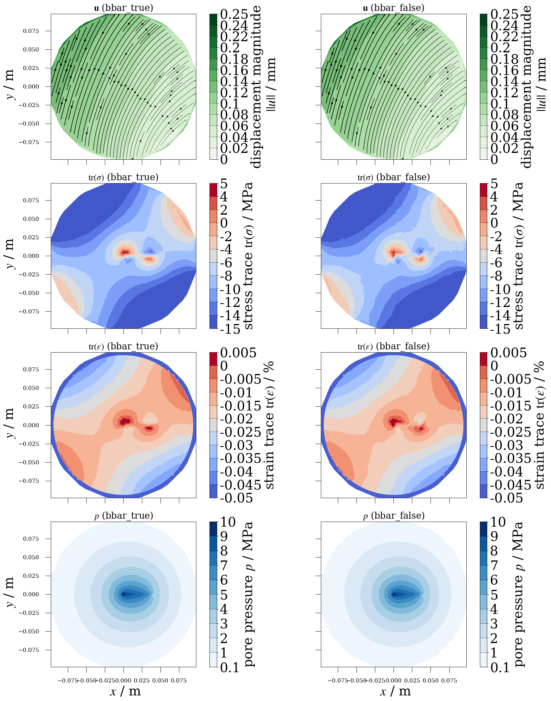

Results over the entire domain
def plot_mesh_compare((click to toggle)
    file_true: Path,
    file_false: Path,
    colorbar_opts: dict,
    save_file: Path | None = None,
    domain_limit: float = 0.098,
    mesh_true = ot.MeshSeries(file_true)[-1]
    mesh_false = ot.MeshSeries(file_false)[-1]
    has_p_true = "pressure" in mesh_true.point_data
    has_p_false = "pressure" in mesh_false.point_data
    include_pressure = has_p_true and has_p_false
    rows = [
            "$\\mathbf{u}$",
            ot.variables.displacement.replace(output_unit="mm"),
            "u",
        ("$\\mathrm{tr}(\\sigma)$", ot.variables.stress.trace, "stress"),
        ("$\\mathrm{tr}(\\varepsilon)$", ot.variables.strain.trace, "strain"),
    if include_pressure:
        rows.append(("$p$", ot.variables.pressure, "pressure"))
    nrows = len(rows)
    ncols = 2
    figsize = (10 * ncols, 6 * nrows)
    fig, axs = plt.subplots(
        nrows=nrows, ncols=ncols, figsize=figsize, sharex=True, sharey=True
    if nrows == 1:
        axs = np.array([axs])
    for i, (title, var, key) in enumerate(rows):
        ot.plot.contourf(mesh_true, var, fig, axs[i, 0], **colorbar_opts[key])
        axs[i, 0].set_title(f"{title} (bbar_true)", fontsize=22)
        ot.plot.contourf(mesh_false, var, fig, axs[i, 1], **colorbar_opts[key])
        axs[i, 1].set_title(f"{title} (bbar_false)", fontsize=22)
    for ax in axs.ravel():
        ax.set_aspect("equal")
        ax.tick_params(labelsize=14)
        ax.set_xlim(-domain_limit, domain_limit)
        ax.set_ylim(-domain_limit, domain_limit)
    if save_file:
        Path(save_file).parent.mkdir(parents=True, exist_ok=True)
        fig.savefig(save_file, dpi=300, bbox_inches="tight")
    plt.close(fig)
colorbar_opts = {
    "u": {"vmin": 0, "vmax": 0.25},
    "stress": {"vmin": -15, "vmax": 5},
    "strain": {"vmin": -0.05, "vmax": 0.005},
    "pressure": {"vmin": 0.1, "vmax": 10},
plot_mesh_compare(
    file_true=Path(out_dir, "hm_lie_bbar_true.pvd"),
    file_false=Path(out_dir, "hm_lie_bbar_false.pvd"),
    colorbar_opts=colorbar_opts,
    save_file=Path(out_dir, "compare_bbar.png"),
