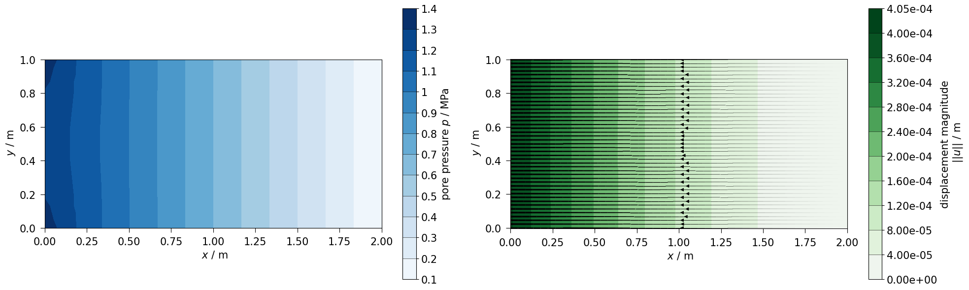

The distributions of pressure and displacement at the end time are shown in the following figure:
# Plotting…
(click to toggle)
# Plotting
mesh = ot.MeshSeries(out_dir / "HM_NodalSourceTem.pvd").mesh(20)
fig, (ax1, ax2) = plt.subplots(1, 2, figsize=(20, 6))
ot.plot.contourf(
mesh,
ot.variables.pressure.replace(data_name="pressure_interpolated"),
fig=fig,
ax=ax1,
fontsize=15,
ot.plot.contourf(mesh, ot.variables.displacement, fig=fig, ax=ax2, fontsize=15)
plt.subplots_adjust(wspace=0.3) # increase horizontal space
plt.tight_layout()
