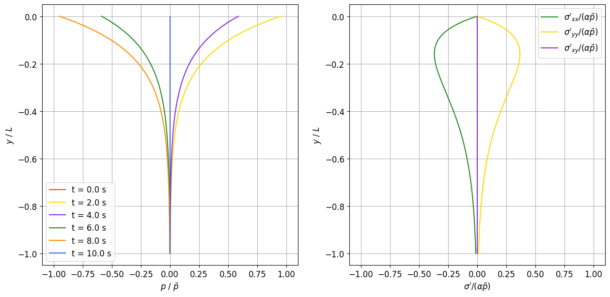

By evaluating these equations at different times $t$ and depths $y$, we gain a better understanding of the pressure and stress distribution in the seabed. The below plot illustrates the pore pressure and the amplitude of the effective stresses as a function of depth directly underneath an anti-node of the standing water wave (the place where the amplitude is at maximum, i.e. for $x = k \cdot \frac{L}{2}$, where $k=0, 1, 2,$ …).
Along the top edge of the seabed, the pore pressure is always as large as the applied load and the effective stresses are zero. This means, that all the change in pressure is absorbed by the fluid while the soil particles remain in their initial stress state (in this case zero, since body forces are being disregarded). The increased pore pressure at the top edge cannot propagate freely downwards into the seabed because seepage is limited by the hydraulic conductivity of the soil. Consequently, the pore pressure decreases with depth as the soil matrix gradually takes up the remaining share of the total stress in the seabed.
y = np.linspace(0, 100, 1000)(click to toggle)
y_rel = y / 100
colors = {
    0: "orangered",
    2: "gold",
    4: "blueviolet",
    6: "forestgreen",
    8: "darkorange",
    10: "royalblue",
fig, ax = plt.subplots(ncols=2, figsize=(15, 7))
for idx in (0, 1):
    ax[idx].grid(True)
    ax[idx].set_ylabel("$y$ / $L$")
    ax[idx].set_xlim(-1.1, 1.1)
for t in [0, 2, 4, 6, 8, 10]:
    ax[0].plot(
        compute_pressure_and_stresses(t, 0, y)[0],
        -y_rel,
        color=colors[t],
        label=f"t = {t:.1f} s",
t = 2.5
ax[0].set_xlabel("$p$ / $\\tilde{p}$")
ax[0].legend()
ax[1].plot(
    compute_pressure_and_stresses(t, 0, y)[1],
    -y_rel,
    color=colors[6],
    label=r"$\sigma'_{xx}/(\alpha\tilde{p})$",
# ax[1].plot(compute_pressure_and_stresses(t,0,y)[1]+compute_pressure_and_stresses(t,0,y)[0], -y_rel, linestyle = "--", color = colors[3], label = "$\\sigma_{xx}$/$\\alpha\\tilde{p}$")  # Total horizontal stress
ax[1].plot(
    compute_pressure_and_stresses(t, 0, y)[2],
    -y_rel,
    color=colors[2],
    label=r"$\sigma'_{yy}/(\alpha\tilde{p})$",
# ax[1].plot(compute_pressure_and_stresses(t,0,y)[2]+compute_pressure_and_stresses(t,0,y)[0], -y_rel, linestyle = "--", color = colors[1], label = "$\\sigma_{yy}$/$\\alpha\\tilde{p}$")  # Total vertical stress
ax[1].plot(
    compute_pressure_and_stresses(t, 0, y)[3],
    -y_rel,
    color=colors[4],
    label=r"$\sigma'_{xy}/(\alpha\tilde{p})$",
ax[1].set_xlabel(r"$\sigma'/(\alpha\tilde{p})$")
ax[1].legend()
<matplotlib.legend.Legend at 0x7fa41b999d30>

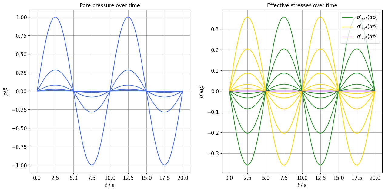

The following plot illustrates the pore pressure and the effective stresses at different depths underneath an anti-node over time. Here it becomes clear that the vertical and the horizontal effective stresses behave symmetrically in space as well as time.
t = np.linspace(0, 20, 200)(click to toggle)
colors = {1: "gold", 2: "blueviolet", 3: "forestgreen", 4: "royalblue"}
for idx in (0, 1):
    ax[idx].grid(True)
    ax[idx].set_xlabel("$t$ / s")
for y in np.linspace(0, 100, 6):
    ax[0].plot(t, compute_pressure_and_stresses(t, 0, y)[0], color=colors[4])
    ax[0].set_ylabel("$p/\\tilde{p}$")
    ax[1].plot(
        t,
        color=colors[3],
    ax[1].plot(
        t,
        color=colors[1],
    ax[1].plot(
        t,
        color=colors[2],
    if y == 0:
ax[1].set_ylabel("$\\sigma$'/$\\alpha\\tilde{p}$")
ax[0].set_title("Pore pressure over time")
ax[1].set_title("Effective stresses over time")
Text(0.5, 1.0, 'Effective stresses over time')

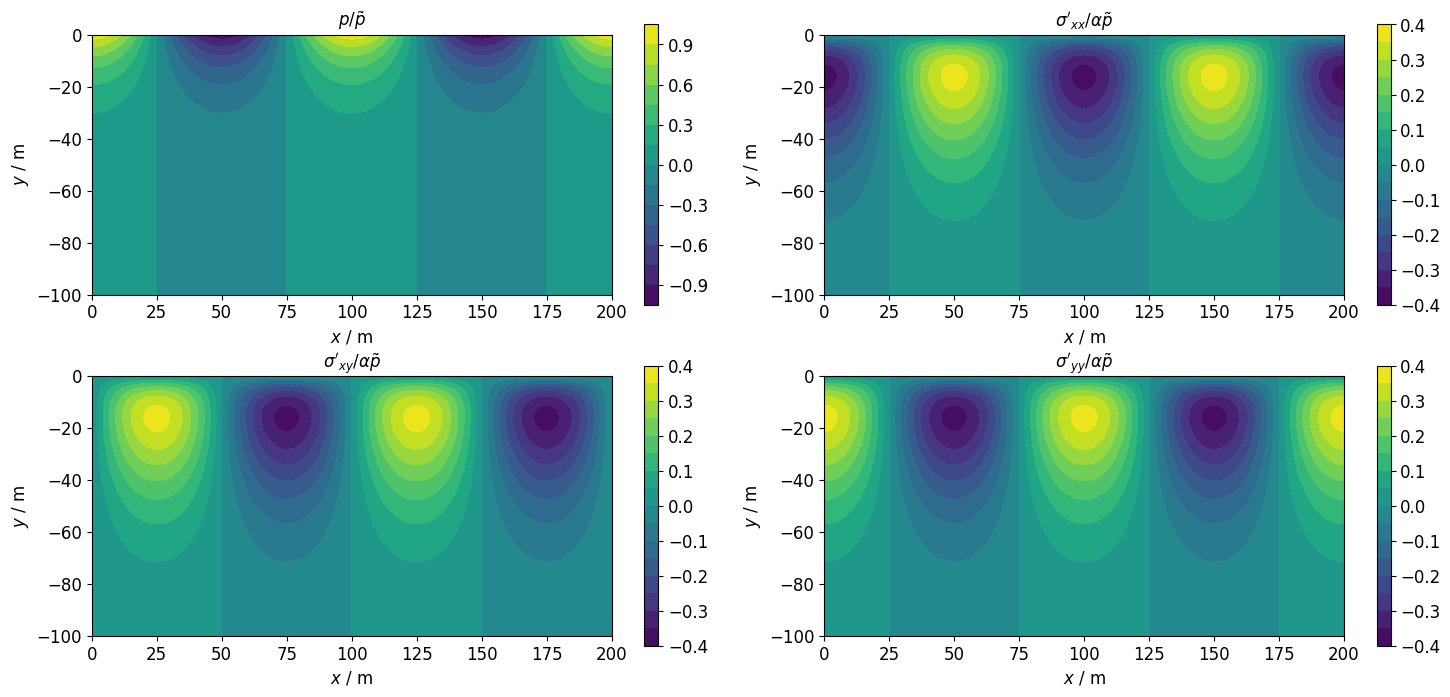

For a better understanding of the planar pressure and stress distribution, the following 2D color-plots are helpful. Each of the diagramms illustrates the pressure or stress distribution at a timepoint, where the applied load is at maximum.
x, y = np.meshgrid(np.linspace(0, 200, 1000), np.linspace(0, 100, 1000))(click to toggle)
t = 2.5
fig, ax = plt.subplots(ncols=2, nrows=2, figsize=(15, 7))
l1 = ax[0][0].contourf(x, -y, compute_pressure_and_stresses(t, x, y)[0], 15)
l2 = ax[0][1].contourf(x, -y, compute_pressure_and_stresses(t, x, y)[1], 15)
l3 = ax[1][1].contourf(x, -y, compute_pressure_and_stresses(t, x, y)[2], 15)
l4 = ax[1][0].contourf(x, -y, compute_pressure_and_stresses(t, x, y)[3], 15)
fig.colorbar(l1, ax=ax[0][0])
fig.colorbar(l2, ax=ax[0][1])
fig.colorbar(l3, ax=ax[1][1])
fig.colorbar(l4, ax=ax[1][0])
for i in (0, 1):
    for j in (0, 1):
        ax[i][j].set_aspect("equal")
        ax[i][j].set_xlabel("$x$ / m")
        ax[i][j].set_ylabel("$y$ / m")
ax[0][0].set_title("$p/\\tilde{p}$")
ax[0][1].set_title("$\\sigma'_{xx}/\\alpha\\tilde{p}$")
ax[1][1].set_title("$\\sigma'_{yy}/\\alpha\\tilde{p}$")
ax[1][0].set_title("$\\sigma'_{xy}/\\alpha\\tilde{p}$")

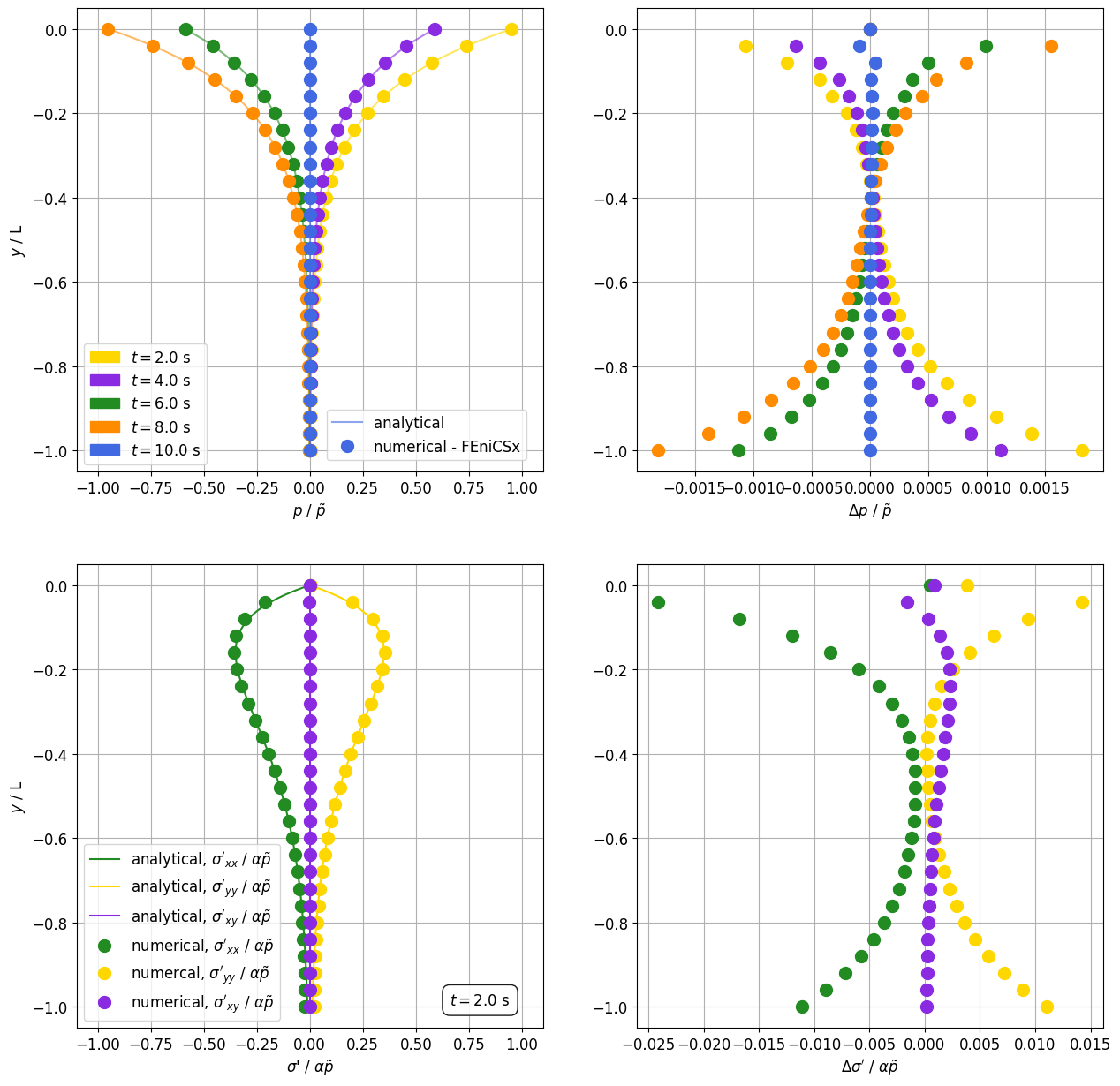

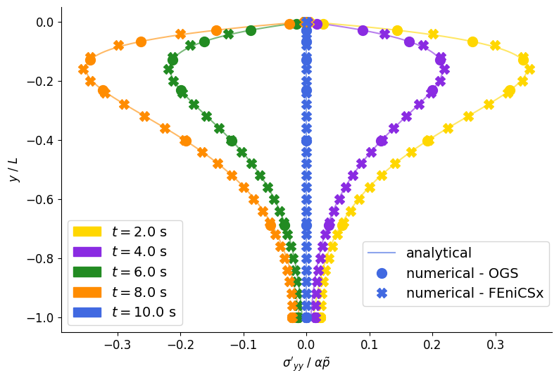

Numerical solution
In the following section, the behavior of the seabed under the influence of standing water waves is solved numerically by FEM in OpenGeoSys. The principle of Finite Element Methods is to subdivide a large and complex object into smaller parts (called finite elements), which is achieved by the construction of a mesh of the object. For each of the meshes’ nodes, an approximation of the real solution is calculated. Therefore, numerical solutions always contain errors that originate in the so-called space discretization. The finer the resolution of a mesh, the more accurately the approximation matches the real solution. However, a large number of elements and nodes also causes longer calculation times. A description of the meshing process for this specific example follows below.
For transient problems, a time discretization must also be carried out in addition to the space discretization. In doing so, the observed time period is divided into finite time steps. Here too, smaller timesteps come along with more accurate results but longer calculation times. For the numerical simulation of the seabed, a timestep of $\Delta t = 0.25$ s was chosen. With a periodic time of the water wave of $T=10$ s, there are $40$ timesteps per period. The number of timesteps per period should be large enough to enable an accurate representation of the wave’s sinusoidal shape.

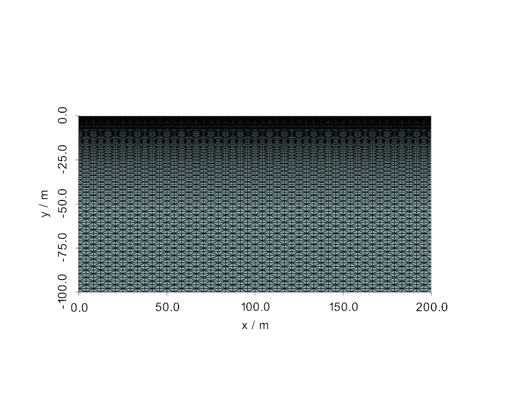

Meshing
Since the problem can be simplified to a planar geometry, a two-dimensional mesh is constructed for the numerical solution. Here, the Gmsh application programming interface (API) for python is used to generate a structured mesh of rectangular shape. This allows a parametric input of the geometry’s dimensions and the mesh refinement. The generated mesh consists of quadratic elements, which have mid-side-nodes. In that way, displacements between nodes at the vertices can be interpolated using a higher order polynomial.
For the further use in OpenGeoSys, the gmsh-mesh is converted to the vtu-format.
def generate_mesh_axb(a, b, Nx, Ny, P):(click to toggle)
    output_file = f"{out_dir}/square_{a}x{b}.msh"
    lc = 0.5
    # Before using any functions in the Python API, Gmsh must be initialized:
    gmsh.initialize()
    gmsh.model.add("rectangle")
    # Dimensions
    dim1 = 1
    dim2 = 2
    # Outer points (ccw)
    gmsh.model.geo.addPoint(0, -b, 0, lc, 1)
    gmsh.model.geo.addPoint(a, -b, 0, lc, 2)
    gmsh.model.geo.addPoint(a, -b / 2, 0, lc, 3)
    gmsh.model.geo.addPoint(a, 0, 0, lc, 4)
    gmsh.model.geo.addPoint(0, 0, 0, lc, 5)
    gmsh.model.geo.addPoint(0, -b / 2, 0, lc, 6)
    # Outer lines (ccw)
    gmsh.model.geo.addLine(4, 5, 4)
    gmsh.model.geo.addLine(6, 1, 6)
    gmsh.model.geo.addLine(6, 3, 7)
    # The third elementary entity is the surface. In order to define a surface
    # from the curves defined above, a curve loop has first to be defined (ccw).
    gmsh.model.geo.addCurveLoop([1, 2, -7, 6], 1)
    gmsh.model.geo.addCurveLoop([7, 3, 4, 5], 2)
    gmsh.model.geo.addPlaneSurface([1], 1)
    gmsh.model.geo.synchronize()
    #  Prepare structured grid
    gmsh.model.geo.mesh.setTransfiniteCurve(1, Nx)
    gmsh.model.geo.mesh.setTransfiniteCurve(2, int(Ny * 0.3))
    gmsh.model.geo.mesh.setTransfiniteCurve(3, Ny, "Progression", -P)
    gmsh.model.geo.mesh.setTransfiniteCurve(4, Nx)
    gmsh.model.geo.mesh.setTransfiniteCurve(5, Ny, "Progression", P)
    gmsh.model.geo.mesh.setTransfiniteCurve(6, int(Ny * 0.3))
    gmsh.model.geo.mesh.setTransfiniteCurve(7, Nx)
    gmsh.model.geo.mesh.setTransfiniteSurface(1, "Alternate")
    # Physical groups (only this gets saved to file per default)
    Right = gmsh.model.addPhysicalGroup(dim1, [2, 3])
    Top = gmsh.model.addPhysicalGroup(dim1, [4])
    Left = gmsh.model.addPhysicalGroup(dim1, [5, 6])
    Plate = gmsh.model.addPhysicalGroup(dim2, [1, 2])
    gmsh.model.setPhysicalName(dim2, Plate, "Plate")
    # gmsh.option.setNumber('Mesh.SecondOrderIncomplete', 1)   # serendipity elements
    gmsh.model.mesh.setOrder(2)  # higher order elements (quadratic)
    gmsh.write(output_file)
    gmsh.finalize()
generate_mesh_axb(200, 100, 25, 45, 1.07)

The below figure shows the generated mesh with a width of $a=2L=200$ m and a height (or rather depth) of $b=L=100$ m.
Note: the origin of coordinates is located at ground level, therefore y-coordinates are negative
As was already visible in the analytical solution, the pressure and stress gradients are particularly high in the upper half of the geometry. Therefore, it makes sense to refine the mesh in this area.
mesh = pv.read(f"{out_dir}/square_200x100_domain.vtu")(click to toggle)
plotter = pv.Plotter(window_size=[1000, 800])
plotter.show_bounds(ticks="outside", xlabel="x / m", ylabel="y / m")
plotter.view_xy()
plotter.show()

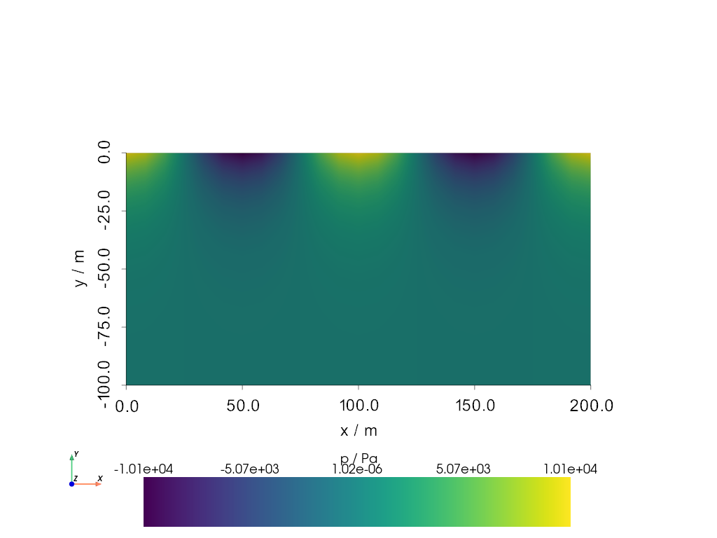

The below plot illustrates the pore pressure distribution in the domain at a timepoint where the applied load is at maximum. By comparing this plot to the 2D-colorplots of the analytical solution, it can already be concluded that the numerical solution resembles the analytical solution.
time = 2.5 # [s](click to toggle)
time = 2.5  # [s]
reader = pv.get_reader(f"{out_dir}/square_200x100.pvd")
reader.set_active_time_point(int(time * 4))
mesh = reader.read()[0]
plotter = pv.Plotter()
sargs = dict(title="p / Pa", height=0.25, position_x=0.2, position_y=0.02)  # noqa: C408
plotter.add_mesh(
    mesh,
    scalars="pressure_interpolated",
    show_edges=False,
    show_scalar_bar=True,
    label="p",
    scalar_bar_args=sargs,
plotter.add_axes()
plotter.view_xy()
plotter.show()

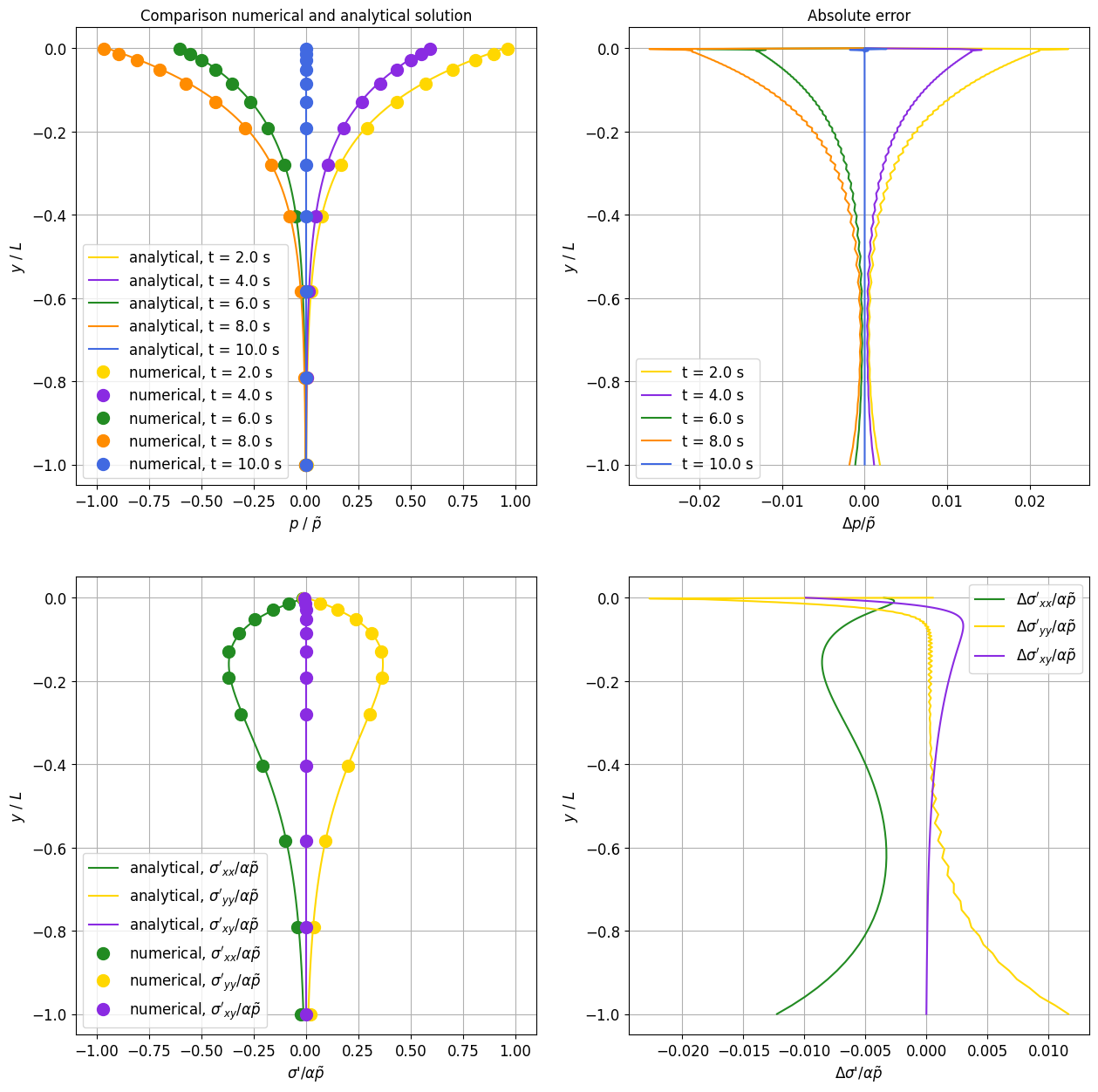

For a more detailed comparison between the analytical and the numerical solution, both solutions are evaluated along the vertical line directly underneath an anti-node of the standing wave. As before, the pore pressure and the amplitude of the effective stresses are illustrated as a function of depth. The results of the numerical solution are marked as dots in the same color as the analytical solution. Additionally, the absolute errors $\Delta p = p_{numerical}-p_{analtical}$ and $\Delta \sigma_{i}' = \sigma_{i, numerical}'-\sigma_{i, analytical}'$ are illustrated on the right.
The plot shows that the absolute errors are very small at about $2 \%$ of the wave’s amplitude. They can mostly be ascribed to the space- and time-discretization. Close to the top boundary of the domain, larger errors occur. These errors could originate in the definition of both a pressure and displacement (Neumann-) boundary condition along the top edge.
x = 0(click to toggle)
x = 0
y_rel = y / 100
colors = {
    0: "orangered",
    2: "gold",
    4: "blueviolet",
    6: "forestgreen",
    8: "darkorange",
    10: "royalblue",
fig, ax = plt.subplots(ncols=2, nrows=2, figsize=(15, 15))
## Plotting analytical solution
for t in [2, 4, 6, 8, 10]:
    ax[0][0].plot(
        -y_rel,
        color=colors[t],
        label=f"analytical, t = {t:.1f} s",
ax[1][0].plot(
    compute_pressure_and_stresses(2.5, x, y)[1],
    -y_rel,
    color=colors[6],
    label="analytical, $\\sigma'_{xx}/\\alpha\\tilde{p}$",
ax[1][0].plot(
    compute_pressure_and_stresses(2.5, x, y)[2],
    -y_rel,
    color=colors[2],
    label="analytical, $\\sigma'_{yy}/\\alpha\\tilde{p}$",
ax[1][0].plot(
    compute_pressure_and_stresses(2.5, x, y)[3],
    -y_rel,
    color=colors[4],
    label="analytical, $\\sigma'_{xy}/\\alpha\\tilde{p}$",
## Plotting numerical solution
p1 = (x + 1e-6, 0, 0)
p2 = (x + 1e-6, -100, 0)
for t_num in (2, 2.5, 4, 6, 8, 10):
    mesh = read_timestep_mesh(200, t_num)
    line_mesh = slice_along_line(mesh, p1, p2)
    pressure = get_pressure_sorted(line_mesh)
    sigma = get_stresses_sorted(line_mesh)
    depth = get_depth_sorted(line_mesh)
    f_abs_pressure = compute_abs_and_rel_pressure_error(pressure, depth, t_num, x)[0]
    f_abs_sigma = compute_abs_and_rel_stress_error(sigma, depth, t_num, x)[0]
    if t_num != 2.5:
        ax[0][0].plot(
            pressure / 0.1e5,
            depth / 100,
            "o",
            markevery=10,
            color=colors[t_num],
            label=f"numerical, t = {t_num:.1f} s",
        ax[0][0].set_xlabel("$p$ / $\\tilde{p}$")
        ax[0][1].plot(
            f_abs_pressure, depth / 100, color=colors[t_num], label=f"t = {t_num:.1f} s"
        ax[0][1].set_xlabel("$\\Delta p /\\tilde{p}$")
    if t_num == 2.5:
        ax[1][0].plot(
            sigma[0] / 0.1e5,
            depth / 100,
            "o",
            markevery=10,
            color=colors[6],
            label="numerical, $\\sigma'_{xx}/\\alpha\\tilde{p}$",
        ax[1][0].plot(
            sigma[1] / 0.1e5,
            depth / 100,
            "o",
            markevery=10,
            color=colors[2],
            label="numerical, $\\sigma'_{yy}/\\alpha\\tilde{p}$",
        ax[1][0].plot(
            sigma[2] / 0.1e5,
            depth / 100,
            "o",
            markevery=10,
            color=colors[4],
            label="numerical, $\\sigma'_{xy}/\\alpha\\tilde{p}$",
        ax[1][0].set_xlabel("$\\sigma$'/$\\alpha\\tilde{p}$")
        ax[1][1].plot(
            f_abs_sigma[0],
            depth / 100,
            color=colors[6],
            label="$\\Delta\\sigma'_{xx}/\\alpha\\tilde{p}$",
        ax[1][1].plot(
            f_abs_sigma[1],
            depth / 100,
            color=colors[2],
            label="$\\Delta\\sigma'_{yy}/\\alpha\\tilde{p}$",
        ax[1][1].plot(
            f_abs_sigma[2],
            depth / 100,
            color=colors[4],
            label="$\\Delta\\sigma'_{xy}/\\alpha\\tilde{p}$",
        ax[1][1].set_xlabel("$\\Delta\\sigma$'/$\\alpha\\tilde{p}$")
        # ax[1][0].plot(sigma[3]/0.1e5, depth/100, "o", markevery=10, color = colors[4], label = "numerical, $\\sigma'_{zz}/\\alpha\\tilde{p}$")
## layout settings
ax[0][0].set_title("Comparison numerical and analytical solution")
ax[0][1].set_title("Absolute error")
for idx_1 in (0, 1):
    for idx_2 in (0, 1):
        ax[idx_1][idx_2].grid(True)
        ax[idx_1][idx_2].set_ylabel("$y$ / $L$")
        ax[idx_1][0].set_xlim(-1.1, 1.1)
        ax[idx_1][idx_2].legend()

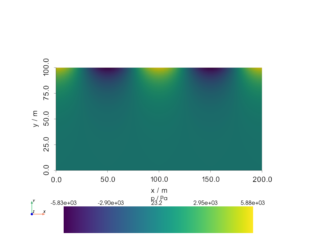

plotter = pv.Plotter()(click to toggle)
sargs = dict(title="p / Pa", height=0.3, position_x=0.2, position_y=0.02)  # noqa: C408
plotter.add_mesh(
    mesh_t4,
    scalars="Porewater pressure",
    show_edges=False,
    label="p",
plotter.show_bounds(ticks="outside", xtitle="x / m", ytitle="y / m")
plotter.add_axes()
plotter.view_xy()
plotter.show()
x = 0
y_rel = y / 100
    if t != 10:
        ax[0][0].plot(
            -y_rel,
            color=colors[t],
            alpha=0.6,
        (ANALYTICAL,) = ax[0][0].plot(
            -y_rel,
            color=colors[t],
            alpha=0.6,
            label="analytical",
ax[1][0].plot(
    compute_pressure_and_stresses(2, x, y)[1],
    -y_rel,
    color=colors[6],
    label="analytical, $\\sigma'_{xx}$ / $\\alpha\\tilde{p}$",
ax[1][0].plot(
    compute_pressure_and_stresses(2, x, y)[2],
    -y_rel,
    color=colors[2],
    label="analytical, $\\sigma'_{yy}$ / $\\alpha\\tilde{p}$",
ax[1][0].plot(
    compute_pressure_and_stresses(2, x, y)[3],
    -y_rel,
    color=colors[4],
    label="analytical, $\\sigma'_{xy}$ / $\\alpha\\tilde{p}$",
i_steps = [2, 4, 6, 8, 10]
meshes = [mesh_t2, mesh_t4, mesh_t6, mesh_t8, mesh_t10]
meshes_stress = [mesh_t2_stress]
for step, mesh in zip(i_steps, meshes, strict=False):
    mask, line_points = nodes_along_line_FEniCSx(mesh)
    pressure = get_pressure_sorted_FEniCSx(mesh, mask, line_points)
    depth = get_depth_sorted_nodes_FEniCSx(line_points)
    f_abs_pressure = compute_abs_and_rel_pressure_error_FEniCSx(
        pressure, depth, step, x
    if step != 10:
        ax[0][0].plot(pressure / 0.1e5, (depth / 100) - 1, "o", color=colors[step])
        ax[0][0].plot(
            pressure / 0.1e5,
            (depth / 100) - 1,
            "o",
            color=colors[step],
            label="numerical - FEniCSx",
    ax[0][0].set_ylabel("$y$ / L")
    ax[0][0].set_xlim(-1.1, 1.1)
    ax[0][0].grid(True)
    ax[0][1].plot(
        f_abs_pressure,
        (depth / 100) - 1,
        "o",
        color=colors[step],
        label=f"t = {step:.1f} s",
    ax[0][1].set_xlabel("$\\Delta p$ / $\\tilde{p}$")
    ax[0][1].grid(True)
# Add the first legend
first_patch = mpatches.Patch(color=colors[2], label="$t = 2.0$ s")
second_patch = mpatches.Patch(color=colors[4], label="$t = 4.0$ s")
third_patch = mpatches.Patch(color=colors[6], label="$t = 6.0$ s")
forth_patch = mpatches.Patch(color=colors[8], label="$t = 8.0$ s")
fifth_patch = mpatches.Patch(color=colors[10], label="$t = 10.0$ s")
first_legend = ax[0][0].legend(
    handles=[first_patch, second_patch, third_patch, forth_patch, fifth_patch],
    loc="lower left",
# Manually add the first legend back to the plot
ax[0][0].add_artist(first_legend)
ax[0][0].legend(bbox_to_anchor=(0.52, 0.15))
for step, mesh_stress in zip(i_steps, meshes_stress, strict=False):
    mask, line_points = nodes_along_line_FEniCSx(mesh_stress)
    sigma_xx, sigma_yy, sigma_xy = get_stresses_sorted_FEniCSx(
        mesh_stress, mask, line_points
    f_abs_sigma_yy, f_abs_sigma_xx, f_abs_sigma_xy = (
        compute_abs_and_rel_stress_error_FEniCSx(
            sigma_yy, sigma_xx, sigma_xy, depth, step, x
    if step == 2:
        ax[1][0].plot(
            sigma_xx / 0.1e5,
            (depth / 100) - 1,
            "o",
            color=colors[6],
            label="numerical, $\\sigma'_{xx}$ / $\\alpha\\tilde{p}$",
        ax[1][0].plot(
            sigma_yy / 0.1e5,
            (depth / 100) - 1,
            "o",
            color=colors[2],
            label="numercal, $\\sigma'_{yy}$ / $\\alpha\\tilde{p}$",
        ax[1][0].plot(
            sigma_xy / 0.1e5,
            (depth / 100) - 1,
            "o",
            color=colors[4],
            label="numerical, $\\sigma'_{xy}$ / $\\alpha\\tilde{p}$",
        ax[1][0].set_xlabel("$\\sigma$' / $\\alpha\\tilde{p}$")
        ax[1][0].set_ylabel("$y$ / L")
        ax[1][0].set_xlim(-1.1, 1.1)
        ax[1][0].grid(True)
        ax[1][0].text(
            0.8,
            0.05,
            "$t = 2.0$ s",
            transform=ax[1][0].transAxes,
            bbox={
                "facecolor": "white",
                "edgecolor": "black",
                "boxstyle": "round,pad=0.5",
                "alpha": 0.9,
        ax[1][0].legend()
        ax[1][1].plot(
            f_abs_sigma_yy,
            (depth / 100) - 1,
            "o",
            color=colors[2],
            label="$\\Delta\\sigma'_{yy}$ / $\\alpha\\tilde{p}$",
        ax[1][1].plot(
            f_abs_sigma_xx,
            (depth / 100) - 1,
            "o",
            color=colors[6],
            label="$\\Delta\\sigma'_{xx}$ / $\\alpha\\tilde{p}$",
        ax[1][1].plot(
            f_abs_sigma_xy,
            (depth / 100) - 1,
            "o",
            color=colors[4],
            label="$\\Delta\\sigma'_{xy}$ / $\\alpha\\tilde{p}$",
        ax[1][1].set_xlabel("$\\Delta\\sigma'$ / $\\alpha\\tilde{p}$")
        ax[1][1].grid(True)
plt.savefig(str(out_dir / "comparison_analytical_fenicsx_p_sigma_error.pdf"))

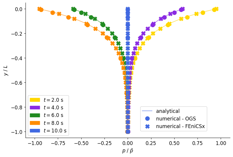

Comparison between FEniCSx, OpenGeoSys and the analytical solution
In the field of numerical simulations, it is good practice to perform Verification and Validation (V&V) in order to build confidence in the results [5]. Verification can be done by comparing results with analytical solutions or with other independent code implementations (see [6] for an example of Quality assurance (QA) of TH²M simulations). The more complex a model is, the more equations and physical components it contains. When using hierarchical benchmarking, the complexity can be increased slowly in order to examine different aspects and simplifications [7].
The following compares the results of the numerical simulation using OpenGeoSys with those of the FEniCSx simulation and the analytical solution.
x = 0
y_rel = y / 100
fig, ax = plt.subplots(figsize=(9, 6))
ax.spines["right"].set_color(
    "none"
)  # https://www.grund-wissen.de/informatik/python/scipy/matplotlib.html
ax.spines["top"].set_color(
    "none"
    if t != 10:
        ax.plot(
            -y_rel,
            color=colors[t],
            alpha=0.6,
        (ANALYTICAL,) = ax.plot(
            -y_rel,
            color=colors[t],
            alpha=0.6,
            label="analytical",
## Plotting numerical solution OGS
for t_num in (2, 4, 6, 8, 10):
    mesh_ogs = read_timestep_mesh(200, t_num)
    line_mesh_ogs = slice_along_line(mesh_ogs, p1, p2)
    pressure_ogs = get_pressure_sorted(line_mesh_ogs)
    depth_ogs = get_depth_sorted(line_mesh_ogs)
    if t_num != 10:
        ax.plot(
            pressure_ogs / 0.1e5,
            depth_ogs / 100,
            "o",
            markevery=15,
        ax.set_xlabel("$p$ / $\\tilde{p}$")
        (OGS,) = ax.plot(
            depth_ogs / 100,
            "o",
            markevery=15,
            label="numerical - OGS",
## Plotting numerical solution FEniCSx
    if step != 10:
        ax.plot(pressure / 0.1e5, (depth / 100) - 1, "X", color=colors[step])
        ax.plot(
            pressure / 0.1e5,
            (depth / 100) - 1,
            "X",
            color=colors[step],
first_legend = ax.legend(
    loc="lower left",
ax.add_artist(first_legend)
ax.legend(bbox_to_anchor=(0.55, 0.25))
# ax.grid(True)
ax.set_ylabel("$y$ / $L$")
ax.set_xlim(-1.1, 1.1)
# ax.legend(bbox_to_anchor=(.55, 0.4))
plt.savefig(str(out_dir / "./comparison_analytical_ogs_fenicsx_p.pdf"))
x = 0
y_rel = y / 100
    "none"
    "none"
    if t != 10:
        ax.plot(
            -y_rel,
            color=colors[t],
            alpha=0.6,
            -y_rel,
            color=colors[t],
            alpha=0.6,
            label="analytical",
    sigma_ogs = get_stresses_sorted(line_mesh_ogs)
    if t_num != 10:
        ax.plot(
            sigma_ogs[1] / 0.1e5,
            depth_ogs / 100,
            "o",
            markevery=15,
        ax.set_xlabel("$\\sigma'_{yy,\\text{ogs}}/\\alpha\\tilde{p}$")
        (OGS,) = ax.plot(
            depth_ogs / 100,
            "o",
            markevery=15,
meshes_stress = [
    mesh_t2_stress,
    mesh_t4_stress,
    mesh_t6_stress,
    mesh_t8_stress,
    mesh_t10_stress,
for step, mesh in zip(i_steps, meshes_stress, strict=False):
    sigma_xx, sigma_yy, sigma_xy = get_stresses_sorted_FEniCSx(mesh, mask, line_points)
    if step != 10:
        ax.plot(sigma_yy / 0.1e5, (depth / 100) - 1, "X", color=colors[step])
        ax.set_xlabel("$\\sigma'_{yy}$ / $\\alpha\\tilde{p}$")
        ax.plot(
            sigma_yy / 0.1e5,
            (depth / 100) - 1,
            "X",
            color=colors[step],
    loc="lower left",
    fontsize="14",
ax.legend(bbox_to_anchor=(0.6, 0.3), fontsize="14")
# ax.grid(True)
