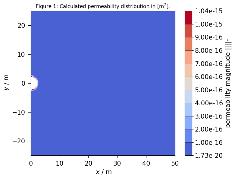

The computed permeability is shown in Fig. 1, in which one can see that the permeability near the hole is increased with a reasonable distribution pattern. This implies that the permeability model can describe the permeability change in EDZ.
mesh_1 = ot.MeshSeries(out_dir / "quad_with_half_hole.pvd").mesh(1)(click to toggle)
fig_perm, ax = plt.subplots(figsize=(8, 6))
ot.plot.contourf(mesh_1, "permeability", fig=fig_perm, ax=ax, fontsize=15)
ax.set_title("Figure 1: Calculated permeability distribution in [m$^2$].")
plt.tight_layout()

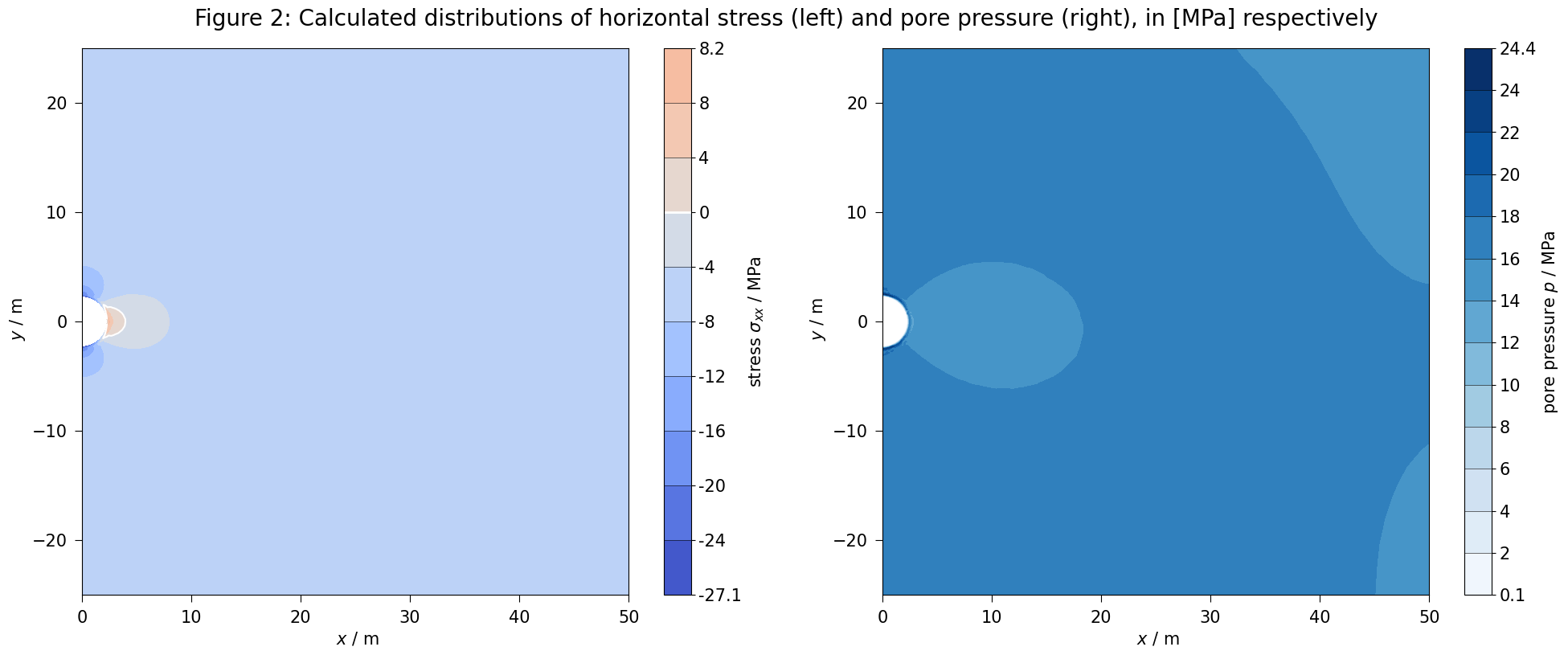

The distributions of the horizontal stress, $\sigma_{xx}$ , and the pore pressure are illustrated in Fig. 2.
pressure = ot.variables.pressure.replace(data_name="pressure_interpolated")(click to toggle)
fig_stress, ax = plt.subplots(nrows=1, ncols=2, figsize=(20, 8))
ot.plot.contourf(
    mesh_1, ot.variables.stress["xx"], fig=fig_stress, ax=ax[0], fontsize=15
ot.plot.contourf(mesh_1, pressure, fig=fig_stress, ax=ax[1], fontsize=15)
plt.suptitle(
    "Figure 2: Calculated distributions of horizontal stress (left) and pore pressure (right), in [MPa] respectively",
    fontsize=20,
plt.tight_layout()
