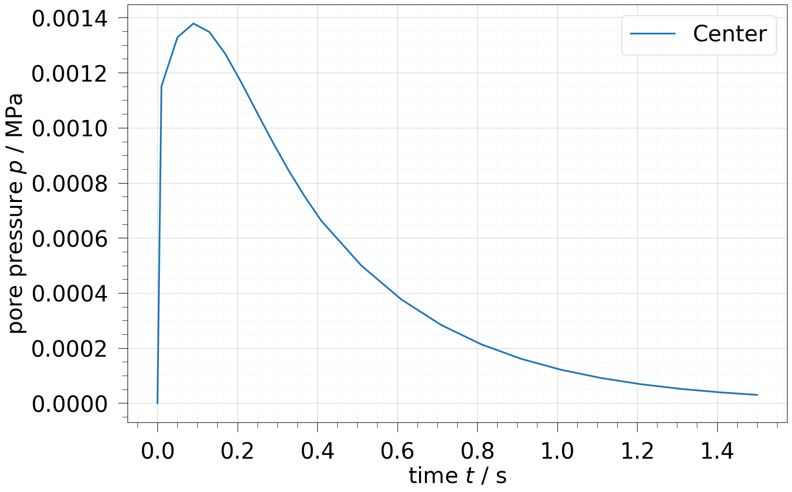

# Load the result
ms = ot.MeshSeries(f"{out_dir}/results_MandelCryerStaggered.pvd")Available point data in the results:
print(ms[0].point_data.keys())['displacement', 'epsilon', 'pressure', 'sigma', 'velocity']
# Plot soil temperature at observation points…
(click to toggle)
center_point = [0, 0, 0]
ms_pts = ot.MeshSeries.probe(ms, center_point)
fig = ot.plot.line(ms_pts, "time", ot.variables.pressure, labels=["Center"])
As predicted, the pressure in the center exceeds the applied load and then levels out.
