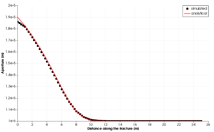

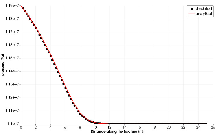

We solve a hydromechanics problem (small deformation, linear elastic, Darcy flow) with a pre-existing fracture using the lower-dimensional interface element (LIE) approach.
Result showing pore pressure increase due to the injection and subsequent fracture aperture increases at t=500s. A small discrepancy of the aperture near the injection is due to the interpolation method for converting cell data to point data in ParaView.

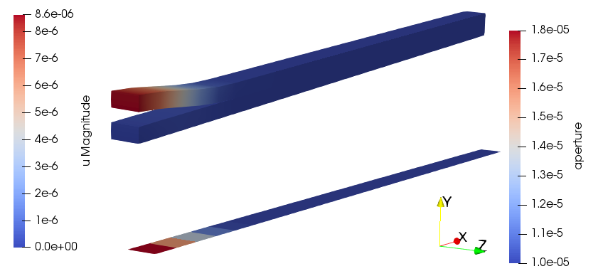

3D setup
Same setup as for the given 2D case above with additional plane strain conditions in the front and back x-y planes. Warp of the 1000-times oversized displacement and the fracture’s aperture are shown in the following figure.
