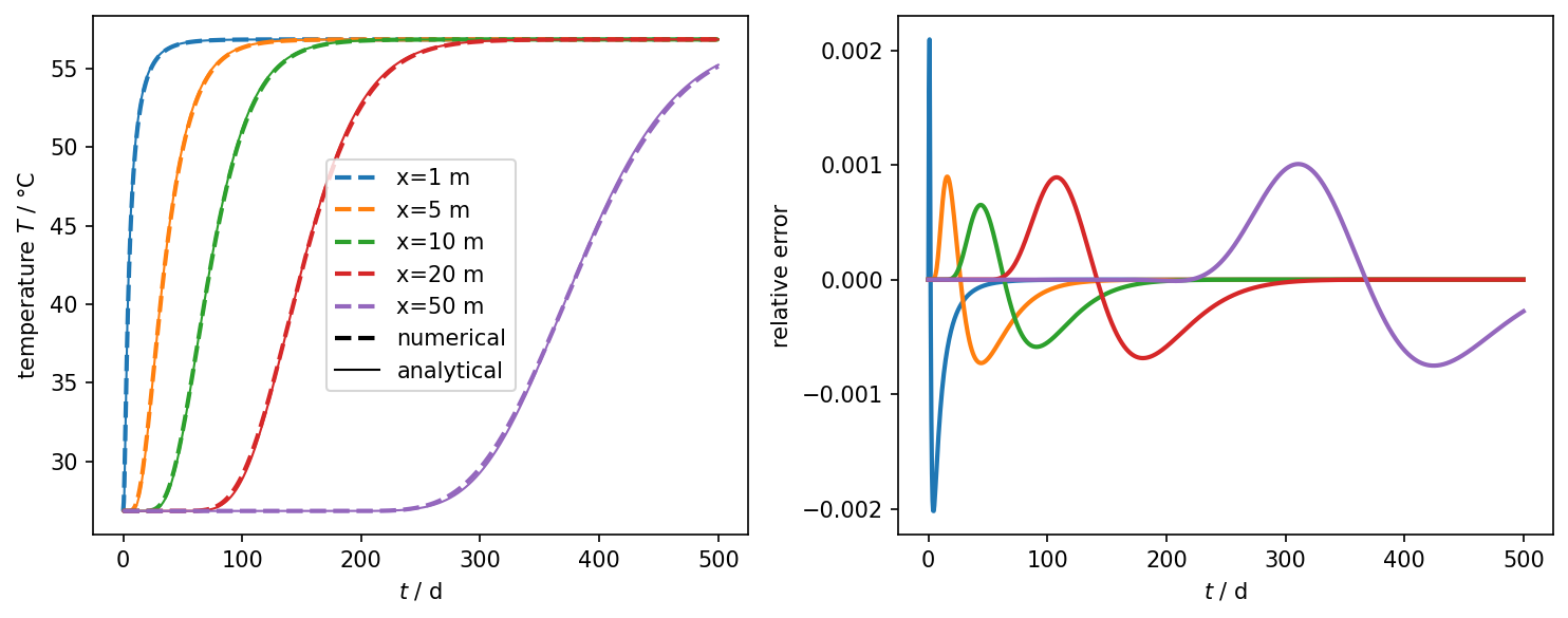

Temperature over time at different locations
obs_pts = np.asarray([[x, 0, 0] for x in [1, 5, 10, 20, 50]])… (click to toggle)
num_values = ms.probe_values(obs_pts, "temperature").T
ref_values = [ogata_banks_analytical(ms.timevalues, x) for x in obs_pts[:, 0]]
ms = ms.scale(time="days")
time = ms.timevalues
plot_results_errors(time, num_values, ref_values, leg_labels, "$t$ / d")

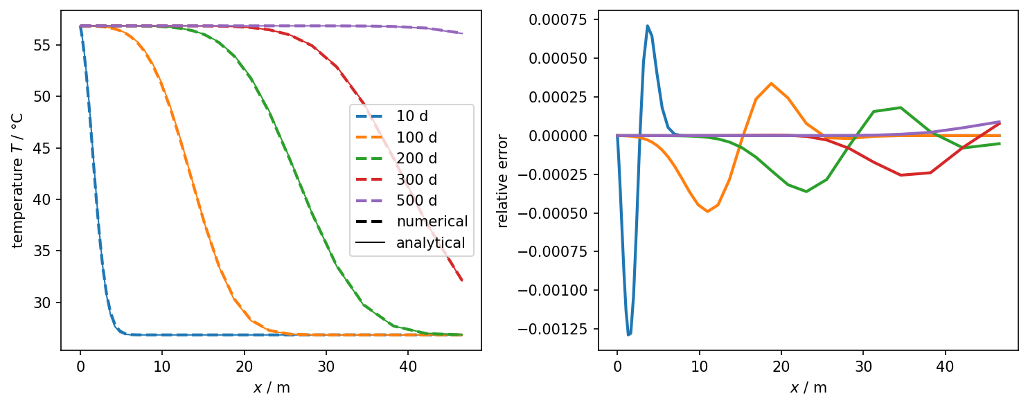

Temperature over x at different timesteps
timevalues = np.asarray([10, 100, 200, 300, 500])… (click to toggle)
all_pts = ms.mesh(0).points
pts = all_pts[(all_pts[:, 0] <= 50) & (all_pts[:, 1] == 0)]
line = pv.PointSet(pts)
num_values = [line.sample(ms.mesh(ts))["temperature"] for ts in timesteps]
ref_values = [ogata_banks_analytical(tv * 86400, pts[:, 0]) for tv in timevalues]
leg_labels = [f"{tv} d" for tv in timevalues]
plot_results_errors(pts[:, 0], num_values, ref_values, leg_labels, "$x$ / m")

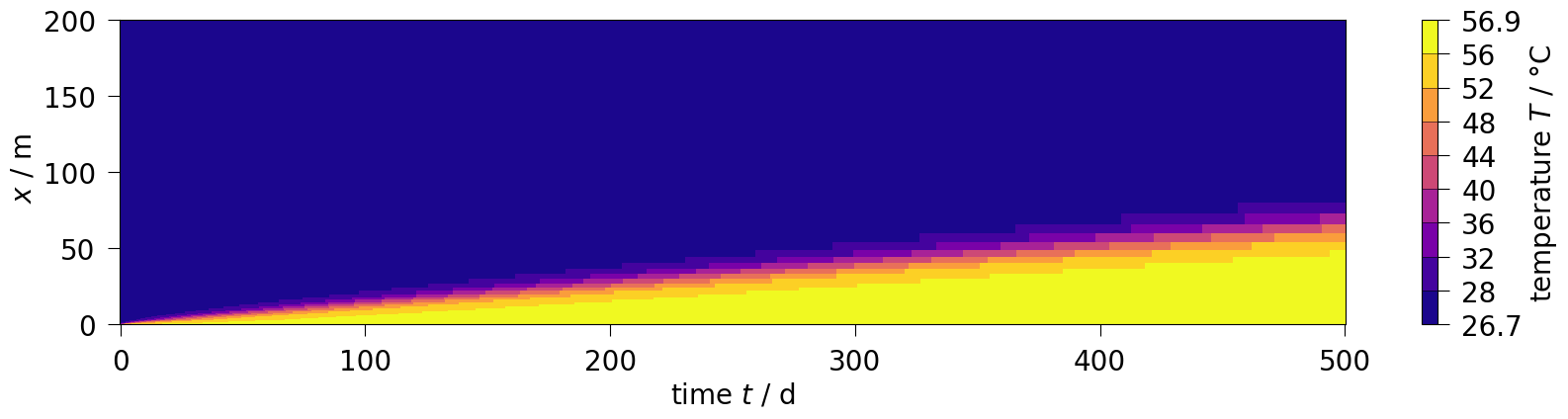

Temperature over time and space
fig = ms.plot_time_slice("time", "x", var, figsize=(20, 4), fontsize=20)
For this discretisation, the numerical solution approximates well to the analytical one. Finer resolutions in the time discretisation reduce the deviations considerably. In this benchmark it is easy to see that too coarse resolutions (especially in the time discretisation) yield very plausible results, which can, however, deviate considerably from the exact solution. An analysis of the von Neumann stability criterion is worthwhile here. This criterium demands
$$\text{Ne}=\frac{\alpha\Delta t}{\left(\Delta x\right)^2}\leq\frac{1}{2}$$
Evaluated for the problem at hand, the following value results:
dx = 0.17 # Spatial discretizations at the left boundary (smallest element)… (click to toggle)
Ne = alpha * delta_t / (dx * dx)  # von-Neumann-Stability-Criterion
print(Ne)
1.644290657439446
The Neumann criterion is not met in this case. The smallest element is $\Delta x=0.17\text{m}$ in width. A suitable time step for this cell size would be
dt = 0.5 * (dx * dx) / alpha
print("Smallest timestep should not exceed", dt, "seconds.")
Smallest timestep should not exceed 13136.363636363638 seconds.
Repeating the test with this time step should give much smaller deviations to the exact solution.
However, the problem at hand has been spatially discretised where element widths are increasing from left to right. That means that the stability criteria is violated only at the left region of the domain. The minimum width that an element should have is can be determined by:
dx = np.sqrt(2 * alpha * delta_t)
print("Minimum element size should be", dx, " metre.")
Minimum element size should be 0.3082855818879631  metre.
The elements located at approximately $x>1\text{m}$ satisfy this criterion, therefore the solution presented here can be accepted as an approximation of the exact solution.
