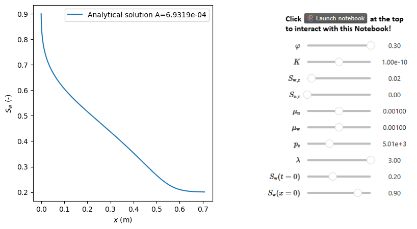

The analytical solution is calculated according to McWhorter and Sunada. The initial saturation is Si in the domain. At $t=0$ the saturation at $x=0$ becomes S0. The analytical solution is calculated for $t=1000$ s.
def plot_f(mun, muw, K, phi, lambda_, Pe, S0, Si, Snr, Swr, **kwargs):… (click to toggle)
    model = BrooksCorey(Pe, lambda_, Snr, Swr)
    problem = McWhorter(model, phi, K, muw, mun, S0, Si)
    problem.plot_solution()

if "OGS_TESTRUNNER" in os.environ:  # static plot
    params = {k: v.value for k, v in sliders.items()}
        params["Pe"],
        params["lambda_"],
        params["Snr"],
        params["Swr"],
        model,
        params["phi"],
        params["K"],
        params["muw"],
        params["mun"],
        params["S0"],
        params["Si"],
    img = mpimg.imread("figures/slider.png")
    fig, axes = plt.subplots(1, 2, figsize=(10, 5))
    axes[1].imshow(img)
    axes[1].axis("off")  # Achsen ausblenden
    plt.sca(axes[0])
else:  # interactive plot
    # Display sliders and plot
    ui = widgets.VBox(list(sliders.values()))
    out = widgets.interactive_output(plot_f, sliders)
    display(widgets.HBox([out, ui]))

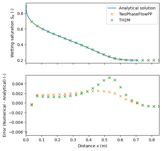

Numerical solutions
For the numerical solution, we compare the Thermal-2-Phase-Hydro-Mechanical (TH2M) and the Two-phase Flow formulation.
  1. The first step is to create a matching mesh that capture the penetration depth of the wetting fluid.
  2. Because the OGS models use the capillary pressure as a primary variable, the boundary and initial conditions need to be converted from saturations to pressures.
Tip: Pick the parameters you would like to study with the sliders above and run the code blocks below to compare the results of the analytical and numerical model.

penetration depth of the wetting fluid: 0.7072512405219576
2 replacements made.
info: Mesh reading time: 0.00076759 s
info: MeshNodeSearcher construction time: 2.0822e-05 s
info: identifySubdomainMesh(): identifySubdomainMeshNodes took 4.597e-06 s
info: identifySubdomainMesh(): identifySubdomainMeshElements took 1.3811e-05 s
info: identifySubdomains time: 2.9755e-05 s
info: writing time: 0.000723673 s
info: Entire run time: 0.00173575 s
Si = 0.2 -> pci = 8793.060606699997
S0 = 0.9 -> pc0 = 5180.877745148153
Updating the PRJ file

Evaluation and Results
# 1. Plot analytical solution… (click to toggle)
plotter = plot_with_error(
    x_ref,
    Sw_ref,
    "C0-",
    "Analytical solution",
    "Distance $x$ (m)",
    "Wetting saturation $S_w$ (-)",
    "Error (Numerical - Analytical) (-)",
# 2. Read results from TwoPhaseFlowPP
labels = ["TwoPhaseFlowPP", "TH2M"]
results = [
    "twophaseflow_test_t_1000.000000.vtu",
    "result_McWhorter_H2_ts_110_t_1000.000000.vtu",
i = 1
for label, result in zip(labels, results, strict=True):
    mesh = pv.read(out_dir / result)
    print(mesh.point_data.keys())
    Sw = mesh["saturation"]
    x = mesh.points[:, 0]
    ind = np.argsort(x)
    x = x[ind]
    Sw = Sw[ind]
    plotter.append(x, Sw, f"C{i}x", label)
    i = i + 1
# show plot
plotter.plot([0, depth * 1.2])
['capillary_pressure', 'gas_pressure', 'saturation']
['capillary_pressure', 'capillary_pressure_interpolated', 'displacement', 'epsilon', 'gas_density', 'gas_pressure', 'gas_pressure_interpolated', 'k_rel_G', 'k_rel_L', 'liquid_density', 'liquid_pressure_interpolated', 'porosity', 'saturation', 'sigma', 'temperature', 'temperature_interpolated', 'velocity_gas', 'velocity_liquid', 'xmCG', 'xmWL', 'xnCG']
