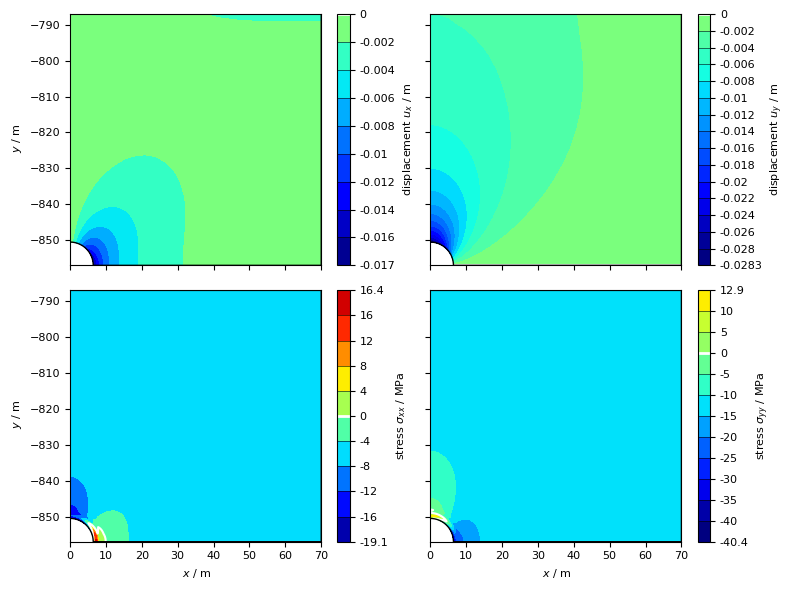

The following figures illustrate the distributions of displacements and stresses at the end of the simulation.
contour_plot(… (click to toggle)
contour_plot(
    ms_e_last,
        ot.variables.displacement["y"],
        ot.variables.stress["xx"],
        ot.variables.stress["yy"],

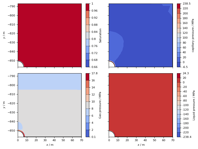

The following figures illustrate the distributions of gas pressure, liquid pressure, capillary pressure and saturation at the end of the simulation.
contour_plot(
    ms_e_last,
    [saturation, pc_interpolated, pg_interpolated, pl_interpolated],
    cmap="coolwarm",
  • The obtained results are checked below

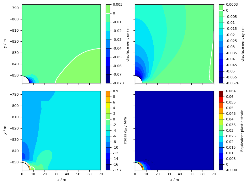

The following figures illustrate the distributions of displacement, horizontal stress, and equivalent plastic strain at the end of the simulation. In comparison with elastic deformation, displacement and stress exhibit noticeable changes.
contour_plot(
    ms_pls_last,
        pls_strain,

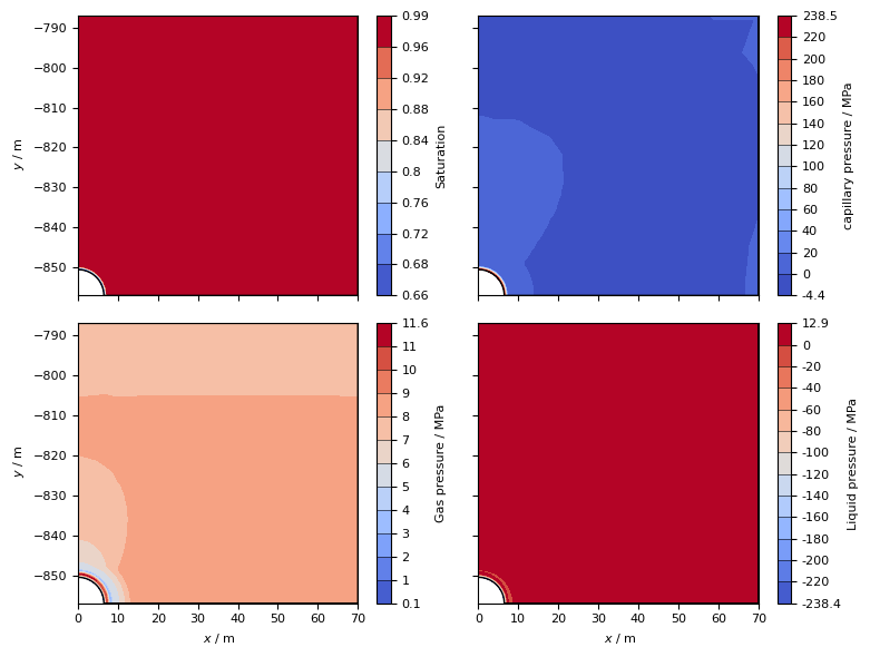

The following figures illustrate the distributions of gas pressure, liquid pressure, capillary pressure and saturation at the end of the simulation. In contrast to elastic deformation, these variables are also modified.
contour_plot(
    ms_pls_last,
    cmap="coolwarm",
  • The obtained results of the elasto-plastic case are checked below

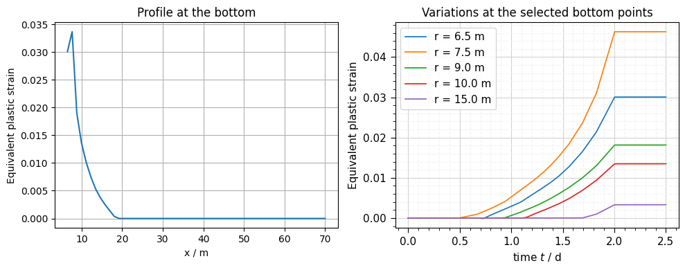

The left figure below illustrates the equivalent plastic strain profile at the bottom boundary, while the right figure illustrates the equivalent plastic strain variations at selected bottom points. From the latter, we observe that the largest equivalent plastic strain occurs at the position closest to the tunnel surface.
fig, ax = plt.subplots(1, 2, figsize=(10, 4))… (click to toggle)
ax[0].plot(x_profile_pls["Distance"] + 6.5, x_profile_pls["epsilon_pls"], color="C0")
ax[0].set_xlabel("x / m")
ax[0].set_ylabel("Equivalent plastic strain")
ax[0].set_title("Profile at the bottom")
ax[0].grid()
ms_pts_pls = ot.MeshSeries.probe(ms_pls, points)
ot.plot.line(
    ms_pts_pls,
    "time",
    pls_strain,
    labels=labels,
    # linestyle="dashed",
    ax=ax[1],
    fontsize=11,
    linewidth=0.5,
ax[1].set_title("Variations at the selected bottom points")

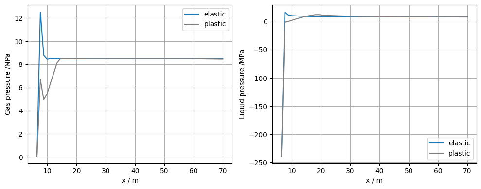

plot_profile = PlotProfile(x_profile_e, x_profile_pls)

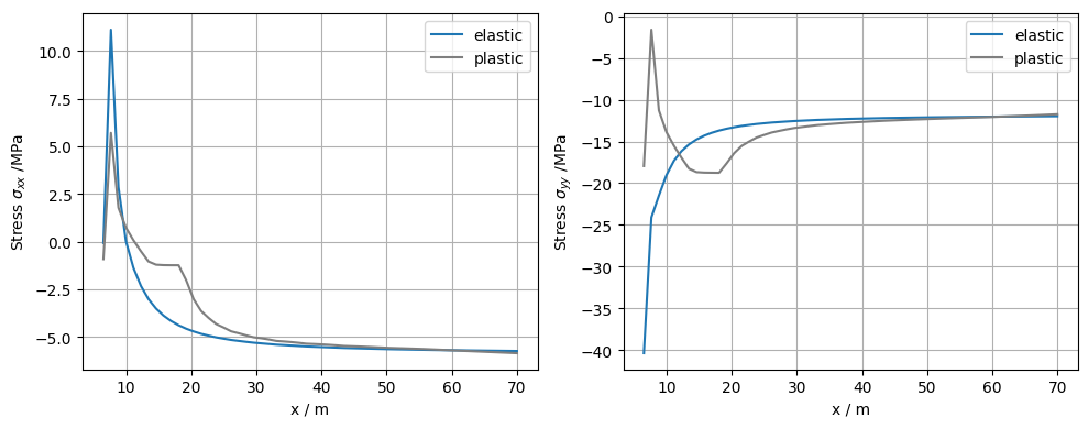

The following figures present the profiles of horizontal stress, $\sigma_{xx}$, and vertical stress, $\sigma_{yy}$ along the bottom boundary. The stress variations near the tunnel are clearly significant.
plot_profile.plot(… (click to toggle)
plot_profile.plot(
    ["sigma_xx", "sigma_yy"],
    [r"Stress $\sigma_{xx}$ /MPa", r"Stress $\sigma_{yy}$ /MPa"],
The following figures show the profiles of gas pressure and liquid pressure along the bottom boundary. The application of the plastic model results in a substantial change in the gas pressure.
plot_profile.plot(
    ["gas_pressure_interpolated", "liquid_pressure_interpolated"],
    ["Gas pressure /MPa", "Liquid pressure /MPa"],

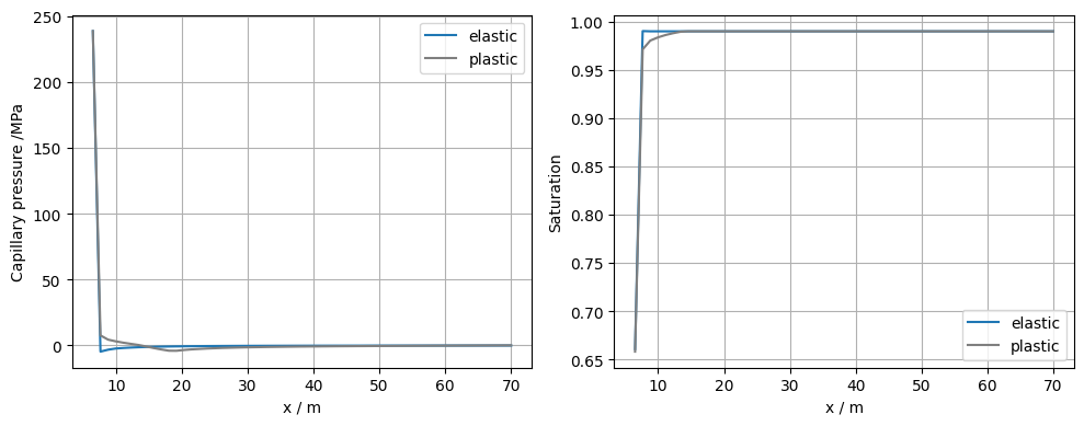

The following figures show the profiles of capillary pressure and saturation along the bottom boundary. Using the plastic model results in a slight change in the saturation.
plot_profile.plot(
    ["capillary_pressure_interpolated", "saturation"],
    ["Capillary pressure /MPa", "Saturation"],

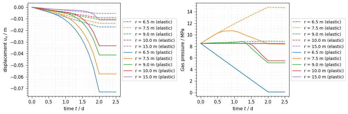

4.2 Variable variations at bottom points
ms_pts_e = ot.MeshSeries.probe(ms_e, points)
vv = VariableVariations(ms_pts_e, ms_pts_pls)
The figures below illustrate the variations in horizontal displacement (left) and gas pressure (right). It is evident that the application of the plastic model leads to reductions in both parameters.
vv.plot([ot.variables.displacement["x"], pg_interpolated])

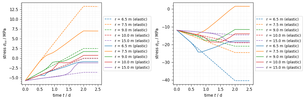

The figures below illustrate the variations in horizontal stress (left) and vertical stress (right). This stress comparison further confirms that the application of the plastic model leads to significant alterations in the stress results.
vv.plot([ot.variables.stress["xx"], ot.variables.stress["yy"]])

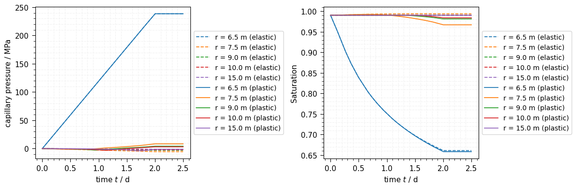

The figures below illustrate the variations in capillary pressure (left) and saturation (right). The significant changes in these variables occur in the region near the tunnel.
vv.plot([pc_interpolated, saturation])
