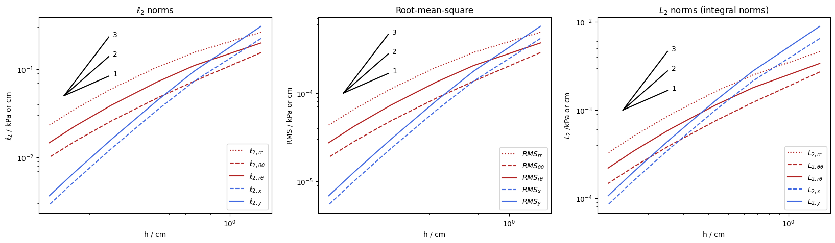

Convergence Analysis: Disc with a hole
For many typical engineering problems that need to be solved using numerical techniques, convergence plays a decisive role. It is important to obtain an accurate numerical solution, i.e., to know the mesh refinement level beyond which the results of the numerical analysis do not change significantly, anymore.
In this study the convergence in stress and displacement values for the disc with hole problem are analysed and compared to each other. This study is based on the accomanying Jupyter notebook “Linear_Disc_with_hole.ipynb”, which explains the main features of the analytical and numerical solution of the disc with hole problem. For a better access to the solutions used in this document, it is recommended to read through the previously mentioned Jupyter notebook first.
For the evaluation of the stress and displacement convergence, we consider seven steps of mesh refinement, described by an index parameter. The following table lists each refinement index with the corresponding edge length, which is considered representative of the cell size.
$$ \begin{aligned} &\begin{array}{cccc} \text {Refinement Index} & \text {Cell Size [cm]} \\ \hline 8 & 1.429 \\ 16 & 0.667 \\ 24 & 0.435 \\ 40 & 0.256 \\ 60 & 0.169 \\ 80 & 0.127 \\ 240 & 0.042 \\ \end{array} \end{aligned} $$

Comparison with “pseudo” analytical solution
As described before the numerical solutions for each refinement step are compared to the solution for the finest refinement index of 240 in the following section. Although the approximation is already clear from the previous plots of the stress curves along the x axis, mathematical norms are used hereafter for a better representation and interpretation of the relationship. In particular, these norms reveal how fast the solution converges to the pseudo analytical one.
Norm Plots
To quantify the total error of a numerical calculation, various error norms can be used:
\begin{align} \ell_{2}=|w|=\sqrt{\sum_{i=0}^N (w_{i})^2} \ RMS =\sqrt{\frac{\sum_{i=0}^N (w_{i})^2}{N}} \ L_{2}=||w||=\sqrt{\int_{\Omega} (w(x))^2 dx} \end{align}
The $\ell_{2}$ norm or Euclidean norm is the square root of the sum of the squared absolute errors at each point of the mesh.
The root mean square ($RMS$) is calculated similarly. Here, however, the influence of the number of points is taken into account by dividing by the square root of the number of points.
The $L_{2}$ norm as integral norm represents a generalization of the $\ell_{2}$ norm for continuous functions. While the Euclidean norm only considers the values on individual mesh nodes, the integral norm considers the solution on the entire mesh. Therefore an advantage of the $L_{2}$ norm is, that big elements are considered with a higher impact than small ones, which produces more homogeneous results.
The following plots represent the development of the Euclidean and Integral norm and $RMS$ for the refinement of the mesh. How fast the considered element converge is expressed by the slope of the lines in the plot. First the detailed discussed error norms for the stresses are visualised and in addition to them the norms for the associated displacements to draw conclusions about the quality of convergence.
The main conclusion that can be drawn is that the solution for the displacements converge significantly faster than those for the stresses. As a practical consequence, it might be possible to get a sufficiently accurate displacement solution already on a relatively coarse mesh, whereas for an accurate stress solution a much finer mesh might be necessary.

def plot_slope_sketch(ax, x0, y0, slopes, xmax=None):(click to toggle)
    """Plot sketch for slopes. All slopes cross at (x0, y0)"""
    if xmax is None:
        xmax = 2 * x0
    xs = np.linspace(x0, xmax, 20)
    for slope in slopes:
        y_ = xs[0] ** slope
        ys = y0 / y_ * xs**slope
        ax.plot(xs, ys, color="black")
        ax.text(xs[-1] * 1.05, ys[-1], slope)
h = np.linspace(size[80], size[8], 1000)(click to toggle)
k = np.linspace(1, 2, 20)
fig, ax = plt.subplots(ncols=3, figsize=(20, 5))
ax[0].plot(
    size.values(),
    l2_rr.values(),
    color="firebrick",
    linestyle=":",
    label=r"$\ell_{2, rr}$",
ax[0].plot(
    size.values(),
    l2_tt.values(),
    color="firebrick",
    linestyle="--",
    label="$\\ell_{2, \\theta\\theta}$",
ax[0].plot(
    size.values(),
    l2_rt.values(),
    color="firebrick",
    label="$\\ell_{2, r\\theta}$",
ax[0].plot(
    size.values(),
    l2_x.values(),
    color="royalblue",
    linestyle="--",
    label=r"$\ell_{2, x}$",
ax[0].plot(size.values(), l2_y.values(), color="royalblue", label=r"$\ell_{2, y}$")
plot_slope_sketch(ax[0], 1.5e-1, 5e-2, [1, 2, 3], xmax=2.5e-1)
ax[0].set_title(r"$\ell_2$ norms")
ax[0].set_ylabel(r"$\ell_2$ / kPa or cm")
ax[1].plot(
    size.values(),
    rms_rr.values(),
    color="firebrick",
    linestyle=":",
    label="$RMS_{rr}$",
ax[1].plot(
    size.values(),
    rms_tt.values(),
    color="firebrick",
    linestyle="--",
    label="$RMS_{\\theta\\theta}$",
ax[1].plot(size.values(), rms_rt.values(), color="firebrick", label="$RMS_{r\\theta}$")
ax[1].plot(
    size.values(),
    rms_x.values(),
    color="royalblue",
    linestyle="--",
    label="$RMS_{x}$",
ax[1].plot(size.values(), rms_y.values(), color="royalblue", label="$RMS_{y}$")
plot_slope_sketch(ax[1], 1.5e-1, 1e-4, [1, 2, 3], xmax=2.5e-1)
ax[1].set_title("Root-mean-square")
ax[1].set_ylabel("RMS / kPa or cm")
ax[2].plot(
    size.values(),
    L2_rr.values(),
    color="firebrick",
    linestyle=":",
    label="$L_{2, rr}$",
ax[2].plot(
    size.values(),
    L2_tt.values(),
    color="firebrick",
    linestyle="--",
    label="$L_{2, \\theta\\theta}$",
ax[2].plot(size.values(), L2_rt.values(), color="firebrick", label="$L_{2, r\\theta}$")
ax[2].plot(
    size.values(),
    L2_x.values(),
    color="royalblue",
    linestyle="--",
    label="$L_{2, x}$",
ax[2].plot(size.values(), L2_y.values(), color="royalblue", label="$L_{2, y}$")
plot_slope_sketch(ax[2], 1.5e-1, 1e-3, [1, 2, 3], xmax=2.5e-1)
ax[2].set_title("$L_2$ norms (integral norms)")
ax[2].set_ylabel("$L_2$ /kPa or cm")
for i in range(3):
    ax[i].legend()
    ax[i].set_xlabel("h / cm")
    ax[i].loglog(base=10)
