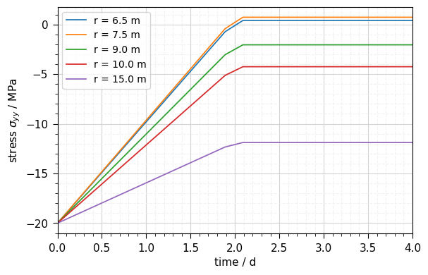

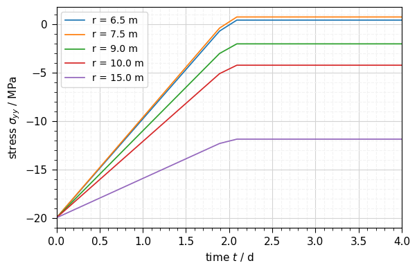

To simulate gradual excavation, the release nodal force vector is applied to the global right-hand side (RHS) vector $\mathbf{b}$, scaled by a time- and position-dependent release parameter $g(t, \mathbf{x})$:
$$ \mathbf{b} = \mathbf{b} + \mathbf{f}_\text{r} \cdot g(t, \mathbf{x}) $$
Parameter requirements:
  • Monotonically decreasing: $\frac{\partial g}{\partial t} < 0$
  • $g(0, \mathbf{x}) = 1$
  • $g(t_e, \mathbf{x}) = 0$, where $t_e$ is the end time of excavation

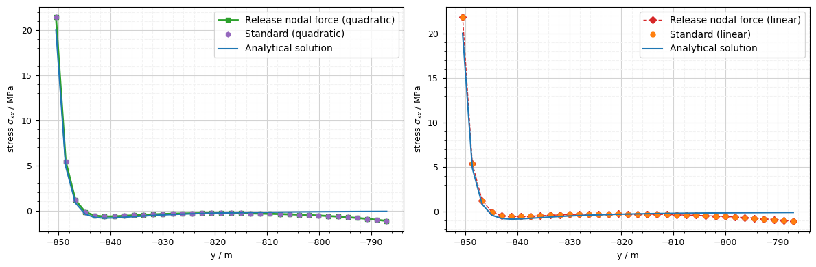

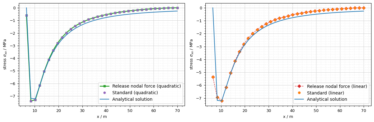

Kirsch’s problem, a classic example, is used to verify the implementation of the ReleaseNodalForce boundary condition.

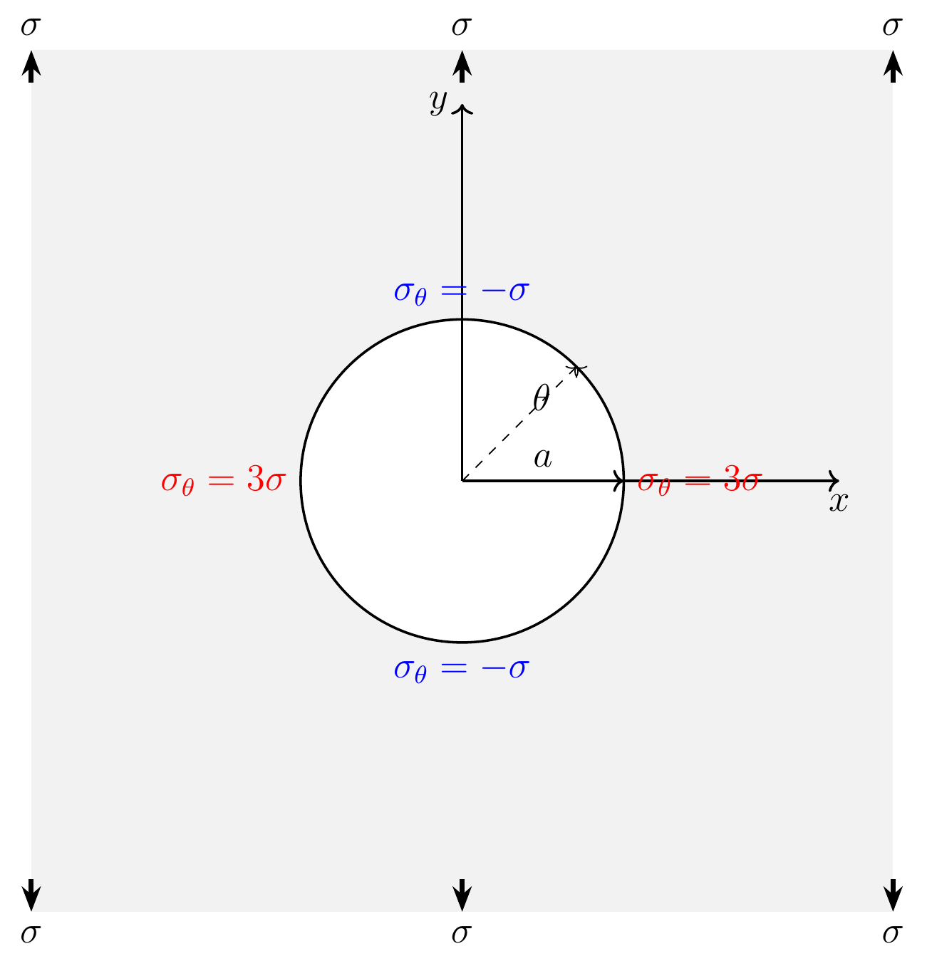

Kirsch’s problem defines an infinite elastic plate with a circular hole of radius $a$ subjected to uniaxial tension or compression stress $\sigma$. If the tension or the compression is along y-axis,
drawing
the stress solutions of this problem in polar coordinates $(r, \theta)$ are given by [1]:
$$ \begin{align} \sigma_r &= \frac{\sigma}{2} \left( 1 - \frac{a^2}{r^2} \right) - \frac{\sigma}{2} \left( 1 - \frac{4a^2}{r^2} + \frac{3a^4}{r^4} \right) \cos 2\theta \\ \sigma_\theta &= \frac{\sigma}{2} \left( 1 + \frac{a^2}{r^2} \right) + \frac{\sigma}{2} \left( 1 + \frac{3a^4}{r^4} \right) \cos 2\theta \\ \tau_{r\theta} &= \frac{\sigma}{2} \left( 1 + \frac{2a^2}{r^2} - \frac{3a^4}{r^4} \right) \sin 2\theta \end{align} $$
  • At the hole’s boundary $ r = a $: $ \sigma_r = 0 $, $ \tau_{r\theta} = 0 $.
  • At $ \theta = 0, \pi $: $ \sigma_\theta = 3\sigma $ (maximum tensile stress).
  • At $ \theta = \pm \pi/2 $: $ \sigma_\theta = -\sigma $ (compressive stress).

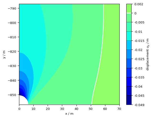

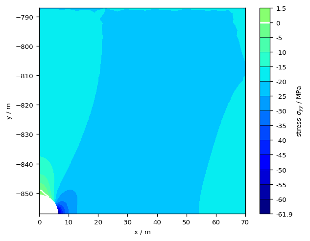

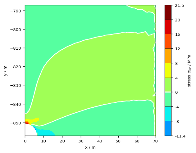

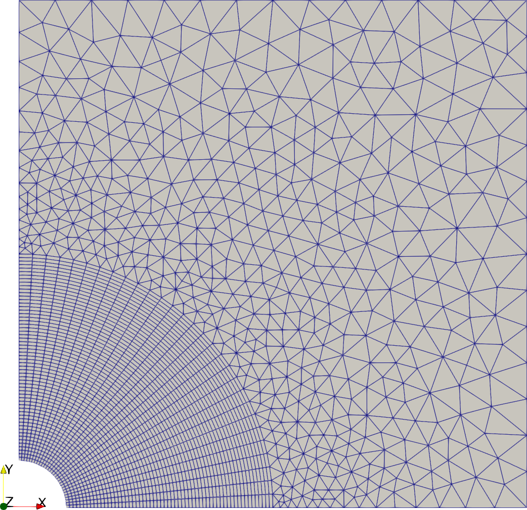

For the finite element analysis, the geometrical domain is bounded to 140 m $\times$ 140 m with a circular hole of radius 6.5 m located at the domain center. By leveraging the problem’s symmetry, we use a quarter of the domain, resulting in the mesh shown below:
drawing

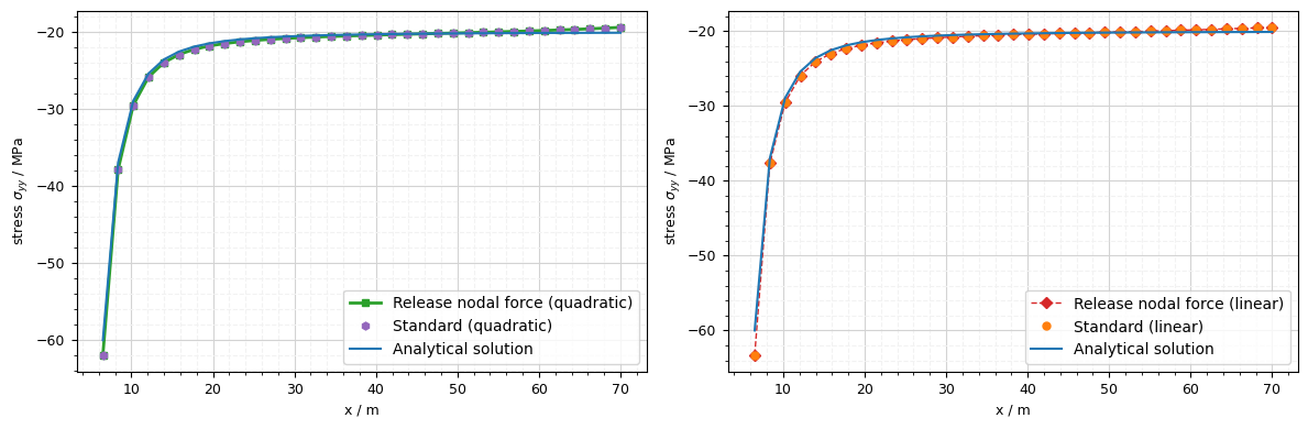

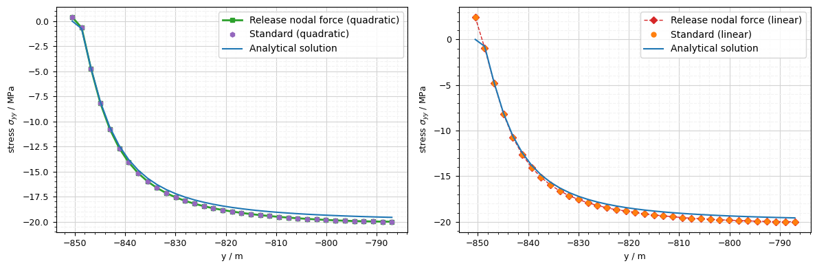

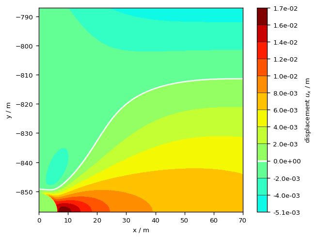

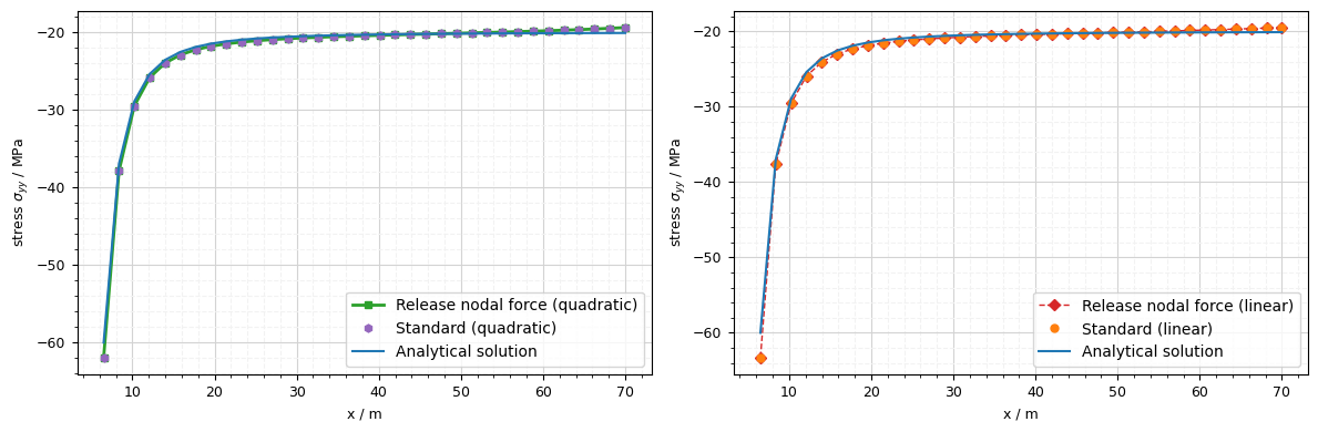

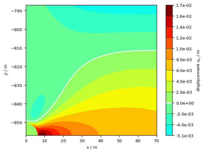

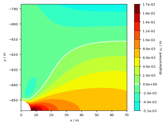

The problem is analyzed using the release nodal force approach and a standard approach. The initial and boundary conditions for both approaches are provided in the table below:
Item Standard approach Release Nodal Force Unit
Initial stress (0.0, 0.0, 0.0, 0.0) (0.0, -20.0, 0.0, 0.0) MPa
Bottom $u_y$=0 $u_y$=0 m
Left $u_x$=0 $u_x$=0 m
Top $\sigma_y$=-20 $\sigma_y$=-20, or 0 MPa
Arc Traction $\mathbf\tau=\mathbf 0$ ReleaseNodalForce N/A
These conditions result in $\sigma=-20$ MPa and $a=6.5$ m for the analytical solutions.
With the standard approach, the problem is steady-state, requiring only one time step. With the release nodal force approach, the compensation of non equilibrium initial residuum is required, which means the constant traction boundary condition can be ignored. In addition, we assume that the nodal forces at the arc-type boundary are scaled by a linear time-decay factor that varies from 1 to 0 over a period of 2 days. After 2 days, the stress solutions obtained by this approach should be identical to those from the standard approach, and should closely match the analytical solution.
In the subsequent cells, we perform the computations and compare the results against the analytical solutions.

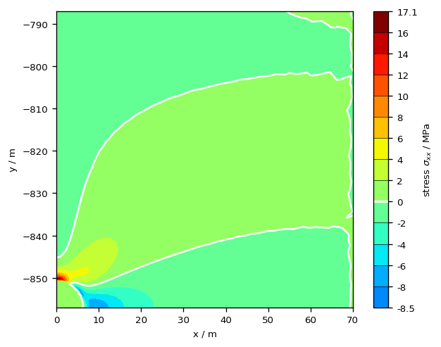

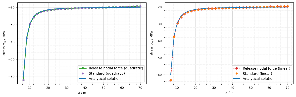

fig = ms_last.plot_contourf(… (click to toggle)
    figsize=(6, 4),
    fontsize=8,
    cmap="jet",
    ot.variables.displacement["y"], figsize=(6, 4), fontsize=8, cmap="jet"
    ot.variables.stress["xx"], figsize=(6, 4), fontsize=8, cmap="jet"
    ot.variables.stress["yy"], figsize=(6, 4), fontsize=8, cmap="jet"

5. Result comparison
fig, ax = plt.subplots(1, 2, figsize=(12, 4))… (click to toggle)
ot.plot.lineplots.line(
    extracted_ms[-1],
    ax=ax[0],
    fontsize=9,
    linewidth=0.8,
    color="C2",
    marker="s",
    markersize=5,
    label="Release nodal force (quadratic)",
    extracted_ms_linear[-1],
    ax=ax[1],
    fontsize=9,
    linewidth=0.4,
    linestyle="dashed",
    marker="D",
    markersize=5,
    color="C3",
    label="Release nodal force (linear)",
    extracted_ms_std[-1],
    ax=ax[0],
    fontsize=9,
    linewidth=0.4,
    marker="h",
    markersize=5,
    color="C4",
    linestyle="None",
    label="Standard (quadratic)",
    extracted_ms_std_linear[-1],
    ax=ax[1],
    fontsize=9,
    linewidth=0.4,
    marker="o",
    markersize=5,
    color="C1",
    linestyle="None",
    label="Standard (linear)",
a = 6.5
sigma_t = -20  # MPa
sigma_x_a = np.asarray(
        0.5 * (3.0 * a * a / (r * r) - 3 * a**4 / (r**4)) * sigma_t
        for r in np.linspace(6.5, 70.0, 35)
ax[0].plot(xs, sigma_x_a, color="C0", label="Analytical solution")
ax[0].legend()
ax[1].plot(xs, sigma_x_a, color="C0", label="Analytical solution")
ax[1].legend()
In the above two figures, the radial stress $\sigma_r$ profiles along the $\theta = 0^\circ$ axis, obtained using the standard approach, the release nodal force approach, and the analytical solution, are compared. The right-hand figure shows results using linear elements, while the left-hand figure displays results using quadratic elements.
At the arc, i.e., $r = 6.5$ m, the stress computed using linear elements shows a significant discrepancy of approximately 5.5 MPa compared to the analytical solution, which is zero. In contrast, the quadratic elements yield highly accurate stress results in the near field, i.e. around $r = 6.5$ m.
In both cases—whether using linear or quadratic elements—the standard approach and the release nodal force approach produce identical stress solutions.

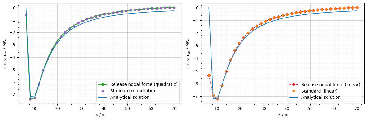

    extracted_ms[-1],
    ax=ax[0],
    fontsize=9,
    linewidth=0.8,
    color="C2",
    marker="s",
    markersize=5,
    ax=ax[1],
    fontsize=9,
    linewidth=0.4,
    linestyle="dashed",
    marker="D",
    markersize=5,
    color="C3",
    ax=ax[0],
    fontsize=9,
    linewidth=0.4,
    marker="h",
    markersize=5,
    color="C4",
    linestyle="None",
    ax=ax[1],
    fontsize=9,
    linewidth=0.4,
    marker="o",
    markersize=5,
    color="C1",
    linestyle="None",
a = 6.5
sigma_t = -20  # MPa
sigma_y_a = np.asarray(
        0.5 * (2 + a * a / (r * r) + 3 * a**4 / (r**4)) * sigma_t
ax[0].plot(xs, sigma_y_a, color="C0", label="Analytical solution")
ax[0].legend()
ax[1].plot(xs, sigma_y_a, color="C0", label="Analytical solution")
ax[1].legend()
In the above two figures, the tangential stress $\sigma_{\theta}$ profiles along the $\theta = 0^\circ$ axis, obtained using the standard approach, the release nodal force approach, and the analytical solution, are compared. The right-hand figure shows results using linear elements, while the left-hand figure displays results using quadratic elements.
In both cases—whether using linear or quadratic elements—the standard approach and the release nodal force approach produce identical stress solutions that match the analytical solution, except at the arc (i.e., $r = 6.5$ m), where the computed stress shows a small, acceptable error.

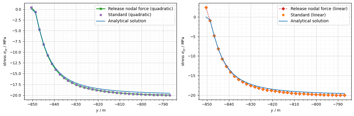

ys = np.asarray(list(np.linspace(-857 + 6.5, -787.0, 35)))… (click to toggle)
y_axis = np.asarray([[0, y, 0] for y in ys])
extracted_ms_y = ot.MeshSeries.extract_probe(ms, y_axis)
extracted_ms_y_linear = ot.MeshSeries.extract_probe(ms_linear, y_axis)
extracted_ms_std_y = ot.MeshSeries.extract_probe(ms_std, y_axis)
extracted_ms_std_y_linear = ot.MeshSeries.extract_probe(ms_std_linear, y_axis)
    extracted_ms_y[-1],
    ax=ax[0],
    fontsize=9,
    linewidth=0.8,
    color="C2",
    marker="s",
    markersize=5,
    extracted_ms_y_linear[-1],
    ax=ax[1],
    fontsize=9,
    linewidth=0.4,
    linestyle="dashed",
    marker="D",
    markersize=5,
    color="C3",
    extracted_ms_std_y[-1],
    ax=ax[0],
    fontsize=9,
    linewidth=0.4,
    marker="h",
    markersize=5,
    color="C4",
    linestyle="None",
    extracted_ms_std_y_linear[-1],
    ax=ax[1],
    fontsize=9,
    linewidth=0.4,
    marker="o",
    markersize=5,
    color="C1",
    linestyle="None",
a = 6.5
sigma_t = -20  # MPa
        0.5 * (2.0 - 5.0 * a * a / (r * r) + 3 * a**4 / (r**4)) * sigma_t
ax[0].plot(ys, sigma_y_a, color="C0", label="Analytical solution")
ax[0].legend()
ax[1].plot(ys, sigma_y_a, color="C0", label="Analytical solution")
ax[1].legend()
In the two figures above, the radial stress $\sigma_r$ profiles along the $\theta = 90^\circ$ axis are similarly compared across the standard approach, the release nodal force approach, and the analytical solution. The same conclusion as above can be drawn.
    extracted_ms_y[-1],
    ax=ax[0],
    fontsize=9,
    linewidth=0.8,
    color="C2",
    marker="s",
    markersize=5,
    ax=ax[1],
    fontsize=9,
    linewidth=0.4,
    linestyle="dashed",
    marker="D",
    markersize=5,
    color="C3",
    ax=ax[0],
    fontsize=9,
    linewidth=0.4,
    marker="h",
    markersize=5,
    color="C4",
    linestyle="None",
    ax=ax[1],
    fontsize=9,
    linewidth=0.4,
    marker="o",
    markersize=5,
    color="C1",
    linestyle="None",
a = 6.5
sigma_t = -20  # MPa
        0.5 * (a * a / (r * r) - 3.0 * (a**4) / (r**4)) * sigma_t
ax[0].plot(ys, sigma_x_a, color="C0", label="Analytical solution")
ax[0].legend()
ax[1].plot(ys, sigma_x_a, color="C0", label="Analytical solution")
ax[1].legend()
In the two figures above, the tangential stress $\sigma_{\theta}$ profiles along the $\theta = 90^\circ$ axis—obtained using the standard approach, the release nodal force approach, and the analytical solution—are compared. The figure on the right shows results using linear elements, while the figure on the left displays results using quadratic elements.
The figures show that the quadratic elements deliver more accurate tangential stress results than the linear elements do.

r = 6.5
h = -857
spoints = np.asarray(
        [0, h + y, 0]
        for y in [
            r,
            r + 1,
            r + 2.5,
            r + 3.5,
            r + 8.5,
labels = [f"r = {point[1] -h:.1f} m" for i, point in enumerate(spoints)]
extracted_sp = ot.MeshSeries.extract_probe(ms, spoints)… (click to toggle)
ot.plot.line(
    extracted_sp,
    "time",
    labels=labels,
    figsize=(6, 4),
    fontsize=11,
    linewidth=0.5,
plt.xlim(0, 4)
plt.legend()
plt.grid(True)
The figure above shows the radial stress variation at different positions along the $\theta = 0^\circ$ axis.
Over time, the absolute stress values decrease from their initial value of 20 MPa, especially at the boundary ($r = 6.5\,\text{m}$), where the stress drops to nearly the expected value of zero.

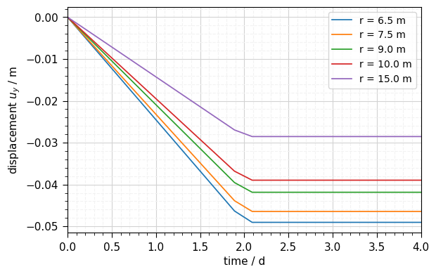

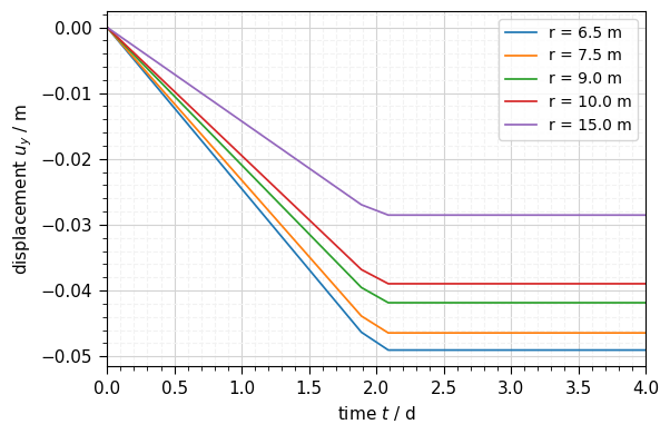

ot.plot.line(… (click to toggle)
ot.plot.line(
    extracted_sp,
    "time",
    labels=labels,
    figsize=(6, 4),
    fontsize=11,
    linewidth=0.5,
plt.xlim(0, 4)
plt.legend()
plt.grid(True)
The figure above shows the radial displacement variation at different positions along the $\theta = 0^\circ$ axis.
Over time, the absolute displacement values increase, particularly at the boundary ($r = 6.5\,\text{m}$), where the maximum displacement change occurs as expected.

fig = ms_ed[-1].plot_contourf(… (click to toggle)
    figsize=(6, 4),
    fontsize=8,
    cmap="jet",
    figsize=(6, 4),
    fontsize=8,
    cmap="jet",

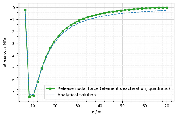

fig, ax = plt.subplots(1, 1, figsize=(6, 4))… (click to toggle)
    extracted_ms_ed_x[-1],
    ax=ax,
    fontsize=9,
    linewidth=0.8,
    color="C2",
    marker="s",
    markersize=5,
    label="Release nodal force (element deactivation, quadratic)",

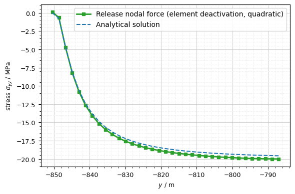

a = 6.5
sigma_t = -20  # MPa
plt.plot(xs, sigma_x_a, color="C0", label="Analytical solution")
plt.legend()
In the above figure, the radial stress $\sigma_r$ profiles along the $\theta = 0^\circ$ axis, obtained using the release nodal force approach together with the element deactivation and the analytical solution, are compared.
    extracted_ms_ed_y[-1],
    ax=ax,
    fontsize=9,
    linewidth=0.8,
    color="C2",
    marker="s",
    markersize=5,
a = 6.5
sigma_t = -20  # MPa
plt.plot(ys, sigma_y_a, color="C0", label="Analytical solution")
plt.legend()
In the above figure, the radial stress $\sigma_r$ profiles along the $\theta = 90^\circ$ axis, obtained using the release nodal force approach together with the element deactivation and the analytical solution, are compared.
