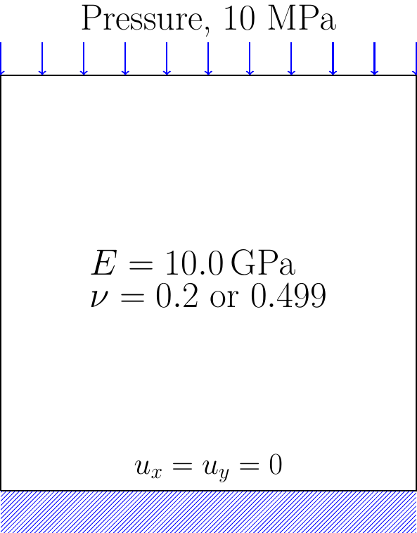

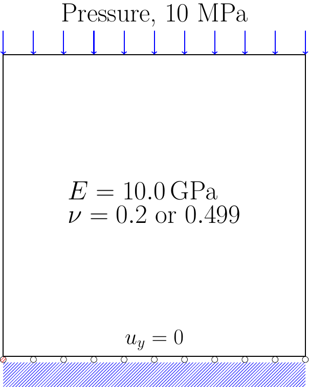

This is a plane strain example demonstrating the mechanical behavior of a $1\text{m}\times1\text{m}$ domain under a constant pressure of 10 MPa.
We analyze two problems, referred to as the homogeneous and heterogeneous problems. The schematics of these problems are shown in the figures below:
Homogeneous problem heterogeneous problem
Simple test Simple test
As can be seen from the schematic figures, the settings of the two problems are identical except for the boundary conditions on the bottom edge. For the homogeneous problem, the bottom boundary has a roller support with the horizontal displacement fixed at the lower left corner. Under these boundary conditions, the strain and stress remain homogeneous throughout the domain. For the heterogeneous problem, all displacement components on the bottom are fixed, leading to heterogeneous strain, and stress within the domain.
Material compressibility is accounted for by using a Poisson’s ratio (nu) of 0.2 for the compressible material and 0.499 for the incompressible material.

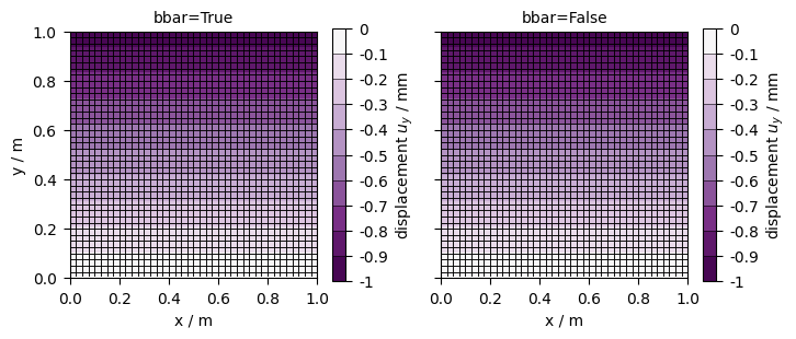

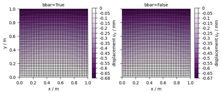

The displacement field is linear and the same in both cases:
fig = contourplots(homogeneous_compressible, u["y"])

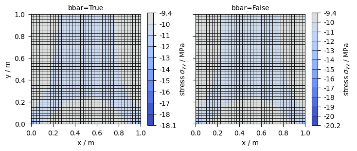

The vertical stress is constant everywhere aside from random noise.
compare_data(homogeneous_compressible, sig["yy"])
stress_yy, bbar=True:	mean=-10 megapascal	range of deviation=7.8e-13 megapascal
stress_yy, bbar=False:	mean=-10 megapascal	range of deviation=1.07e-12 megapascal
For this homogeneous problem, the solutions obtained using the B-bar method have almost the same accuracy as those obtained with the standard approach. This is confirmed by the following comparisons with the analytical solutions:

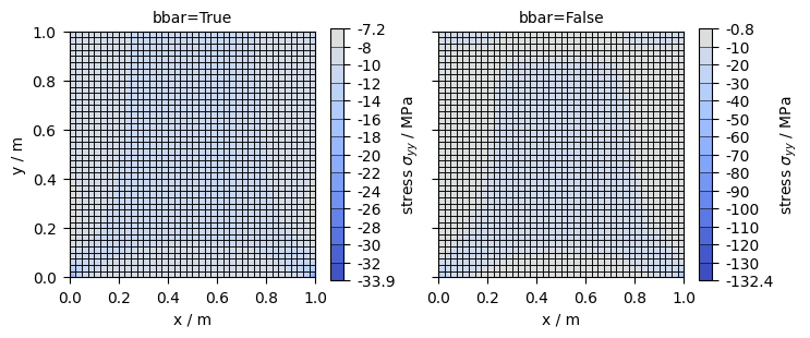

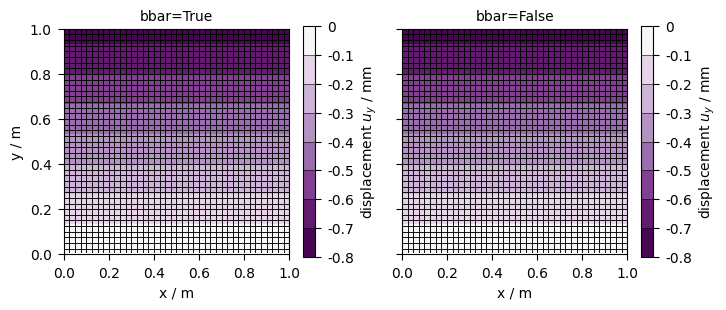

Again, the displacement field is linear and the same in both cases:
fig = contourplots(homogeneous_incompressible, u["y"])

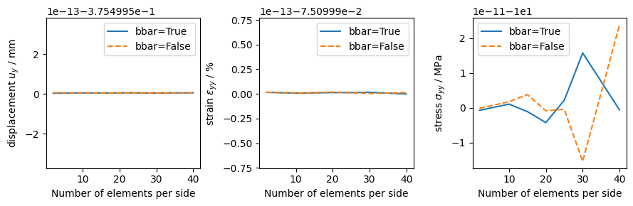

Also the vertical stress is again constant everywhere aside from random noise.
compare_data(homogeneous_incompressible, sig["yy"])
stress_yy, bbar=True:	mean=-10 megapascal	range of deviation=1.33e-10 megapascal
stress_yy, bbar=False:	mean=-10 megapascal	range of deviation=1.71e-10 megapascal

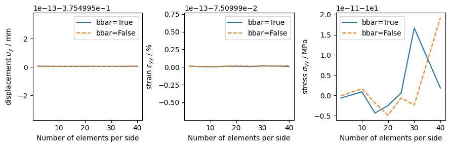

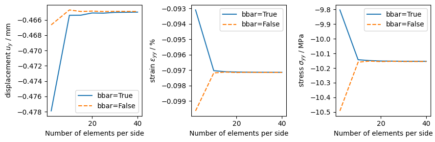

The following figure shows the vertical components of displacement, strain and stress at the center over the different discretizations. It shows, that this model, with or without the B-bar method, delivers accurate solutions and exhibits excellent mesh size independence. This reflects the fact that this test has no volumetric locking though the material is incompressible.
fig = plot_center_per_refinement(homogeneous_incompressible)
compare_with_analytical_solution(homogeneous_incompressible, nu=0.499)

In the following figures we see, that with and without the B-bar method, the variable distribution patterns look quite similar. In the bottom corners the stresses deviate from each other.
fig = contourplots(heterogeneous_compressible, u["y"])
fig = contourplots(heterogeneous_compressible, sig["yy"])

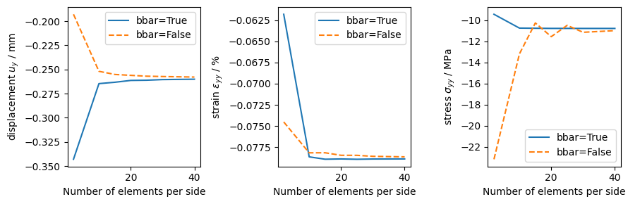

The following figure shows, that the differences in the center between the results with B-Bar and without B-bar tend to become tiny as the mesh refinement level increases.
fig = plot_center_per_refinement(heterogeneous_compressible)

In the following figures we see, that the bottom corners exhibit even stronger stress concentrations, which is slightly reduced by the B-bar method.
fig = contourplots(heterogeneous_incompressible, u["y"])
fig = contourplots(heterogeneous_incompressible, sig["yy"])
The following figure shows, that the differences in the center between the results with B-Bar and without B-bar tend to become smaller as the mesh refinement level increases, but not as much, as in the compressible model.
fig = plot_center_per_refinement(heterogeneous_incompressible)
test_center_difference_below(heterogeneous_incompressible, u["y"], (0.2, 3e-3))… (click to toggle)
test_center_difference_below(heterogeneous_incompressible, eps["yy"], (2e-2, 3e-4))
test_center_difference_below(heterogeneous_incompressible, sig["yy"], (14, 0.3))
