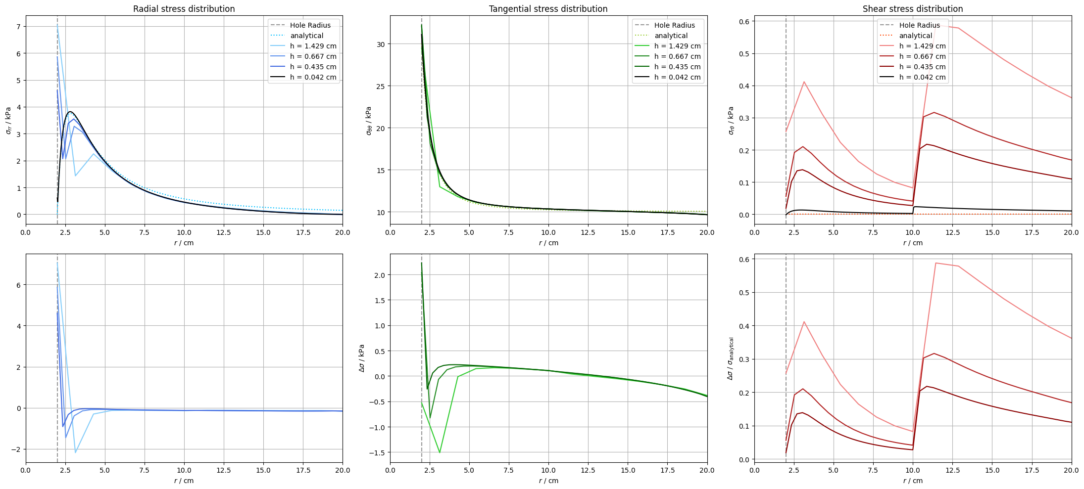

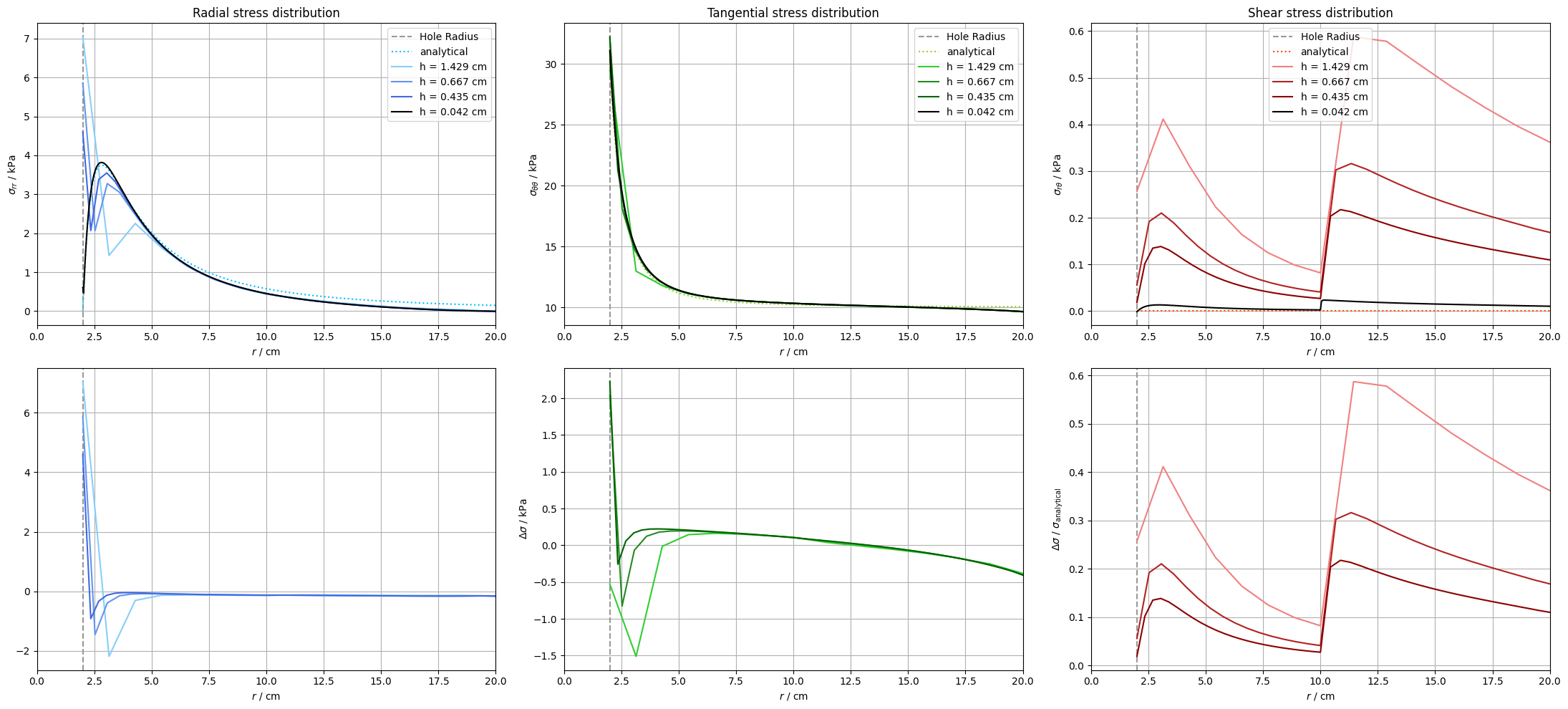

def compute_abs_and_rel_stress_error_rr(sigmas_rr_num, rs, theta_degree):
    num_points = sigmas_rr_num.shape[0]
        r = rs[pt_idx]
        sigma_rr_ana = kirsch_sig_rr(10, r, theta_degree, 2)
        sigma_rr_num = sigmas_rr_num[pt_idx] * 1000
        f_abs_rr[pt_idx] = sigma_rr_num - sigma_rr_ana
        if sigma_rr_ana == 0:
            f_rel_rr[pt_idx] = f_abs_rr[pt_idx] / sigma_rr_ana
    return f_abs_rr, f_rel_rr
def compute_abs_and_rel_stress_error_rt(sigmas_rt_num, rs, theta_degree):
    num_points = sigmas_rt_num.shape[0]
        r = rs[pt_idx]
        sigma_rt_ana = kirsch_sig_rt(10, r, theta_degree, 2)
        sigma_rt_num = sigmas_rt_num[pt_idx] * 1000
        f_abs_rt[pt_idx] = sigma_rt_num - sigma_rt_ana
        if sigma_rt_ana == 0:
            f_rel_rt[pt_idx] = f_abs_rt[pt_idx] / sigma_rt_ana
    return f_abs_rt, f_rel_rt
def compute_abs_and_rel_stress_error_tt(sigmas_tt_num, rs, theta_degree):
    num_points = sigmas_tt_num.shape[0]
        r = rs[pt_idx]
        sigma_tt_ana = kirsch_sig_tt(10, r, theta_degree, 2)
        sigma_tt_num = sigmas_tt_num[pt_idx] * 1000
        f_abs_tt[pt_idx] = sigma_tt_num - sigma_tt_ana
        if sigma_tt_ana == 0:
            f_rel_tt[pt_idx] = f_abs_tt[pt_idx] / sigma_tt_ana
    return f_abs_tt, f_rel_tt

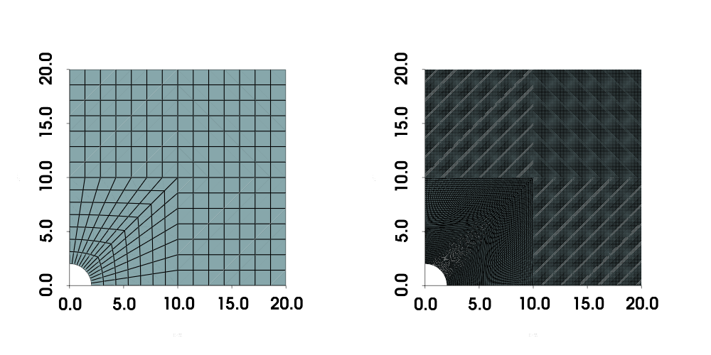

Create Gmsh meshes
To generate the meshes and to enable the individual parameters to be adjusted from within this notebook the script “mesh_quarter_of_rectangle_with_hole.py” is used. For the considered problem the parameter $a$ and $b$ which define the size of the rectangular quarter of the plate are set to a value of $20\, \text{cm}$. The radius of the central hole is controlled by the value of $r$, which is set at $r = 2\, \text{cm}$.
The arguments Nx, Ny, NR and Nr of the script describe the refinement of the mesh and are determined according to each refinement index.
Parameter $R$ describes the area for a further refinement in the vicinity of the hole. This additional refinement is needed for better capturing the stress and strain gradients near the hole. Because the fine resolution of the mesh is only needed in the area around the hole, the size of $R$ is half the size of the plate.
for idx in STUDY_indices:… (click to toggle)
    a and b seem to be the sizes of the rectangular plate,
    r the hole radius, R an auxiliary radius
    the other parameters control the mesh resolution
    please check that, and maybe document in mesh_quarter_of_rectangle_with_hole.py
    output_file = f"{out_dir}/disc_with_hole_idx_is_{idx}.msh"
    mesh_quarter_of_rectangle_with_hole.run(
        output_file,
        a=STUDY_mesh_size,
        b=STUDY_mesh_size,
        r=2,
        R=0.5 * STUDY_mesh_size,
        Nx=idx,
        Ny=idx,
        NR=idx,
        Nr=idx,
        P=1,

Visualize the meshes
To get a better sense of cell sizes and the additional refinement around the hole, the meshes of refinement indices 8 and 80 are shown below.
pv.set_plot_theme("document")
domain_8 = pv.read(… (click to toggle)
domain_8 = pv.read(
    f"{out_dir}/disc_with_hole_idx_is_8/disc_with_hole_idx_is_8_domain.vtu"
domain_80 = pv.read(
    f"{out_dir}/disc_with_hole_idx_is_80/disc_with_hole_idx_is_80_domain.vtu"
p.subplot(0, 0)
p.add_mesh(domain_8, show_edges=True, show_scalar_bar=False, color=None, scalars=None)
p.view_xy()
p.show_bounds(ticks="outside", xlabel="x / m", ylabel="y / m")
p.camera.zoom(1.3)
p.subplot(0, 1)
p.add_mesh(domain_80, show_edges=True, show_scalar_bar=False, color=None, scalars=None)
p.view_xy()
p.camera.zoom(1.3)
p.window_size = [1000, 500]
p.show()

Error Analysis
In this section we compare the numerical solution for the different refinement levels to Kirsch’s analytical solution. We show plots of the radial, tangential and shear stress distribution along the x-axis. Additionally, the absolute error of each refinement level to the analytical solution is plotted for better interpretation of variations.
The plots show that–for the considered axis–the stress distribution around the hole converges to Kirsch`s solution with decreasing size of the mesh cells. This decrease of the extrapolation errors can also be seen in the plots for the absolute error. Especially in the region close to the hole the error values for finer meshes shrink more and more.
Another effect that is particularly visible in the plots of $\sigma_{rr}$ and $\sigma_{\theta\theta}$ along the x-axis is an increasing convergence of the solutions for each refinement step to the solution for the finest mesh at the outer boundaries. The results of the numerical solution therefore do not converge against the Kirsch’s solution, but against the numerical solution itself for very fine meshes. This discrepancy is caused by the finite size of the plate in the numerical solution: Kirsch’s analytical solution assumes an infinite plate.
For this reason, an error analysis against the analytical solution does not make sense. Instead, the individual numerical solutions are compared with a “pseudo” analytical solution. For this purpose, a numerical result with extremely fine mesh resolution (refinement index = 240) is generated.

Stress distribution along the x-axis
def plot_stress_distribution_along_xaxis():… (click to toggle)
    ### Step 1: Compute data ##########################################
    # These variables will hold the error data for all STUDY_indices
    f_abs_rr = {}
    f_abs_tt = {}
    f_abs_rt = {}
    # Plot setup
    fig, ax = plt.subplots(nrows=2, ncols=3, figsize=(22, 10))
    for i in range(2):
        for j in range(3):
            ax[i][j].axvline(2, color="0.6", linestyle="--", label="Hole Radius")
            ax[i][j].grid(True)
            ax[i][j].set(xlim=(0, STUDY_mesh_size))
            ax[i][j].set_xlabel("$r$ / cm")
            ax[i][1].set_ylabel("$\\Delta\\sigma$ / kPa")
            ax[i][2].set_ylabel("$\\Delta\\sigma$ / $\\sigma_{\\mathrm{analytical}}$")
    for iteration, idx in enumerate(STUDY_indices):
        # we use the line mesh we extracted before
        line_mesh = STUDY_num_result_xaxis_meshes_by_index[idx]
        sig_rr, sig_tt, sig_rt = get_sigma_polar_components(line_mesh)
            indices_sorted,
            dist_sorted,
        ) = get_sort_indices_and_distances_by_distance_from_origin_2D(line_mesh)
        # sort sigma by distance from origin
        # compute errors
        f_abs_rr, _f_rel_rr = compute_abs_and_rel_stress_error_rr(
            sig_rr_sorted, dist_sorted, -90
        f_abs_tt, _f_rel_tt = compute_abs_and_rel_stress_error_tt(
            sig_tt_sorted, dist_sorted, -90
        f_abs_rt, _f_rel_rt = compute_abs_and_rel_stress_error_rt(
            sig_rt_sorted, dist_sorted, -90
        ### Step 2: Plot data ##############################################
        ax[0][0].set_ylabel("$\\sigma_{rr}$ / kPa")
        ax[0][1].set_ylabel("$\\sigma_{\\theta\\theta}$ / kPa")
        ax[0][2].set_ylabel("$\\sigma_{r\\theta}$ / kPa")
        # analytical results
        if iteration == 0:
            r = np.linspace(2, STUDY_mesh_size, 1000)
            ax[0][0].plot(
                r,
                kirsch_sig_rr(10, r, -90, 2),
                color="deepskyblue",
                linestyle=":",
                label="analytical",
            ax[0][1].plot(
                r,
                kirsch_sig_tt(10, r, -90, 2),
                color="yellowgreen",
                linestyle=":",
                label="analytical",
            ax[0][2].plot(
                r,
                kirsch_sig_rt(10, r, -90, 2),
                color="orangered",
                linestyle=":",
                label="analytical",
        # numerical results
        cell_size = compute_cell_size(idx, STUDY_num_result_meshes_by_index[idx])
        if idx == 8:
            ax[0][0].plot(
                dist_sorted,
                sig_rr_sorted * 1000,
                color="lightskyblue",
                label=f"h = {cell_size:.3f} cm",
            ax[0][1].plot(
                dist_sorted,
                sig_tt_sorted * 1000,
                color="limegreen",
            ax[0][2].plot(
                dist_sorted,
                sig_rt_sorted * 1000,
                color="lightcoral",
            ax[1][0].plot(dist_sorted, f_abs_rr, color="lightskyblue")
            ax[1][1].plot(dist_sorted, f_abs_tt, color="limegreen")
            ax[1][2].plot(dist_sorted, f_abs_rt, color="lightcoral")
        if idx == 16:
            ax[0][0].plot(
                dist_sorted,
                color="cornflowerblue",
            ax[0][1].plot(
                dist_sorted,
                color="forestgreen",
            ax[0][2].plot(
                dist_sorted,
                color="firebrick",
            ax[1][0].plot(dist_sorted, f_abs_rr, color="cornflowerblue")
            ax[1][1].plot(dist_sorted, f_abs_tt, color="forestgreen")
            ax[1][2].plot(dist_sorted, f_abs_rt, color="firebrick")
        if idx == 24:
            ax[0][0].plot(
                dist_sorted,
                color="royalblue",
            ax[0][1].plot(
                dist_sorted,
                color="darkgreen",
            ax[0][2].plot(
                dist_sorted,
                color="darkred",
            ax[1][0].plot(dist_sorted, f_abs_rr, color="royalblue")
            ax[1][1].plot(dist_sorted, f_abs_tt, color="darkgreen")
            ax[1][2].plot(dist_sorted, f_abs_rt, color="darkred")
        if idx == 240:
            ax[0][0].plot(
                dist_sorted,
                color="black",
            ax[0][1].plot(
                dist_sorted,
                color="black",
            ax[0][2].plot(
                dist_sorted,
                color="black",
        # final plot settings
        for i in range(3):
            ax[0][i].legend()
        ax[0][0].set_title("Radial stress distribution")
        ax[0][1].set_title("Tangential stress distribution")
        ax[0][2].set_title("Shear stress distribution")

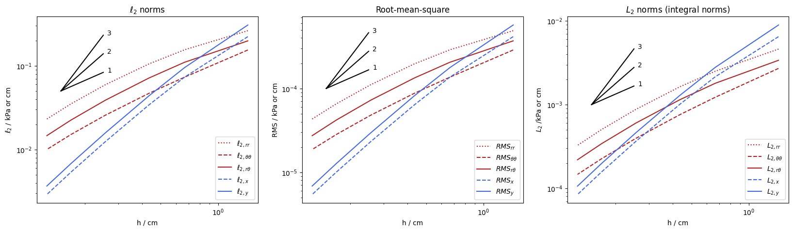

Norm Plots
To quantify the total error of a numerical calculation, various error norms can be used:
\begin{align} \ell_{2}=|w|=\sqrt{\sum_{i=0}^N (w_{i})^2} \ RMS =\sqrt{\frac{\sum_{i=0}^N (w_{i})^2}{N}} \ L_{2}=||w||=\sqrt{\int_{\Omega} (w(x))^2 dx} \end{align}
The $\ell_{2}$ norm or Euclidean norm is the square root of the sum of the squared absolute errors at each point of the mesh.
The root mean square ($RMS$) is calculated similarly. Here, however, the influence of the number of points is taken into account by dividing by the square root of the number of points.
The $L_{2}$ norm as integral norm represents a generalization of the $\ell_{2}$ norm for continuous functions. While the Euclidean norm only considers the values on individual mesh nodes, the integral norm considers the solution on the entire mesh. Therefore an advantage of the $L_{2}$ norm is, that big elements are considered with a higher impact than small ones, which produces more homogeneous results.
The following plots represent the development of the Euclidean and Integral norm and $RMS$ for the refinement of the mesh. How fast the considered element converge is expressed by the slope of the lines in the plot. First the detailed discussed error norms for the stresses are visualised and in addition to them the norms for the associated displacements to draw conclusions about the quality of convergence.
The main conclusion that can be drawn is that the solution for the displacements converge significantly faster than those for the stresses. As a practical consequence, it might be possible to get a sufficiently accurate displacement solution already on a relatively coarse mesh, whereas for an accurate stress solution a much finer mesh might be necessary.

h = np.linspace(size[80], size[8], 1000)… (click to toggle)
k = np.linspace(1, 2, 20)
fig, ax = plt.subplots(ncols=3, figsize=(20, 5))
ax[0].plot(
    size.values(),
    l2_rr.values(),
    color="firebrick",
    linestyle=":",
    label=r"$\ell_{2, rr}$",
ax[0].plot(
    size.values(),
    l2_tt.values(),
    color="firebrick",
    linestyle="--",
    label="$\\ell_{2, \\theta\\theta}$",
ax[0].plot(
    size.values(),
    l2_rt.values(),
    color="firebrick",
    label="$\\ell_{2, r\\theta}$",
ax[0].plot(
    size.values(),
    l2_x.values(),
    color="royalblue",
    linestyle="--",
    label=r"$\ell_{2, x}$",
ax[0].plot(size.values(), l2_y.values(), color="royalblue", label=r"$\ell_{2, y}$")
plot_slope_sketch(ax[0], 1.5e-1, 5e-2, [1, 2, 3], xmax=2.5e-1)
ax[0].set_title(r"$\ell_2$ norms")
ax[0].set_ylabel(r"$\ell_2$ / kPa or cm")
ax[1].plot(
    size.values(),
    rms_rr.values(),
    color="firebrick",
    linestyle=":",
    label="$RMS_{rr}$",
ax[1].plot(
    size.values(),
    rms_tt.values(),
    color="firebrick",
    linestyle="--",
    label="$RMS_{\\theta\\theta}$",
ax[1].plot(size.values(), rms_rt.values(), color="firebrick", label="$RMS_{r\\theta}$")
ax[1].plot(
    size.values(),
    rms_x.values(),
    color="royalblue",
    linestyle="--",
    label="$RMS_{x}$",
ax[1].plot(size.values(), rms_y.values(), color="royalblue", label="$RMS_{y}$")
plot_slope_sketch(ax[1], 1.5e-1, 1e-4, [1, 2, 3], xmax=2.5e-1)
ax[1].set_title("Root-mean-square")
ax[1].set_ylabel("RMS / kPa or cm")
ax[2].plot(
    size.values(),
    L2_rr.values(),
    color="firebrick",
    linestyle=":",
    label="$L_{2, rr}$",
ax[2].plot(
    size.values(),
    L2_tt.values(),
    color="firebrick",
    linestyle="--",
    label="$L_{2, \\theta\\theta}$",
ax[2].plot(size.values(), L2_rt.values(), color="firebrick", label="$L_{2, r\\theta}$")
ax[2].plot(
    size.values(),
    L2_x.values(),
    color="royalblue",
    linestyle="--",
    label="$L_{2, x}$",
ax[2].plot(size.values(), L2_y.values(), color="royalblue", label="$L_{2, y}$")
plot_slope_sketch(ax[2], 1.5e-1, 1e-3, [1, 2, 3], xmax=2.5e-1)
ax[2].set_title("$L_2$ norms (integral norms)")
ax[2].set_ylabel("$L_2$ /kPa or cm")
for i in range(3):
    ax[i].legend()
    ax[i].set_xlabel("h / cm")
    ax[i].loglog(base=10)
