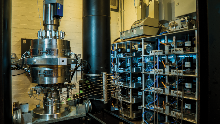

Great cell
GREAT cell facility
Figure: The GREAT cell facility.
The GREAT cell is designed to reproduce subsurface conditions in the laboratory down to a depth of 3.5 km, simulating both geomechanical stress and geothermal reservoir conditions on 200 mm diameter rock samples that contain fracture networks. This enables validation of numerical predictions under realistic conditions.
The GREAT cell represents a major advancement in experimental geomechanics technology. It uniquely:
  • Generates a truly poly-axial rotating stress field
  • Facilitates fluid flow through the rock samples
  • Employs state-of-the-art fibre-optic strain sensing for high-resolution circumferential strain measurements
  • Records fluid pressure and strain at thousands of data points per hour
This facility enhances understanding of fracture propagation and its effect on fluid flow—key factors in geo-energy applications involving fluid storage or extraction in the subsurface.

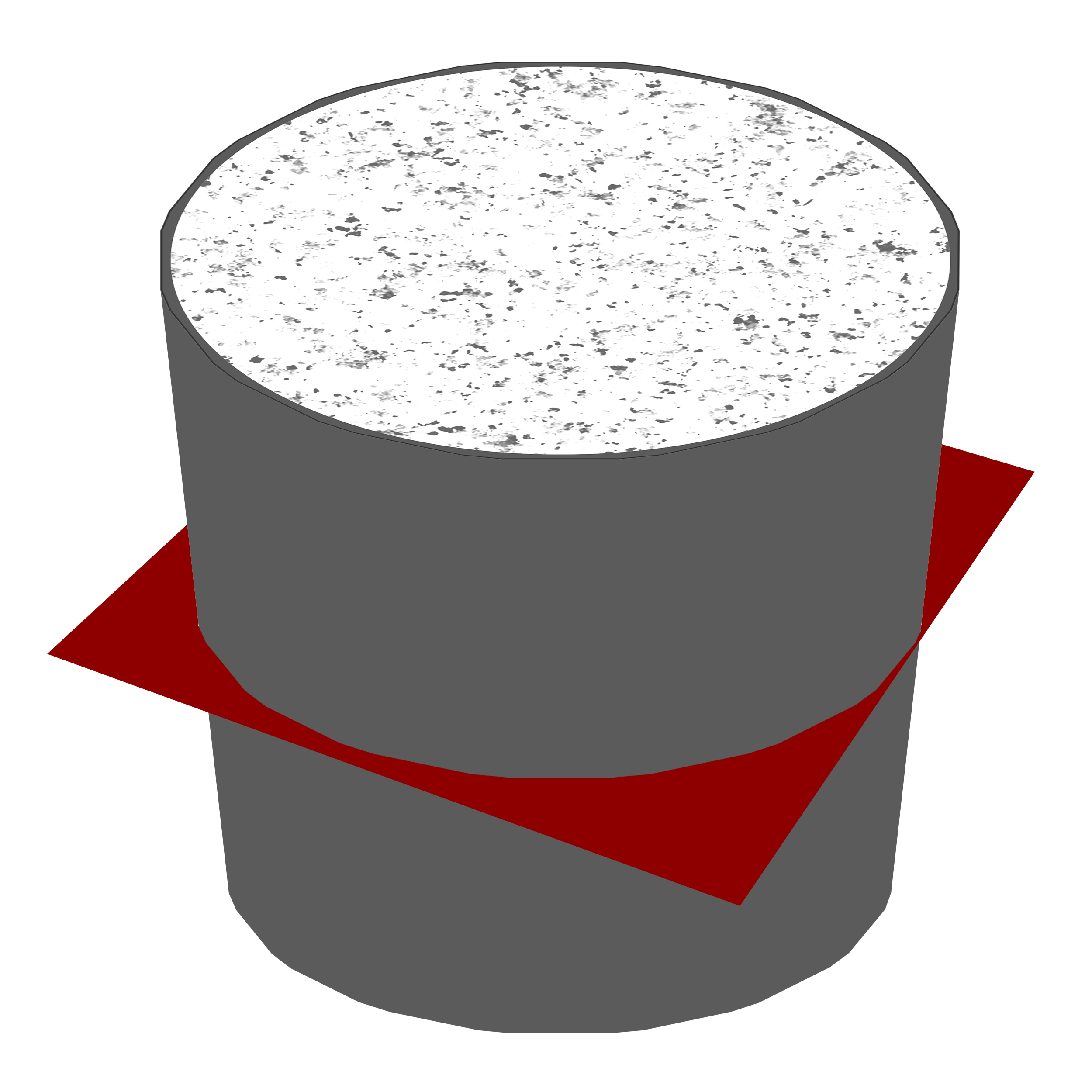

Typical rock sample
(a) Typical rock sample
Schematic cross-section
(b) Simplification for GREAT cell benchmarking
Figure: (a) Typical rock sample and (b) its simplified 3D schematic used for GREAT cell benchmarks. The cross-section (b) aligns with the 2D simulations discussed earlier.

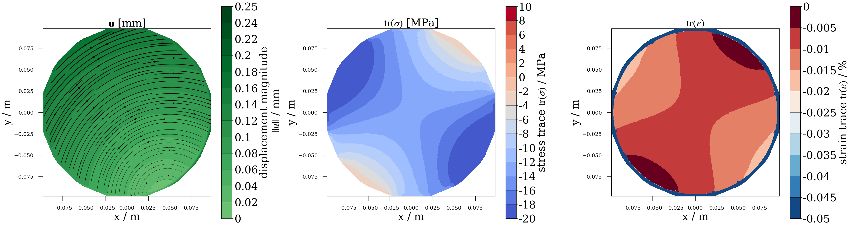

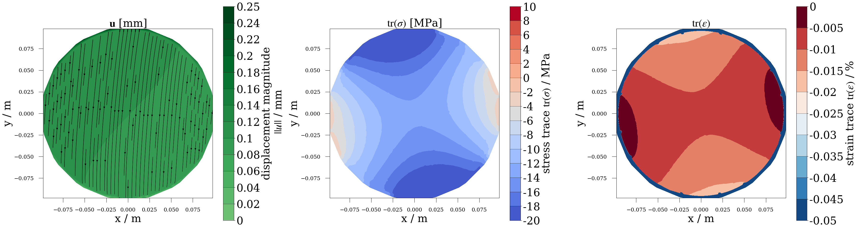

  • $\texttt{M}_1$: Intact rock sample under rotating boundary conditions.

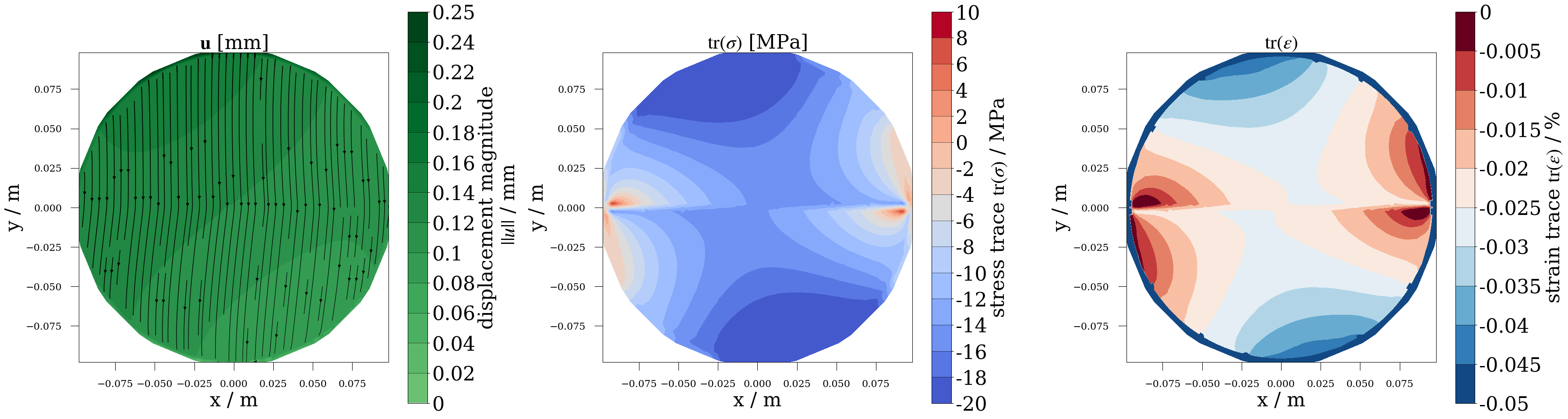

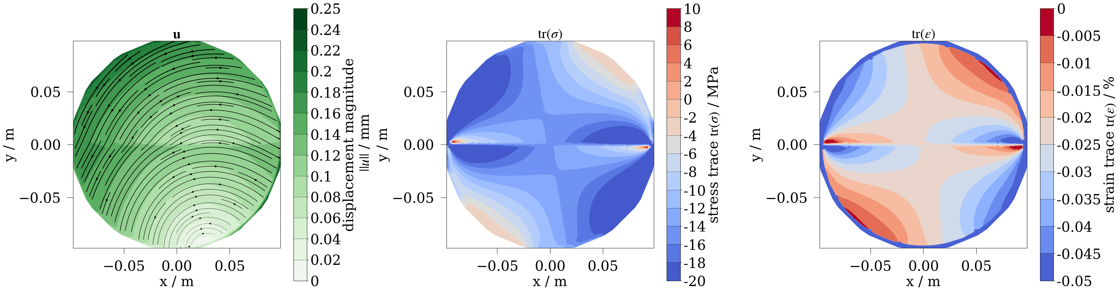

  • $\texttt{M}_{2a}$: Fully fractured sample.
  • $\texttt{M}_{2b}$: Half-fractured sample.
  • $\texttt{HM}_{2a}$: Fully fractured sample with inflow-outflow.
  • $\texttt{HM}_{2b}$: Half-fractured sample with inflow-outflow.

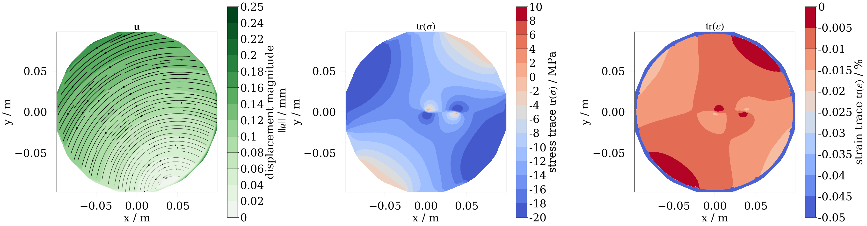

Finally, fracture propagation conditions are studied by injecting fluid into a pre-existing fracture ($\texttt{HM}_{3c}$) and by initiating a fracture from a borehole ($\texttt{HM}_{3d}$):
  • $\texttt{HM}_{3c}$: Propagation of pre-existing fracture by fluid injection.
  • $\texttt{HM}_{3d}$: Fracture nucleation from borehole by fluid injection.

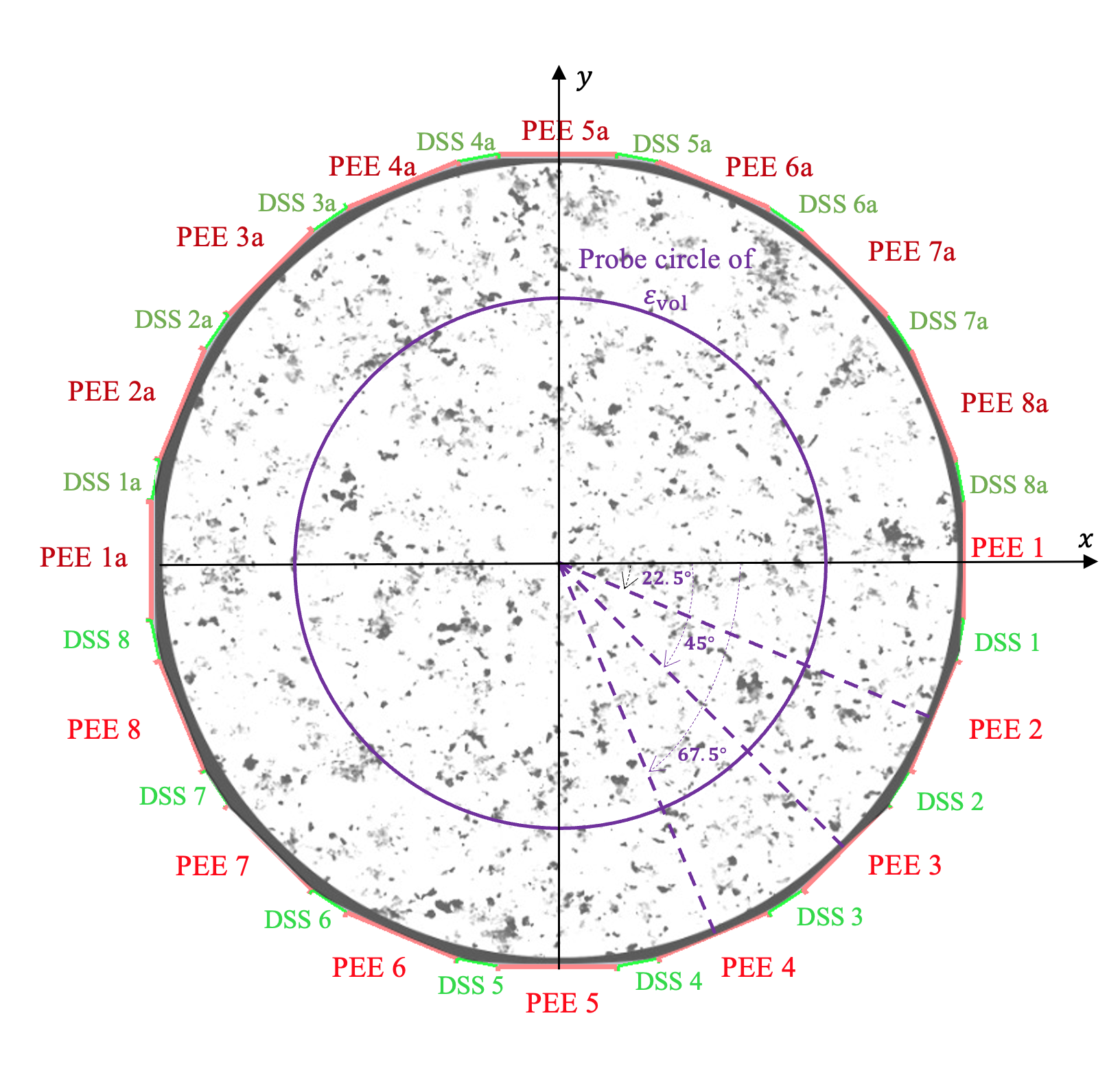

Schematic loading 2D UFZ
Figure 2:
Geometry and location of PEEs and DSSs. Fracture aligned with PEE1/1a direction.

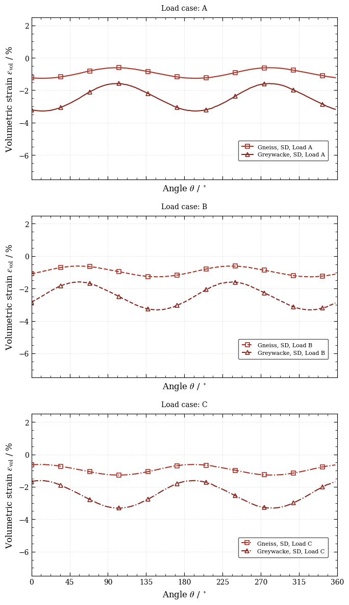

Loads
Table 2: Load Conditions
A 10.0 6.64 4.46 1.17 1.0 3.82 7.80 9.95
E 22.5° 9.95 10.0 6.64 4.46 1.17 1.0 3.82 7.80
B 45.0° 7.80 9.95 10.0 6.64 4.46 1.17 1.0 3.82
C 90° 1.0 3.82 7.80 9.95 10.0 6.64 4.46 1.17
Schematic loading conditions

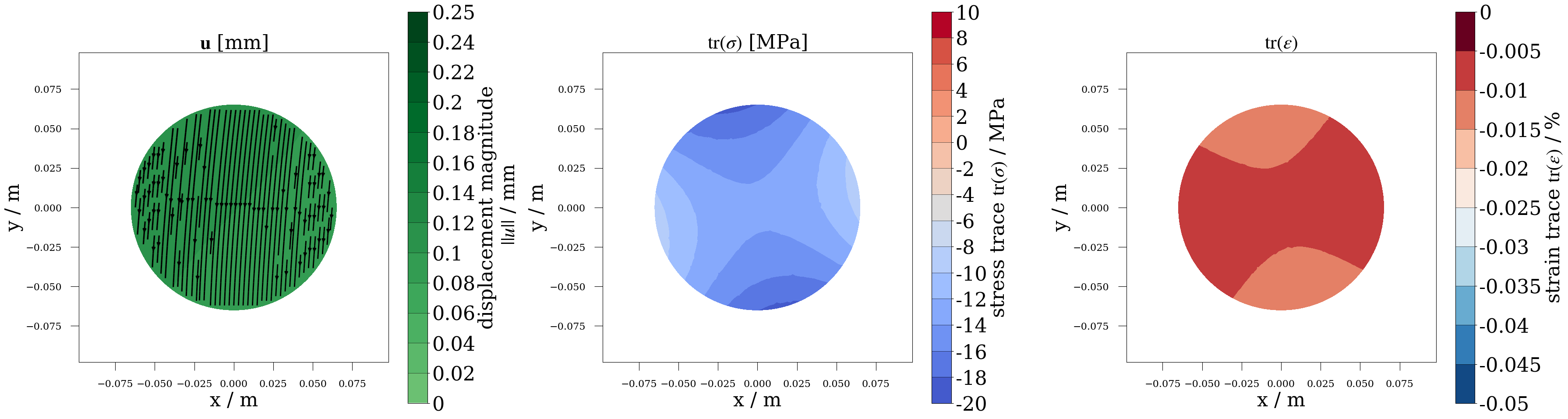

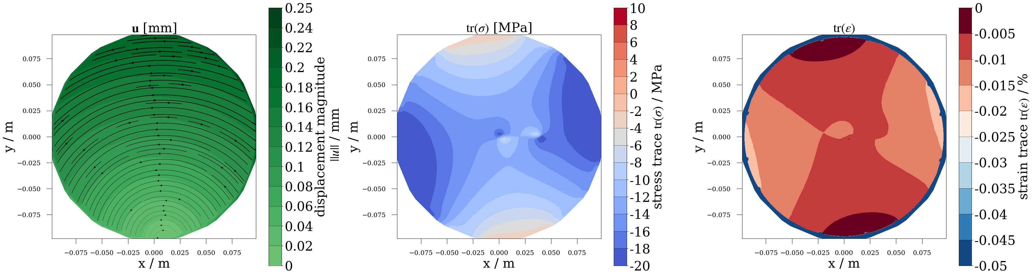

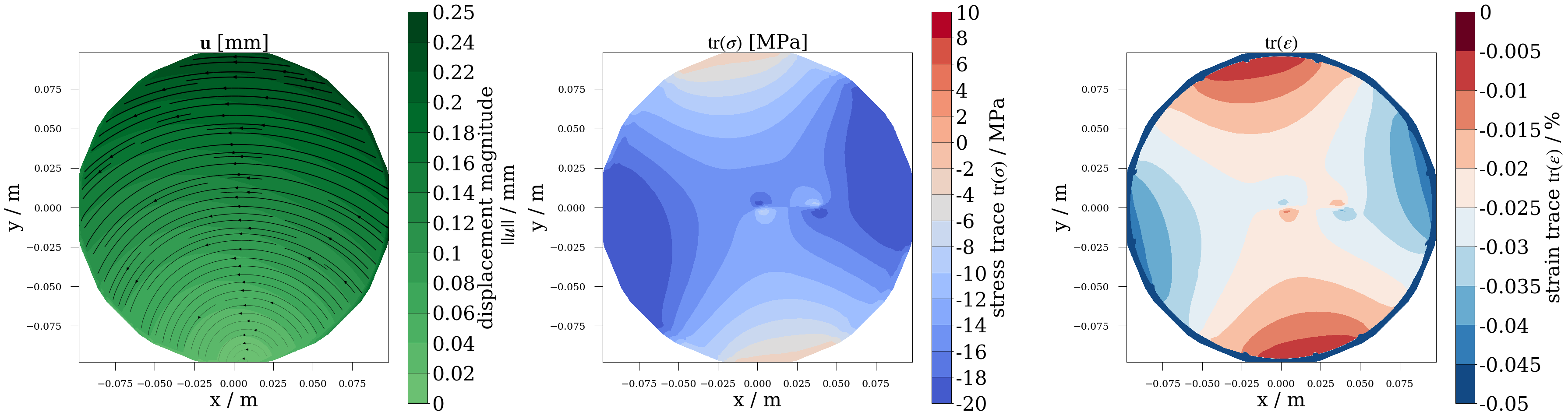

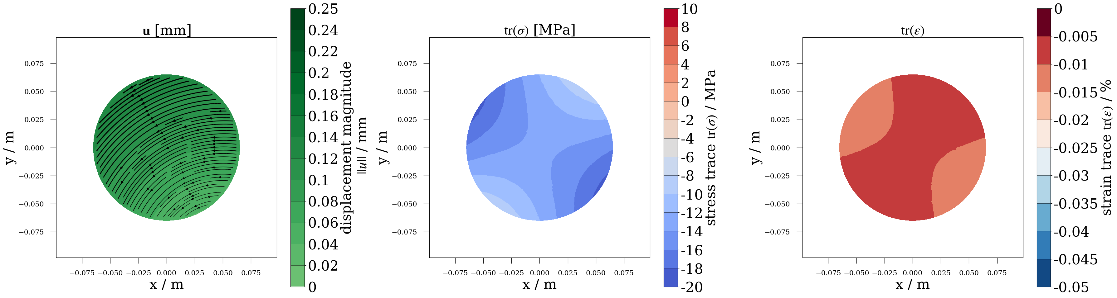

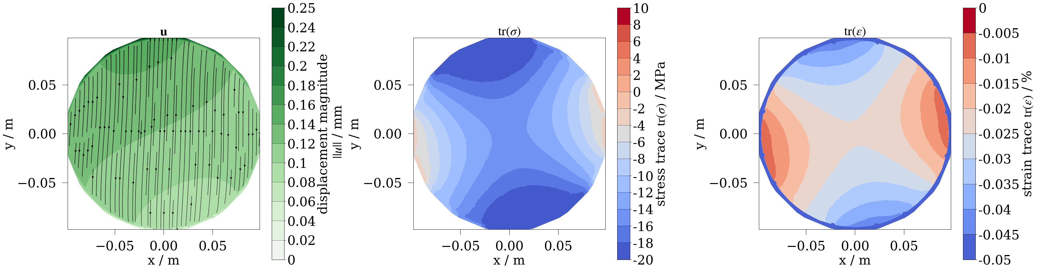

Intact Samples ($\texttt{M}_1$)
The primary objective of the first benchmark exercise is to evaluate the mechanical deformation of different rock samples in the GREAT cell under various boundary conditions in a 2D plane strain setup.
This benchmark considers a plane strain triaxial stress condition, where the in-plane principal stresses are defined as:
$$ \sigma_2 = 10\ \text{MPa},\quad \sigma_3 = 1\ \text{MPa} $$
The out-of-plane stress component, $\sigma_1$, is governed by the plane strain constraint:
$$ \sigma_1 = \nu (\sigma_2 + \sigma_3) $$
This loading condition is applied to both Greywacke and Gneiss samples (see also loading Table referenced in earlier section).

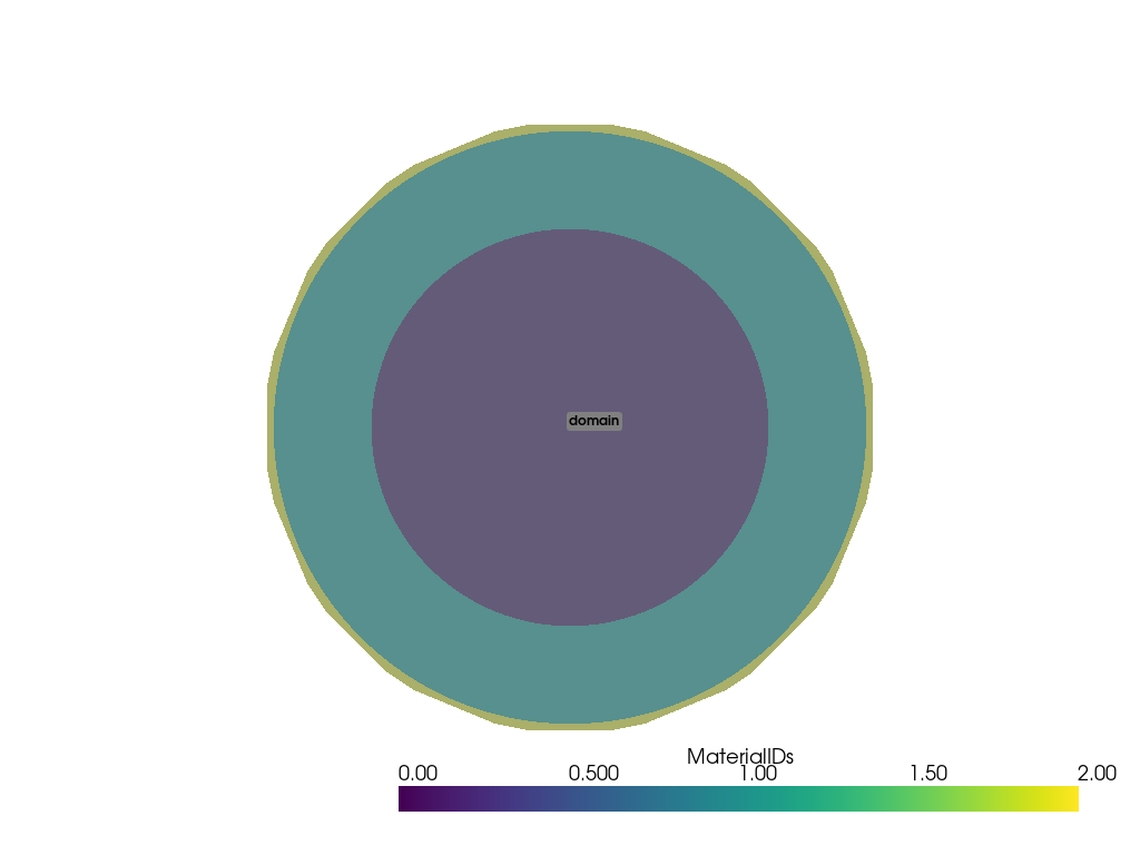

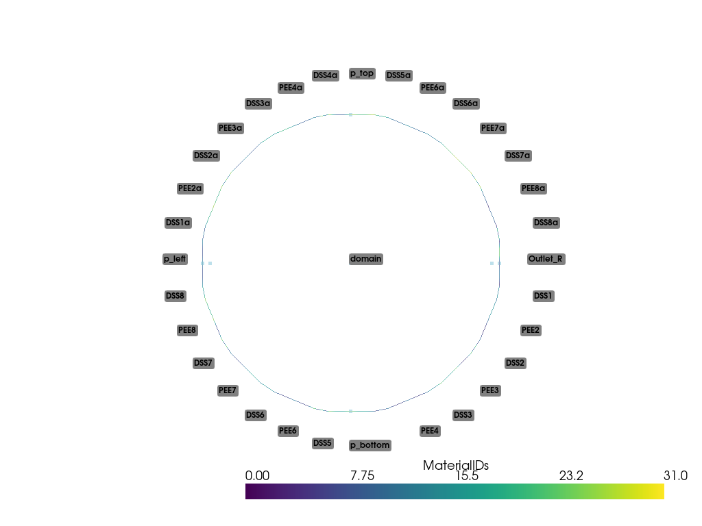

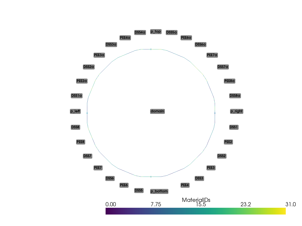

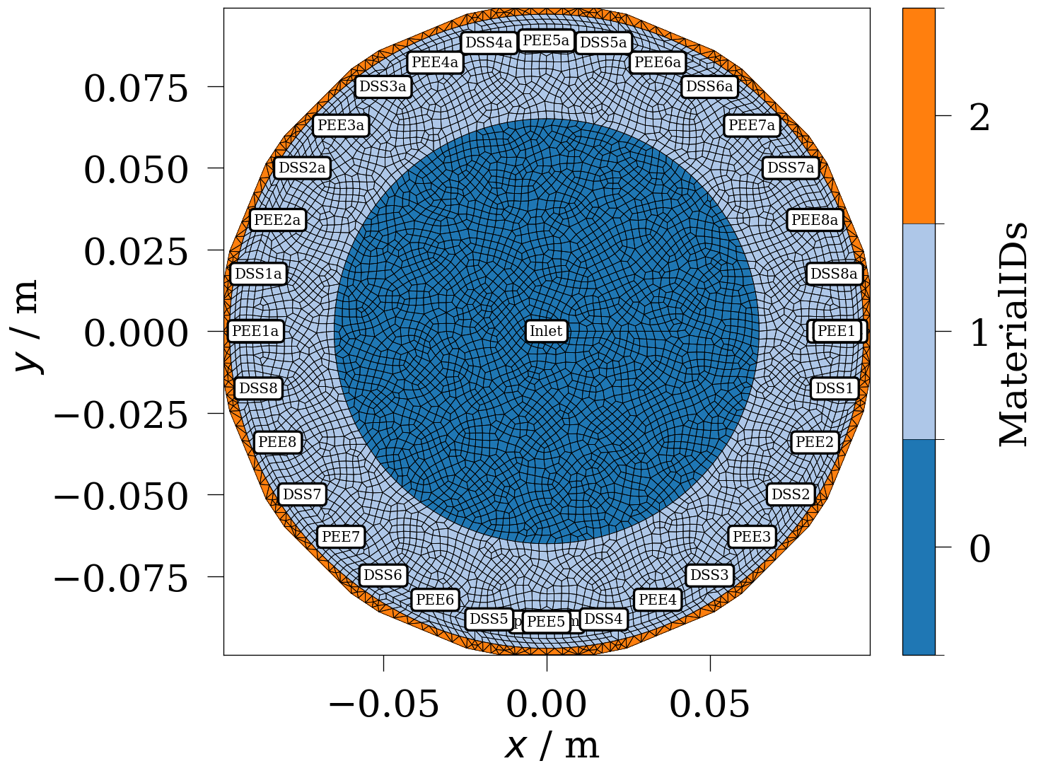

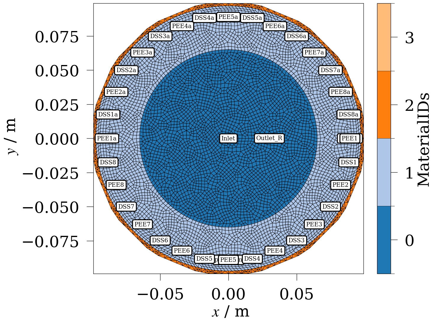

Mesh Generation
Input
h = 0.0025(click to toggle)
h = 0.0025
meshname = "GreatCell"
mesh_path = Path(out_dir, "mesh_intact").resolve()
print(mesh_path)
/var/lib/gitlab-runner/builds/vZ6vnZiU/0/ogs/build/release-all/Tests/Data/LIE/Mechanics/GreatCelljupyterNotebook/GreatCellM/mesh_intact
Boundary meshes
Gmsh (boundary meshes)
msh_file = mesh_GreatCell_intact((click to toggle)
    lc=0.005,
    lc2=h,
    r0=0.097,
    r1=0.094,
    r2=0.090,
    r3=0.065,
    out_dir=mesh_path,
    meshname=meshname,
    mode="BC",
    post_process=True,
    cmap="viridis",
    opacity=0.9,

Computational domain mesh
Gmsh
    lc=0.005,
    lc2=h,
    r0=0.097,
    r1=0.094,
    r2=0.090,
    r3=0.065,
    out_dir=mesh_path,
    meshname=meshname,
    mode="domain",
    post_process=True,
    cmap="viridis",
    opacity=0.8,

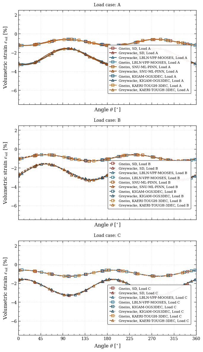

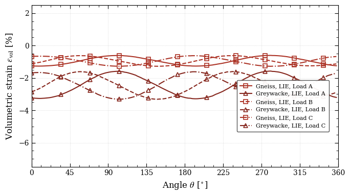

Post-processing
Volumetric strain vs angle at probe circle
json_path = Path("./external_data_dict.py").resolve()(click to toggle)
print(f"[DEBUG] Trying path: {json_path}")
if json_path.exists():
    from external_data_dict import external_data
    print("[WARNING] External data dict not found! Skipping...")
    external_data = None
plotter = Plotter(
    output_dir=out_dir,
    save_extracted_data=True,
plotter.plot_volumetric_strain_vs_angle(
    vtu_files_dict,
    model_type="M1",
    ylim_range=[-7.5, 2.5],
    layout="subplots",
    external_data=external_data,
[DEBUG] Trying path: /var/lib/gitlab-runner/builds/vZ6vnZiU/0/ogs/ogs/Tests/Data/LIE/Mechanics/GreatCelljupyterNotebook/external_data_dict.py
Profiles

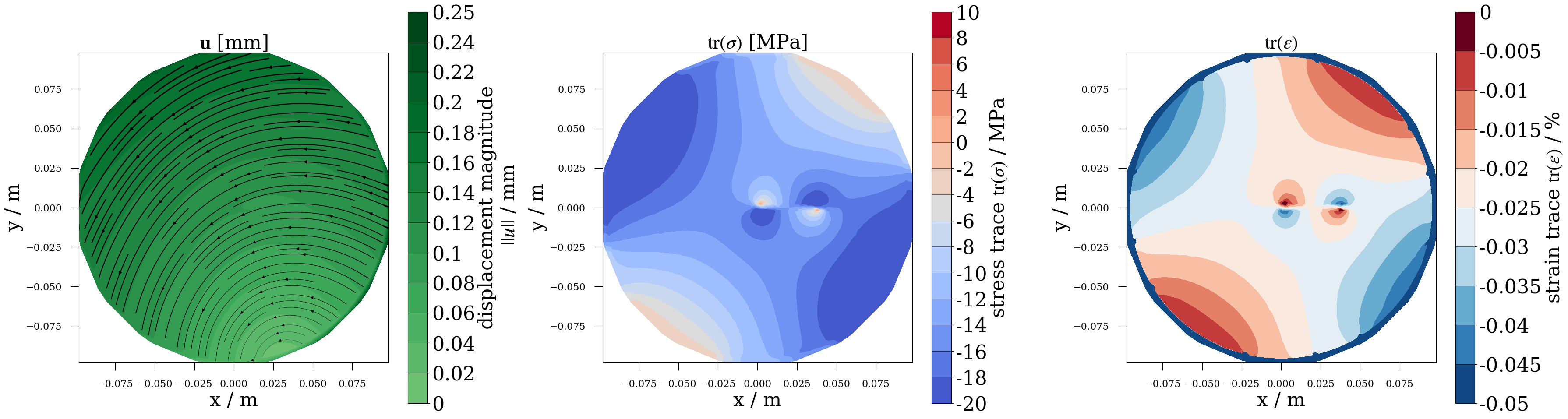

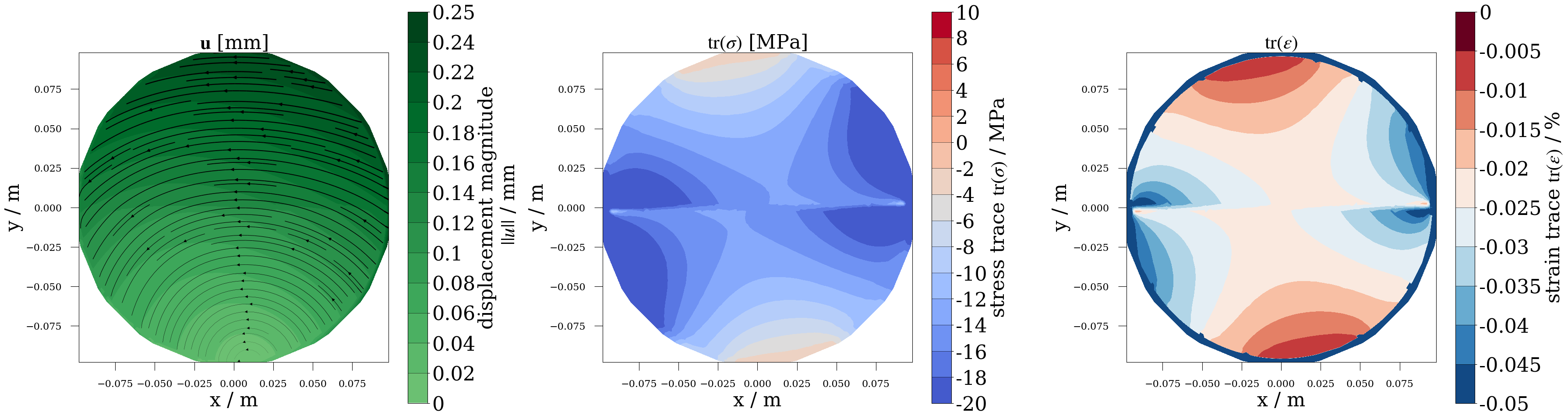

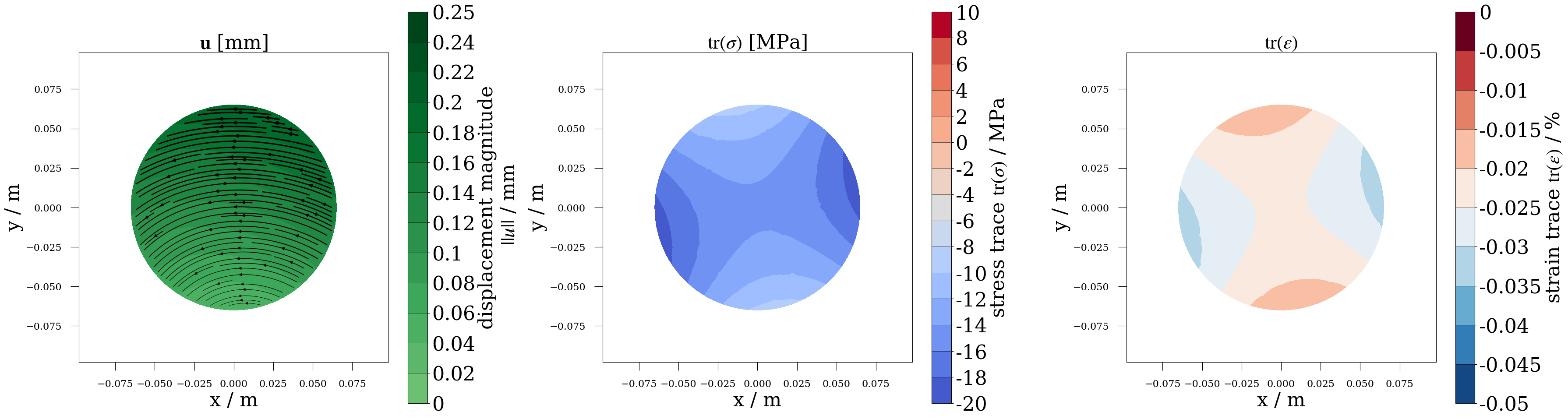

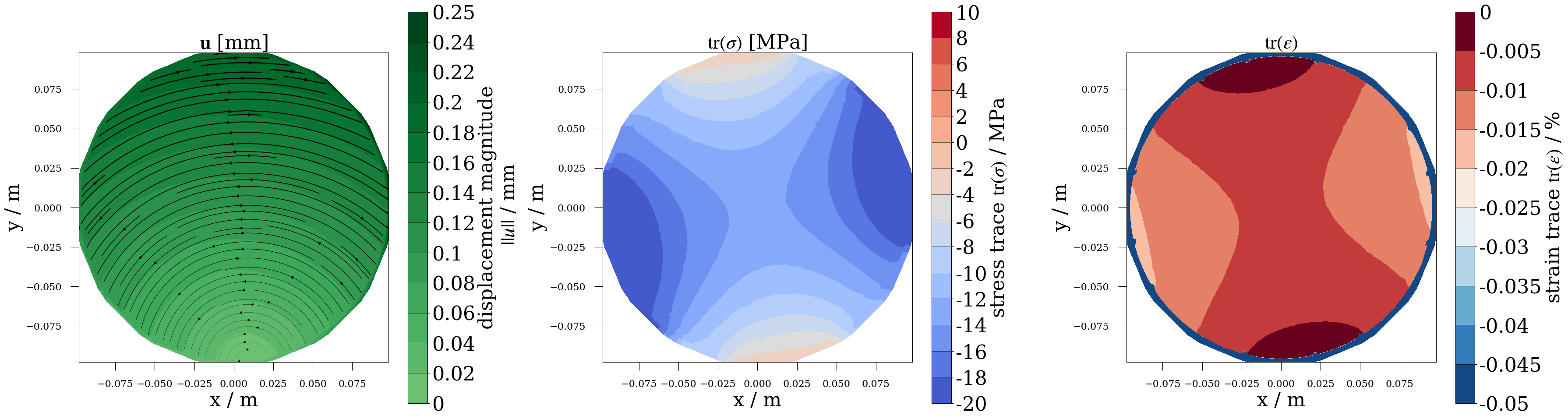

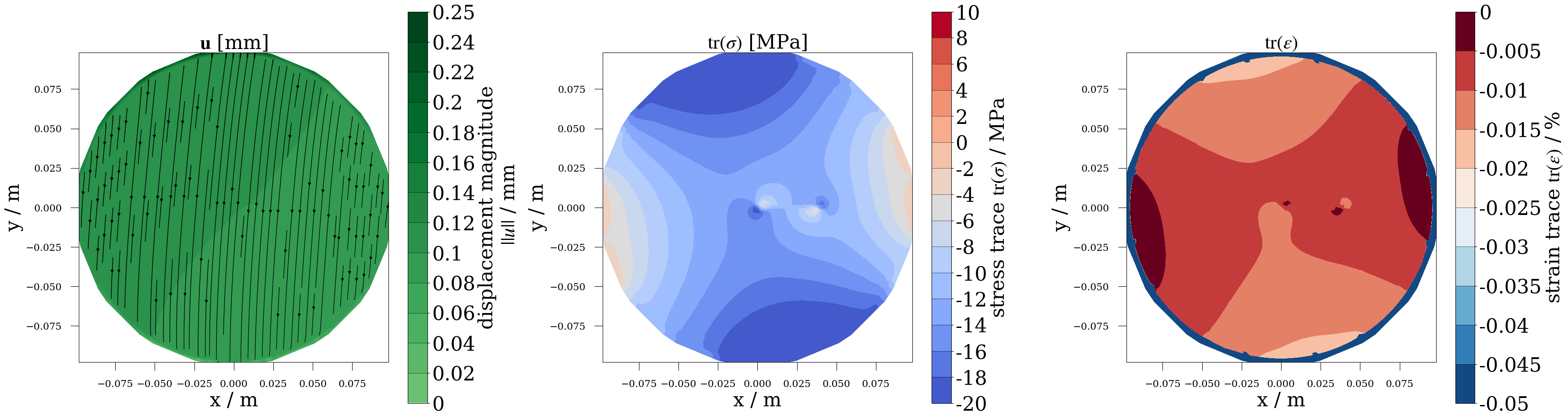

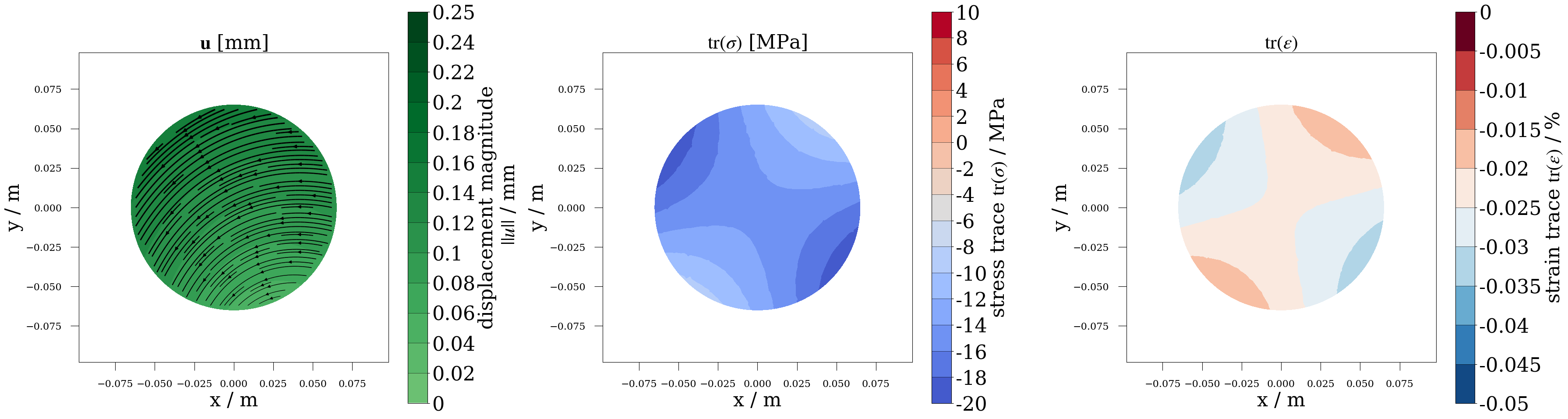

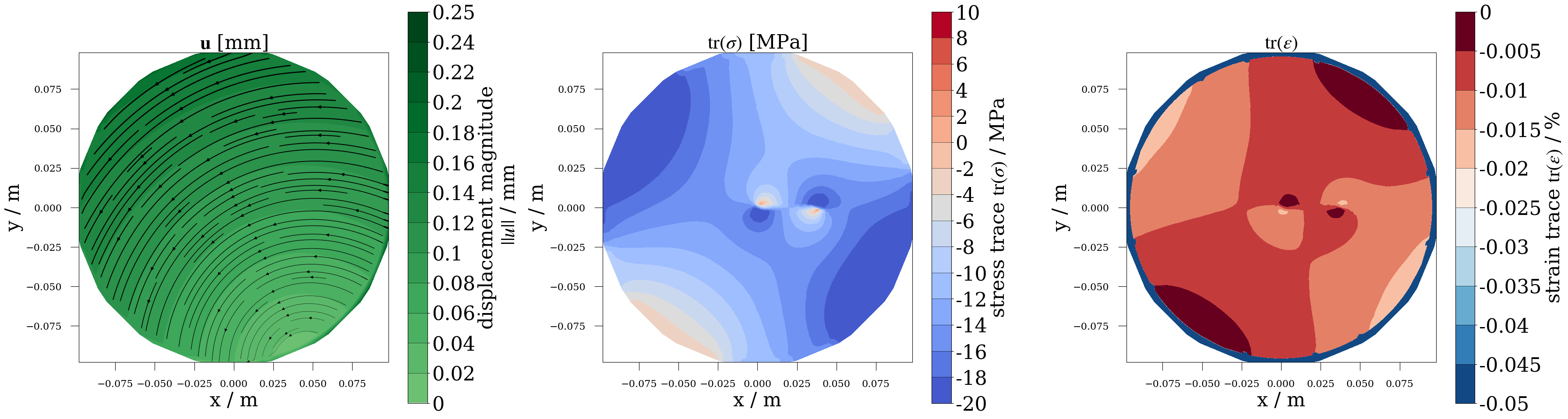

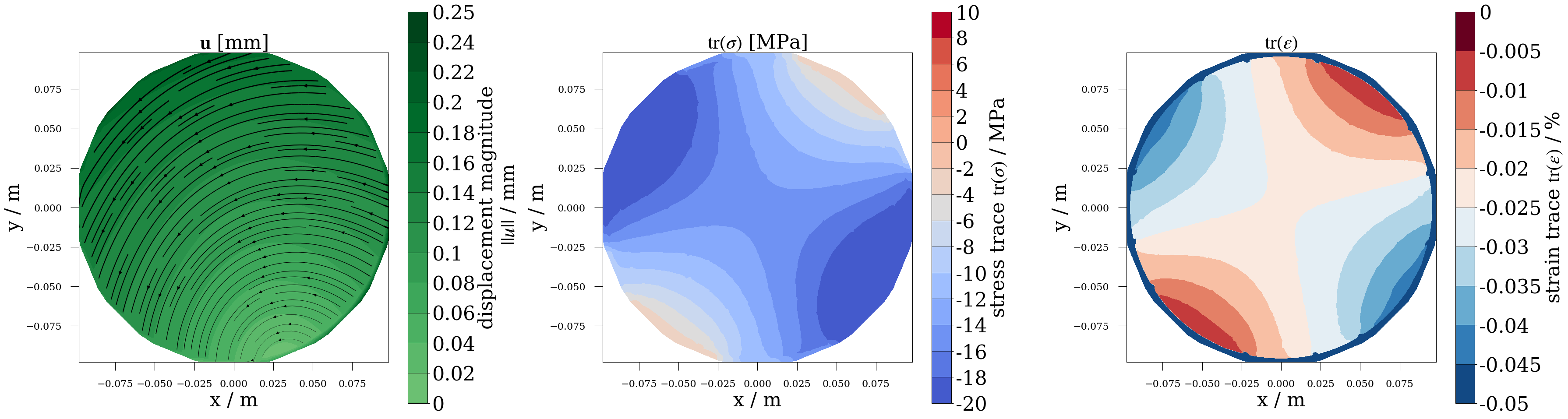

Figure below shows the results of this benchmark:
  • The trace of effective stress, defined as $\sum_{i=x,y,z} \sigma'_{ii}$,
  • and the corresponding volumetric strain plotted versus loading angle,
  • for both Greywacke and Gneiss,
These results are shown for the intact rock samples under $\texttt{M}_1$ loading.

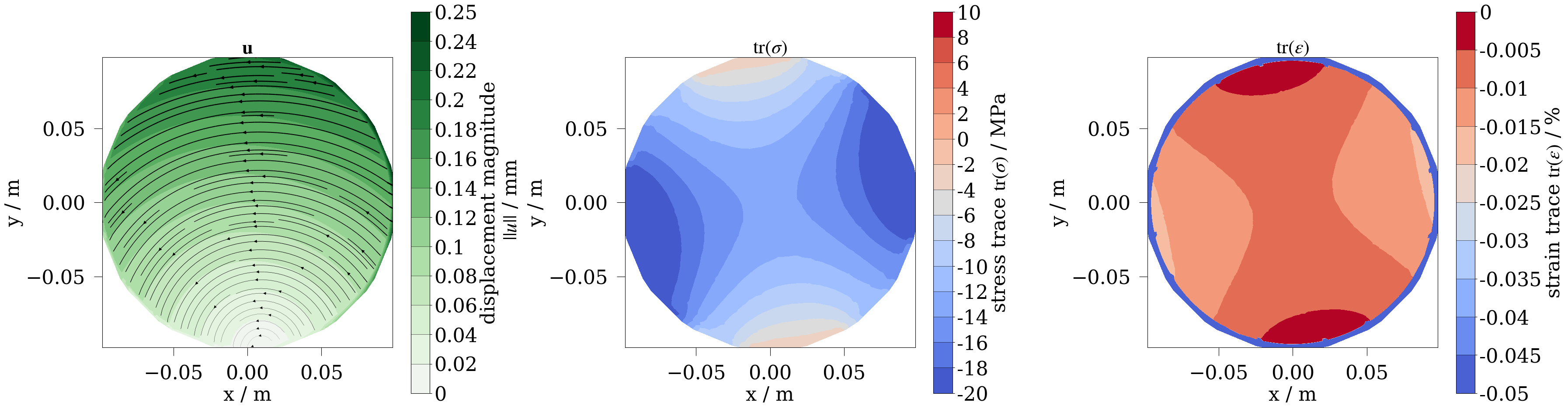

plotter.plot_field_variables(vtu_files_dict)
Load: A, File 0, Benchmark: M1, Material: Gneiss
Load: A, File 1, Benchmark: M1, Material: Greywacke
Load: B, File 0, Benchmark: M1, Material: Gneiss
Load: B, File 1, Benchmark: M1, Material: Greywacke
Load: C, File 0, Benchmark: M1, Material: Gneiss
Load: C, File 1, Benchmark: M1, Material: Greywacke
Note: The stress distribution and volumetric strain are shown only in the central zone defined by:
$$ \sqrt{x^2 + y^2} < 0.065\ \text{m} $$
This is done because strain is relatively high in the PEE regions (due to their softer material properties), and we want to isolate the deformation behavior within the core of the sample.
# Plot only inner mesh (within r=0.065 m):
plotter.plot_field_variables(vtu_files_dict, inner=True, r=0.065)

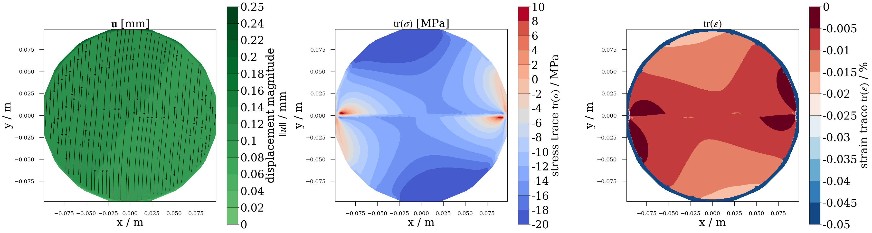

Half fractured sample ($\texttt{M}_{2b}$)
In this section, all input data and boundary conditions provided in $\texttt{M}_{2b}$, except a single wing fracture, defined as $\Gamma = \left[0, 0.04\right] \times \{0\}$, is considered.
Mesh Generation
Input
h = 0.0025
mesh_path_embedded = Path(out_dir, "mesh_GreatCell_embeddedFracture").resolve()
Boundary meshes
msh_file_embedded = mesh_GreatCell_embeddedFracture((click to toggle)
    lc=0.005,
    lc2=h,
    r0=0.097,
    r1=0.094,
    r2=0.090,
    r3=0.065,
    out_dir=mesh_path_embedded,
    meshname=meshname,
    mode="BC",
    post_process=True,
    cmap="viridis",
    opacity=0.8,
Gmsh (computational domain mesh)
msh_file_volume_embedded = mesh_GreatCell_embeddedFracture((click to toggle)
    lc=0.005,
    lc2=h,
    r0=0.097,
    r1=0.094,
    r2=0.090,
    r3=0.065,
    meshname=meshname,
    mode="domain",
    post_process=True,
    cmap="viridis",
    opacity=0.8,

Run the simulation
Input
# Times for load curves(click to toggle)
times = "0.0  1000. 3500"
simulation_end_time = 3500.0
n_fracture_p_ncs = 3
model_type = "M2b"
output_prefix = "M2b_LIE"
# Load
PEE_load_values = {
# Project file
prj_file = Path("M2_LIE.prj")
prj = ot.Project(input_file=prj_file, output_file=Path(out_dir, f"{output_prefix}.prj"))
Run OGS
sing_ogs_model = SingleOGSModel((click to toggle)
    model=prj,
    out_dir=out_dir,
    mesh_path=mesh_path_embedded,
    output_prefix=output_prefix,
    method="LIE",
    model_type=model_type,
    materials=materials,
vtu_files_dict_embedded = sing_ogs_model.run_simulations_with_fracture(
    times=times,
    base_project_file=prj_file,
    load_cases=PEE_load_values,
    out_dir=out_dir,
    use_b_bar_value="true",
    tension_cutoff="true",
mesh path: /var/lib/gitlab-runner/builds/vZ6vnZiU/0/ogs/build/release-all/Tests/Data/LIE/Mechanics/GreatCelljupyterNotebook/GreatCellM/mesh_GreatCell_embeddedFracture
[DEBUG] Current working directory: /var/lib/gitlab-runner/builds/vZ6vnZiU/0/ogs/ogs/Tests/Data/LIE/Mechanics/GreatCelljupyterNotebook
[DEBUG] output project file: /var/lib/gitlab-runner/builds/vZ6vnZiU/0/ogs/build/release-all/Tests/Data/LIE/Mechanics/GreatCelljupyterNotebook/GreatCellM/M2b_LIE.prj
[DEBUG] output project file: /var/lib/gitlab-runner/builds/vZ6vnZiU/0/ogs/build/release-all/Tests/Data/LIE/Mechanics/GreatCelljupyterNotebook/GreatCellM/M2b_LIE_A.prj
Running simulation for load case: A with method: LIE, tension_cutoff: true
Simulation: /var/lib/gitlab-runner/builds/vZ6vnZiU/0/ogs/build/release-all/Tests/Data/LIE/Mechanics/GreatCelljupyterNotebook/GreatCellM/M2b_LIE_A.prj
Execution took 13.041065216064453 s
* Running the simulation for sample Greywacke:
Execution took 14.940980434417725 s
[DEBUG] output project file: /var/lib/gitlab-runner/builds/vZ6vnZiU/0/ogs/build/release-all/Tests/Data/LIE/Mechanics/GreatCelljupyterNotebook/GreatCellM/M2b_LIE_B.prj
Running simulation for load case: B with method: LIE, tension_cutoff: true
Simulation: /var/lib/gitlab-runner/builds/vZ6vnZiU/0/ogs/build/release-all/Tests/Data/LIE/Mechanics/GreatCelljupyterNotebook/GreatCellM/M2b_LIE_B.prj
Execution took 13.907129049301147 s
Execution took 18.714593410491943 s
[DEBUG] output project file: /var/lib/gitlab-runner/builds/vZ6vnZiU/0/ogs/build/release-all/Tests/Data/LIE/Mechanics/GreatCelljupyterNotebook/GreatCellM/M2b_LIE_C.prj
Running simulation for load case: C with method: LIE, tension_cutoff: true
Simulation: /var/lib/gitlab-runner/builds/vZ6vnZiU/0/ogs/build/release-all/Tests/Data/LIE/Mechanics/GreatCelljupyterNotebook/GreatCellM/M2b_LIE_C.prj
Execution took 23.55478572845459 s
Execution took 27.83884358406067 s

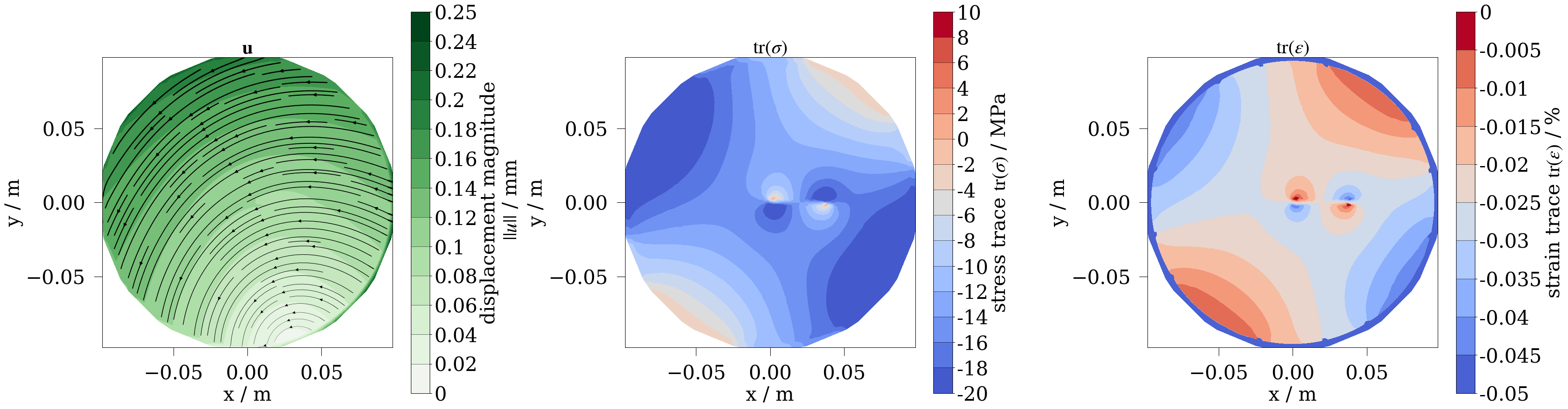

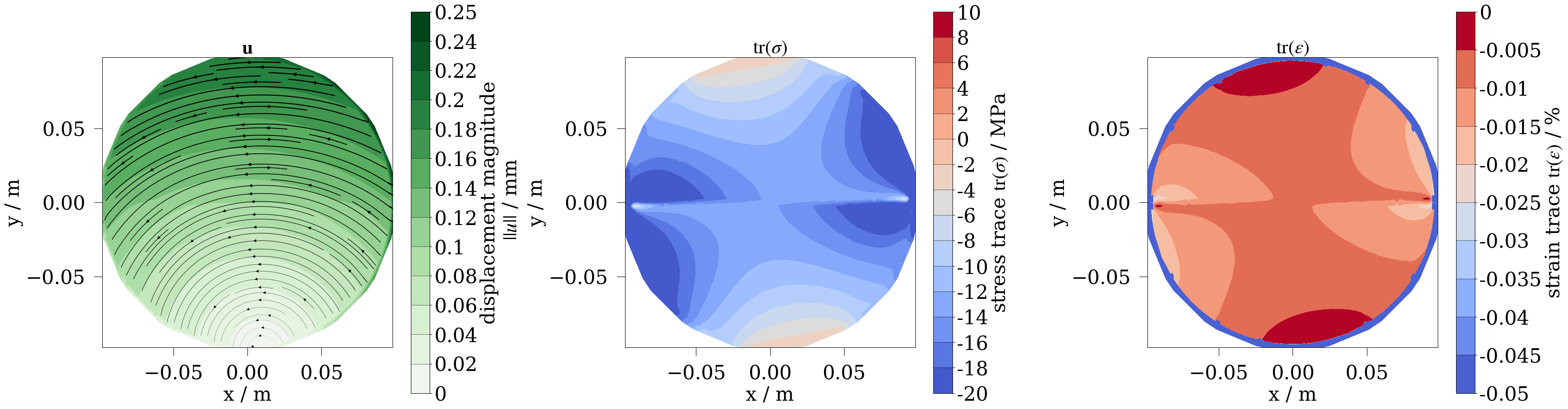

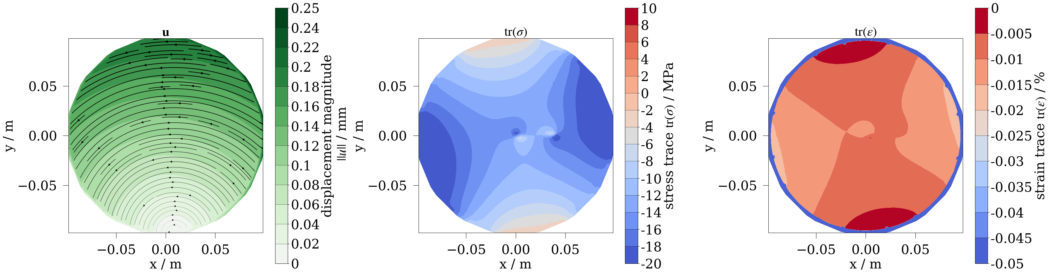

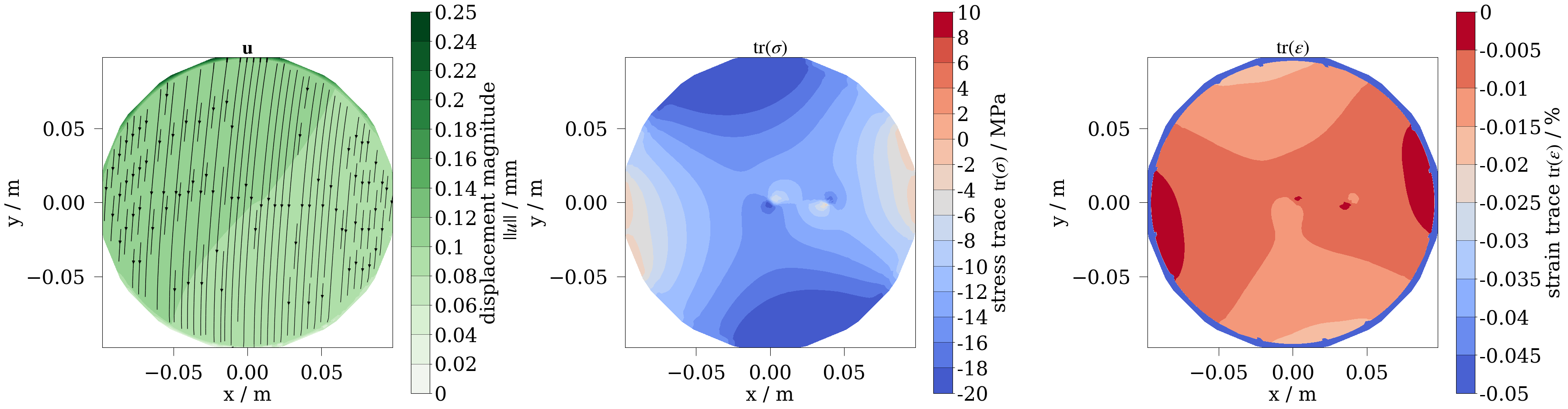

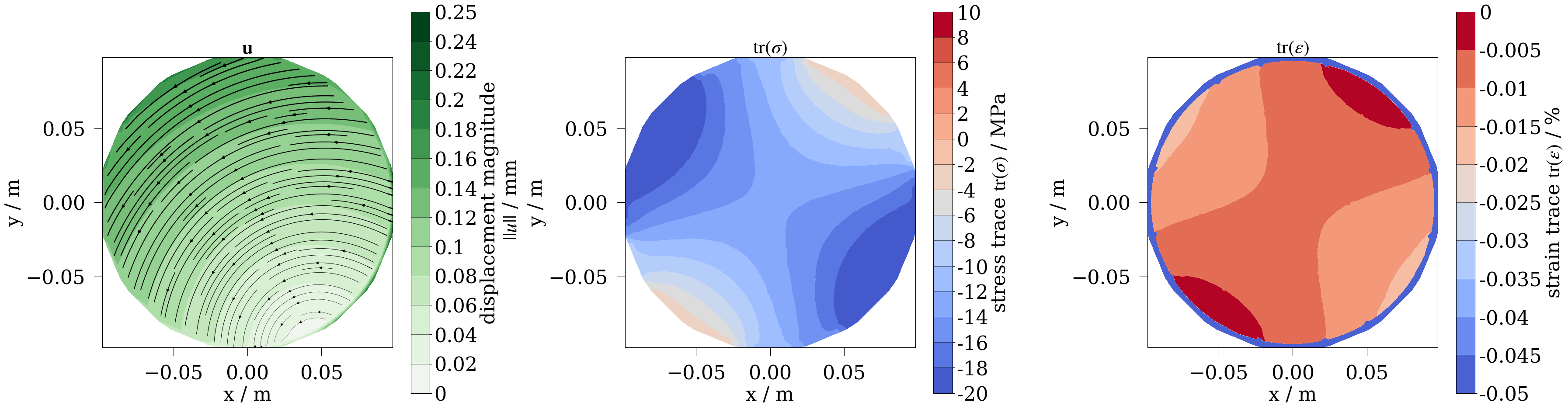

Post-processing
plotter = Plotter((click to toggle)
plotter = Plotter(
    output_dir=out_dir,
    vtu_files_dict_embedded,
    model_type="M2b",
    layout="single",
Profiles
plotter.plot_field_variables(vtu_files_dict_embedded)
Load: A, File 0, Benchmark: M2b, Material: Gneiss
Load: A, File 1, Benchmark: M2b, Material: Greywacke
Load: B, File 0, Benchmark: M2b, Material: Gneiss
Load: B, File 1, Benchmark: M2b, Material: Greywacke
Load: C, File 0, Benchmark: M2b, Material: Gneiss
Load: C, File 1, Benchmark: M2b, Material: Greywacke

Mesh Generation
Input
h = 0.0025
mesh_path_full = Path(".", out_dir, "mesh_GreatCell_fullFracture").resolve()
Boundary meshes
msh_file_full = mesh_GreatCell_fullFracture((click to toggle)
    lc=0.005,
    lc2=h,
    r0=0.097,
    r1=0.094,
    r2=0.090,
    r3=0.065,
    out_dir=mesh_path_full,
    meshname=meshname,
    mode="BC",
    post_process=True,
    cmap="viridis",
    opacity=0.8,
    lc=0.005,
    lc2=h,
    r0=0.097,
    r1=0.094,
    r2=0.090,
    r3=0.065,
    meshname=meshname,
    mode="domain",
    post_process=True,
    cmap="viridis",
    opacity=0.8,
Info    : Meshing 1D...

Post-processing
plotter = Plotter(
    output_dir=out_dir,
    vtu_files_dict_full,
    model_type="M2a",
    layout="subplots",
Profiles

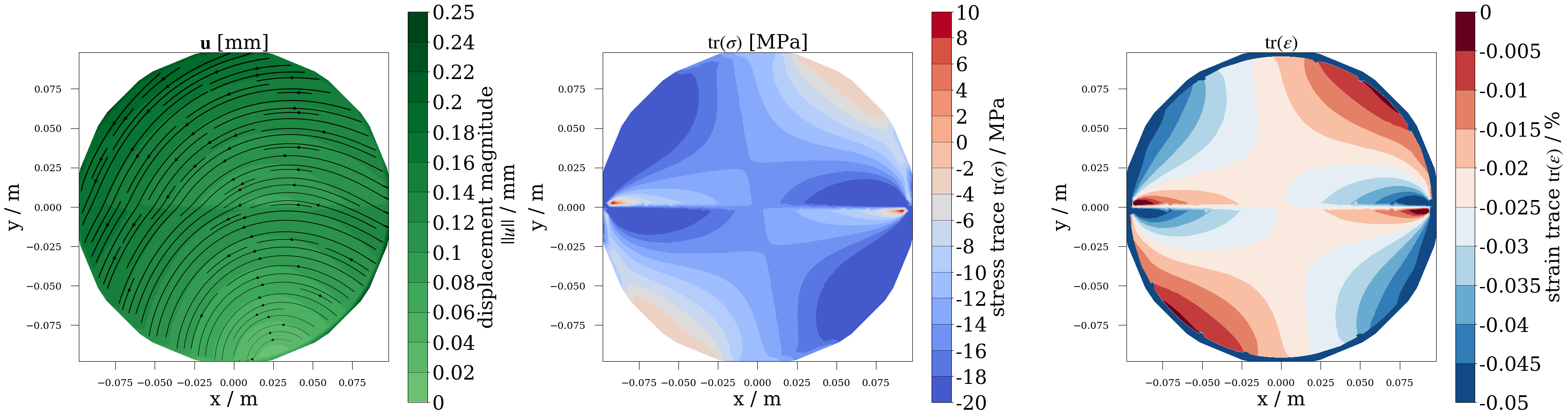

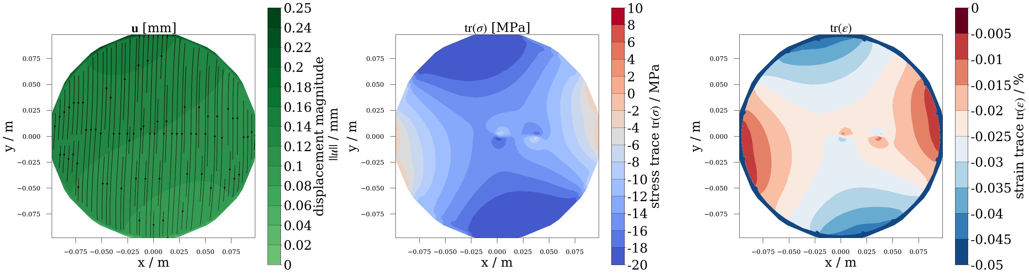

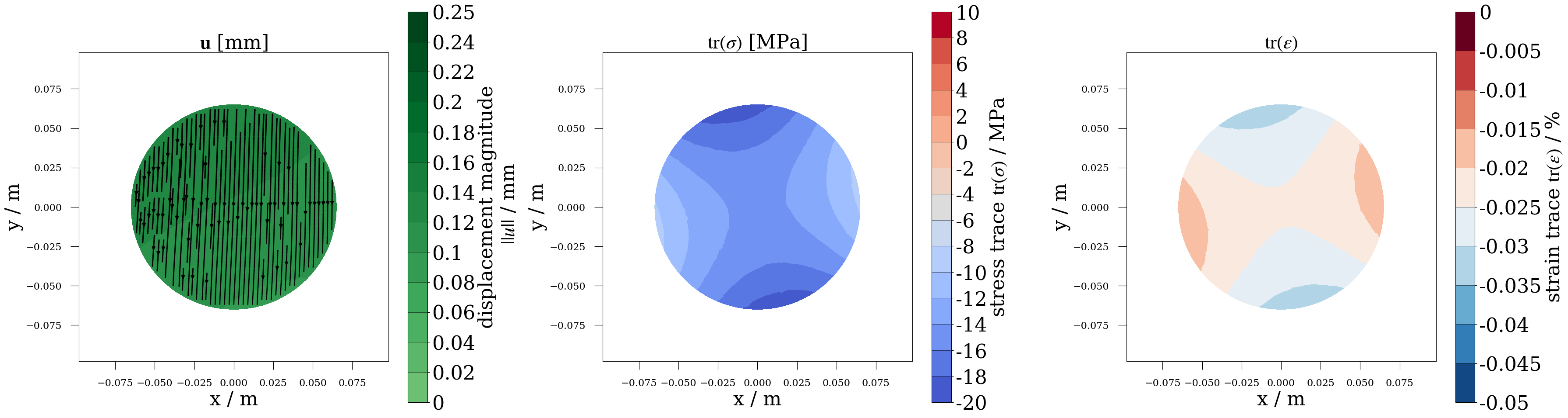

plotter.plot_field_variables(vtu_files_dict_full)
Load: A, File 0, Benchmark: M2a, Material: Gneiss
Load: A, File 1, Benchmark: M2a, Material: Greywacke
Load: B, File 0, Benchmark: M2a, Material: Gneiss
Load: B, File 1, Benchmark: M2a, Material: Greywacke
Load: C, File 0, Benchmark: M2a, Material: Gneiss

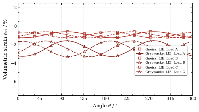

Load: C, File 1, Benchmark: M2a, Material: Greywacke
pairs_to_check = {(click to toggle)
pairs_to_check = {
    "M1_SD_A_Greywacke": "M1",
    "M2a_LIE_A_Greywacke": "M2a",
    "M2b_LIE_A_Greywacke": "M2b",
for case, label in pairs_to_check.items():
    print(f"\n===== {label} case =====")
    new_result = np.load(Path(out_dir, f"extracted_{case}_volStrain.npz"))
    expected_result = np.load(Path("expected", f"extracted_{case}_volStrain.npz"))
    eps_v_new = new_result["eps_v"]
    eps_v_expected = expected_result["eps_v"]
    phi_new = new_result["phi"]
    phi_expected = expected_result["phi"]
    np.testing.assert_allclose(eps_v_new, eps_v_expected, atol=1e-3)
    np.testing.assert_allclose(phi_new, phi_expected, atol=1e-8)
    print(f"\n{label} case passed.")
===== M1 case =====
M1 case passed.
===== M2a case =====
M2a case passed.
===== M2b case =====
M2b case passed.
