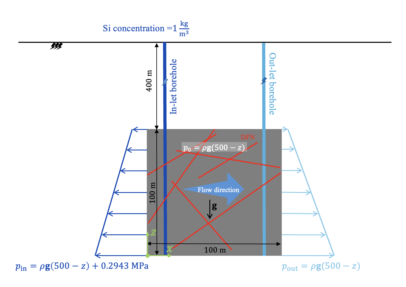

Protecting the environment over geological timescales requires isolating hazardous substances (e.g., radionuclides and industrial chemicals) from the biosphere. Accurate prediction of solute transport is essential for the safe design of deep geological repositories and for long-term groundwater contamination protection.
Natural retention processes — matrix diffusion and sorption — serve as critical barriers that delay contaminant migration, helping to prevent their spread through the environment.
Matrix Diffusion: The movement of solutes from regions of high to low concentration within a solid matrix, governed by concentration gradients and diffusion coefficients.
Sorption: The process by which solutes are retained on or in a solid, encompassing adsorption (solutes attaching to the surface) and absorption (solutes entering the solid matrix). This process is influenced by surface chemistry, solute properties, and environmental conditions, and is quantified by the distribution coefficient.
Tracer tests are a primary method for investigating subsurface solute transport and retention. In these experiments, a known tracer is injected into the formation, and its concentration is monitored over time at a recovery location.
Different tracers are used to isolate transport mechanisms:
In crystalline rock formations, groundwater flow occurs primarily through discrete fracture networks (DFN), as the rock matrix itself exhibits low permeability. DFN models simulate flow and solute migration by treating fractures as discrete hydraulic features.
To investigate solute transport and retention in fractured rocks, a DFN is generated using
PorePy with stochastic fracture placement algorithms.
The resulting DFN geometry is processed through OGSTools to create OpenGeoSys
(OGS)-compatible input files, enabling the setup and execution of a Hydro-Component (HC) simulation for
flow and solute transport, and retention in realistic fractured media.

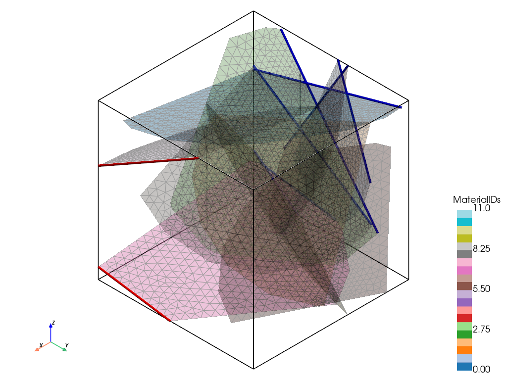

Loaded existing fracture parameters.
Once all fractures are generated, they’re passed as a list to
create_fracture_network(), along with the domain’s bounding box. This creates a 3D
Fracture Network object, representing the full 3D fracture system. The object takes care of intersection
detection, applies the orientation from strike/dip angles, and prepares the geometry for meshing and
simulation (see FractureNetwork3d
documentation).
The system consists of two vertical fractures representing inlet and outlet boreholes, modeled as long,
thin elliptic fractures. The minor axis is set to a small value
(borehole_Radius = maxs[0] * 0.005) to reflect the narrow borehole dimensions.
[x_Left, y_Center, zmax], with a major axis of
borehole_height and a minor axis of borehole_Radius, oriented vertically
(major_axis_angle =$\frac{\pi}{2}$, dip_angle =$\frac{\pi}{2}$).
[x_Right, y_Center, zmax], with identical
dimensions and orientation as the left borehole.Both fractures are added to the fractures list.

OpenGeosys simulationWe generate s clean, standardized .vtu mesh containing only MaterialIDs as cell
data — fully tailored for OpenGeoSys simulations in fractured media.
.vtu file into a mesh object for processing.MaterialIDs are missing, they’re generated from subdomain_id,
starting at 0 — OGS uses them to identify physical regions..prj setup.DFN_2D = ot.Mesh(f"{out_dir}/mixed_dimensional_grid_2.vtu")…

DFN_2D = pv.read(f"{out_dir}/mixed_dimensional_grid_2.vtu")
x_inlet = pv.read(f"{out_dir}/x_inlet.vtu")
x_outlet = pv.read(f"{out_dir}/x_outlet.vtu")
plotter.add_mesh(
DFN_2D,
scalars="MaterialIDs",
cmap="tab20",
opacity=0.4,
show_edges=True,
scalar_bar_args={"title": "MaterialIDs", "vertical": True},
plotter.add_mesh(DFN_2D.outline(), color="black", line_width=2)
plotter.add_mesh(
x_inlet,
color="blue",
opacity=1.0,
show_edges=True,
line_width=5,
render_lines_as_tubes=True,
plotter.add_mesh(
x_outlet,
color="red",
opacity=1.0,
show_edges=True,
line_width=5,
plotter.show_axes()
plotter.enable_parallel_projection()
plotter.view_isometric()
# plotter.window_size = [500, 500]
output_path = out_dir.joinpath("Concentration.png")
plotter.screenshot(str(output_path))
plotter.show()

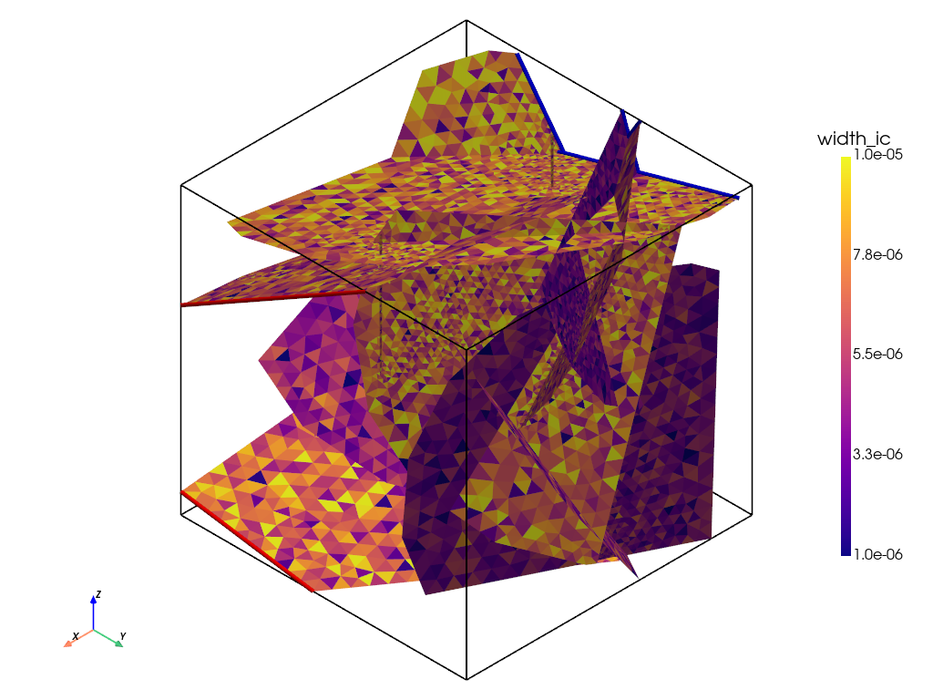

We assign random fracture properties (e.g., width and permeability) by calculating each mean value, $\mu$, from one of three user-defined distributions: Uniform, clipped Gaussian, or truncated Gaussian, constrained within specified bounds. The standard deviation is then calculated as $\sigma = \mathrm{rel_{std}} \times \mu$, with $\mathrm{rel_{std}}$ fixed at 30%, and cell values are subsequently sampled from a Gaussian distribution $\bigl(\mu, \sigma\bigr)$ and mapped to the mesh. Permeability can be configured as either isotropic or anisotropic.
Remark: Random fields with spatial correlation would be a more suitable representation of fracture heterogeneity. In the context of OGS see [8,9].
def sample_truncnorm(a, b, mu, sigma, rng, size=None):…
(click to toggle)
if size is None:
# scalar
while True:
x = rng.normal(mu, sigma)
if a <= x <= b:
return x
size = int(size)
out = np.empty(size)
filled = 0
batch = max(1024, size)
while filled < size:
x = rng.normal(mu, sigma, batch)
x = x[(x >= a) & (x <= b)]
take = min(size - filled, x.size)
if take:
out[filled : filled + take] = x[:take]
filled += take
return out
def sample_mean(a, b, rng, method="uniform"):
if method == "uniform":
return rng.uniform(a, b)
if method == "constant":
return 0.5 * (a + b)
mu = 0.5 * (a + b)
sigma = (b - a) / 6.0
if method == "gaussian":
return np.clip(rng.normal(mu, sigma), a, b)
if method == "truncated":
return sample_truncnorm(a, b, mu, sigma, rng)
msg = "Unknown sampling method"
raise ValueError(msg)
def generate_random_fracture_stats(
fracture_ids,
width_range=(5e-6, 1e-5),
k_range=(1e-14, 1e-12),
rel_std=0.3,
mean_dist="uniform",
rng=None,
rng = rng or default_rng()
stats = {}
for mat_id in fracture_ids:
w_min, w_max = width_range
width_mean = sample_mean(w_min, w_max, rng, method=mean_dist)
k_min, k_max = k_range
k_mean = sample_mean(k_min, k_max, rng, method=mean_dist)
stats[mat_id] = {
"width_mean": width_mean,
"width_std": rel_std * width_mean,
"width_range": (w_min, w_max),
"k_mean": k_mean,
"k_std": rel_std * k_mean,
"k_range": (k_min, k_max),
"method": mean_dist,
return stats
def assign_cellwise_random_props(mesh, stats_dict, clip_min=1e-20, seed=42):
rng = default_rng(seed)
MaterialIDs = mesh.cell_data["MaterialIDs"]
n_cells = len(MaterialIDs)
width_ic = np.zeros(n_cells)
permeability = np.zeros(n_cells)
for mat_id, stats in stats_dict.items():
idx = np.where(MaterialIDs == mat_id)[0]
n = len(idx)
method = stats.get("method", "uniform")
w_min, w_max = stats["width_range"]
w_mean, w_std = stats["width_mean"], stats["width_std"]
k_min, k_max = stats["k_range"]
k_mean, k_std = stats["k_mean"], stats["k_std"]
width_vals = rng.uniform(w_min, w_max, n)
k_vals = rng.uniform(k_min, k_max, n)
elif method == "constant":
width_vals = np.full(n, w_mean)
k_vals = np.full(n, k_mean)
elif method == "truncated":
width_vals = sample_truncnorm(w_min, w_max, w_mean, w_std, rng, size=n)
k_vals = sample_truncnorm(k_min, k_max, k_mean, k_std, rng, size=n)
elif method == "gaussian":
width_vals = np.clip(rng.normal(w_mean, w_std, n), w_min, w_max)
k_vals = np.clip(rng.normal(k_mean, k_std, n), k_min, k_max)
width_ic[idx] = np.clip(width_vals, clip_min, None)
permeability[idx] = k_vals
mesh.cell_data["width_ic"] = width_ic
mesh.cell_data["permeability_ic"] = permeability

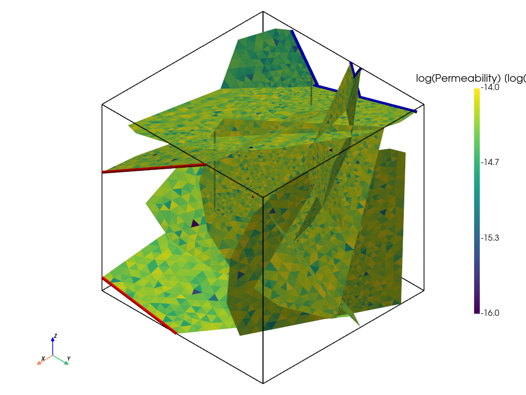

input_mesh = "mixed_dimensional_grid_2.vtu"…
(click to toggle)
output_mesh = "mixed_dimensional_grid_2_updated.vtu"
use_isotropic_perm = False
mesh = pv.read(Path(out_dir, input_mesh))
material_ids = np.unique(mesh.cell_data["MaterialIDs"])
fracture_ids = list(material_ids)
SEED = 20250818…
(click to toggle)
SEED = 20250818
rng = default_rng(SEED)
fracture_stats = generate_random_fracture_stats(
fracture_ids,
width_range=(1e-6, 1e-5),
k_range=(1e-16, 1e-14),
rel_std=0.3, # standard deviation is 30 % of mean value.
mean_dist="gaussian", # constant, uniform, gaussian, or truncated
rng=rng,
assign_cellwise_random_props(mesh, fracture_stats, seed=SEED)

def plot_isotropic_permeability(
mesh,
inlet,
outlet,
out_dir,
cmap="viridis",
image_name="permeability_isotropic.png",
k_iso = mesh.cell_data["permeability_ic"] # [:, 0]
k_log = np.log10(np.clip(k_iso, 1e-20, None))
mesh.cell_data["log_k_iso"] = k_log
scalar_bar_args = base_scalar_bar_args.copy()
scalar_bar_args["title"] = "log₁₀(Permeability) [log₁₀(m²)]"
plotter.add_mesh(
mesh,
scalars="log_k_iso",
cmap=cmap,
show_edges=False,
scalar_bar_args=scalar_bar_args,
plotter.add_mesh(mesh.outline(), color="black", line_width=2)
plotter.add_mesh(inlet, color="blue", line_width=6, render_lines_as_tubes=True)
plotter.add_mesh(outlet, color="red", line_width=6, render_lines_as_tubes=True)
plotter.show_axes()
plotter.screenshot(Path(out_dir, image_name))
plotter.show()

plot_scalar_field(
mesh=DFN_2D,
inlet=x_inlet,
outlet=x_outlet,
scalar_data="width_ic",
title="Fracture Width (m)",
cmap="plasma",
filename="width_ic.png",

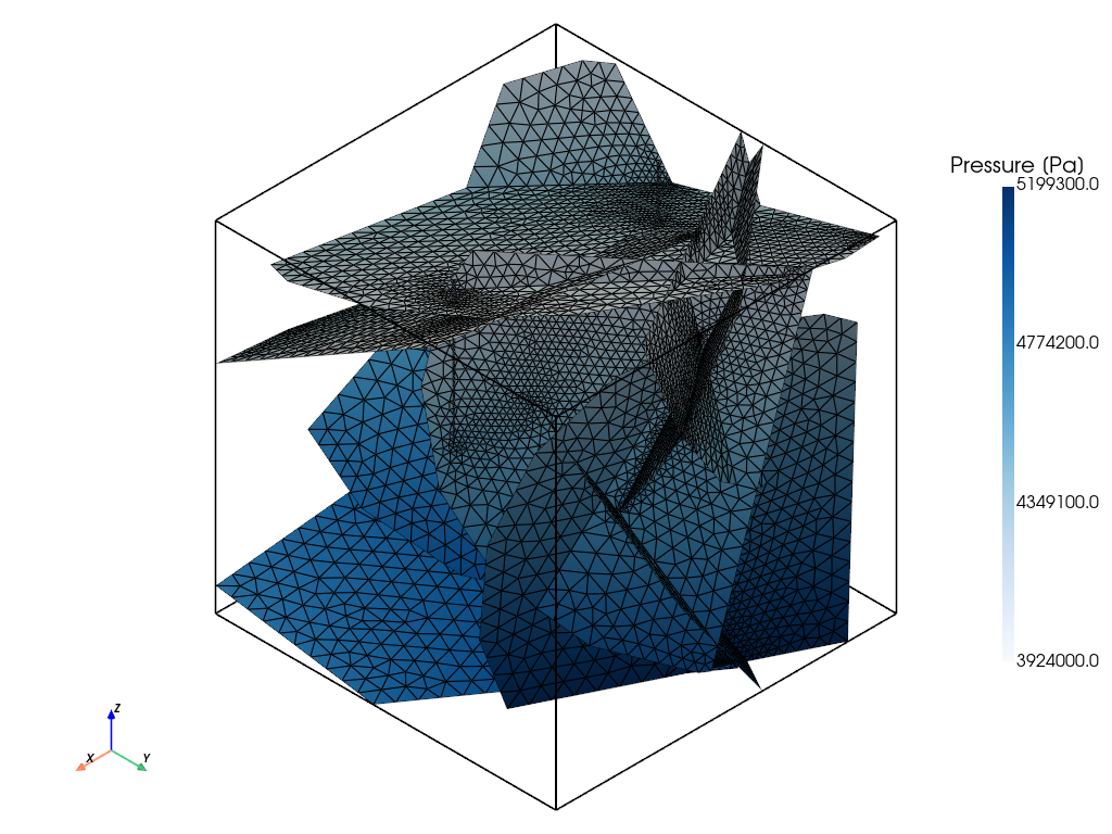

plotter = pv.Plotter(off_screen=True)…
(click to toggle)
scalar_bar_args["title"] = "Pressure [Pa]"
plotter.add_mesh(
mesh,
scalars="pressure",
cmap="Blues",
show_edges=True,
opacity=1.0,
plotter.show_axes()
output_path = out_dir.joinpath("pressure.png")
plotter.show()

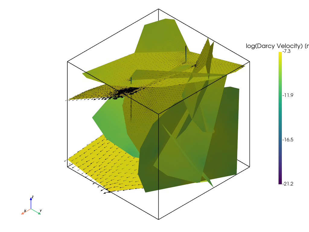

magnitude = np.linalg.norm(mesh["darcy_velocity"], axis=1)…
(click to toggle)
magnitude[magnitude <= 0] = 1e-12
log_magnitude = np.log10(magnitude)
mesh["darcy_velocity_magnitude"] = magnitude
mesh["log_darcy_velocity_magnitude"] = log_magnitude
mesh.set_active_vectors("darcy_velocity")
vmax = magnitude.max()
domain_size = max(mesh.bounds[1::2]) - min(mesh.bounds[::2])
scale_factor = domain_size * 0.1 / vmax if vmax > 0 else 1.0
arrows = mesh.glyph(
scale="darcy_velocity_magnitude", orient="darcy_velocity", factor=scale_factor
scalar_bar_args["title"] = "log₁₀(Darcy Velocity) [m/s]"
plotter.add_mesh(
mesh,
scalars="log_darcy_velocity_magnitude",
cmap="viridis",
opacity=1.0,
show_edges=False,
plotter.add_mesh(arrows, color="black", label="Velocity Vectors")
plotter.show_axes()
output_path = out_dir.joinpath("full_mesh_velocity_log_arrows.png")
plotter.show()

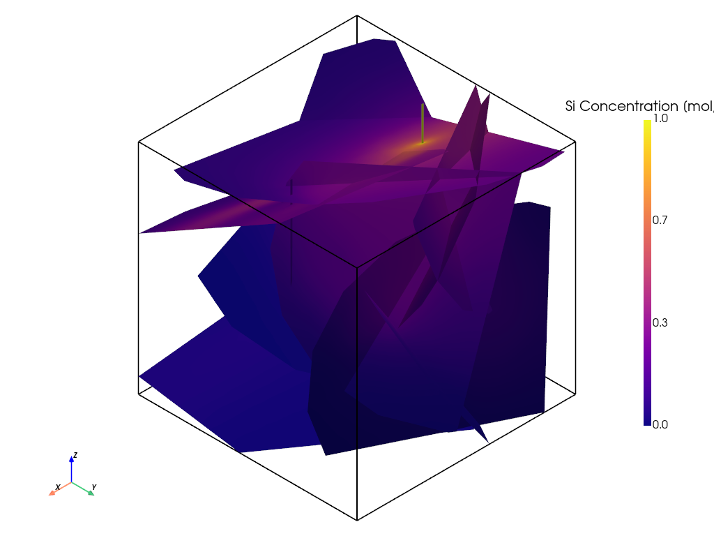

(click to toggle)
scalar_bar_args["title"] = "Si Concentration [mol/m³]"
plotter.add_mesh(
mesh,
scalars="Si",
cmap="plasma",
clim=(0, 1),
show_edges=False,
opacity=1.0,
plotter.show_axes()
output_path = out_dir.joinpath("concentration.png")
plotter.show()

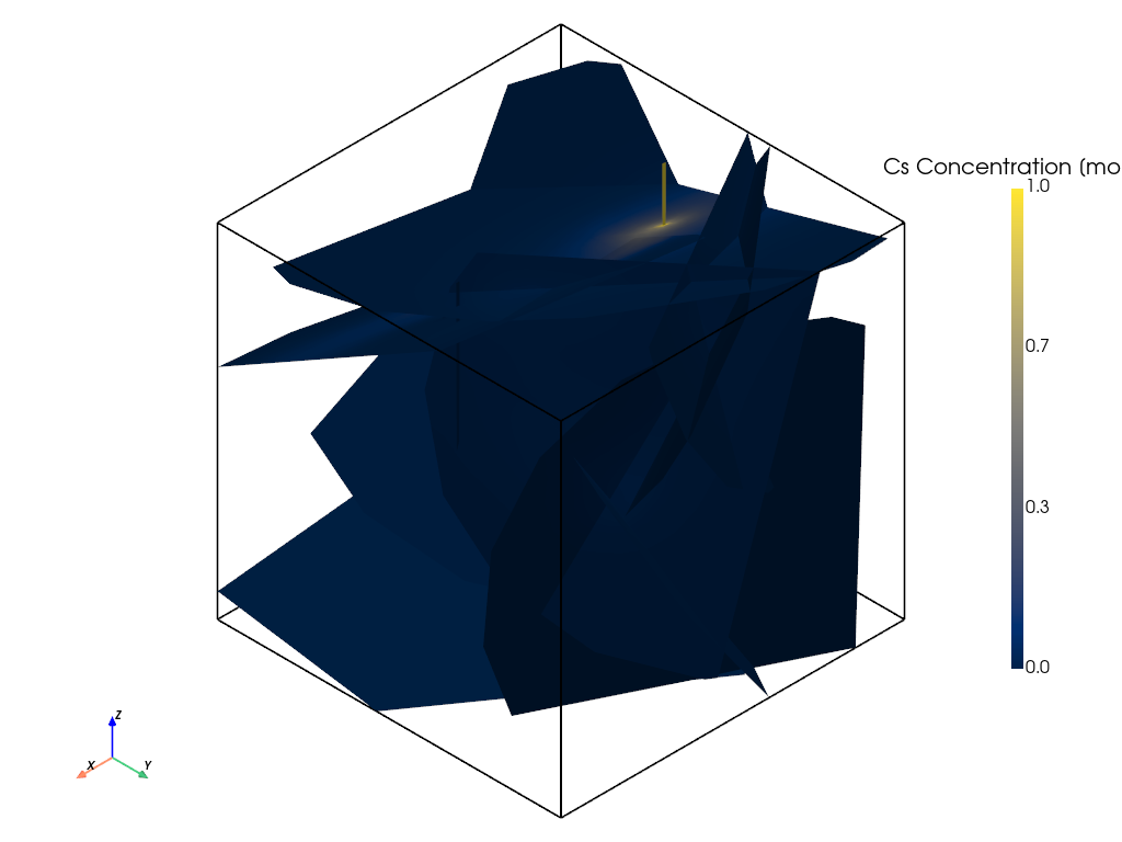

(click to toggle)
scalar_bar_args["title"] = "Cs Concentration [mol/m³]"
plotter.add_mesh(
mesh,
scalars="Cs",
clim=(0, 1),
cmap="cividis",
show_edges=False,
opacity=1.0,
plotter.show_axes()
output_path = out_dir.joinpath("concentration_Cs.png")
plotter.show()

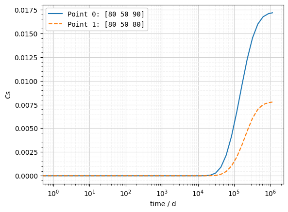

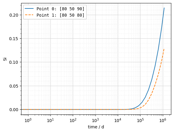

the temporal evolution of tracer concentration at a downstream monitoring point in a flow-through porous medium,
mesh_series = ot.MeshSeries(f'{out_dir}/{user_parameters["prefix"]}.pvd')…
(click to toggle)
print("Scalar fields available in mesh:", mesh.array_names)
observation_points = np.array(
[80, 50, 90],
[80, 50, 80],
labels = [f"Point {i}: {pt}" for i, pt in enumerate(observation_points)]
ms_days = mesh_series.scale(time=("s", "d"))
var = ot.variables.Scalar("Si")
fig_si = ms_days.plot_probe(points=observation_points, variable=var, labels=labels)
fig_si.axes[0].set_xscale("log")
fig_cs = ms_days.plot_probe(points=observation_points, variable="Cs", labels=labels)
fig_cs.axes[0].set_xscale("log")
