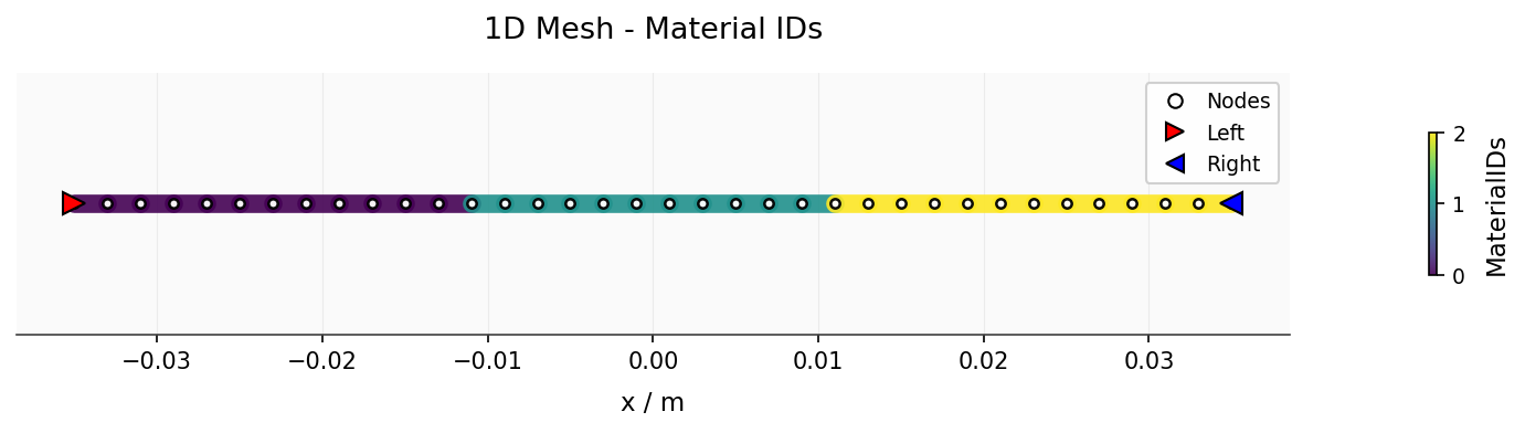

This study models how the injection of sulfuric acid alters the porosity and permeability of a layered porous medium. The domain is water-saturated and consists of three distinct layers:
  • Upstream quartz sand (inert)
  • Reactive sand-calcite interlayer
  • Downstream quartz sand (inert)
Schematic
Figure: Schematic
The quartz sand is chemically inert, while the key process is the dissolution of calcite in the middle layer by acid, which increases porosity. This porosity change modifies permeability according to the Kozeny-Carman relationship ($ k = k_0 \frac{(1 - \phi_0)^2}{\phi_0^3} \frac{\phi^3}{(1 - \phi)^2} $), thereby influencing subsequent fluid flow and solute transport. Aqueous chemical speciation is computed using the LLNL thermodynamic database.
Boundary conditions, initial conditions, and specific parameter values are provided in the Input Data section. The geochemical reactions are implemented using PHREEQC, tracking five primary components ($\mathrm{S(6)}$, $\mathrm{C}$, $\mathrm{Ca}$, $\mathrm{Na}$, $\mathrm{Cl}$) with calcite dissolution kinetics following a three-mechanism rate law (acid, neutral, and $\mathrm{CO_2}$-promoted pathways).

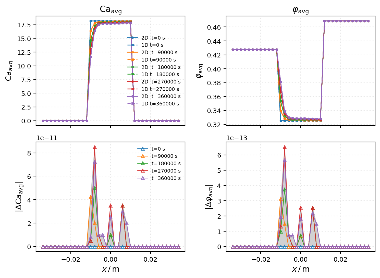

The model couples fluid flow with reactive solute transport through the advection-dispersion-reaction equation:
$$ \frac{\partial c_{T\alpha}}{\partial t} +\nabla\!\cdot\!\big(\mathbf{q}\,c_{T\alpha}-\phi\,\mathbf{D}\,\nabla c_{T\alpha}\big) +R_{\min,\alpha}=0 $$$$ \mathbf{q}=-\frac{k}{\mu}\big(\nabla p-\rho_\ell\,\mathbf{g}\big),\qquad \mathbf{D}=D_p\,\mathbf{I}+\alpha_T\,|\mathbf{v}|\,\mathbf{I} +(\alpha_L-\alpha_T)\,\frac{\mathbf{v}\mathbf{v}^\top}{|\mathbf{v}|},\qquad \mathbf{v}=\frac{\mathbf{q}}{\phi}. $$
  • $c_{T\alpha}$: total concentration of primary species $\alpha$.
  • $\mathbf{q}$: Darcy flux; body force term $-\rho_\ell\,\mathbf{g}$ included.
  • $\mathbf{D}$: hydrodynamic dispersion tensor with pore diffusion $D_p$ and dispersivities $\alpha_L,\alpha_T$ (using $\mathbf{v}=\mathbf{q}/\phi$).
  • $R_{\min,\alpha}$: heterogeneous reaction term (mineral dissolution/precipitation).
Although Darcy’s law is written here with the gravitational body-force term for generality, in this benchmark we neglect gravity by setting the specific body force to zero, so gravity does not contribute to the flow in the simulations.

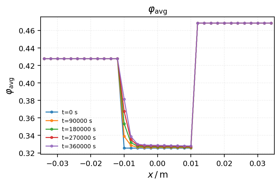

Media: Initial Porosity $,\phi_0,$ & Permeability $,k_0$
Layer $\phi_0$ [–] $k_0$ [m$^2$]
Upstream quartz $0.4277$ $2.95\times10^{-12}$
Reactive interlayer $0.3255$ $1.52\times10^{-12}$
Downstream quartz $0.4685$ $3.21\times10^{-12}$

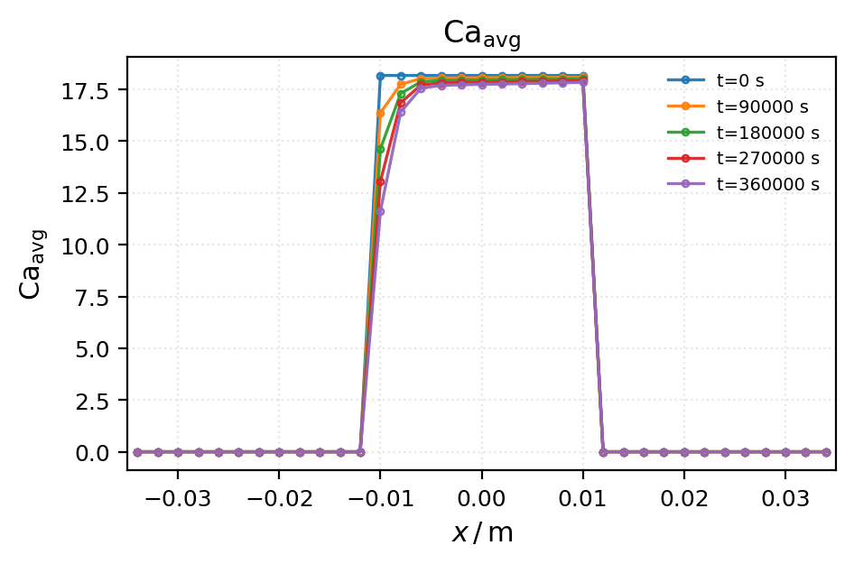

Calcite volume fraction (interlayer, init.) — — $0.2185$
Transported Components
Transported Component Symbol Primary Role in the System
Sulfate $\mathrm{S(6)}$ Tracks the injected acid anion $\mathrm{H_2SO_4}$ (conservative w.r.t. mineral reactions)
Proton $\mathrm{H^+}$ Drives acidity (low pH) and dissolution rates
Total Inorganic Carbon $\mathrm{C}$ Aggregates $\mathrm{CO_2(aq)}$, $\mathrm{HCO_3^-}$, $\mathrm{CO_3^{2-}}$
Calcium $\mathrm{Ca^{2+}}$ Product of calcite dissolution; controls saturation
Sodium & Chloride $\mathrm{Na^+}$, $\mathrm{Cl^-}$ Background ions for charge balance / ionic strength

Convert msh to vtu for running OpenGeoSys simulations
def plot_2d_meshes(meshes_2d):… (click to toggle)
    figures = []
    if not meshes_2d:
        return figures
    domain_mesh = meshes_2d.get("domain", next(iter(meshes_2d.values())))
    try:
        fig = plt.figure(figsize=(10, 3.0), dpi=150)
        ax = fig.add_subplot(111)
        domain_mesh.plot_contourf(
            "MaterialIDs", ax=ax, cbar=True, linewidth=0.2, cmap="viridis"
        ax.set_aspect("equal")
        ax.set_xlabel("x / m", fontsize=11)
        ax.set_ylabel("y / m", fontsize=11)
        ax.tick_params(labelsize=10)
        ax.set_title("2D Mesh - Material IDs", fontsize=13, pad=15)
        boundary_colors = {"Left": "red", "Right": "blue"}
        for name, mesh in meshes_2d.items():
            for boundary_key, color in boundary_colors.items():
                if boundary_key.lower() in name.lower():
                    try:
                        points = mesh.points
                        if len(points) > 1:
                            if boundary_key in ["Left", "Right"]:
                                sorted_idx = np.argsort(points[:, 1])
                                sorted_idx = np.argsort(points[:, 0])
                            ax.plot(
                                points[sorted_idx, 0],
                                points[sorted_idx, 1],
                                color=color,
                                linewidth=5,
                                alpha=0.8,
                                label=name,
                    except Exception:
                        continue
        if any(
            any(
                boundary_key.lower() in name.lower() for boundary_key in boundary_colors
            for name in meshes_2d
            ax.legend(fontsize=9, loc="upper right", frameon=True)
        figures.append(fig)
    except Exception as e:
        print(f"Could not create 2D contour plot: {e}")
    return figures
def plot_1d_meshes(meshes_1d):
    figures = []
    if not meshes_1d:
        return figures
    mesh = meshes_1d.get("domain", next(iter(meshes_1d.values())))
    fig, ax = plt.subplots(figsize=(10, 2.5), dpi=150)
    if len(points) == 0:
        return figures
    cell_data = None
    for key in ("MaterialIDs", "MaterialID", "MaterialId"):
        if key in mesh.cell_data and len(mesh.cell_data[key]) > 0:
            cell_data = np.asarray(mesh.cell_data[key]).flatten()
            break
    segments = []
    if hasattr(mesh, "cells"):
        cells = np.asarray(mesh.cells)
        if len(cells) > 0:
            if cells.ndim == 1:
                i = 0
                while i < len(cells):
                    n_points = cells[i]
                    cell_points = cells[i + 1 : i + 1 + n_points]
                    for j in range(len(cell_points) - 1):
                        x1 = points[cell_points[j]][0]
                        x2 = points[cell_points[j + 1]][0]
                        segments.append([[x1, 0], [x2, 0]])
                    i += 1 + n_points
                for cell in cells:
                    if len(cell) >= 2:
                        x1 = points[cell[0]][0]
                        x2 = points[cell[1]][0]
    if not segments and len(points) > 1:
        for i in range(len(points) - 1):
            x1 = points[i][0]
            x2 = points[i + 1][0]
        if cell_data is None:
            cell_data = np.ones(len(segments), dtype=int)
    if not segments:
        return figures
    segments = np.array(segments)
    lc = LineCollection(
        segments,
        linewidth=8.0,
        capstyle="round",
        joinstyle="round",

def generate_vtu_meshes_from_Gmsh(msh_file: Path, target_dim: int):
    if not msh_file.is_file():
        raise FileNotFoundError(msh_file)
    out_dir = msh_file.parent
    figures = []
    if target_dim == 2:
        meshes = ot.meshes_from_gmsh(msh_file, dim=[2], log=False)
            pv.save_meshio(out_dir / f"{name}.vtu", mesh)
        if meshes:
            figures.extend(plot_2d_meshes(meshes))
    elif target_dim == 1:
        meshes = ot.meshes_from_gmsh(msh_file, dim=[1], log=False)
        if meshes:
            figures.extend(plot_1d_meshes(meshes))
    if figures:
    return figures
def run_mesh(dim: str):
    d = dim.strip().lower()
    td = {"1d": 1, "2d": 2}[d]
    base_msh = MESH["msh_file"]
    base_vtu = MESH["vtu_file"]
    msh = base_msh.parent.parent / d / base_msh.name
    vtu = base_vtu.parent.parent / d / base_vtu.name
    if not msh.is_file():
        raise FileNotFoundError(msh)
    generate_vtu_meshes_from_Gmsh(msh, target_dim=td)

vtu_path = run_mesh(dim_suffix)
assert_structured_mesh_size(vtu_path, target_dim)
Mesh check passed: 35 cells, 36 points (dim = 1D).

Post-processing
VARS = ["Calcite_avg", "porosity_avg"]… (click to toggle)
PVD_PATH = PROJECT["pvd_path"]
def _var_tex(var: str) -> str:
    v = var.lower()
    if "porosity" in v:
        return r"\varphi_\mathrm{avg}"
    if "calcite" in v:
        return r"\mathrm{Ca}_\mathrm{avg}"
    return var
def get_centerline_cell_indices(mesh, y_tol: float = 1e-8):
    """Return cell indices and x-coordinates along the x-centerline."""
    xmin, xmax, ymin, ymax, zmin, zmax = mesh.bounds
    ext = np.array([xmax - xmin, ymax - ymin, zmax - zmin])
    nz_dims = int(np.sum(ext > 1e-10))
    if nz_dims not in (1, 2):
        msg = "Only 1D or 2D meshes are supported for centerline extraction."
        raise ValueError(msg)
    centers = mesh.cell_centers().points
    xs = centers[:, 0]
    if nz_dims == 1:
        order = np.argsort(xs)
        return order, xs[order], nz_dims, ymin
    ys = centers[:, 1]
    center_y = 0.5 * (ymin + ymax)
    y_unique = np.unique(np.round(ys / y_tol) * y_tol)
    row_y = y_unique[np.argmin(np.abs(y_unique - center_y))]
    row_mask = np.abs(ys - row_y) < y_tol
    if not np.any(row_mask):
        msg = "No centerline row found in y."
        raise RuntimeError(msg)
    row_ids = np.nonzero(row_mask)[0]
    row_xs = xs[row_mask]
    order = np.argsort(row_xs)
    centerline_ids = row_ids[order]
    x_coords = row_xs[order]
    return centerline_ids, x_coords, nz_dims, row_y
def plot_centerline_profiles(
    pvd_path: Path,
    vars_to_plot,
    out_dir: Path | None = None,
    plt.rcParams.update(
            "font.size": 9,
            "axes.labelsize": 11,
            "axes.titlesize": 12,
            "legend.fontsize": 8,
            "xtick.labelsize": 9,
            "ytick.labelsize": 9,
    ms = ot.MeshSeries(pvd_path)
    n = len(ms.timevalues)
    if n == 0:
        msg = f"No timesteps in PVD file: {pvd_path}"
    idxs = sorted({round(f * (n - 1)) for f in (0.0, 0.25, 0.5, 0.75, 1.0)})
    times = [ms.timevalues[i] for i in idxs]
    ref_mesh = ms[0]
    xmin, xmax, *_ = ref_mesh.bounds
    centerline_ids, x_coords, *_ = get_centerline_cell_indices(ref_mesh)
    nx = len(x_coords)
    npz_data: dict[str, np.ndarray] = {
        "axis_label": np.array("x"),
        "coord": x_coords,
        "times": np.array(times, dtype=float),
    cmap = plt.get_cmap("tab10")
    colors = [cmap(i % 10) for i in range(len(idxs))]
    markevery = max(1, nx // 25)
    for var in vars_to_plot:
        fig, ax = plt.subplots(figsize=(4.8, 3.2), dpi=200)
        plotted_any = False
        var_arr = np.full((len(idxs), nx), np.nan, dtype=float)
        for k, (i, t, c) in enumerate(zip(idxs, times, colors, strict=False)):
            mesh = ms[i]
            var_name = None
            for avail_var in mesh.array_names:
                if avail_var.lower() == var.lower():
                    var_name = avail_var
                    break
            if var_name is None:
                continue
            if var_name not in mesh.cell_data:
                continue
            all_cell_values = np.asarray(mesh.cell_data[var_name])
            if all_cell_values.shape[0] <= centerline_ids.max():
                msg = (
                    f"Cell data for variable '{var}' has insufficient length "
                    f"at t={t:g} s."
            values = all_cell_values[centerline_ids]
            if values.size != nx:
                continue
            var_arr[k, :] = values
            ax.plot(
                x_coords,
                values,
                marker="o",
                markevery=markevery,
                markersize=2.5,
                lw=1.2,
                alpha=0.95,
                color=c,
                markerfacecolor="none",
                label=f"t={t:g} s",
            plotted_any = True
        if not plotted_any:
            plt.close(fig)
            print(f"[skip] '{var}' not found as cell data in any timestep.")
            continue
        npz_data[var] = var_arr
        var_tex = _var_tex(var)
        ax.set_xlim(xmin, xmax)
        ax.set_xlabel(r"$x\,/\,\mathrm{m}$")
        ax.set_ylabel(rf"${var_tex}$")
        ax.tick_params(axis="both", labelsize=9)
        ax.grid(True, which="both", alpha=0.3, linestyle=":")
        ax.legend(loc="best", frameon=False, fontsize=7)
        ax.set_title(rf"${var_tex}$")
    if out_dir is not None:
        out_dir = Path(out_dir)
        npz_path = out_dir / f"{pvd_path.stem}_centerline.npz"
        np.savez_compressed(npz_path, **npz_data)
        print(f"[saved] centerline profiles -> {npz_path}")
plot_centerline_profiles(… (click to toggle)
    pvd_path=PVD_PATH,
    vars_to_plot=VARS,
    out_dir=Path(PROJECT["out_dir"]),
[saved] centerline profiles -> /var/lib/gitlab-runner/builds/vZ6vnZiU/0/ogs/build/release-petsc/Tests/Data/Parabolic/ComponentTransport/ReactiveTransport/Acidification/PorosityIncrease/hc_porosity_change_1d_centerline.npz
Comparison between 1D and 2D simulations
def _swap_dim_suffix(stem: str) -> tuple[str, str, str]:… (click to toggle)
    s = stem.lower()
    if s.endswith("1d"):
        curr = "1d"
        other = "2d"
        other_stem = stem[:-2] + "2d"
    elif s.endswith("2d"):
        curr = "2d"
        other = "1d"
        other_stem = stem[:-2] + "1d"
        msg = (
            f"Cannot infer dimension from stem '{stem}'. "
            "Expected it to end with '1d' or '2d'."
    return curr, other, other_stem
def _align_other_to_base(
    base_x: np.ndarray, other_x: np.ndarray, other_vals: np.ndarray
) -> np.ndarray:
    if np.allclose(base_x, other_x, rtol=1e-10, atol=1e-12):
        return other_vals
    aligned = np.empty((other_vals.shape[0], base_x.shape[0]))
    for it in range(other_vals.shape[0]):
        aligned[it, :] = np.interp(base_x, other_x, other_vals[it, :])
    return aligned
    v = var.lower()
    if "porosity" in v:
    if "calcite" in v:
    return var
def compare_centerline_npz(
    base_npz: Path,
    other_npz: Path,
    vars_to_plot,
    use_relative: bool = False,
    base_label: str = "BASE",
    other_label: str = "OTHER",
            "font.size": 9,
    base_data = np.load(base_npz)
    other_data = np.load(other_npz)
    base_x = base_data["coord"]
    other_x = other_data["coord"]
    base_t = base_data["times"]
    other_t = other_data["times"]
    if base_t.shape != other_t.shape or not np.allclose(base_t, other_t):
        print("[warn] Times differ between base and other.")
    times = base_t
    print(f"[compare_centerline_npz] {base_label} file : {base_npz}")
    print(f"[compare_centerline_npz] {other_label} file: {other_npz}")
    print(
        "[compare_centerline_npz] x-base:  "
        f"{base_x[0]:.6g} .. {base_x[-1]:.6g} ({len(base_x)} pts)"
    print(
        "[compare_centerline_npz] x-other: "
        f"{other_x[0]:.6g} .. {other_x[-1]:.6g} ({len(other_x)} pts)"
    nt = len(times)
    colors = [cmap(i % 10) for i in range(nt)]
    markevery = max(1, len(base_x) // 25)
    nvars = len(vars_to_plot)
    if nvars == 0:
        print("[compare_centerline_npz] No variables to plot.")
        return
    ncols = nvars
    nrows = 3 if use_relative else 2
    fig, axes = plt.subplots(
        nrows,
        ncols,
        figsize=(3.7 * ncols, 2.3 * nrows * 1.2),
        dpi=200,
        sharex="col",
    if nvars == 1:
        axes = np.atleast_2d(axes)
    for j, var in enumerate(vars_to_plot):
        if var not in base_data or var not in other_data:
            print(f"[skip] '{var}' not in both files.")
            continue
        base_vals = np.asarray(base_data[var])
        other_vals = np.asarray(other_data[var])
        other_vals_aligned = _align_other_to_base(base_x, other_x, other_vals)
        abs_err = np.abs(base_vals - other_vals_aligned)
        if use_relative:
            eps = 1e-14
            denom = np.maximum(np.abs(base_vals), eps)
            rel_err = abs_err / denom
            rel_err = None
        ax_prof = axes[0, j]
        ax_abs = axes[1, j]
        ax_rel = axes[2, j] if use_relative else None
        for it, t in enumerate(times):
            c = colors[it]
            ax_prof.plot(
                base_x,
                base_vals[it, :],
                marker="o",
                markersize=2.5,
                lw=1.2,
                alpha=0.95,
                color=c,
                label=f"{base_label}  t={t:g} s",
            ax_prof.plot(
                base_x,
                other_vals_aligned[it, :],
                marker="s",
                markersize=2.5,
                lw=1.2,
                alpha=0.95,
                color=c,
                label=f"{other_label} t={t:g} s",
        ax_prof.set_ylabel(rf"${var_tex}$")
        ax_prof.grid(True, which="both", alpha=0.3, linestyle=":")
        if j == 0:
            ax_prof.legend(loc="best", frameon=False, fontsize=7)
        ax_prof.set_title(rf"${var_tex}$")
        # absolute error
        max_abs_err = np.max(abs_err, axis=0)
            c = colors[it]
            ax_abs.plot(
                base_x,
                abs_err[it, :],
                marker="^",
                markersize=4,
                lw=1.0,
                alpha=0.9,
                color=c,
                label=f"t={t:g} s",
        ax_abs.fill_between(
            base_x,
            0.0,
            max_abs_err,
            color="black",
            alpha=0.18,
        ax_abs.set_ylabel(rf"$|\Delta {var_tex}|$")
        ax_abs.grid(True, which="both", alpha=0.3, linestyle=":")
        if j == 0:
            ax_abs.legend(loc="best", frameon=False, fontsize=7)
        # relative error
        if ax_rel is not None and rel_err is not None:
            max_rel_err = np.max(rel_err, axis=0)
                c = colors[it]
                ax_rel.plot(
                    base_x,
                    rel_err[it, :],
                    marker="v",
                    lw=1.0,
                    alpha=0.9,
                    color=c,
                    label=f"t={t:g} s",
            ax_rel.fill_between(
                base_x,
                0.0,
                max_rel_err,
                color="black",
                alpha=0.18,
            ax_rel.set_ylabel(rf"$|\Delta {var_tex}| / |{var_tex}|$")
            ax_rel.grid(True, which="both", alpha=0.3, linestyle=":")
            if j == 0:
                ax_rel.legend(loc="best", frameon=False, fontsize=7)
    for j in range(ncols):
        axes[-1, j].set_xlabel(r"$x\,/\,\mathrm{m}$")
def compare_with_other_dim(vars_to_plot, use_relative: bool = True):
    stem = PVD_PATH.stem
    curr_suffix, other_suffix, other_stem = _swap_dim_suffix(stem)
    out_dir = Path(PROJECT["out_dir"])
    exp_dir = Path("expected")
    current_npz = out_dir / f"{stem}_centerline.npz"
    other_npz = exp_dir / f"{other_stem}_centerline.npz"
    if not current_npz.is_file():
        msg = (
            f"Current dim NPZ not found: {current_npz}.\n"
            "Run plot_centerline_profiles first for the current dimension."
        raise FileNotFoundError(msg)
    if not other_npz.is_file():
        msg = (
            f"Expected other-dim NPZ not found: {other_npz}.\n"
            "Check 'expected' folder and the naming convention."
    base_label = other_suffix.upper()
    other_label = curr_suffix.upper()
        base_npz=other_npz,
        other_npz=current_npz,
        vars_to_plot=vars_to_plot,
        use_relative=use_relative,
        base_label=base_label,
        other_label=other_label,
compare_with_other_dim(… (click to toggle)
    vars_to_plot=VARS,
    use_relative=False,
[compare_centerline_npz] 2D file : expected/hc_porosity_change_2d_centerline.npz
[compare_centerline_npz] 1D file: /var/lib/gitlab-runner/builds/vZ6vnZiU/0/ogs/build/release-petsc/Tests/Data/Parabolic/ComponentTransport/ReactiveTransport/Acidification/PorosityIncrease/hc_porosity_change_1d_centerline.npz
[compare_centerline_npz] x-base:  -0.034 .. 0.034 (35 pts)
[compare_centerline_npz] x-other: -0.034 .. 0.034 (35 pts)

    msg = "Cell connectivity/types differ."
def _assert_cell(name, atol=1e-6, rtol=0):
    np.testing.assert_allclose(
        np.asarray(mesh_new.cell_data[name]),
        np.asarray(mesh_ref.cell_data[name]),
        rtol=rtol,
        atol=atol,
    print(f"OK CELL: {name}")
for n, atol, rtol in [("porosity_avg", 1e-6, 0)]:
    if n in mesh_new.cell_data and n in mesh_ref.cell_data:
        _assert_cell(n, atol, rtol)
print("All requested cell arrays matched within tolerances.")
OK CELL: porosity_avg
