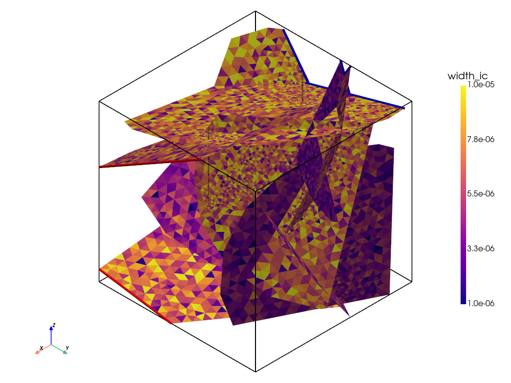

To investigate solute transport and retention in fractured rocks, a DFN is generated using PorePy with stochastic fracture placement algorithms. The resulting DFN geometry is processed through OGSTools to create OpenGeoSys (OGS)-compatible input files, enabling the setup and execution of a Hydro-Component (HC) simulation for flow and solute transport, and retention in realistic fractured media.
alt text

Fracture generation loop
  • The loop iterates n_fractures times, with each iteration generating a single fracture.
  • For every fracture:
    • A random center is generated within the domain by scaling a uniformly distributed random vector.
    • A random radius is selected within the radius_\text{R}ange, setting its size between the allowed minimum and maximum values.
    • Both the major axis and minor axis are set equal to the radius—while PorePy supports ellipses, we’re using circular fractures here.
    • Strike and dip angles are randomly drawn from the interval $[-\frac{\pi}{2}, \frac{\pi}{2}]$.
      • These angles define the fracture plane’s orientation (see link):
        • Strike angle: Sets the direction of the rotation axis in the horizontal plane, measured from the x-axis.
        • Dip angle: Describes the tilt of the fracture plane from the horizontal.

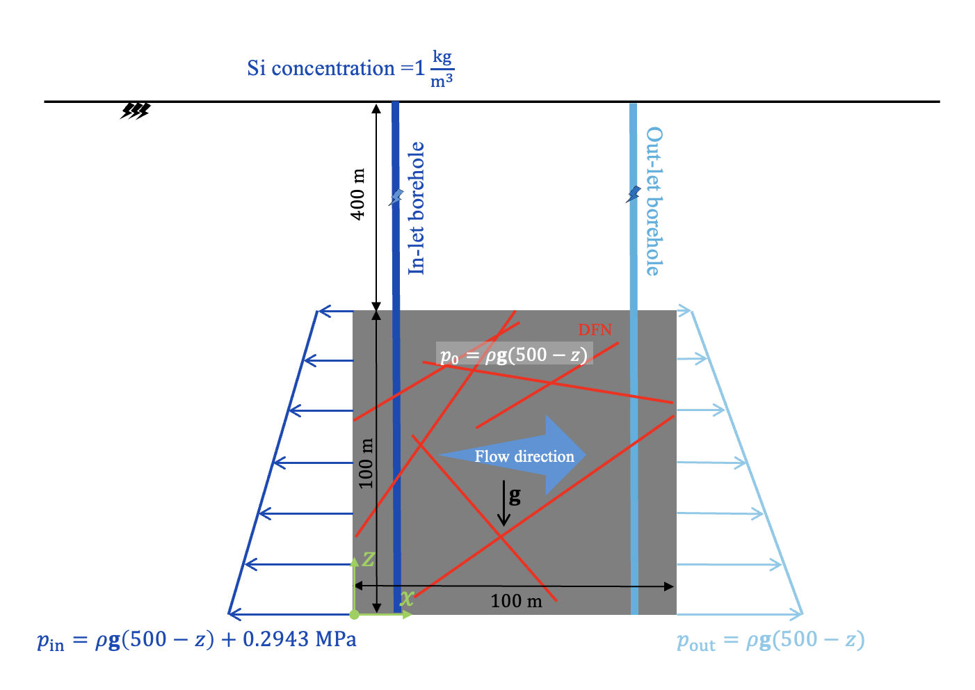

Fracture network generation
Once all fractures are generated, they’re passed as a list to create_fracture_network(), along with the domain’s bounding box. This creates a 3D Fracture Network object, representing the full 3D fracture system. The object takes care of intersection detection, applies the orientation from strike/dip angles, and prepares the geometry for meshing and simulation (see FractureNetwork3d documentation).
The system consists of two vertical fractures representing inlet and outlet boreholes, modeled as long, thin elliptic fractures. The minor axis is set to a small value (borehole_Radius = maxs[0] * 0.005) to reflect the narrow borehole dimensions.
  1. Left Borehole: Located at [x_Left, y_Center, zmax], with a major axis of borehole_height and a minor axis of borehole_Radius, oriented vertically (major_axis_angle =$\frac{\pi}{2}$, dip_angle =$\frac{\pi}{2}$).
  2. Right Borehole: Located at [x_Right, y_Center, zmax], with identical dimensions and orientation as the left borehole.
Both fractures are added to the fractures list.

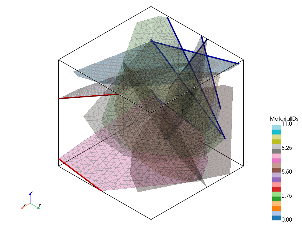

Export the mesh to VTU format
Creates a VTK file of the 2D mixed-dimensional grid (mdg2d) using Exporter (see link). The output is compatible with visualization tools like ParaView, and serves as input for OpenGeoSys.
exporter = pp.Exporter(mdg2d, "mixed_dimensional_grid", folder_name=out_dir).write_vtu()
OpenGeosys
Preparing the mesh (.vtu) for OpenGeosys simulation
We generate s clean, standardized .vtu mesh containing only MaterialIDs as cell data — fully tailored for OpenGeoSys simulations in fractured media.
  • Loads the .vtu file into a mesh object for processing.
  • If MaterialIDs are missing, they’re generated from subdomain_id, starting at 0 — OGS uses them to identify physical regions.
  • Removes all other cell and point data, keeping only what’s necessary for OGS.
  • Saves the meshes ready for use in an OGS .prj setup.

Plot DFN and boundaries
%cd $orig_dir… (click to toggle)
%cd $orig_dir
try:
except Exception as e:
    print("PyVista backend not set:", e)
DFN_2D = pv.read(f"{out_dir}/mixed_dimensional_grid_2.vtu")
x_inlet = pv.read(f"{out_dir}/x_inlet.vtu")
x_outlet = pv.read(f"{out_dir}/x_outlet.vtu")
plotter.add_mesh(
    DFN_2D,
    scalars="MaterialIDs",
    cmap="tab20",
    opacity=0.4,
    show_edges=True,
    scalar_bar_args={"title": "MaterialIDs", "vertical": True},
plotter.add_mesh(DFN_2D.outline(), color="black", line_width=2)
plotter.add_mesh(
    x_inlet,
    color="blue",
    opacity=1.0,
    show_edges=True,
    line_width=5,
    render_lines_as_tubes=True,
plotter.add_mesh(
    x_outlet,
    color="red",
    opacity=1.0,
    show_edges=True,
    line_width=5,
plotter.show_axes()
plotter.enable_parallel_projection()
plotter.view_isometric()
# plotter.window_size = [500, 500]
output_path = out_dir.joinpath("Concentration.png")
plotter.screenshot(str(output_path))
plotter.show()

Generate and assign random fracture properties with Gaussian distributions
We assign random fracture properties (e.g., width and permeability) by calculating each mean value, $\mu$, from one of three user-defined distributions: Uniform, clipped Gaussian, or truncated Gaussian, constrained within specified bounds. The standard deviation is then calculated as $\sigma = \mathrm{rel_{std}} \times \mu$, with $\mathrm{rel_{std}}$ fixed at 30%, and cell values are subsequently sampled from a Gaussian distribution $\bigl(\mu, \sigma\bigr)$ and mapped to the mesh. Permeability can be configured as either isotropic or anisotropic.
Remark: Random fields with spatial correlation would be a more suitable representation of fracture heterogeneity. In the context of OGS see [8,9].
def sample_truncnorm(a, b, mu, sigma, rng, size=None):… (click to toggle)
    if size is None:
        # scalar
        while True:
            x = rng.normal(mu, sigma)
            if a <= x <= b:
                return x
    size = int(size)
    out = np.empty(size)
    filled = 0
    batch = max(1024, size)
    while filled < size:
        x = rng.normal(mu, sigma, batch)
        x = x[(x >= a) & (x <= b)]
        take = min(size - filled, x.size)
        if take:
            out[filled : filled + take] = x[:take]
            filled += take
    return out
def sample_mean(a, b, rng, method="uniform"):
    if method == "uniform":
        return rng.uniform(a, b)
    if method == "constant":
        return 0.5 * (a + b)
    mu = 0.5 * (a + b)
    sigma = (b - a) / 6.0
    if method == "gaussian":
        return np.clip(rng.normal(mu, sigma), a, b)
    if method == "truncated":
        return sample_truncnorm(a, b, mu, sigma, rng)
    msg = "Unknown sampling method"
    raise ValueError(msg)
def generate_random_fracture_stats(
    fracture_ids,
    width_range=(5e-6, 1e-5),
    k_range=(1e-14, 1e-12),
    rel_std=0.3,
    mean_dist="uniform",
    rng=None,
    rng = rng or default_rng()
    stats = {}
    for mat_id in fracture_ids:
        w_min, w_max = width_range
        width_mean = sample_mean(w_min, w_max, rng, method=mean_dist)
        k_min, k_max = k_range
        k_mean = sample_mean(k_min, k_max, rng, method=mean_dist)
        stats[mat_id] = {
            "width_mean": width_mean,
            "width_std": rel_std * width_mean,
            "width_range": (w_min, w_max),
            "k_mean": k_mean,
            "k_std": rel_std * k_mean,
            "k_range": (k_min, k_max),
            "method": mean_dist,
    return stats
def assign_cellwise_random_props(mesh, stats_dict, clip_min=1e-20, seed=42):
    rng = default_rng(seed)
    MaterialIDs = mesh.cell_data["MaterialIDs"]
    n_cells = len(MaterialIDs)
    width_ic = np.zeros(n_cells)
    permeability = np.zeros(n_cells)
    for mat_id, stats in stats_dict.items():
        idx = np.where(MaterialIDs == mat_id)[0]
        n = len(idx)
        method = stats.get("method", "uniform")
        w_min, w_max = stats["width_range"]
        w_mean, w_std = stats["width_mean"], stats["width_std"]
        k_min, k_max = stats["k_range"]
        k_mean, k_std = stats["k_mean"], stats["k_std"]
            width_vals = rng.uniform(w_min, w_max, n)
            k_vals = rng.uniform(k_min, k_max, n)
        elif method == "constant":
            width_vals = np.full(n, w_mean)
            k_vals = np.full(n, k_mean)
        elif method == "truncated":
            width_vals = sample_truncnorm(w_min, w_max, w_mean, w_std, rng, size=n)
            k_vals = sample_truncnorm(k_min, k_max, k_mean, k_std, rng, size=n)
        elif method == "gaussian":
            width_vals = np.clip(rng.normal(w_mean, w_std, n), w_min, w_max)
            k_vals = np.clip(rng.normal(k_mean, k_std, n), k_min, k_max)
        width_ic[idx] = np.clip(width_vals, clip_min, None)
        permeability[idx] = k_vals
    mesh.cell_data["width_ic"] = width_ic
    mesh.cell_data["permeability_ic"] = permeability
input_mesh = "mixed_dimensional_grid_2.vtu"… (click to toggle)
output_mesh = "mixed_dimensional_grid_2_updated.vtu"
use_isotropic_perm = False
mesh = pv.read(Path(out_dir, input_mesh))
material_ids = np.unique(mesh.cell_data["MaterialIDs"])
fracture_ids = list(material_ids)
SEED = 20250818… (click to toggle)
SEED = 20250818
rng = default_rng(SEED)
fracture_stats = generate_random_fracture_stats(
    fracture_ids,
    width_range=(1e-6, 1e-5),
    k_range=(1e-16, 1e-14),
    rel_std=0.3,  # standard deviation is 30 % of mean value.
    mean_dist="gaussian",  # constant, uniform, gaussian, or truncated
    rng=rng,
assign_cellwise_random_props(mesh, fracture_stats, seed=SEED)
mesh.save(Path(out_dir, output_mesh), binary=False)

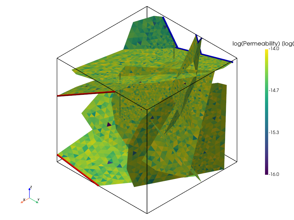

def plot_isotropic_permeability(
    mesh,
    inlet,
    outlet,
    out_dir,
    cmap="viridis",
    image_name="permeability_isotropic.png",
    k_iso = mesh.cell_data["permeability_ic"]  # [:, 0]
    k_log = np.log10(np.clip(k_iso, 1e-20, None))
    mesh.cell_data["log_k_iso"] = k_log
    scalar_bar_args = base_scalar_bar_args.copy()
    scalar_bar_args["title"] = "log₁₀(Permeability) [log₁₀(m²)]"
    plotter.add_mesh(
        mesh,
        scalars="log_k_iso",
        cmap=cmap,
        show_edges=False,
        scalar_bar_args=scalar_bar_args,
    plotter.add_mesh(mesh.outline(), color="black", line_width=2)
    plotter.add_mesh(inlet, color="blue", line_width=6, render_lines_as_tubes=True)
    plotter.add_mesh(outlet, color="red", line_width=6, render_lines_as_tubes=True)
    mesh=DFN_2D,
    inlet=x_inlet,
    outlet=x_outlet,
    out_dir=out_dir,
plot_scalar_field(
    mesh=DFN_2D,
    inlet=x_inlet,
    outlet=x_outlet,
    scalar_data="width_ic",
    title="Fracture Width (m)",
    cmap="plasma",
    filename="width_ic.png",

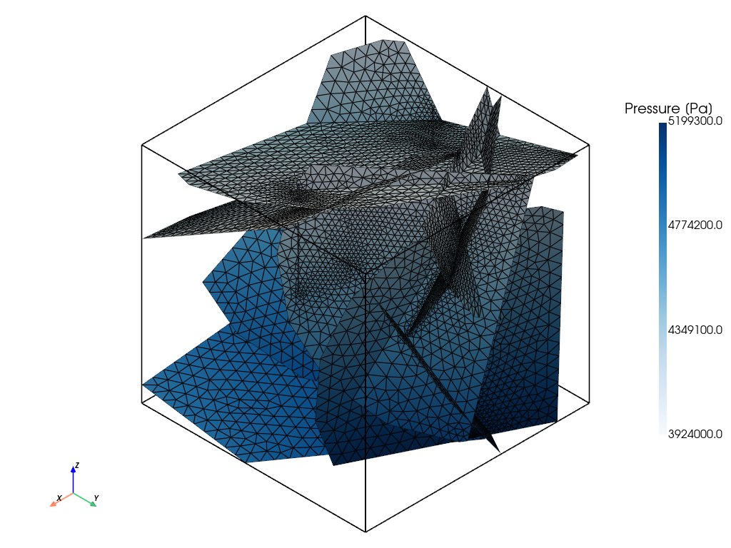

plotter = pv.Plotter(off_screen=True)… (click to toggle)
scalar_bar_args["title"] = "Pressure [Pa]"
plotter.add_mesh(
    mesh,
    scalars="pressure",
    cmap="Blues",
    show_edges=True,
    opacity=1.0,
plotter.show_axes()
output_path = out_dir.joinpath("pressure.png")
plotter.show()

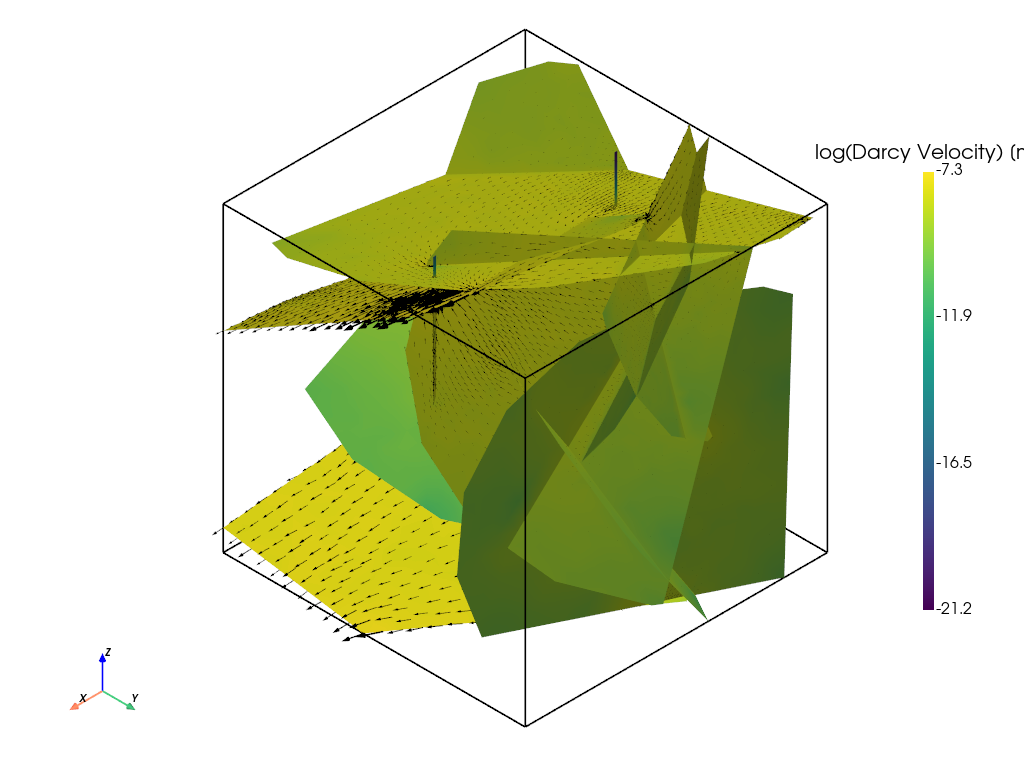

magnitude = np.linalg.norm(mesh["darcy_velocity"], axis=1)… (click to toggle)
magnitude[magnitude <= 0] = 1e-12
log_magnitude = np.log10(magnitude)
mesh["darcy_velocity_magnitude"] = magnitude
mesh["log_darcy_velocity_magnitude"] = log_magnitude
mesh.set_active_vectors("darcy_velocity")
vmax = magnitude.max()
domain_size = max(mesh.bounds[1::2]) - min(mesh.bounds[::2])
scale_factor = domain_size * 0.1 / vmax if vmax > 0 else 1.0
arrows = mesh.glyph(
    scale="darcy_velocity_magnitude", orient="darcy_velocity", factor=scale_factor
scalar_bar_args["title"] = "log₁₀(Darcy Velocity) [m/s]"
plotter.add_mesh(
    mesh,
    scalars="log_darcy_velocity_magnitude",
    cmap="viridis",
    opacity=1.0,
    show_edges=False,
plotter.add_mesh(arrows, color="black", label="Velocity Vectors")
plotter.show_axes()
output_path = out_dir.joinpath("full_mesh_velocity_log_arrows.png")
plotter.show()

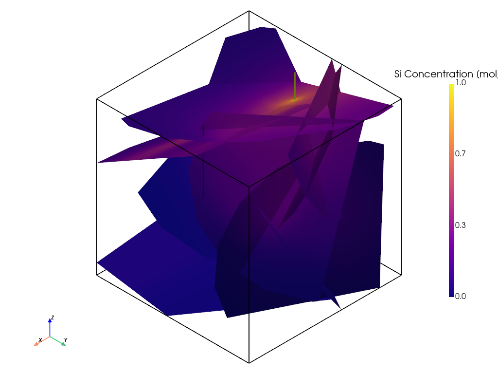

scalar_bar_args["title"] = "Si Concentration [mol/m³]"
plotter.add_mesh(
    mesh,
    scalars="Si",
    cmap="plasma",
    clim=(0, 1),
    show_edges=False,
    opacity=1.0,
plotter.show_axes()
output_path = out_dir.joinpath("concentration.png")
plotter.show()

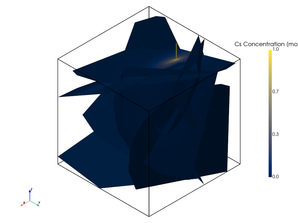

scalar_bar_args["title"] = "Cs Concentration [mol/m³]"
plotter.add_mesh(
    mesh,
    scalars="Cs",
    clim=(0, 1),
    cmap="cividis",
    show_edges=False,
    opacity=1.0,
plotter.show_axes()
output_path = out_dir.joinpath("concentration_Cs.png")
plotter.show()

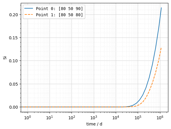

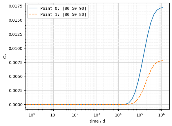

Breakthrough curve (BTC)
the temporal evolution of tracer concentration at a downstream monitoring point in a flow-through porous medium,
mesh_series = ot.MeshSeries(f'{out_dir}/{user_parameters["prefix"]}.pvd')… (click to toggle)
print("Scalar fields available in mesh:", mesh.array_names)
observation_points = np.array(
        [80, 50, 90],
        [80, 50, 80],
labels = [f"Point {i}: {pt}" for i, pt in enumerate(observation_points)]
ms_days = mesh_series.scale(time=("s", "d"))
var = ot.variables.Scalar("Si")
fig_si = ms_days.plot_probe(points=observation_points, variable=var, labels=labels)
fig_si.axes[0].set_xscale("log")
fig_cs = ms_days.plot_probe(points=observation_points, variable="Cs", labels=labels)
fig_cs.axes[0].set_xscale("log")
