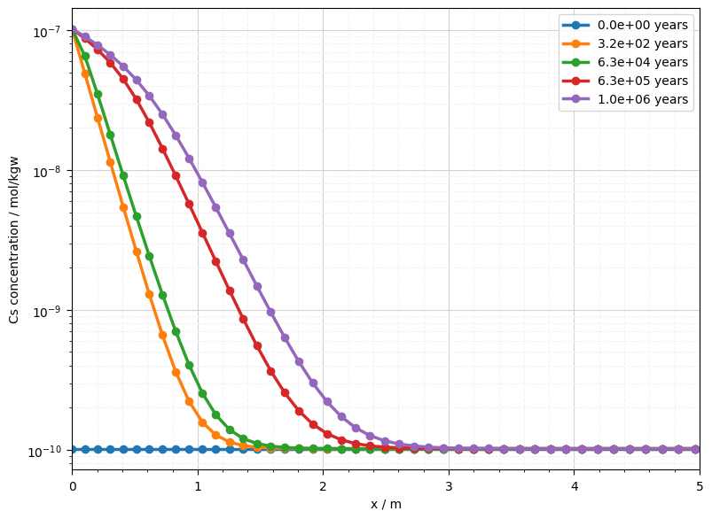

Cs-135 migration
A Cs concentration at the left boundary of 1.019e-7 mol/kgw is set constant throughout the simulation. The sorption model is taken from Águila et al., 2021. Cs-135 migration is simulated by using OGS#iPHREEQC via the <surface> keyword with the following parameters:

Here we plot the last timestep of the above simulation and the timesteps of the full simulation.
cs_var = ot.variables.Scalar("Cs", output_name="Cs concentration / mol/kgw")
cs_fig = plot_results(cs_var, x_max=5)
The results show that Cs-135 does not migrate for more than 3 m even after 1 million years.

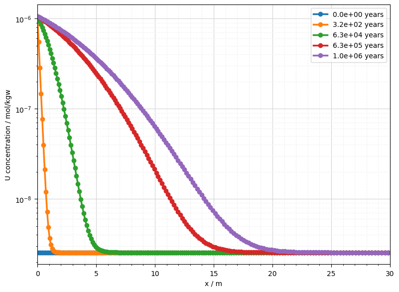

U-238 migration
Similarly, a U concentration at the left boundary of 1.060e-6 mol/kgw is applied to the domain. In this case, the sorption model is taken from Hennig et al., 2020. U-238 migration is simulated by using OGS#iPHREEQC via the <surface> keyword definition with the following parameters:

Plot the results
Again, the full simulation results are provided in /U_full_simulation. They are plotted to show the migration of U after 1 million years.
U_var = ot.variables.Scalar("U", output_name="U concentration / mol/kgw")
U_fig = plot_results(U_var, x_max=30)
In this case, it is clear that the migration of U-238 is much more pronounced than Cs-135. After 1 million years, U-238 shows a breakthrough to around 20 m.
