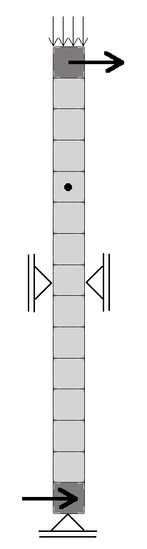

The fluid enters and leaves only via the source and sink in the domain, there is no flow across the boundaries. The displacements at the bottom are fixed, whereas there is a vertical traction applied on top. Originally the problem is one-dimensional, for simulation with OpenGeoSys it is created in two dimensions with corresponding boundary conditions. All parameters are concluded in the following tables.

| Hydraulic | Mechanical | |
| injection over area $10$m$\times 10$m | $+1.16\cdot 10^{-4}$ kg/(m$^3$s) | - |
| production over area $10$m$\times 10$m | $-1.16\cdot 10^{-4}$ kg/(m$^3$s) | - |
| top | no flow | $\sigma_{yy}=-2.125\cdot 10^6$ Pa |
| left | no flow | $u_x=0$ |
| right | no flow | $u_x=0$ |
| bottom | no flow | $u_y=0$ |
| initial state | $p(x,y)=2.125\cdot 10^6$ Pa | $u_x(x,y)=u_y(x,y)=0$ |

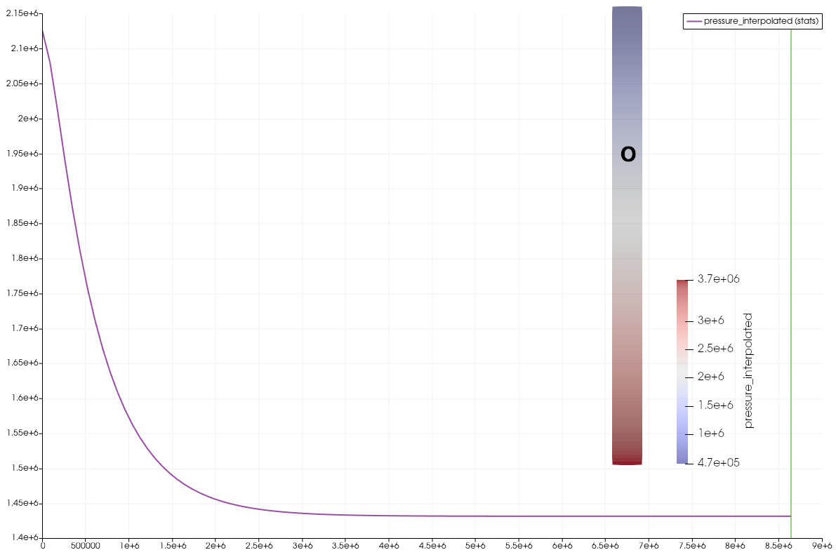

Note that 100 time steps were used for the following results, whereas the provided input file is set to 1 time step (1 day = 86400 s). Kim plots his results over non dimensional time, referring to the time at which the produced fluid volume equals the pore volume of the domain (450 days).
