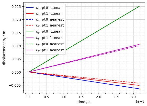

pvdfile = vtuIO.PVDIO(f"{out_dir}/{prj_name}.pvd", interpolation_backend="scipy", dim=2)
time = pvdfile.timesteps
points={'pt0': (0.3,0.5,0.0), 'pt1': (0.24,0.21,0.0)}
displacement_linear = pvdfile.read_time_series("displacement", points, interpolation_method="linear")
displacement_nearest = pvdfile.read_time_series("displacement", points, interpolation_method="nearest")
plt.plot(time, displacement_linear["pt0"][:,0], "b-", label="$u_x$ pt0 linear interpolated")
plt.plot(time, displacement_nearest["pt0"][:,0], "b--", label="$u_x$ pt0 closest point value")
plt.plot(time, displacement_linear["pt0"][:,1], "g-", label="$u_y$ pt0 linear interpolated")
plt.plot(time, displacement_nearest["pt0"][:,1], "g--", label="$u_y$ pt0 closest point value")
plt.plot(time, displacement_linear["pt1"][:,0], "r-", label="$u_x$ pt1 linear interpolated")
plt.plot(time, displacement_nearest["pt1"][:,0], "r--", label="$u_x$ pt1 closest point value")
plt.plot(time, displacement_linear["pt1"][:,1], "m-", label="$u_y$ pt1 linear interpolated")
plt.plot(time, displacement_nearest["pt1"][:,1], "m--", label="$u_y$ pt1 closest point value")
plt.legend()
plt.xlabel("t")
plt.ylabel("u")
Text(0, 0.5, 'u')
