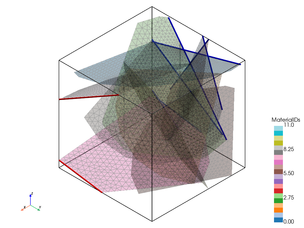

To investigate solute transport and retention in fractured rocks, a DFN is generated using PorePy with stochastic fracture placement algorithms. The resulting DFN geometry is processed through OGSTools to create OpenGeoSys (OGS)-compatible input files, enabling the setup and execution of a Hydro-Component (HC) simulation for flow and solute transport, and retention in realistic fractured media.
alt text
DFN generating using Porepy
PorePy is an open-source Python library developed by the University of Bergen, designed for simulating multiphysics processes in fractured and porous media. It emphasizes discrete fracture network (DFN) modeling through a mixed-dimensional approach.

Fracture generation loop
  • The loop iterates n_fractures times, with each iteration generating a single fracture.
  • For every fracture:
    • A random center is generated within the domain by scaling a uniformly distributed random vector.
    • A random radius is selected within the radius_\text{R}ange, setting its size between the allowed minimum and maximum values.
    • Both the major axis and minor axis are set equal to the radius—while PorePy supports ellipses, we’re using circular fractures here.
    • Strike and dip angles are randomly drawn from the interval $[-\frac{\pi}{2}, \frac{\pi}{2}]$.
      • These angles define the fracture plane’s orientation (see link):
        • Strike angle: Sets the direction of the rotation axis in the horizontal plane, measured from the x-axis.
        • Dip angle: Describes the tilt of the fracture plane from the horizontal.

for p in fracture_params:
    frac = pp.create_elliptic_fracture(
        center=np.array(p["center"]),
        major_axis=p["major_axis"],
        minor_axis=p["minor_axis"],
        major_axis_angle=p["major_axis_angle"],
        strike_angle=p["strike_angle"],
        dip_angle=p["dip_angle"],
    fractures.append(frac)
#  vertical boreholes as long, thin fractures
center_left = np.array([x_left, y_center, z_center])
borehole_left = pp.create_elliptic_fracture(
    center=center_left,
    major_axis=borehole_height,
    minor_axis=borehole_radius,
    major_axis_angle=np.pi / 2,
    strike_angle=0.0,
    dip_angle=-0.5 * np.pi,
fractures.append(borehole_left)
center_right = np.array([x_right, y_center, z_center])
borehole_right = pp.create_elliptic_fracture(
    center=center_right,
    strike_angle=0.0,
fractures.append(borehole_right)
Loaded existing fracture parameters.
Fracture network generation
Once all fractures are generated, they’re passed as a list to create_fracture_network(), along with the domain’s bounding box. This creates a 3D Fracture Network object, representing the full 3D fracture system. The object takes care of intersection detection, applies the orientation from strike/dip angles, and prepares the geometry for meshing and simulation (see FractureNetwork3d documentation).
The system consists of two vertical fractures representing inlet and outlet boreholes, modeled as long, thin elliptic fractures. The minor axis is set to a small value (borehole_Radius = maxs[0] * 0.005) to reflect the narrow borehole dimensions.
  1. Left Borehole: Located at [x_Left, y_Center, zmax], with a major axis of borehole_height and a minor axis of borehole_Radius, oriented vertically (major_axis_angle =$\frac{\pi}{2}$, dip_angle =$\frac{\pi}{2}$).
  2. Right Borehole: Located at [x_Right, y_Center, zmax], with identical dimensions and orientation as the left borehole.
Both fractures are added to the fractures list.

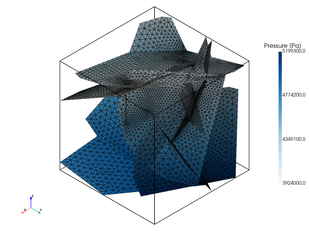

network = pp.create_fracture_network(fractures=fractures, domain=domain)
Meshing the fracture network
We generate the computational mesh using PorePy’s mixed-dimensional approach:
  • cell_size_boundary: maximum cell size near the domain boundaries.
  • cell_size_fracture: target cell size along the fracture surfaces.
  • cell_size_min: minimum allowed cell size anywhere in the mesh.
  • simplex: enables triangular (2D) or tetrahedral (3D) elements.
This produces a mixed-dimensional grid (mdg) with 3D rock matrix cells, 2D fracture surfaces, and lower-dimensional intersections.
For fracture-only simulations, the 3D matrix is removed, leaving just the 2D fractures and their intersections.
mesh_args = {(click to toggle)
mesh_args = {
    "cell_size_boundary": mesh_size_boundary,
    "cell_size_fracture": mesh_size_fracture,
    "cell_size_min": mesh_size_min,
    "export": True,
    "filename": "mdg2d",
    # "folder_name": out_dir,
mdg = pp.create_mdg("simplex", mesh_args, network)
# --- Remove the 3D matrix cells to keep only fractures + intersections ---
mdg2d = mdg.copy()
for sd in list(mdg2d.subdomains()):
    if sd.dim == 3:
        mdg2d.remove_subdomain(sd)
# --- Clean up empty 1D subdomains & interfaces (avoid IndexError on export) ---
for g in list(mdg2d.subdomains(dim=1)):
    cn = g.cell_nodes()
    if g.num_cells == 0 or cn.indices.size == 0 or cn.indptr.size <= 1:
        mdg2d.remove_subdomain(g)
Export the mesh to VTU format
Creates a VTK file of the 2D mixed-dimensional grid (mdg2d) using Exporter (see link). The output is compatible with visualization tools like ParaView, and serves as input for OpenGeoSys.
exporter = pp.Exporter(mdg2d, "mixed_dimensional_grid", folder_name=out_dir).write_vtu()

Plot DFN and boundaries
%cd $orig_dir(click to toggle)
%cd $orig_dir
try:
except Exception as e:
    print("PyVista backend not set:", e)
DFN_2D = pv.read(f"{out_dir}/mixed_dimensional_grid_2.vtu")
x_inlet = pv.read(f"{out_dir}/x_inlet.vtu")
x_outlet = pv.read(f"{out_dir}/x_outlet.vtu")
plotter.add_mesh(
    DFN_2D,
    scalars="MaterialIDs",
    cmap="tab20",
    opacity=0.4,
    show_edges=True,
    scalar_bar_args={"title": "MaterialIDs", "vertical": True},
plotter.add_mesh(DFN_2D.outline(), color="black", line_width=2)
plotter.add_mesh(
    x_inlet,
    color="blue",
    opacity=1.0,
    show_edges=True,
    line_width=5,
    render_lines_as_tubes=True,
plotter.add_mesh(
    x_outlet,
    color="red",
    opacity=1.0,
    show_edges=True,
    line_width=5,
plotter.show_axes()
plotter.enable_parallel_projection()
plotter.view_isometric()
# plotter.window_size = [500, 500]
output_path = out_dir.joinpath("Concentration.png")
plotter.screenshot(str(output_path))
plotter.show()
/var/lib/gitlab-runner/builds/vZ6vnZiU/1/ogs/ogs/Tests/Data/Parabolic/ComponentTransport/DFN_PorePy

plotter = pv.Plotter(off_screen=True)(click to toggle)
scalar_bar_args = base_scalar_bar_args.copy()
scalar_bar_args["title"] = "Pressure [Pa]"
plotter.add_mesh(
    mesh,
    scalars="pressure",
    cmap="Blues",
    show_edges=True,
    opacity=1.0,
    scalar_bar_args=scalar_bar_args,
plotter.add_mesh(mesh.outline(), color="black", line_width=2)
plotter.show_axes()
output_path = out_dir.joinpath("pressure.png")
plotter.show()

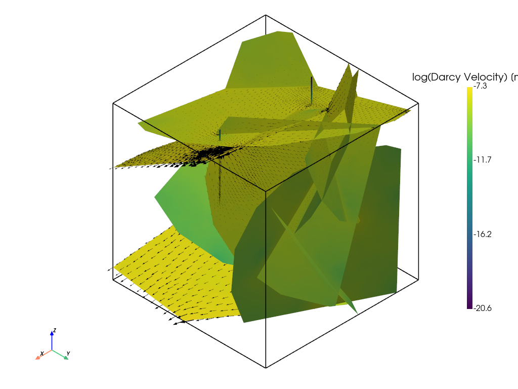

magnitude = np.linalg.norm(mesh["darcy_velocity"], axis=1)(click to toggle)
magnitude[magnitude <= 0] = 1e-12
log_magnitude = np.log10(magnitude)
mesh["darcy_velocity_magnitude"] = magnitude
mesh["log_darcy_velocity_magnitude"] = log_magnitude
mesh.set_active_vectors("darcy_velocity")
vmax = magnitude.max()
domain_size = max(mesh.bounds[1::2]) - min(mesh.bounds[::2])
scale_factor = domain_size * 0.1 / vmax if vmax > 0 else 1.0
arrows = mesh.glyph(
    scale="darcy_velocity_magnitude", orient="darcy_velocity", factor=scale_factor
scalar_bar_args["title"] = "log₁₀(Darcy Velocity) [m/s]"
plotter.add_mesh(
    mesh,
    scalars="log_darcy_velocity_magnitude",
    cmap="viridis",
    opacity=1.0,
    show_edges=False,
plotter.add_mesh(arrows, color="black", label="Velocity Vectors")
plotter.show_axes()
output_path = out_dir.joinpath("full_mesh_velocity_log_arrows.png")
plotter.show()

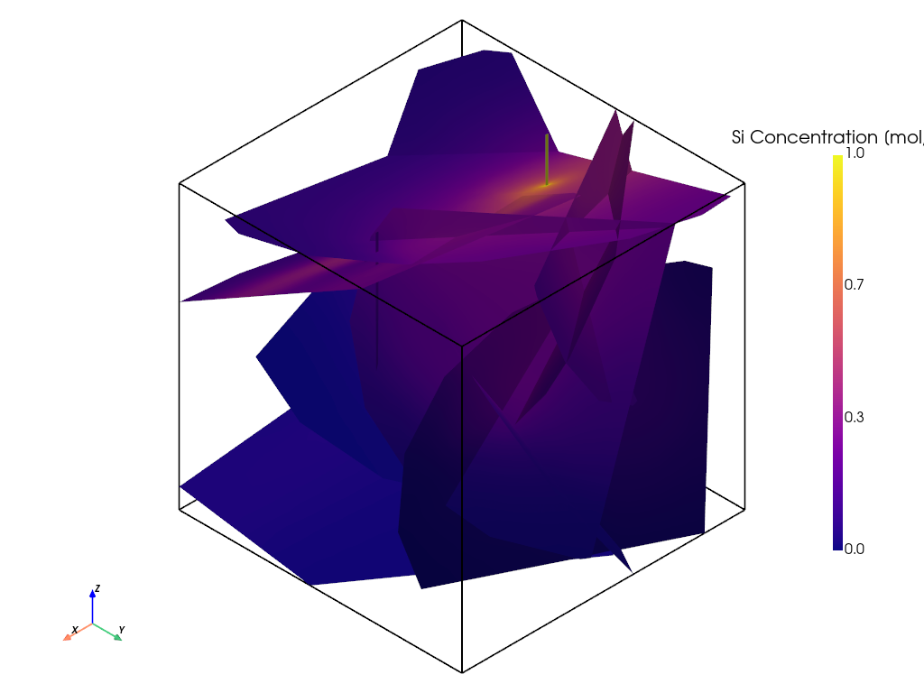

scalar_bar_args["title"] = "Si Concentration [mol/m³]"
plotter.add_mesh(
    mesh,
    scalars="Si",
    cmap="plasma",
    clim=(0, 1),
    show_edges=False,
    opacity=1.0,
plotter.show_axes()
output_path = out_dir.joinpath("concentration.png")
plotter.show()

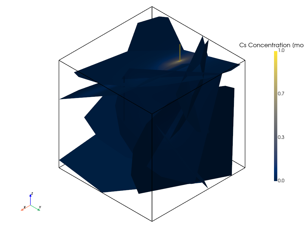

scalar_bar_args["title"] = "Cs Concentration [mol/m³]"
plotter.add_mesh(
    mesh,
    scalars="Cs",
    clim=(0, 1),
    cmap="cividis",
    show_edges=False,
    opacity=1.0,
plotter.show_axes()
output_path = out_dir.joinpath("concentration_Cs.png")
plotter.show()

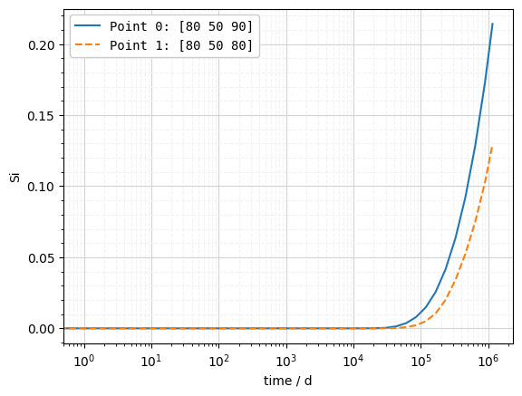

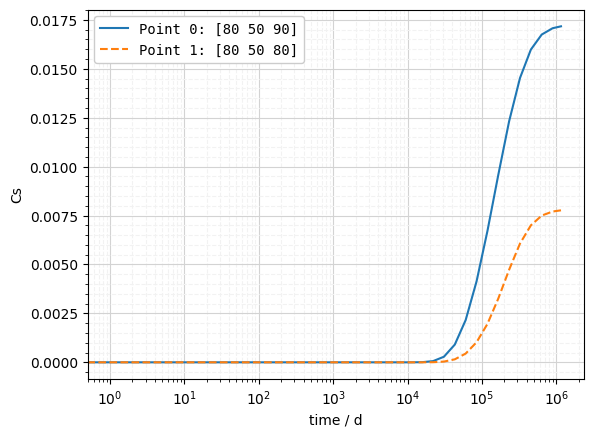

Breakthrough curve (BTC)
the temporal evolution of tracer concentration at a downstream monitoring point in a flow-through porous medium,
mesh_series = ot.MeshSeries(f'{out_dir}/{user_parameters["prefix"]}.pvd')(click to toggle)
print("Scalar fields available in mesh:", mesh.array_names)
observation_points = np.array(
        [80, 50, 90],
        [80, 50, 80],
labels = [f"Point {i}: {pt}" for i, pt in enumerate(observation_points)]
ms_days = mesh_series.scale(time=("s", "d"))
var = ot.variables.Scalar("Si")
fig_si = ms_days.plot_probe(points=observation_points, variable=var, labels=labels)
fig_si.axes[0].set_xscale("log")
fig_cs = ms_days.plot_probe(points=observation_points, variable="Cs", labels=labels)
fig_cs.axes[0].set_xscale("log")
Scalar fields available in mesh: ['Cs', 'OGS_VERSION', 'PointMergeMap', 'CsFlowRate', 'LiquidMassFlowRate', 'Si', 'SiFlowRate', 'darcy_velocity', 'pressure', 'darcy_velocity_magnitude', 'log_darcy_velocity_magnitude', 'MaterialIDs', 'permeability_ic', 'porosity_avg', 'velocity', 'width_ic']
/tmp/ipykernel_726638/2640689875.py:16: DeprecationWarning: Call to a deprecated function plot_probe.
    Please use the following code instead:
        ms_pts = ot.MeshSeries.extract_probe(mesh_series, pts)
        fig = ot.plot.line(ms_pts, "time", variable_of_interest)
/tmp/ipykernel_726638/2640689875.py:19: DeprecationWarning: Call to a deprecated function plot_probe.

ref_mesh = _ensure_point_pressure(pv.read(ref_mesh_path))
print(f"Original points: {mesh_c.n_points}, Cleaned points: {clean_mesh.n_points}")
print("pressure_last shape:", pressure_last.shape, "size:", pressure_last.size)
print(
    "pressure_ref  shape:",
    ref_mesh.point_data["pressure"].shape,
    "size:",
    ref_mesh.point_data["pressure"].size,
sampled = last_mesh.sample(ref_mesh)
pressure_ref_on_last = np.asarray(sampled.point_data["pressure"])
mask = sampled.point_data.get("vtkValidPointMask", None)
if mask is not None:
    mask = np.asarray(mask).astype(bool)
    if not mask.all():
        pressure_ref_on_last = _nn_fill(
            pressure_ref_on_last,
            mask,
            last_mesh.points,
            ref_mesh.points,
            np.asarray(ref_mesh.point_data["pressure"]),
abs_diff = np.abs(pressure_last - pressure_ref_on_last)
print(f"max|delta_p|={abs_diff.max():.6g}, mean|delta_p|={abs_diff.mean():.6g}")
np.testing.assert_allclose(
    actual=pressure_last,
    desired=pressure_ref_on_last,
    rtol=5e-6,
    atol=1e-8,
    equal_nan=False,
print("Pressure fields match")
Original points: 12110, Cleaned points: 10340
pressure_last shape: (10340,) size: 10340
pressure_ref  shape: (10340,) size: 10340
max|delta_p|=3.39933e-07, mean|delta_p|=1.7032e-08
