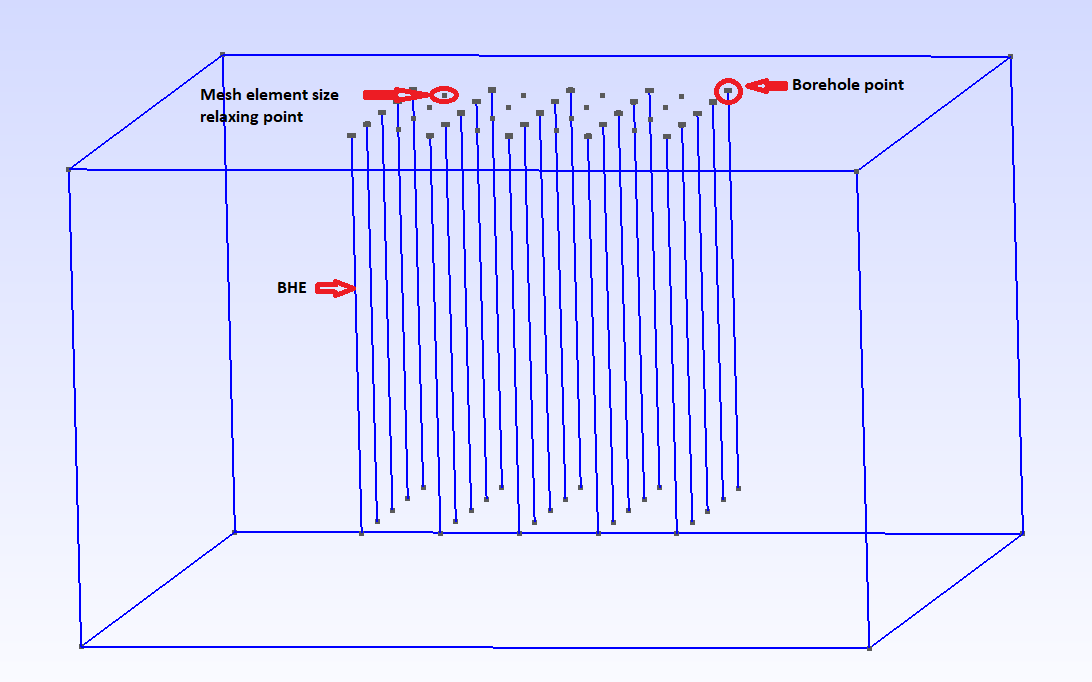

Next step is to include 25 boreholes in this project, organized in a 5X5 array. The corresponding coordinates are imported from a Excel spreadsheet file.
df_bhe = pd.read_excel('bhe_coordinates.xlsx')
df_relax = pd.read_excel('bhe_coordinates.xlsx', sheet_name=1)
Finally, all the borehole points and surrounding points are added to the surface 1. Here, 6 surrounding points for each borehole point are added with hexagonal shape like in this picture.
A detailed explanation and model verification can be found in Diersch et al. (2011). Here, the initial borehole point tag can not be smaller than 4 since there are already four boundary points.

In this step, all BHE points will be extruded up to bhe_depth and each BHE line will be assigned unique physical group.
k= 2… (click to toggle)
k= 2
for u in j:
    G = gmsh.model.geo.extrude([(0, u)], 0, 0, -bhe_depth, [10], [1], True)
    gmsh.model.addPhysicalGroup(1, [G[1][1]], k)
    k = k + 1
gmsh.model.geo.synchronize()

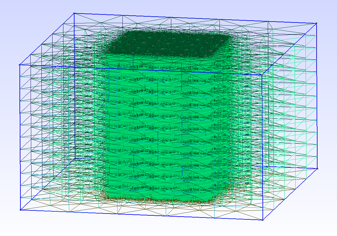

We can then generate a 3D mesh and save it to disk
gmsh.model.mesh.generate(3)… (click to toggle)

If everything runs well, you will see the following mesh.

Total Nodes 119886
Nr of lines 250
Nr. of prisms 221064
Material ID 25
Finally, the mesh file which has been created using the Python interface of Gmsh, will be converted to OGS mesh, in particular to VTU file format. Please, add the executable GMSH2OGS to the directory of this example file, or add the path to the OGS binary folder into the running environment. Here, option -v (--validation) validates the mesh and shows crucial information about the mesh. Option -i takes Gmsh input file name as a string and -o is the output file name as a string as well
info: Reading /var/lib/gitlab-runner/builds/t1_R7hwLX/1/ogs/build/release-all/web/content/docs/tutorials/bhe_meshing/notebook-bhe_meshing/bhe_mesh_file.msh.
info: 	... finished.
info: Nr. Nodes: 119886.
info: Nr. Elements: 221314.
info: Mem for mesh: 63 MiB
info: Time for reading: 1.452574 seconds.
info: Read 119886 nodes and 221314 elements.
info: Axis aligned bounding box: 	x [-100, 100) (extent 200)
	y [0, 200) (extent 200)
	z [-120, 4.94066e-324) (extent 120)
info: Edge length: [0.284716, 43.3385]
info: 	Lines: 250
info: 	Prisms: 221064
info: 	MaterialIDs: (221314 values) [0, 25]
info: Mesh Quality Control:
info: No errors found.
info: No holes found within the mesh.
info: Remark: Nodes n0 and n1 are considered to be 'collapsible' if the dist(n0, n1) is less than minimal edge length of elements in the mesh times 1e-6
The above conversion tool also shows that there exist 250 lines and 221064 prism elements. An assertion check is added here to make sure that the VTU format mesh file is properly created.
