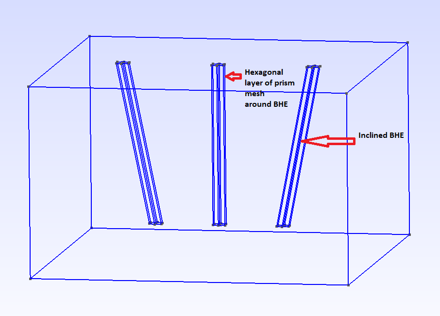

Now, 3 BHE surfaces have been created using parameters such as BHE coordinates, delta. The BHE node is surrounded by the 6 additional nodes in hexagonal shape which will create better mesh for optimal accuracy (Diersch et al. 2011 Part 2 DOI:10.1016/j.cageo.2010.08.002).
For each BHE node, 6 additional nodes and 6 corresponding line are added. After that, a curve loop is created using 6 lines. Then, the BHE surface is defined using that curve loop. Following the same method, BHE surface 2 and 3 have been created.

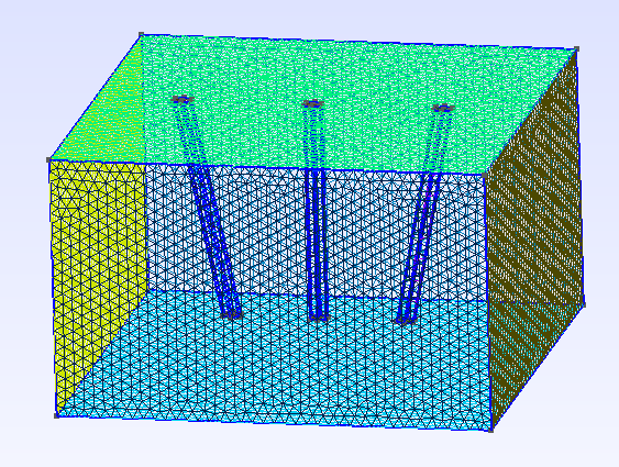

The gmsh.model.geo.extrude command extrudes BHE surface 1, 2 and 3 along the z axis and automatically creates a new volume (as well as all the needed points, curves and surfaces). The function takes a vector of (dim, tag) pairs as input as well as the translation vector, and returns a vector of (dim, tag) pairs as output. For the BHE 1 and 2 in translational vector, x-coordinate is set to 2 and -2 respectively in order to create inclined BHE along x-direction. As a result, the end point of BHEs will be deflected by 2 units along (+) and (-) x-direction.
The 2D mesh extrusion is done with the same extrude() function, but by specifying element ‘Layers’ (Here, one layer each with 10 subdivisions). The number of elements for each layer and the (end) height of each layer are specified in two vectors. The last (optional) argument for the extrude() function specifies whether the extruded mesh should be recombined or not. In this case, it is True since we want to recombine and produce prism mesh elements.
Later, BHE points 5, 12 and 19 have been extruded in the same way to create line elements (Lr, Ll and Lm) which represent BHEs.
P = gmsh.model.geo.extrude([(2, 2)], 2, 0, -10, [10], [1], True) # BHE surface 1… (click to toggle)
Q = gmsh.model.geo.extrude([(2, 3)], -2, 0, -10, [10], [1], True)  # BHE surface 2
R = gmsh.model.geo.extrude([(2, 4)], 0, 0, -10, [10], [1], True)  # BHE surface 3
Lr = gmsh.model.geo.extrude([(0, 5)], 2, 0, -10, [10], [1], True)  # BHE 1
Ll = gmsh.model.geo.extrude([(0, 12)], -2, 0, -10, [10], [1], True)  # BHE 2
Lm = gmsh.model.geo.extrude([(0, 19)], 0, 0, -10, [10], [1], True)  # BHE 3
gmsh.model.geo.synchronize()
Finally, geometry surface 1 is created by combining curve loop 1, 2, 3 and 4. Here, 2, 3, 4 are BHE curve loops and 1 is geometry curve loop. After that, 6 surfaces of geometry and 21 surfaces from 3 BHE hexagonal objects are combined to create a surface loop. Later, volume is added to the surface loop using API function gmsh.model.geo.addVolume. Before creating mesh, gmsh.model.geo.synchronize is used to synchronize the CAD entities with the Gmsh model, which will create the relevant Gmsh data structures.
gmsh.model.geo.addPlaneSurface([1, 2, 3, 4], 1)… (click to toggle)
sl = gmsh.model.geo.addSurfaceLoop(
        1,
        5,
        6,
        7,
        8,
        9,
        204,
        183,
        187,
        191,
        195,
        199,
        203,
        140,
        119,
        123,
        127,
        131,
        135,
        139,
        172,
        151,
        155,
        159,
        163,
        167,
        171,
v = gmsh.model.geo.addVolume([sl])
Later gmsh.model.addPhysicalGroup command used to group elementary geometrical entities to define material properties. Gmsh will export in output files only mesh elements that belong to at least one physical group. Physical groups are also identified by tags, i.e. strictly positive integers, that should be unique per dimension (0D, 1D, 2D or 3D). Here, BHE 1, 2 and 3 are tagged by 2, 3, 4 physical group respectively.
gmsh.model.addPhysicalGroup(3, [P[1][1], Q[1][1], R[1][1], v], 1)… (click to toggle)
gmsh.model.addPhysicalGroup(1, [Lr[1][1]], 2)
gmsh.model.addPhysicalGroup(1, [Ll[1][1]], 3)
gmsh.model.addPhysicalGroup(1, [Lm[1][1]], 4)
4

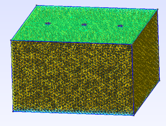

Then We can then generate a 3D mesh and save it to disk
gmsh.model.mesh.generate(3)… (click to toggle)

If everything runs well, you will see the following mesh with incline BHEs.

Finally, the mesh file which has been created using the python interface of Gmsh, will be converted to OGS mesh, in particular to VTU file format. Please, add ogs.exe to the directory of this example file to run GMSH2OGS or give the full path of your ogs executable. Here, option -v (–validation) validate the mesh and shows crucial information of mesh. Option -i takes Gmsh input file name as string and -o is output file name as string as well.
info: Reading /var/lib/gitlab-runner/builds/t1_R7hwLX/1/ogs/build/release-all/web/content/docs/tutorials/Inclined_bhe_meshing/notebook-inclined_bhe_meshing/inclined_bhe_mesh_file.msh.
info: 	... finished.
info: Nr. Nodes: 34992.
info: Nr. Elements: 191576.
info: Mem for mesh: 38 MiB
info: Time for reading: 1.943539 seconds.
info: Read 34992 nodes and 191576 elements.
info: Axis aligned bounding box: 	x [-10, 10) (extent 20)
	y [0, 20) (extent 20)
	z [-12, 4.94066e-324) (extent 12)
info: Edge length: [0.123254, 1.34033]
info: 	Lines: 30
info: 	Tetrahedrons: 191186
info: 	Pyramids: 180
info: 	Prisms: 180
info: 	MaterialIDs: (191576 values) [0, 3]
info: Mesh Quality Control:
info: No errors found.
info: No holes found within the mesh.
info: Remark: Nodes n0 and n1 are considered to be 'collapsible' if the dist(n0, n1) is less than minimal edge length of elements in the mesh times 1e-6
The above conversion tool also shows that there exist line, tetrahedrons, pyramids and prism elements.The number of lines, tetrahedrons, pyramids and prism element is respectively 30, 190918, 180 and 180 with no error.
