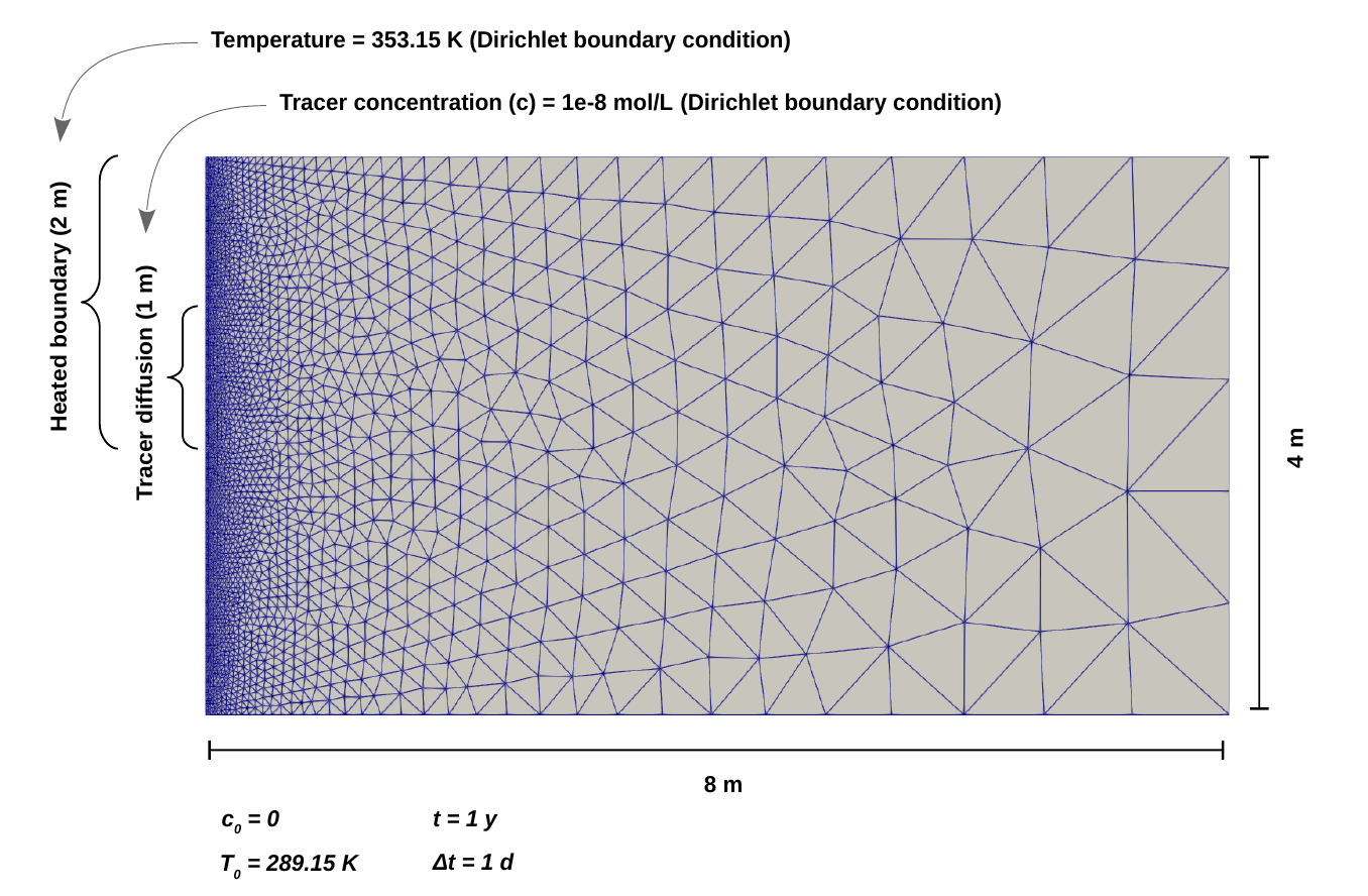

The benchmark follows the HT process in a first model to generate a temperature field (TemperatureField.prj). A 8 x 4 m 2D domain is selected with finer elements on the left side (borehole) for which a Dirichlet boundary condition is applied with a temperature of 353.15 K on the upper half (2 m). The initial temperature of the porous media is 289.15 K (see Figure 1) and all the other boundaries are defined as Neumann (no-flux). Opalinus Clay is selected as porous media and full saturation and instantaneous thermal equilibrium with its porewater is assumed. Properties of the Opalinus clay used in the first-step model are shown in Table 1.
In a second step, a non-reactive tracer is diffused through the domain with a initial concentration of $1 * 10^{-8}$ mol/L over 1 m located at the left boundary (see Figure 1). For the second-step model, the Component Transport process in OGS-6 is used.

The $0 \leq x \leq 8$ and $0 \leq y \leq 4$ triangle mesh with finer elements close to the borehole lateral (left-boundary) is used to i) avoid numerical errors and ii) to gain favorable computational performance. An implicit Euler scheme is used for the time discretization with a time horizon of 1 y and fixed time steps of 1 d.
Domain Mesh
Figure 1: Representation of the model setup.

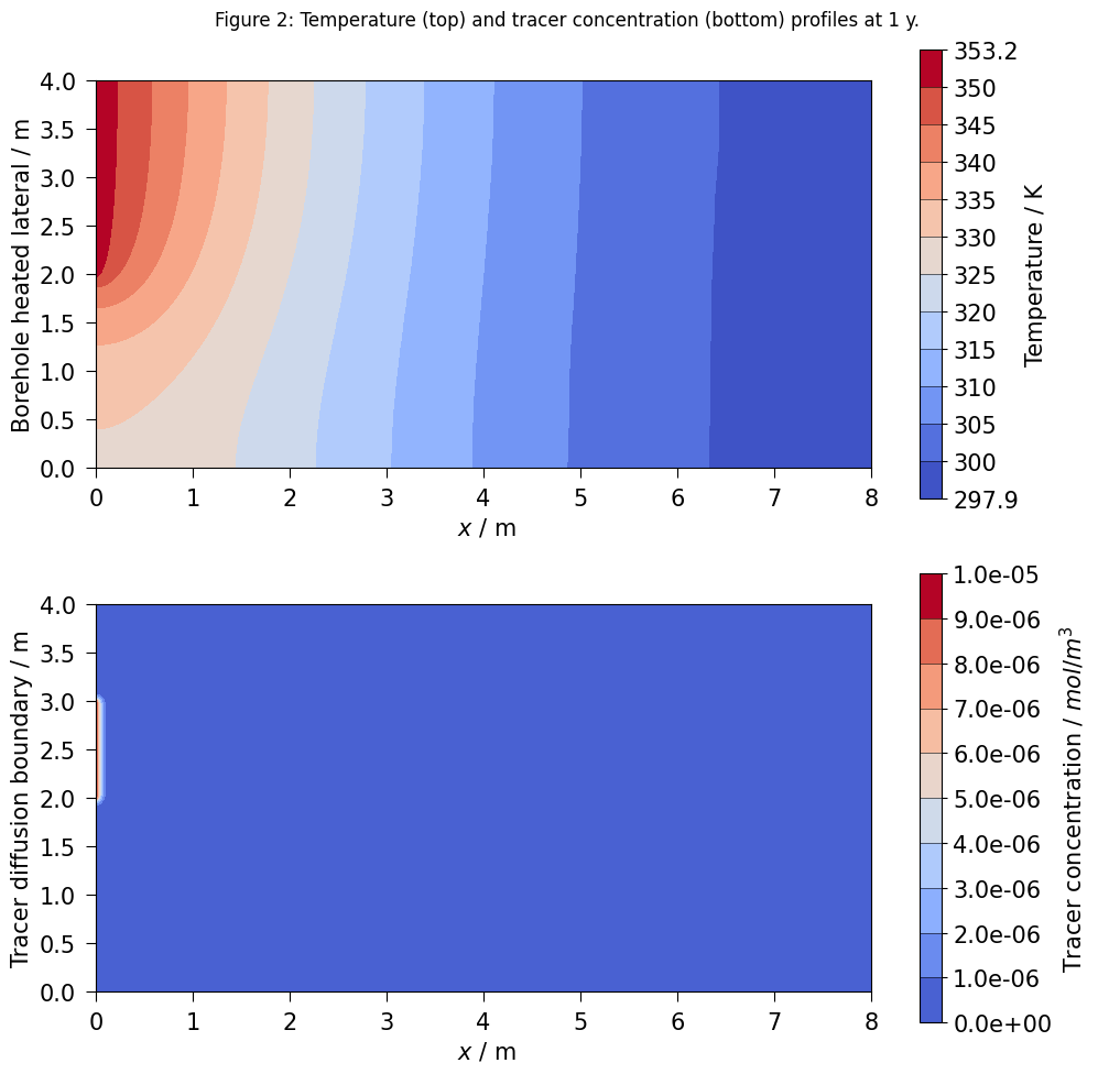

Figure 2 shows both, the temperature field (top) and the concentration profile in the Opalinus-Clay porewater (bottom) computed after 1 year. The results clearly shown that the diffusion of the tracer is confined into the “Borehole-Clay interface”. The tracer penetrates at $\approx 0.2$ $m$ in the $x$ direction when measured in the center of the diffusion range boundary. Recall that isotropic diffusion is assumed in this example.
mesh = ot.MeshSeries(out_dir / "TemperatureField.pvd").mesh(5)
mesh2 = ot.MeshSeries(out_dir / "TemperatureField_transport.pvd").mesh(5)
fig, (ax1, ax2) = plt.subplots(2, 1, figsize=(10, 10))… (click to toggle)
ot.plot.contourf(mesh, "T", fig=fig, ax=ax1, fontsize=15)
ax1.set_ylabel("Borehole heated lateral / m")
cbar1 = fig.axes[-1]
cbar1.set_ylabel("Temperature / K", fontsize=15)
ot.plot.contourf(mesh2, "Cs", fig=fig, ax=ax2, fontsize=15, vmin=0)
ax2.set_ylabel("Tracer diffusion boundary / m", fontsize=15)
cbar2 = fig.axes[-1]
cbar2.set_ylabel(r"Tracer concentration / $mol/m^3$", fontsize=15)
fig.suptitle(
    "Figure 2: Temperature (top) and tracer concentration (bottom) profiles at 1 y."
plt.tight_layout()

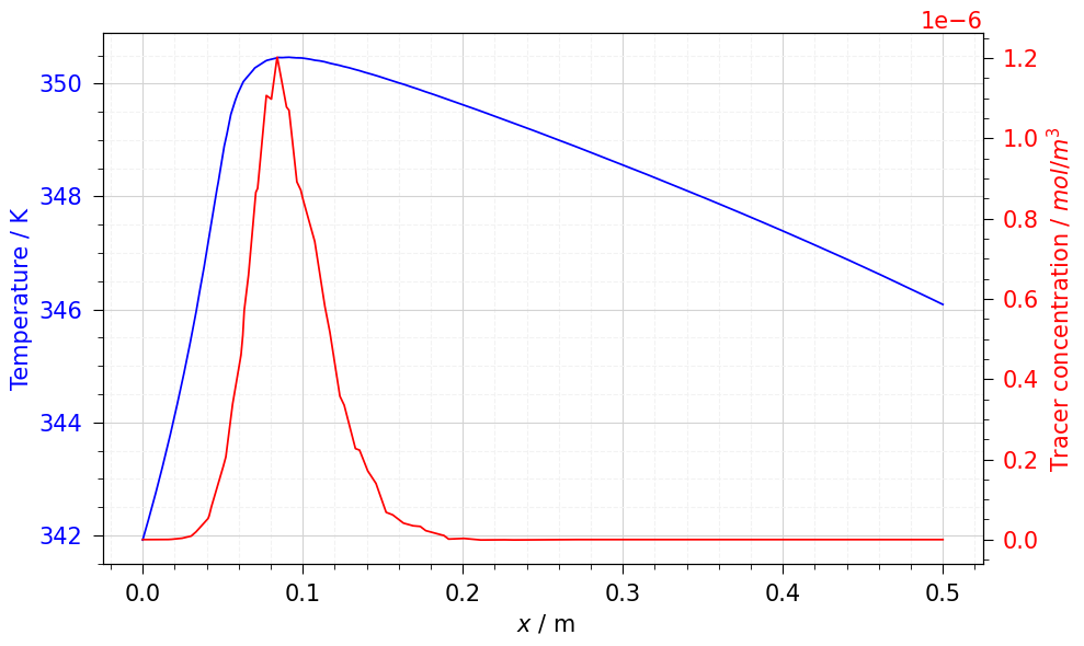

sample_temp = mesh.sample_over_line([0, 1.75, 0], [0.5, 4, 0])… (click to toggle)
sample_conc = mesh2.sample_over_line([0, 1.75, 0], [0.5, 3.25, 0])
fig2, ax1 = plt.subplots(figsize=(10, 6))
# First line in blue
ot.plot.line(sample_temp, "T", ax=ax1, color="blue", linewidth=0.5, fontsize=15)
ax1.set_ylabel("Temperature / K", color="blue")
ax1.tick_params(axis="y", labelcolor="blue")
# Second line in red
ax2 = ax1.twinx()
ot.plot.line(sample_conc, "Cs", ax=ax2, color="red", linewidth=0.5, fontsize=15)
ax2.set_ylabel(r"Tracer concentration / $mol/m^3$", color="red")
ax2.tick_params(axis="y", labelcolor="red")
ax2.grid(False, which="both")
plt.tight_layout()

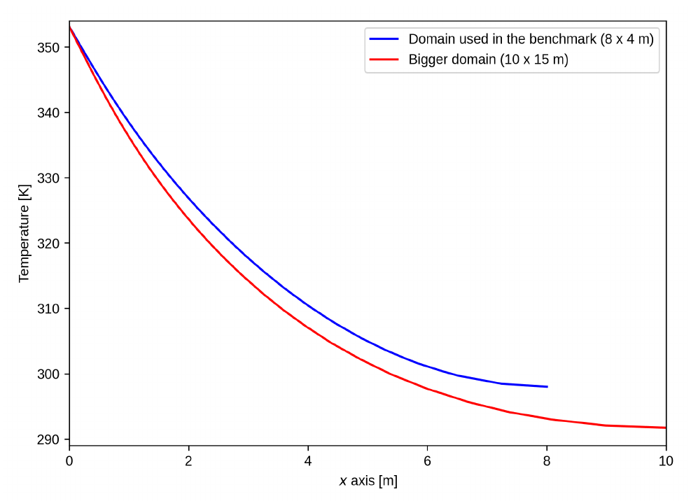

Domain size sensitivity analysis
A sufficient domain size was used in this exercise to neglect the effect of the no-flux boundary conditions on the temperature profile. However, the top, bottom and right boundaries do have a small effect on the computed temperature profile (i.e., temperature at the right boundary is different than the initial temperature). Nonetheless, the size of the domain in this benchmark was selected due to its favorable computational properties.
For comparison purposes, Figure 3 shows the temperature profiles (along a line in the center of the diffusion boundary) for the 8 x 4 m domain used in this description and a bigger domain size (10 x 15 m), which is of sufficient dimensions to neglect the Neumann boundaries on the temperature profile. Using the bigger domain size results in a computational time more than 5 times greater than the current benchmark. In Figure 3, however, note that the temperature difference between the two 3 cases is minimal at the diffusion zone of the tracer (0 - 0.2 m).
Different domain
Figure 3: Temperature profiles for different domain sizes at the center of the diffusion boundary.
