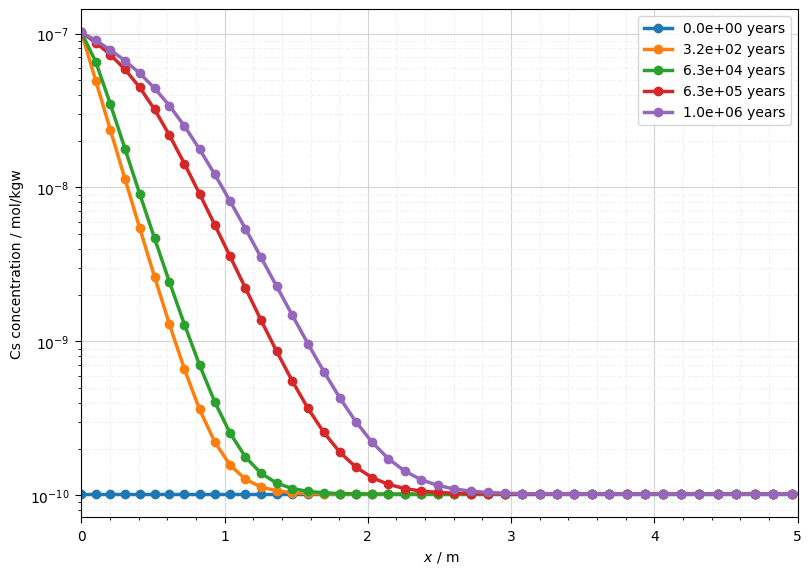

Plot the results
Here we plot the last timestep of the above simulation and the timesteps of the full simulation.
cs_var = ot.variables.Scalar("Cs", output_name="Cs concentration / mol/kgw")
cs_fig = plot_results(cs_var, x_max=5)
The results show that Cs-135 does not migrate for more than 3 m even after 1 million years.

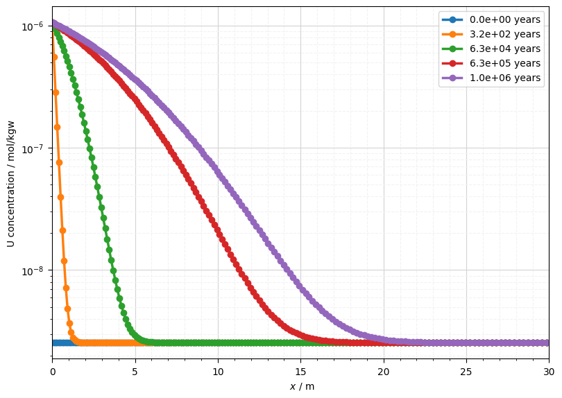

Plot the results
Again, the full simulation results are provided in /U_full_simulation. They are plotted to show the migration of U after 1 million years.
U_var = ot.variables.Scalar("U", output_name="U concentration / mol/kgw")
U_fig = plot_results(U_var, x_max=30)
In this case, it is clear that the migration of U-238 is much more pronounced than Cs-135. After 1 million years, U-238 shows a breakthrough to around 20 m.
