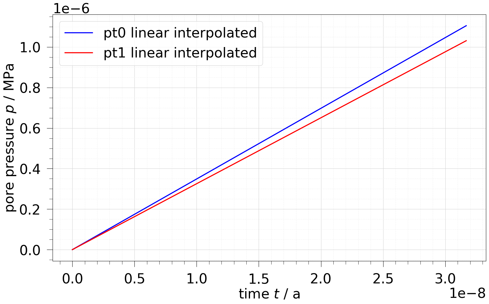

mesh_series = ot.MeshSeries(f"{out_dir}/{prj_name}.pvd").scale(time="a")… (click to toggle)
labels = [f"{label} linear interpolated" for label in ["pt0", "pt1"]]
ms_pts = ot.MeshSeries.probe(mesh_series, points_coords)
fig = ot.plot.line(
    ms_pts, "time", ot.variables.pressure, labels=labels, colors=["b", "r"]
