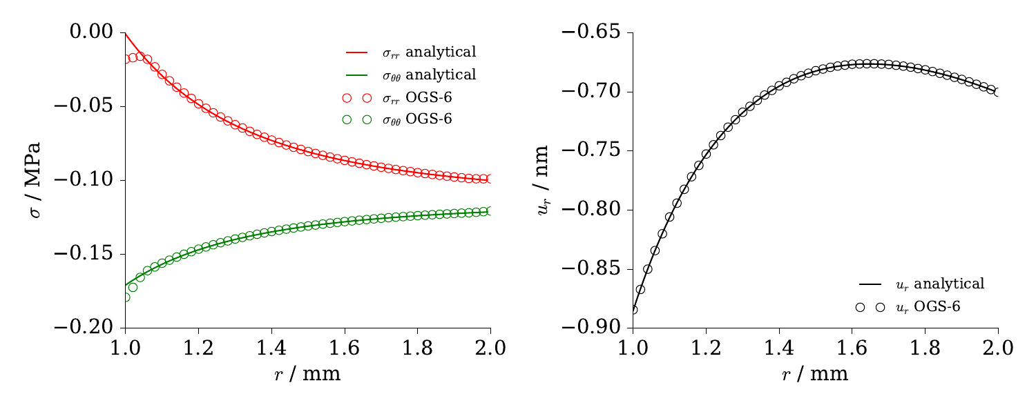

Plain strain elastic cylinder comparison between numerical and analytical results:

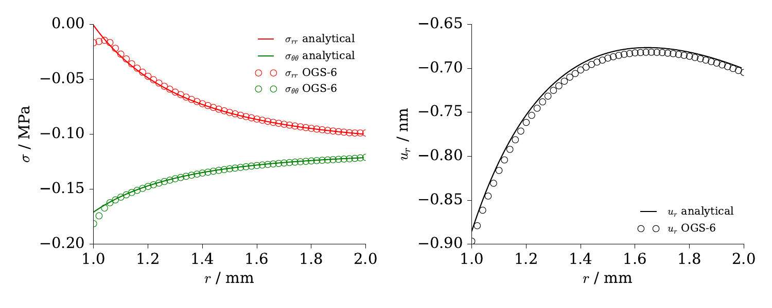

Axisymmetric elastic cylinder comparison between numerical and analytical results.

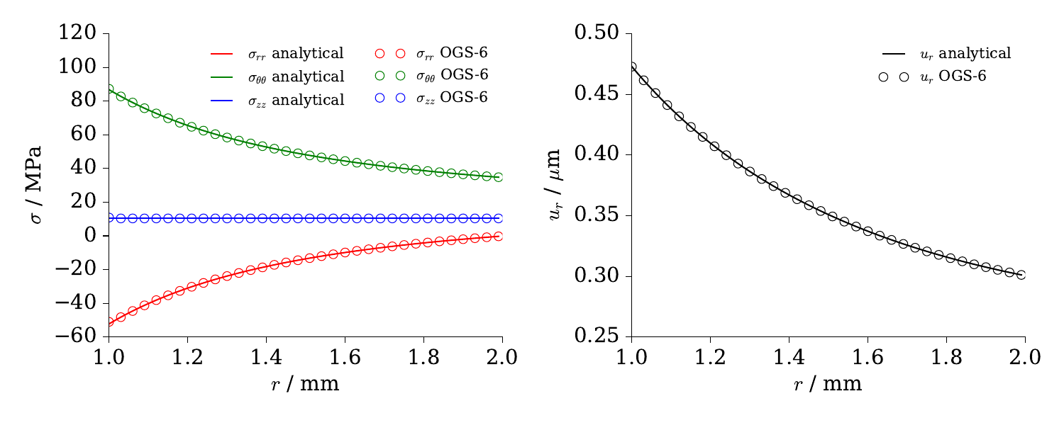

Axisymmetric elastic sphere comparison between numerical and analytical results:
Tri-dimensional elastic sphere comparison between numerical and analytical results:

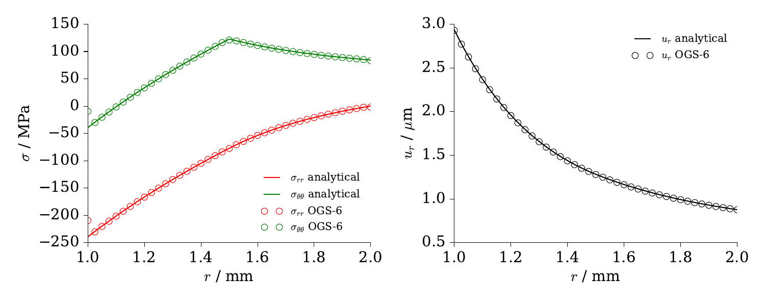

Axisymmetric plastic sphere comparison between numerical and analytical results:

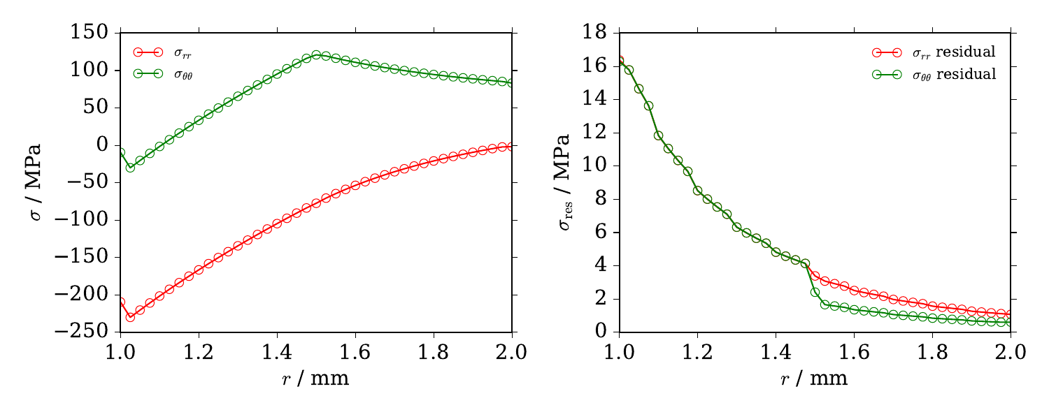

Axisymmetric plastic sphere residuals of stress:
