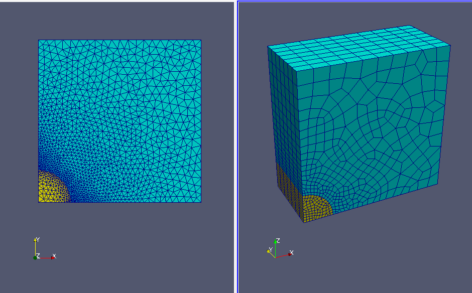

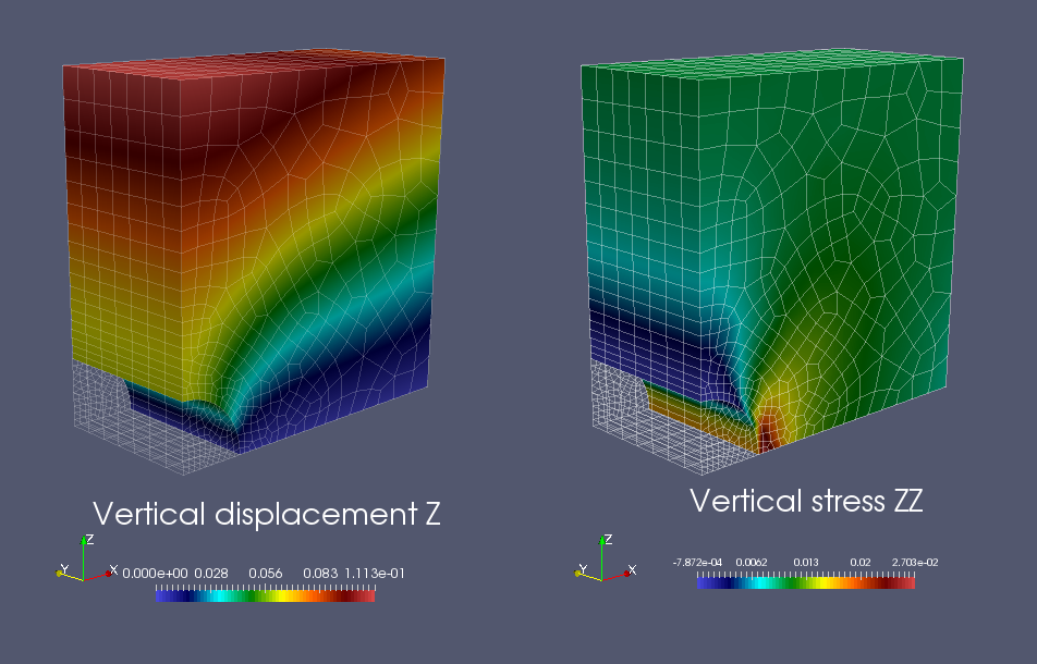

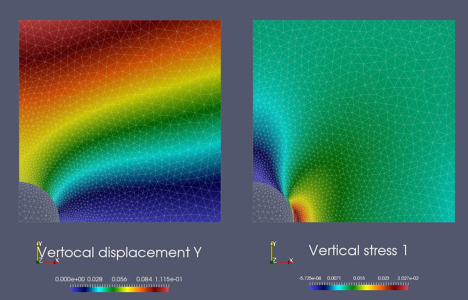

The problem definition is exactly the same as that of Disc with hole. With the element deactivation approach, the problem is solved as 2D and 3D benchmarks, respectively.

Mesh
2D and 3D meshes
2D results
3D results:
