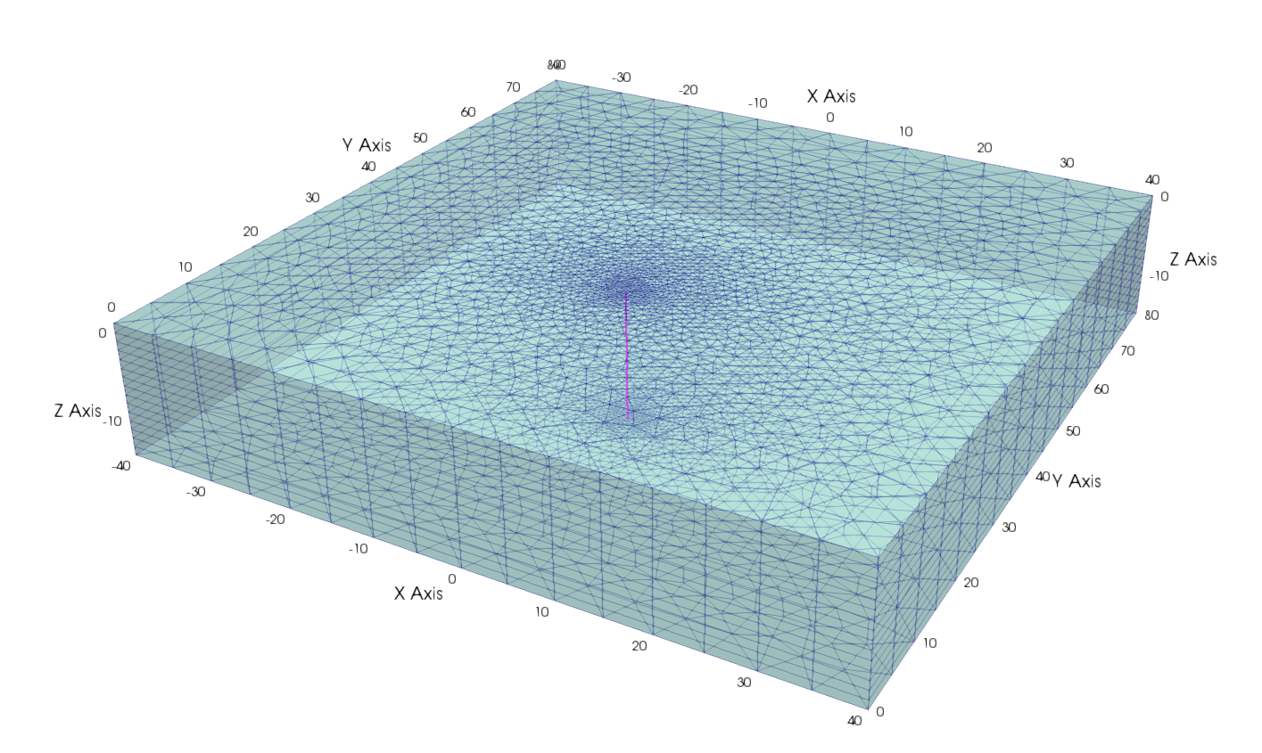

The input files for the full simulation including the analytical solution for the soil temperature can be found here. The geometry of the model is illustrated in Figure 1. The depth of the model domain is 15 m with an areal extent of 80 m x 80 m. The BHE is 1U-type and is represented by a straight line located at $x=0$ m and $y=30$ m. In this benchmark the groundwater flow is set in the $y$ direction. Accordingly, the mesh was intentionally extended downstream of the BHE, so that the boundary effects on the ground temperature distribution can be neglected even for the long-term simulation. Detailed parameters for the soil heat transport model can be found in the following table.

Geometry and mesh of the BHE model

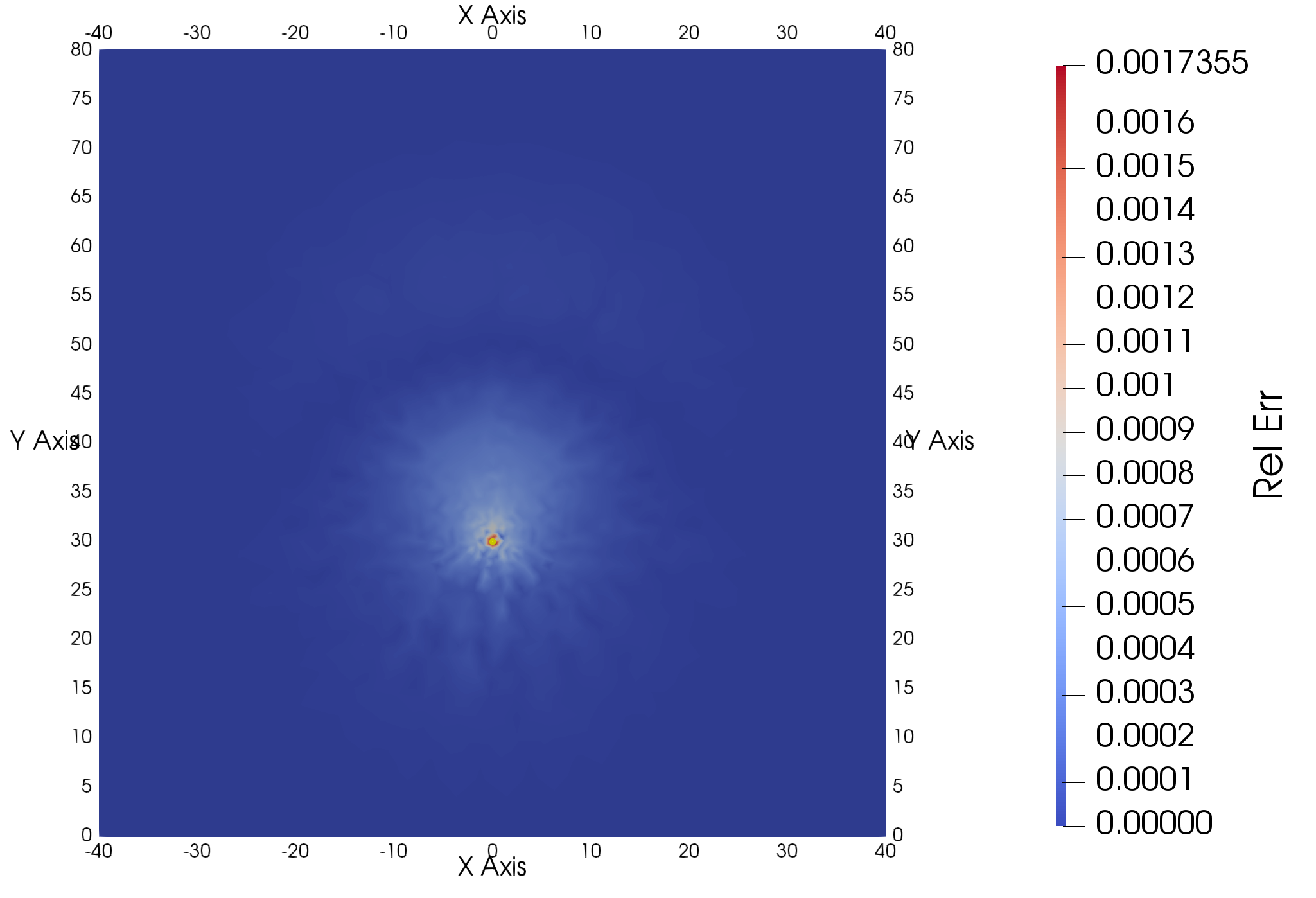

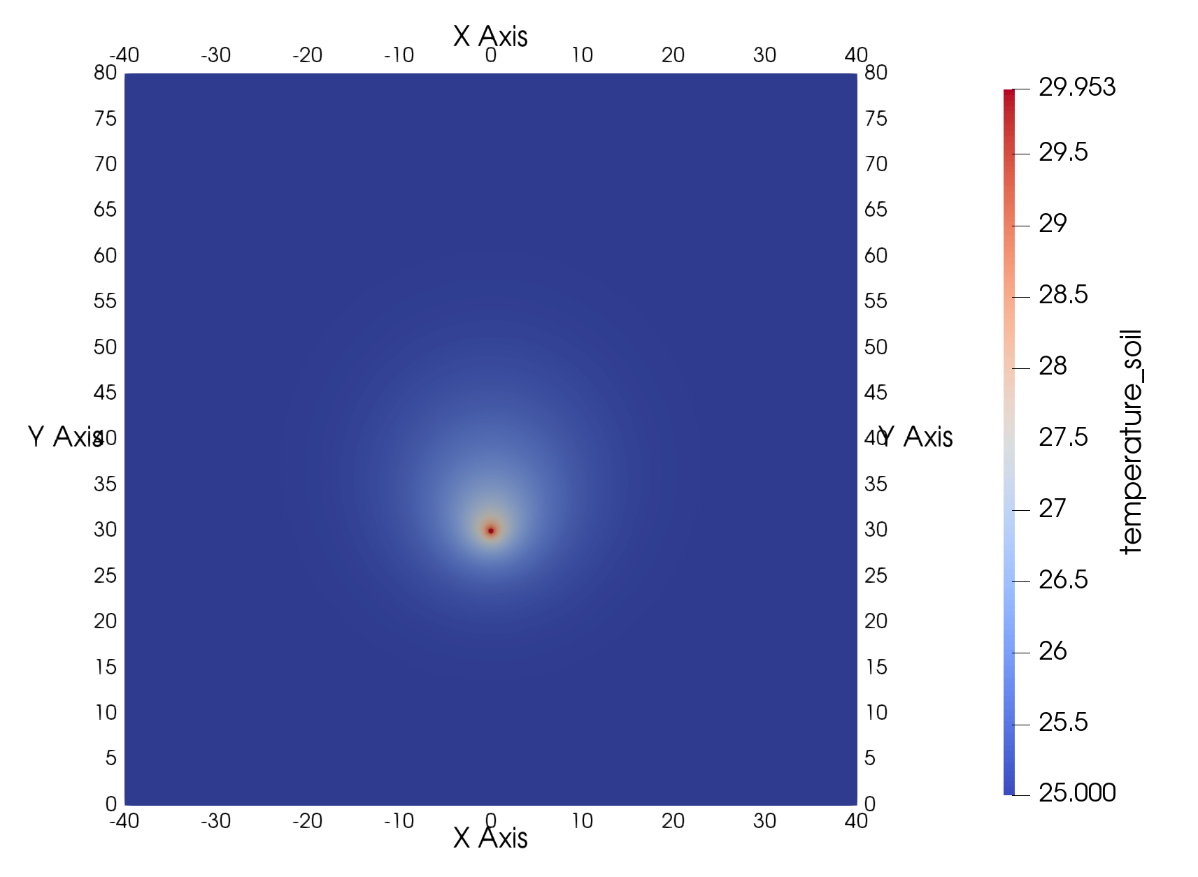

In Figure 2, the numerically simulated ground temperature distribution from OGS-6 is shown for the $z=-7$ m plane after $t=2$ years. Also, the result is compared with the moving line source analytical solution (evaluated using MATLAB®) in Figure 3. The comparison demonstrates that the numerical results and analytical solution match very well as the maximum relative error of ground temperature is less than 0.2 %. The largest difference is found near the BHE node towards which the analytical solution approaches infinity.
Ground temperature distribution after two years at $z=-7$ m.
Comparison of OGS-6 results and analytical solution. Note the singularity of the analytical solution at the BHE node.
