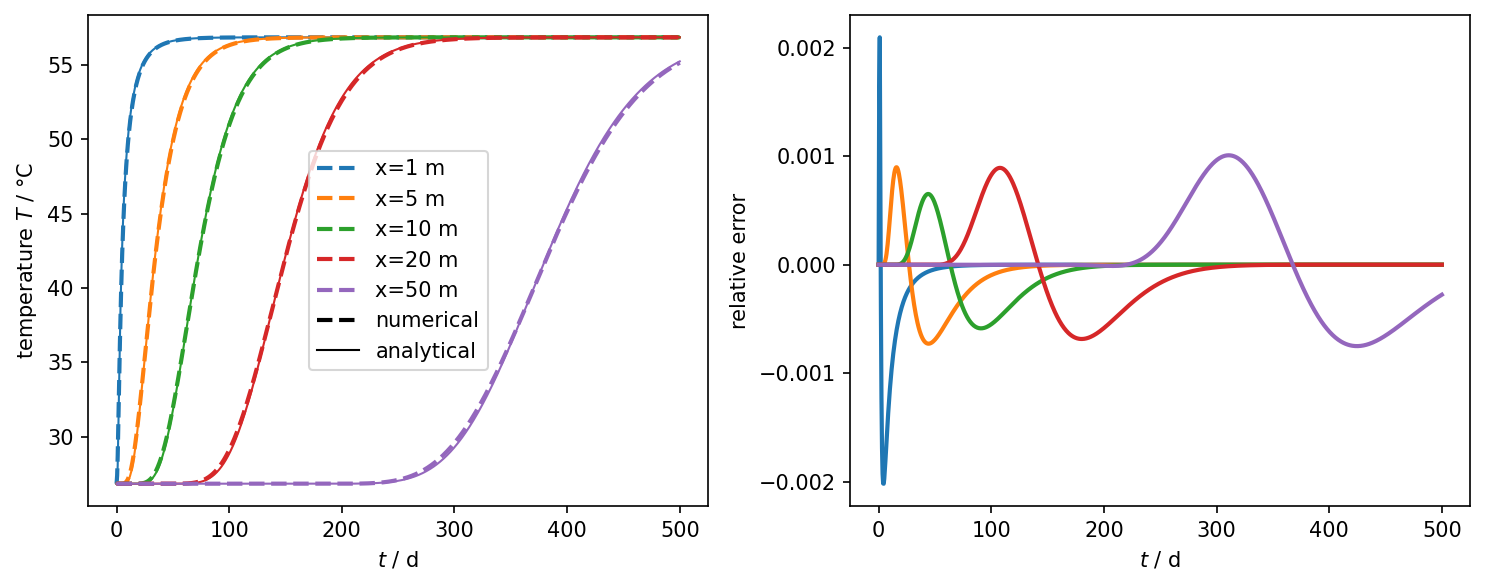

Temperature over time at different locations
obs_pts = np.asarray([[x, 0, 0] for x in [1, 5, 10, 20, 50]])… (click to toggle)
num_values = ms.probe_values(obs_pts, "temperature").T
ref_values = [ogata_banks_analytical(ms.timevalues, x) for x in obs_pts[:, 0]]
ms = ms.scale(time="days")
time = ms.timevalues
plot_results_errors(time, num_values, ref_values, leg_labels, "$t$ / d")

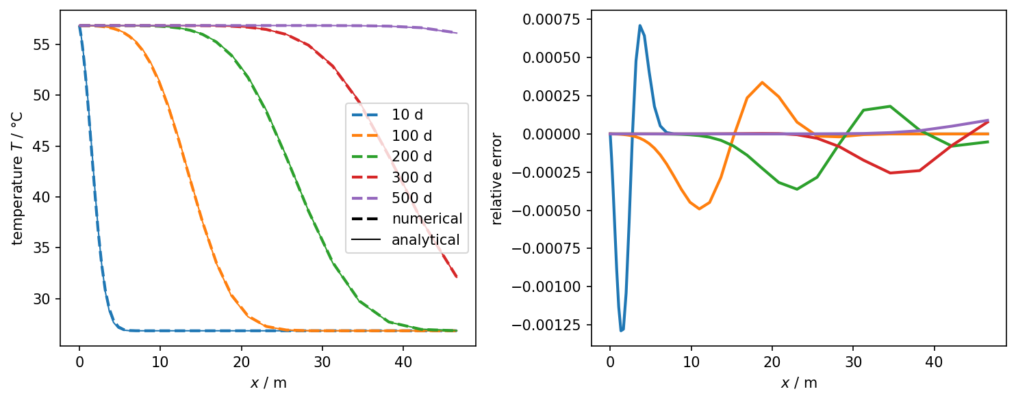

Temperature over x at different timesteps
timevalues = np.asarray([10, 100, 200, 300, 500])… (click to toggle)
all_pts = ms.mesh(0).points
pts = all_pts[(all_pts[:, 0] <= 50) & (all_pts[:, 1] == 0)]
line = pv.PointSet(pts)
num_values = [line.sample(ms.mesh(ts))["temperature"] for ts in timesteps]
ref_values = [ogata_banks_analytical(tv * 86400, pts[:, 0]) for tv in timevalues]
leg_labels = [f"{tv} d" for tv in timevalues]
plot_results_errors(pts[:, 0], num_values, ref_values, leg_labels, "$x$ / m")

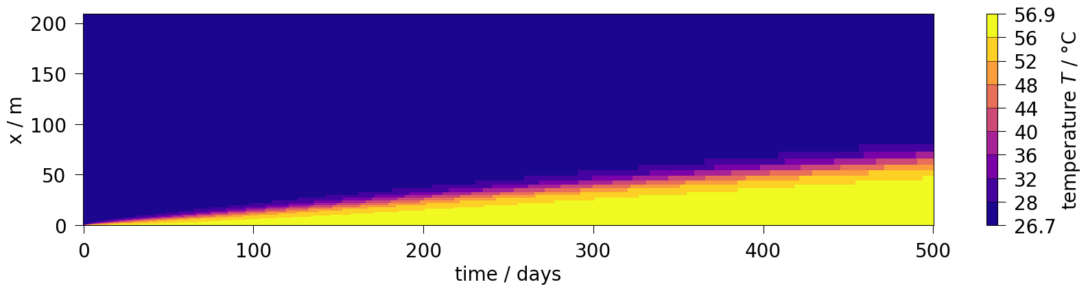

Temperature over time and space
fig = ms.plot_time_slice("time", "x", var, figsize=(20, 4), fontsize=20)
