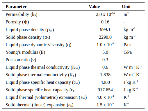

We considered the following set of values as input parameters:

        # material parameters
        self.phi = 0.16  # porosity of soil
        self.k = 2e-20  # coefficient of permeability
        self.eta = 1e-3  # viscosity water at 20 deg
        self.E = 5.0e9  # Youngs modulus
        self.nu = 0.3  # Poisson ratio
        self.rho_w = 999.1  # density of pore water
        self.c_w = 4280  # specific heat of pore water
        self.K_w = 0.6  # thermal conductivity of pore water
        self.rho_s = 2290.0  # density of solid matrix
        self.c_s = 917.654  # specific heat capacity of solid matrix
        self.K_s = 1.838  # themal conductivity of solid matrix
        # volumetric expansivity of matrix - conversion from linear volumetric
        self.a_s = 3 * 1.5e-5
        # coefficient of volume expansion of pore water (beta_w)
        self.a_w = 4.0e-4
        # initial and boundary condition
        # strength of heat source - value corrected to account for domain size
        self.Q = 2 * 150  # [Q] = W
        self.T0 = 273.15  # initial temperature
        self.Init()

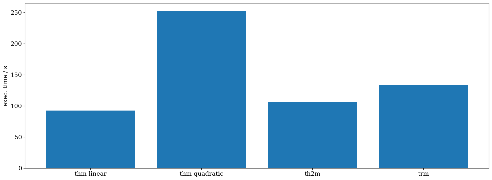

for process_key, model in models.items():
    model.set(t_end=t_end)
    model.set(output_prefix=f"point_heatsource_{process_key}")
# Run models in parallel via concurrent.futures(click to toggle)
ogs_models = [
        "prj": model.prjfile,
        "logfile": f"{out_dir}/{process_key}-out.txt",
        "args": f"-o {out_dir} -m {dirs[process_key]} -s {dirs[process_key]}",
def run_ogs(model):
    print(f"Starting {model['prj']} ...\n")
    start_sim = timer()
    # Starting via ogs6py does not work ("cannot pickle lxml"), at least on mac.
    command = f"ogs {model['prj']} {model['args']} > {model['logfile']}"
    run(command, shell=True, check=True)
    runtime = timer() - start_sim
    return [f"Finished {model['prj']} in {runtime} s", runtime]

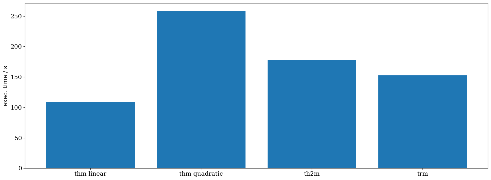

runtimes = []
start = timer()
with concurrent.futures.ThreadPoolExecutor() as executor:
    outputs = executor.map(run_ogs, ogs_models)
    for output in outputs:
        print(output[0])
        runtimes.append(output[1])
print(f"Elapsed time for all simulations: {timer() - start} s")
Starting /var/lib/gitlab-runner/builds/K-X1vcp78/0/ogs/build/release-all/Tests/Data/ThermoHydroMechanics/Linear/Point_injection/SaturatedPointheatsource/point_heatsource_thm_lin.prj ...
Starting /var/lib/gitlab-runner/builds/K-X1vcp78/0/ogs/build/release-all/Tests/Data/ThermoHydroMechanics/Linear/Point_injection/SaturatedPointheatsource/point_heatsource_thm_quad.prj ...
Starting /var/lib/gitlab-runner/builds/K-X1vcp78/0/ogs/build/release-all/Tests/Data/ThermoHydroMechanics/Linear/Point_injection/SaturatedPointheatsource/point_heatsource_th2m.prj ...
Starting /var/lib/gitlab-runner/builds/K-X1vcp78/0/ogs/build/release-all/Tests/Data/ThermoHydroMechanics/Linear/Point_injection/SaturatedPointheatsource/point_heatsource_trm.prj ...
Finished /var/lib/gitlab-runner/builds/K-X1vcp78/0/ogs/build/release-all/Tests/Data/ThermoHydroMechanics/Linear/Point_injection/SaturatedPointheatsource/point_heatsource_thm_lin.prj in 92.49079221393913 s
Finished /var/lib/gitlab-runner/builds/K-X1vcp78/0/ogs/build/release-all/Tests/Data/ThermoHydroMechanics/Linear/Point_injection/SaturatedPointheatsource/point_heatsource_thm_quad.prj in 252.55577744590119 s
Finished /var/lib/gitlab-runner/builds/K-X1vcp78/0/ogs/build/release-all/Tests/Data/ThermoHydroMechanics/Linear/Point_injection/SaturatedPointheatsource/point_heatsource_th2m.prj in 106.43324858462438 s
Finished /var/lib/gitlab-runner/builds/K-X1vcp78/0/ogs/build/release-all/Tests/Data/ThermoHydroMechanics/Linear/Point_injection/SaturatedPointheatsource/point_heatsource_trm.prj in 134.06140497513115 s
Elapsed time for all simulations: 252.5584027939476 s

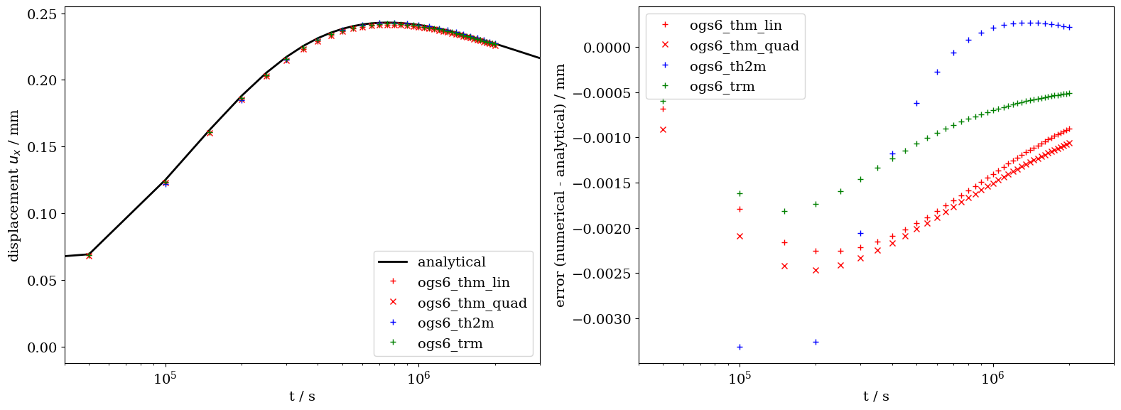

The analytical expressions together with the numerical model can now be evaluated at different points as a function of time (time series) or for a given time as a function of their spatial coordinates (along radial axis).
results = {(click to toggle)
results = {
    process_key: ot.MeshSeries(f"{out_dir}/point_heatsource_{process_key}.pvd")
    for process_key in models

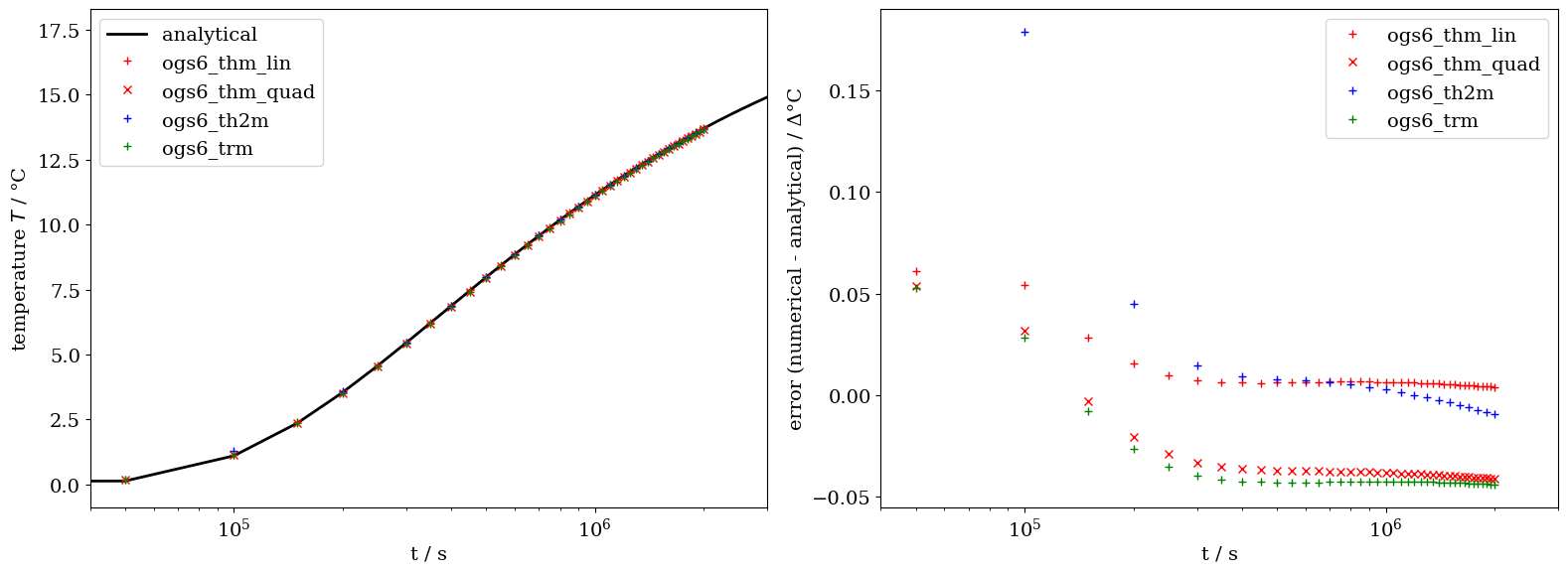

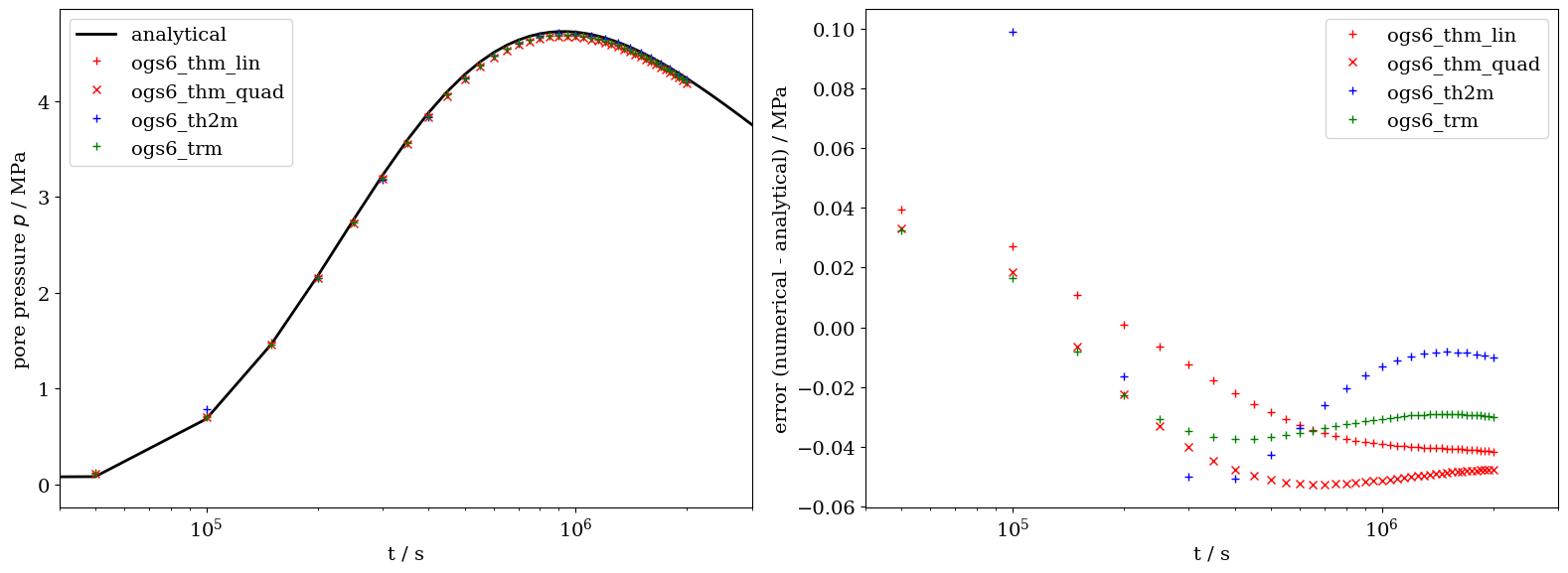

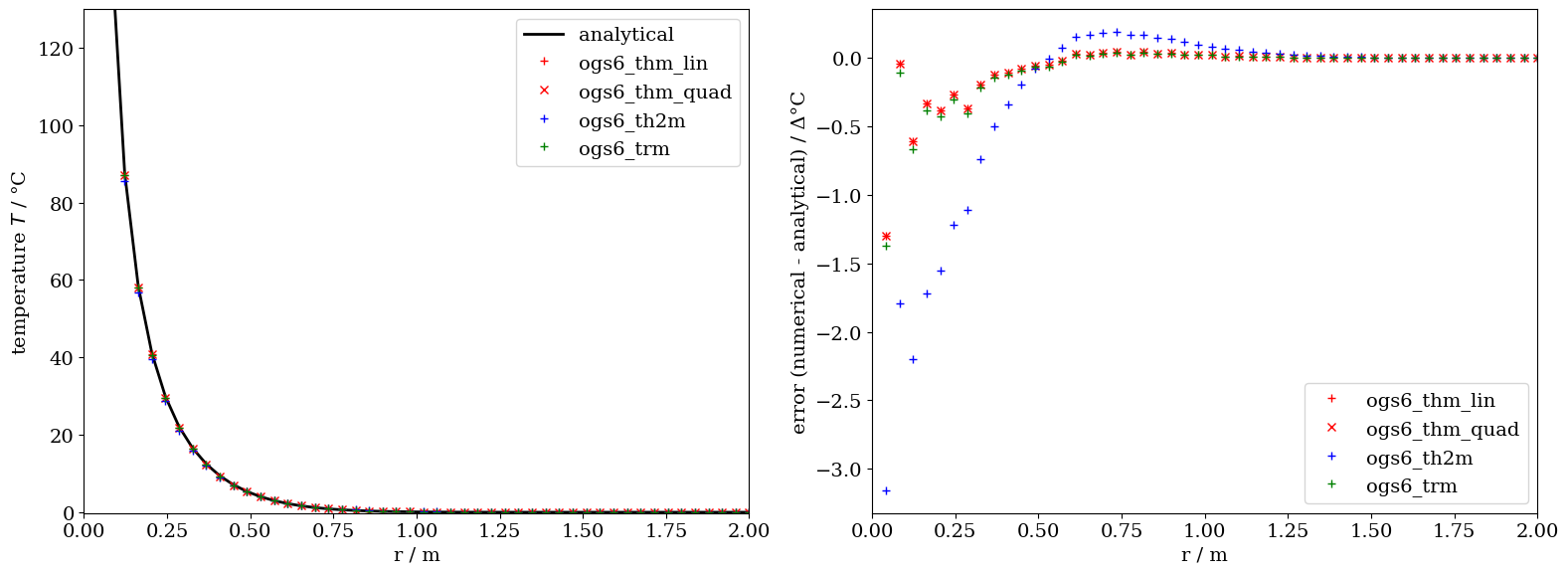

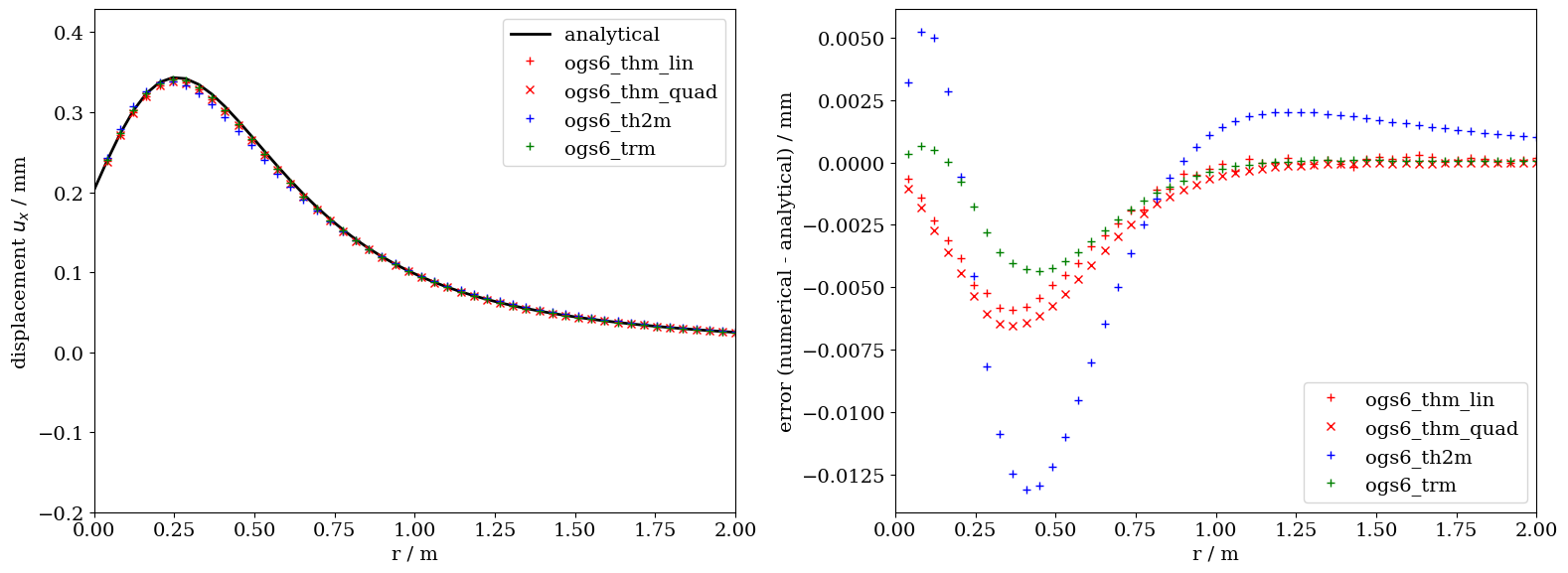

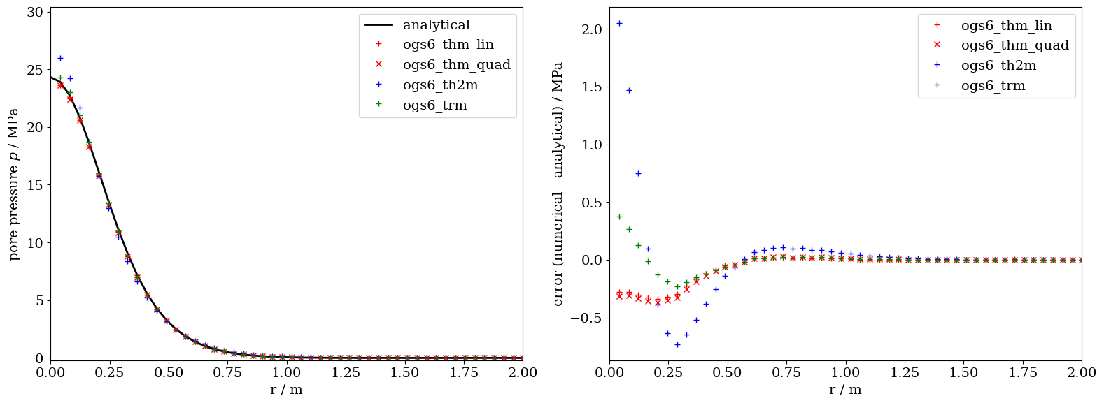

Time series plots for temperature, pressure and displacement
Comparison between the analytical solution and the numerical solution shows very good agreement, as displayed below in the figures.
plt.rcParams["lines.linewidth"] = 2.0(click to toggle)
t_i, p_i = ("temperature_interpolated", "pressure_interpolated")
data_names = {
    "thm_lin": {"T": "temperature", "p": "pressure", "u": "displacement"},
    "thm_quad": {"T": t_i, "p": p_i, "u": "displacement"},
    "th2m": {"T": t_i, "p": f"gas_{p_i}", "u": "displacement"},
    "trm": {"T": t_i, "p": p_i, "u": "displacement"},
variables: dict[str, ot.variables.Variable] = {
    "T": ot.variables.temperature,
    "p": ot.variables.pressure,
    "u": ot.variables.displacement["x"].replace(output_unit="mm"),
style = {"thm_lin": "r+", "thm_quad": "rx", "th2m": "b+", "trm": "g+"}
pt = [0.5, 0.5, 0.0]
t = np.linspace(1, 50000 * 200, num=201, endpoint=True)
def plot_over_time(
    var_key: str, ana_sol: np.ndarray, err_bounds: list[float]
) -> plt.Figure:
    fig, axs = plt.subplots(ncols=2, figsize=(16, 6))
    var = variables[var_key]
    # only do unit conversion here
    ana_sol = var.replace(func=lambda _: _).transform(ana_sol)
    axs[0].plot(t, ana_sol, "k", label="analytical")
    for key, ms in results.items():
        values = var.transform(ms.probe_values(pt, data_names[key][var_key]))
        error = values - np.interp(ms.timevalues, t, ana_sol)
        assert np.all((error > err_bounds[0]) & (error < err_bounds[1]))
        axs[0].plot(ms.timevalues, values, style[key], label=f"ogs6_{key}")
        axs[1].plot(ms.timevalues, error, style[key], label=f"ogs6_{key}")
    axs[0].set_ylabel(var.get_label())
    axs[1].set_ylabel(f"error (numerical - analytical) / {var.difference.output_unit}")
    for ax in axs:
        ax.set_xlim(4.0e4, 3.0e6)
        ax.set_xscale("log")
        ax.set_xlabel("t / s")
        ax.legend()
    return fig
T_fig = plot_over_time("T", ana_model.temperature(*pt, t), [-0.06, 0.2])
T_fig.tight_layout()
p_fig = plot_over_time("p", ana_model.porepressure(*pt, t), [-0.06, 0.1])
p_fig.tight_layout()
u_fig = plot_over_time("u", ana_model.u_i(*pt, t, "x"), [-0.0035, 0.0005])
u_fig.tight_layout()
Plots for temperature, pressure and displacement along the radial axis
The comparison between the analytical and the numerical results along the radial axis generally shows good agreement. The differences observed can be primarily explained by mesh discretization and finite size effects. This is particularly the case for the th2m simulation results, where the differences are slightly more emphasized which is the results of larger time steps.
# Time stamp for the results along the radial axis(click to toggle)
# Radial coordinates for plotting
x = np.linspace(start=0.0001, stop=2.0, num=50)
t_i = 1.0e5
def plot_over_line(
) -> plt.Figure:
    axs[0].plot(x, ana_sol, "k", label="analytical")
        mesh = ms.mesh(ms.closest_timestep(t_i))
        obs_pts = pv.PolyData([(x_i, 0, 0) for x_i in x[1:]]).sample(mesh)
        values = var.transform(obs_pts[data_names[key][var_key]]).ravel()
        pts_x = obs_pts.points[:, 0]
        error = values - np.interp(pts_x, x, ana_sol)
        # do not check first entry, which corresponds to the origin
        assert np.all((error[2:] > err_bounds[0]) & (error[2:] < err_bounds[1]))
        axs[0].plot(pts_x, values, style[key], label=f"ogs6_{key}")
        axs[1].plot(pts_x, error, style[key], label=f"ogs6_{key}")
    axs[0].set_ylim([-0.2, min(130, max(ana_sol) * 1.25)])
    for ax in axs:
        ax.set_xlim([0.0, 2.0])
        ax.set_xlabel("r / m")
        ax.legend()
    return fig
T_fig = plot_over_line("T", ana_model.temperature(x, 0, 0, t_i), [-2.5, 0.5])
p_fig = plot_over_line("p", ana_model.porepressure(x, 0, 0, t_i), [-1.0, 2.5])
u_fig = plot_over_line("u", ana_model.u_i(x, 0, 0, t_i, "x"), [-0.015, 0.01])
Execution times
To compare the performance of the different numerical solutions implemented in OGS6, we compare the execution time of the simulations. The linear thm and trm solutions perform best, while the quadratic thm and th2m solutions take significantly longer time to run. It is also important to mention here, that the time step size selected for the th2m solution are twice as big as the other 3 implementation, yet simulation time still takes longer than any of the other solution.
fig, ax = plt.subplots(figsize=(16, 6))(click to toggle)
ax.bar(["thm linear", "thm quadratic", "th2m", "trm"], runtimes)
ax.set_ylabel("exec. time / s")
