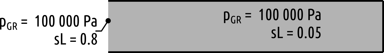

Problem Parameters
Property Symbol Value Unit
Initial saturation $$s_\mathrm{L}(t=0)$$ 0.05 1
Injection boundary saturation $$s_\mathrm{L}(x=0)$$ 0.8 1

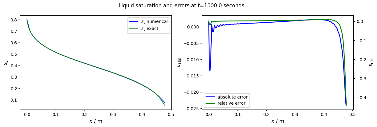

# Read the OGS results and sample the last timestep on the same points as in(click to toggle)
# the reference.
ms = ot.MeshSeries(f"{out_dir}/result_McWhorter_H2.pvd")
pts = pv.PointSet([(x, 0, 0) for x in ref_x])
sL_num = pts.sample(ms.mesh(-1))["saturation"]
# Absolute and relative errors
err_abs = ref_saturation - sL_num
err_rel = err_abs / ref_saturation
assert np.all(np.abs(err_rel) < 0.5)
fig, (ax1, ax2) = plt.subplots(1, 2, figsize=(14, 4))(click to toggle)
ax3 = ax2.twinx()
ax1.plot(ref_x, sL_num, "b", label=r"$s_\mathrm{L}$ numerical")
ax1.plot(ref_x, ref_saturation, "g", label=r"$s_\mathrm{L}$ exact")
lns_abs = ax2.plot(ref_x, err_abs, "-b", lw=2, label=r"absolute error")
lns_rel = ax3.plot(ref_x, err_rel, "-g", lw=2, label=r"relative error")
lns = lns_abs + lns_rel
ax1.legend()
ax1.set_xlabel("$x$ / m", fontsize=12)
ax1.set_ylabel(r"$s_\mathrm{L}$", fontsize=12)
ax2.set_xlabel("$x$ / m", fontsize=12)
ax2.set_ylabel(r"$\epsilon_\mathrm{abs}$", fontsize=12)
ax3.set_ylabel(r"$\epsilon_\mathrm{rel}$", fontsize=12)
time = ms.timevalues[-1]
fig.suptitle(f"Liquid saturation and errors at t={time} seconds")
Text(0.5, 0.98, 'Liquid saturation and errors at t=1000.0 seconds')
The numerical approximation fits the analytical solution very well in the whole area. Only in the area of the saturation front are deviations recognisable. These deviations are mainly due to the grid resolution and are well known in multiphase simulations. The error can be reduced almost arbitrarily by lowering the size of the grid elements.
