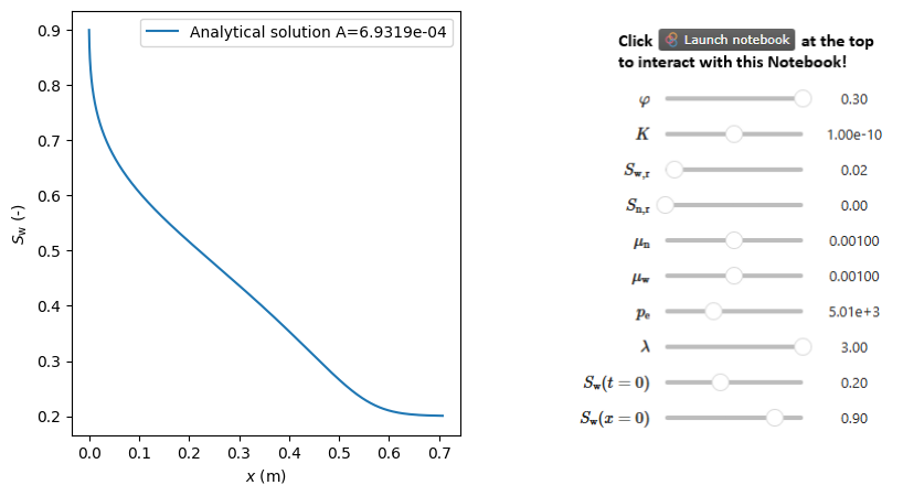

The analytical solution is calculated according to McWhorter and Sunada . The initial saturation is Si in the domain. At $t=0$ the saturation at $x=0$ becomes S0. The analytical solution is calculated for $t=1000$ s.
def plot_f(mun, muw, K, phi, lambda_, Pe, S0, Si, Snr, Swr, **kwargs):…
(click to toggle)
model = BrooksCorey(Pe, lambda_, Snr, Swr)
problem = McWhorter(model, phi, K, muw, mun, S0, Si)
problem.plot_solution()
# Creating sliders for interactive plots based on the DataFrame
sliders = {}
lock = threading.RLock() # Prevent update loops
# Residual Saturations Snr, Swr limit values for Initial and boundary saturation Si, S0
def update_constraints(_change):
with lock:
try:
# Calculate new bounds from current constraint values with small buffer
buffer = 0.001
min_bound = sliders["Swr"].value + buffer
max_bound = 1 - sliders["Snr"].value - buffer
# Update constraints, Values are automatically set according to range
with sliders["Si"].hold_trait_notifications():
sliders["Si"].min = min_bound
sliders["Si"].max = min(max_bound, sliders["S0"].value) # S0 > Si!
with sliders["S0"].hold_trait_notifications():
sliders["S0"].min = max(min_bound, sliders["Si"].value) # S0 > Si!
sliders["S0"].max = max_bound
except Exception as e:
print(f"Constraint update failed: {e}")
# Initialize sliders
for _idx, row in parameter_table.iterrows():
key = row["Key"]
sym = row["Symbol"]
label = rf"\({sym}\)"
if row["Scale"] == "log":
slider = widgets.FloatLogSlider(
value=row["Value"],
base=10,
min=np.log10(row["Range min"]),
max=np.log10(row["Range max"]),
step=0.01,
description=label,
slider = widgets.FloatSlider(
value=row["Value"],
min=row["Range min"],
max=row["Range max"],
step=0.01,
description=label,
# Add observers for constraint sliders
if key in ["Swr", "Snr", "Si", "S0"]:
slider.observe(update_constraints, names="value")
sliders[key] = slider
update_constraints(None)
if "OGS_TESTRUNNER" in os.environ: # static plot
params = {k: v.value for k, v in sliders.items()}
params["Pe"],
params["lambda_"],
params["Snr"],
params["Swr"],
model,
params["phi"],
params["K"],
params["muw"],
params["mun"],
params["S0"],
params["Si"],
img = mpimg.imread("figures/slider.png")
fig, axes = plt.subplots(1, 2, figsize=(10, 5))
axes[1].imshow(img)
axes[1].axis("off") # Achsen ausblenden
plt.sca(axes[0])
else: # interactive plot
# Display sliders and plot
ui = widgets.VBox(list(sliders.values()))
out = widgets.interactive_output(plot_f, sliders)
display(widgets.HBox([out, ui]))

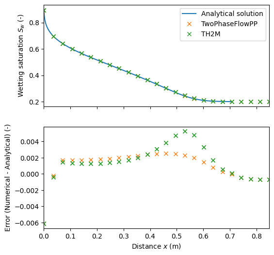

Numerical solutions
For the numerical solution, we compare the Thermal-2-Phase-Hydro-Mechanical (TH2M) and the Two-phase Flow formulation.
- The first step is to create a matching mesh that capture the penetration depth of the wetting fluid.
- Because the OGS models use the capillary pressure as a primary variable, the boundary and initial conditions need to be converted from saturations to pressures.
Tip: Pick the parameters you would like to study with the sliders above and run the code blocks below to compare the results of the analytical and numerical model.
# parameters defined by the current slider settings…
(click to toggle)
# calculate analytical solution with the
params["Pe"],
params["lambda_"],
params["Snr"],
params["Swr"],
model,
params["phi"],
params["K"],
params["muw"],
params["mun"],
params["S0"],
params["Si"],
x_ref, Sw_ref = problem.get_solution()
# 1. Create meshes according to the penetration depth of the wetting fluid
depth = max(x_ref) # penetration depth of the wetting fluid
factor = 5.0 # mesh should be factor times larger than the depth
Nel = 100 # number of mesh elements
print(f"penetration depth of the wetting fluid: {depth}")
# 1.1 Mesh for TwoPhaseFlowPP
mesh = create_1d_mesh(
point_a=(0.0, 0.0, 0.0),
point_b=(depth * factor, 0.0, 0.0),
num_points=Nel + 1,
mesh_type="line",
mesh.save(str(out_dir / "mesh_line.vtu"))
coords = {"x1": mesh.GetBounds()[1], "x2": 0.5 * mesh.GetBounds()[1]}
file_from_template(coords, "mcwt.template", out_dir / "mcwt.gml")
# 1.2 Mesh for TH2M
num_points=Nel + 1,
mesh_type="quad",
mesh.save(str(out_dir / "mesh_quad.vtu"))
boundary_left, boundary_right = create_boundary_line_meshes(
point_a=(0.0, 0.0, 0.0), point_b=(depth * factor, 0.0, 0.0), num_points=Nel + 1
boundary_left.save(out_dir / "boundary_left_test.vtu")
#!checkMesh -v mesh_quad.vtu
subprocess.run(
"identifySubdomains -m mesh_quad.vtu -- boundary_left_test.vtu",
shell=True,
check=True,
cwd=out_dir,
#!checkMesh -v boundary_left_test.vtu
# 2. Calculate capillary pressures
params["pci"] = model.pc(params["Si"])
params["pc0"] = model.pc(params["S0"])
print(f"Si = {params['Si']} -> pci = {params['pci']}")
print(f"S0 = {params['S0']} -> pc0 = {params['pc0']}")penetration depth of the wetting fluid: 0.7072512405219576

Evaluation and Results
# 1. Plot analytical solution…
(click to toggle)
plotter = plot_with_error(
x_ref,
Sw_ref,
"C0-",
"Analytical solution",
"Distance $x$ (m)",
"Wetting saturation $S_w$ (-)",
"Error (Numerical - Analytical) (-)",
# 2. Read results from TwoPhaseFlowPP
labels = ["TwoPhaseFlowPP", "TH2M"]
results = [
"twophaseflow_test_t_1000.000000.vtu",
"result_McWhorter_H2_ts_110_t_1000.000000.vtu",
i = 1
for label, result in zip(labels, results, strict=True):
mesh = pv.read(out_dir / result)
print(mesh.point_data.keys())
Sw = mesh["saturation"]
x = mesh.points[:, 0]
ind = np.argsort(x)
x = x[ind]
Sw = Sw[ind]
plotter.append(x, Sw, f"C{i}x", label)
i = i + 1
# show plot
plotter.plot([0, depth * 1.2])['capillary_pressure', 'gas_pressure', 'saturation']
['capillary_pressure', 'capillary_pressure_interpolated', 'displacement', 'epsilon', 'gas_density', 'gas_pressure', 'gas_pressure_interpolated', 'k_rel_G', 'k_rel_L', 'liquid_density', 'liquid_pressure_interpolated', 'porosity', 'saturation', 'sigma', 'temperature', 'temperature_interpolated', 'velocity_gas', 'velocity_liquid', 'xmCG', 'xmWL', 'xnCG']
