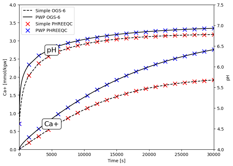

### visulalization
# results at point [0, 0, 0] are selected for display
point = {"pt0": (0.0, 0.0, 0.0)}
# plot
fig1 = plt.figure(figsize=(8, 6))
ax = plt.subplot(111)
## results of 'Ca'
# OGS-6
ax.plot(
    pvdfile_simple.timesteps,
    pvdfile_simple.read_time_series("Ca", point)["pt0"] * 1e3,
    c="k",
    linestyle="--",
    label="Simple " + "OGS-6",
ax.plot(
    pvdfile_pwp.timesteps,
    pvdfile_pwp.read_time_series("Ca", point)["pt0"] * 1e3,
    c="k",
    label="PWP " + "OGS-6",
# PHREEQC
ax.scatter(
    phreeqc_result_df_simple.loc[:, "x"] * 1e3,
    phreeqc_result_df_simple.loc[:, "Ca"],
    c="r",
    s=80,
    marker="x",
    label="Simple " + "PHREEQC",
ax.scatter(
    phreeqc_result_df_pwp.loc[:, "x"] * 1e3,
    phreeqc_result_df_pwp.loc[:, "Ca"],
    c="b",
    s=80,
    marker="x",
    label="PWP " + "PHREEQC",
ax.set_xlim([0, 3e4])
ax.set_ylim([0, 4])
ax.set_ylabel("Ca+ [mmol/kgw]")
ax.set_xlabel("Time [s]")
ann = ax.annotate(
    "Ca+",
    xy=(5000, 0.7),
    xycoords="data",
    va="center",
    ha="center",
    bbox={"boxstyle": "round", "fc": "w"},
    fontsize=16,
ax.legend(loc="upper left", fontsize=10)
## results of 'pH'
ax2 = ax.twinx()
# OGS-6
ax2.plot(
    -np.log10(pvdfile_simple.read_time_series("H", point)["pt0"]),
    c="k",
    linestyle="--",
ax2.plot(
    -np.log10(pvdfile_pwp.read_time_series("H", point)["pt0"]),
    c="k",
# PHREEQC
ax2.scatter(
    phreeqc_result_df_simple.loc[:, "pH"],
    c="r",
    s=80,
    marker="x",
    label="simple " + "PHREEQC",
ax2.scatter(
    phreeqc_result_df_pwp.loc[:, "pH"],
    c="b",
    s=80,
    marker="x",
ax2.set_xlim([0, 3e4])
ax2.set_ylim([4, 7.5])
ax2.set_ylabel("pH")
ax2.set_xlabel("Time [s]")
ann1 = ax2.annotate(
    "pH",
    xy=(5000, 6.4),
    xycoords="data",
    va="center",
    ha="center",
    fontsize=16,
Fig. 1: pH and calcium increase with kinetic dissolution of Calcite.

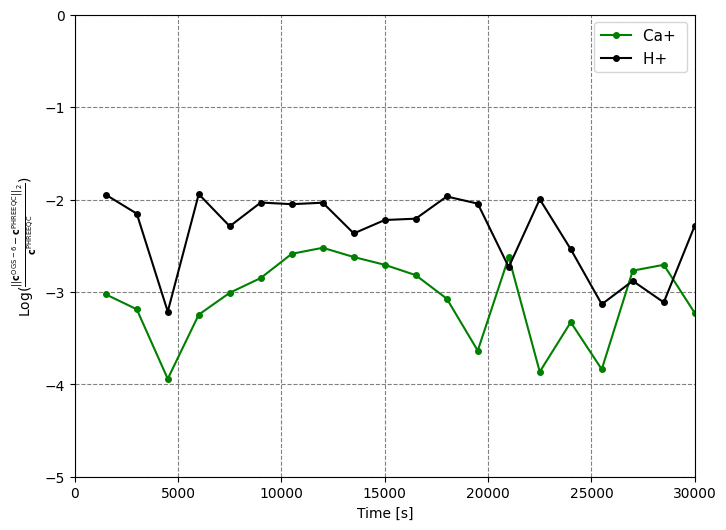

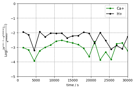

## L2 difference(click to toggle)
## L2 difference
# OGS-6 results for comparision
OGS6_pwp_ca = (
    np.delete((pvdfile_pwp.read_time_series("Ca", point)["pt0"]), np.arange(0, 24, 1))
    * 1e3
OGS6_pwp_H = np.delete(
    pvdfile_pwp.read_time_series("H", point)["pt0"], np.arange(0, 24, 1)
# plot
ax.plot(
    np.log10(
        ((OGS6_pwp_ca - phreeqc_result_df_pwp.loc[1:, "Ca"]) ** 2) ** 0.5
        / phreeqc_result_df_pwp.loc[:, "Ca"]
    c="g",
    marker="o",
    markersize=4,
    label="Ca+ ",
ax.plot(
    np.log10(
        ((OGS6_pwp_H - 10 ** (-phreeqc_result_df_pwp.loc[1:, "pH"])) ** 2) ** 0.5
        / 10 ** (-phreeqc_result_df_pwp.loc[:, "pH"])
    c="k",
    marker="o",
    markersize=4,
    label="H+ ",
ax.set_xlim([1500, 3e4])
ax.set_xticks(np.arange(0, 30001, 5000))
ax.set_ylim([-5, 0])
ax.set_ylabel(
    r"Log($\frac{|| \mathbf{c}^\mathrm{OGS-6} - \mathbf{c}^{\mathrm{PHREEQC}}||_{2}}{\mathbf{c}^{\mathrm{PHREEQC}}}$)"
ax.grid(color="gray", linestyle="dashed")
ax.legend(loc="best", fontsize=11)
<matplotlib.legend.Legend at 0x7f7909c647d0>
Fig. 2: L2 relative difference norm between the obtained results from OGS-6 and PHREEQC for the scenario with the PWP rate.

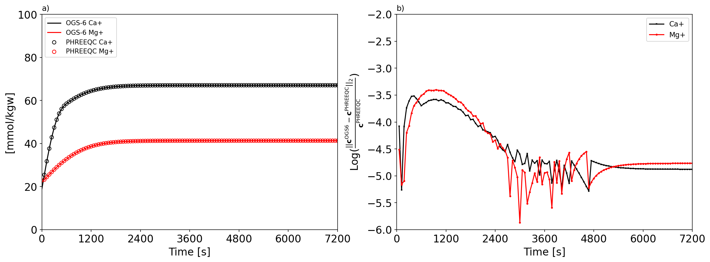

For verification purposes, a corresponding PHREEQC model was constructed with identical parameter settings.
On the Fig. 3 a) the evolution of calcium and magnesium molality during the $\ce{CO2}$ injection computed from the OGS-6 and PHREEQC model is shown. And the Fig. 3 b) displays the L2 relative difference norm between the results computed by the two software. The results of the two software programs match perfectly. On the Fig. 4 the evolution of the dissoluted molality of each minerals during the simulation is illustrated. Only calcite and dolomite have been partially dissolved due to $\ce{CO2}$ injection. In contrast, clay minerals, the illite and kaolinite were hardly affected. The kinetic dissolution rate of calcite and dolomite is mostly controlled by their saturation ratio states. When the SR value of calcite and dolomite reaches 1, the dissolution process of the correspondences is stopped.
Note: The scenario #2 is not directly calculated in the notebook due to the lack of the large input file llnl.dat database in the commit. Also the post-processing of the scenario #2 is similar to which is showed in the scenario #1.
Figure 3 Fig. 3: a) evolution of the calcium and magnesium molality during the $\ce{CO2}$ injection; b) L2 relative difference norm between the results computed by OGS-6 and PHREEQC.

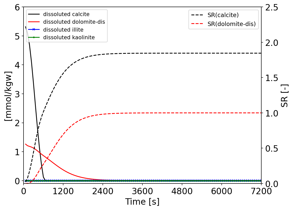

Figure 4 Fig. 4: Evolution of the dissoluted minerals molality and the related saturation ratio of calcite and dolomite over the time.
