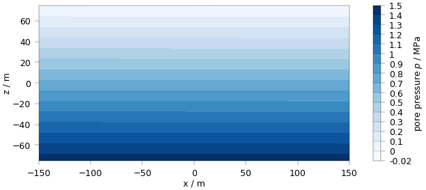

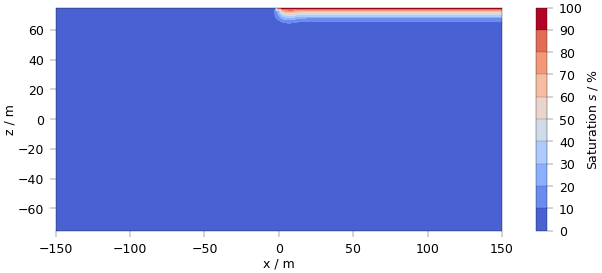

The concentration and pressure at the beginning of the simulation are shown in the figures below.
fig_t0_si = ot.plot.contourf(mesh_t0, ot.variables.saturation, vmin=0)
fig_t0_p = ot.plot.contourf(mesh_t0, ot.variables.pressure)

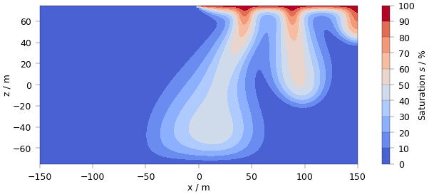

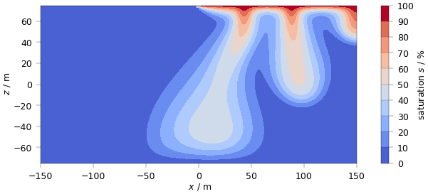

The concentration and pressure at the end of the simulation are shown in the figures below.
fig_tend_si = ot.plot.contourf(mesh_tend, ot.variables.saturation, vmin=0)
fig_tend_p = ot.plot.contourf(mesh_tend, ot.variables.pressure)

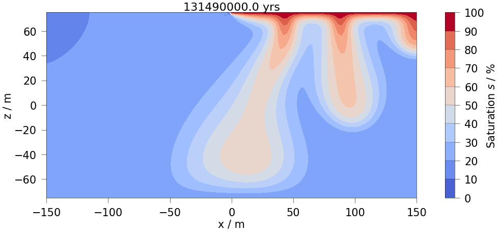

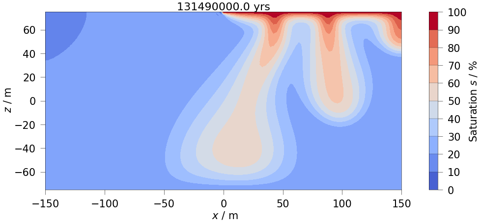

Animate results
Down below the results are shown in an animated plot
ms_2D = mesh_series.transform(lambda mesh: mesh.slice("y", [0, 0, 0]))(click to toggle)
fig = ot.plot.contourf(ms_2D[0], ot.variables.saturation, vmin=0, vmax=100, dpi=50)
fig.axes[0].set_title(f"{0} yrs", fontsize=32)
def plot_contourf(timevalue: float, mesh: pv.UnstructuredGrid) -> None:
    fig.axes[0].clear()
    ot.plot.contourf(mesh, ot.variables.saturation, ax=fig.axes[0], dpi=50)
    fig.axes[0].set_title(f"{timevalue:.1f} yrs", fontsize=32)
anim = ot.plot.animate(fig, plot_contourf, ms_2D.timevalues, ms_2D)
HTML(anim.to_jshtml())
