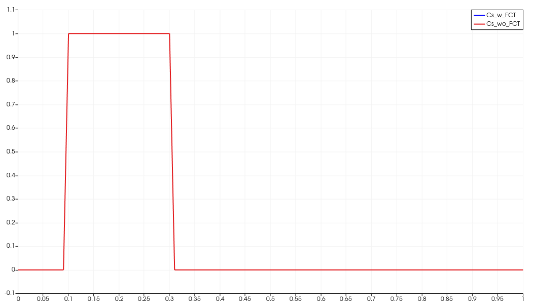

Initial concentration distribution
The benchmark domain is a 1-m long 1D column, discretized into 100 elements and 101 nodes. The porosity of the column is set to 1.0. The flow field is from left to right. On the right end of the column, the pressure is set to 1e5 Pa. On the left end, a fixed flux of 1e3 m3/sec is imposed, resulting in a Darcy velocity of 1 m/sec towards the right. From 0.1 m to 0.3 m, the initial concentration of Cs is set to 1.0, producing a sharp gradient in the concentration profile (see above figure). The dispersion and diffusion are both set to zero in the model, with the purpose to generate oscillation. The benchmark runs from 0 to 0.5 seconds, with a fixed time step size of 0.001 seconds.

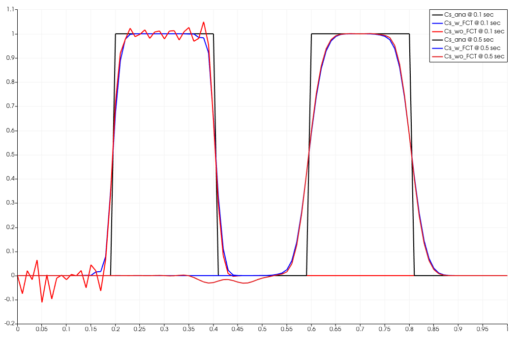

Model result
Comparison of analytical (black) and simulated concentration profile, with (blue) and without (red) FCT scheme, at 0.1 and 0.5 sec
The above figure compares the simulated concentration profiles with or without the FCT stabilization scheme at different times. It is clearly shown that strong oscillation is present when FCT feature is turned off (red curve). With the FCT stabilization (blue), the oscillation is suppressed, and all concentration values are non-negative. It is also found that numerical dispersion, no matter FCT is applied or not, is always present when compared to the analytical profiles (black).
