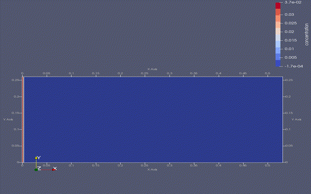

An example for the intruding salt front is shown below. The numerical results of OGS-6 coincide with those of OGS-5.
Results for numerical experiment. The steady state SS2 from the original experimental work is well reproduced.

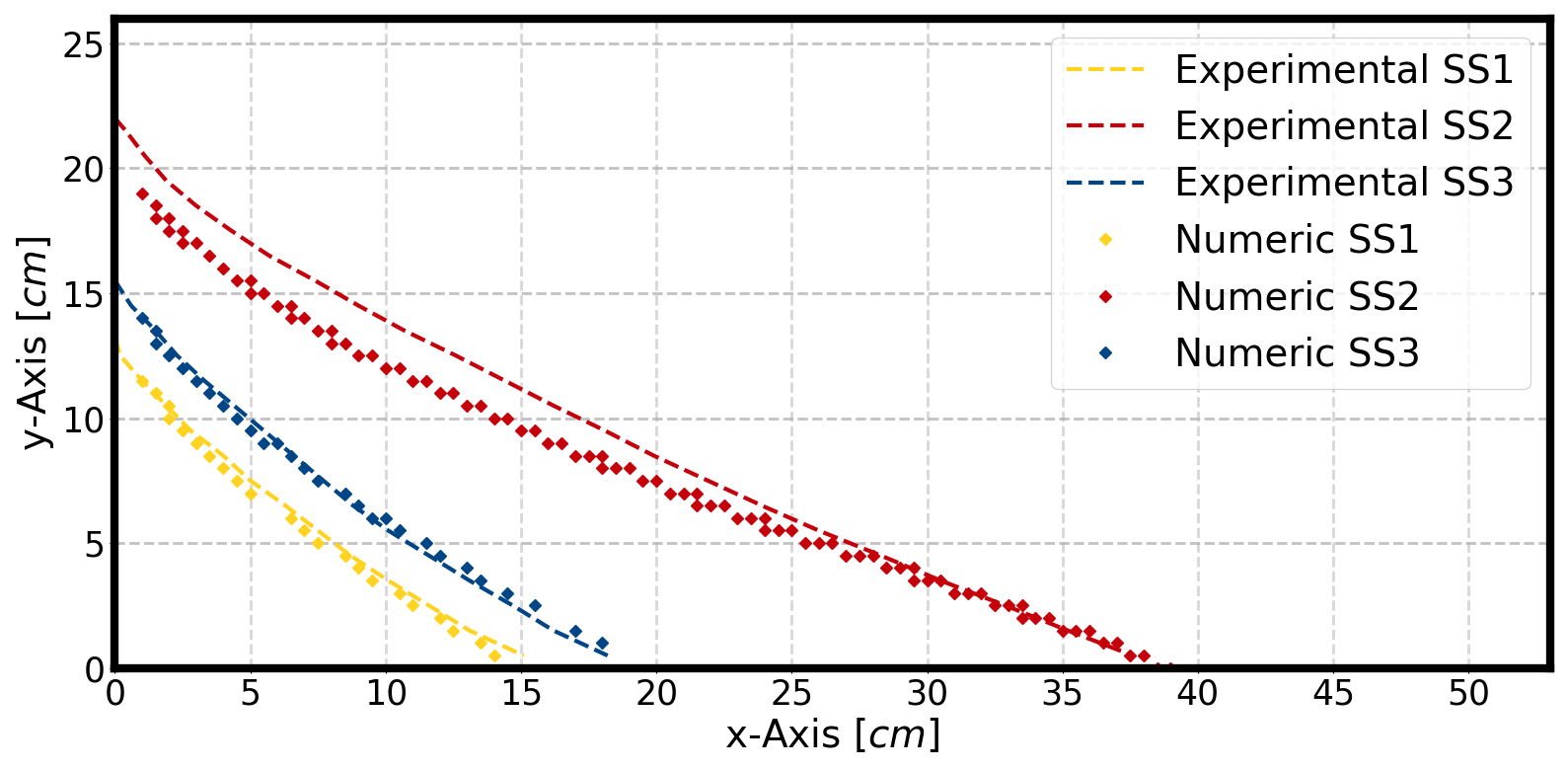

A comparison of numerical and laboratory data is shown in the figure below. The numerical results of OGS-6 coincide with those of OGS-5 and likewise with the laboratory observations.
Results for numerical (colored diamonds) and laboratory data (colored straight lines) on the steady state location of the concentration front (see original research paper).

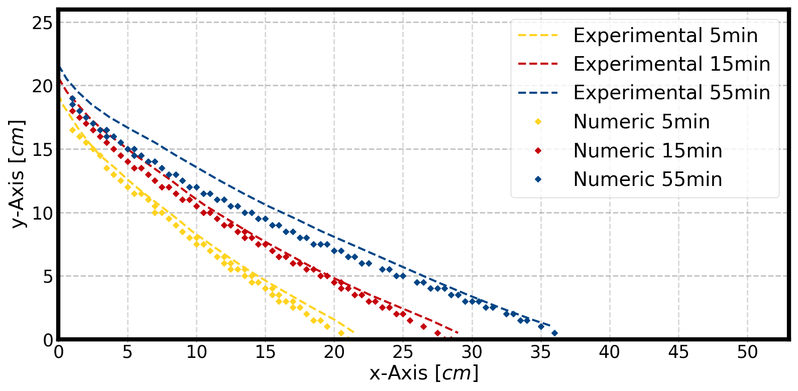

Results for numerical (colored diamonds) and laboratory data (colored straight lines) on the transient state locations of the concentration front (see original research paper).
