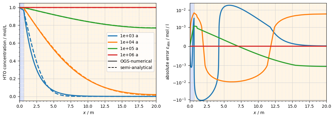

Then, the numerical solution by OpenGeoSys is plotted against the semi-analytical solution for comparison.
# Run OGS simulation(click to toggle)
name = "1D_MultiLayerDiffusion"
 ogs -o /var/lib/gitlab-runner/builds/K-X1vcp78/0/ogs/build/release-all/Tests/Data/Parabolic/ComponentTransport/MultiLayerDiffusion/MultiLayerDiffusion -m . /var/lib/gitlab-runner/builds/K-X1vcp78/0/ogs/build/release-all/Tests/Data/Parabolic/ComponentTransport/MultiLayerDiffusion/MultiLayerDiffusion/1D_MultiLayerDiffusion_modified.prj
['ogs', '-o', '/var/lib/gitlab-runner/builds/K-X1vcp78/0/ogs/build/release-all/Tests/Data/Parabolic/ComponentTransport/MultiLayerDiffusion/MultiLayerDiffusion', '-m', '.', '/var/lib/gitlab-runner/builds/K-X1vcp78/0/ogs/build/release-all/Tests/Data/Parabolic/ComponentTransport/MultiLayerDiffusion/MultiLayerDiffusion/1D_MultiLayerDiffusion_modified.prj']
ms_MLD = ot.MeshSeries(out_dir / f"{name}.pvd").scale(time="a")[1:](click to toggle)
HTO_var = ot.variables.Scalar("HTO", "mol/L", "mol/L", "HTO concentration")
fig = plot_results(ms_MLD, HTO_var)
In the first time step, the semi-analytical and numerical solutions do not agree so well. As the time step progresses, they begin to agree more closely.

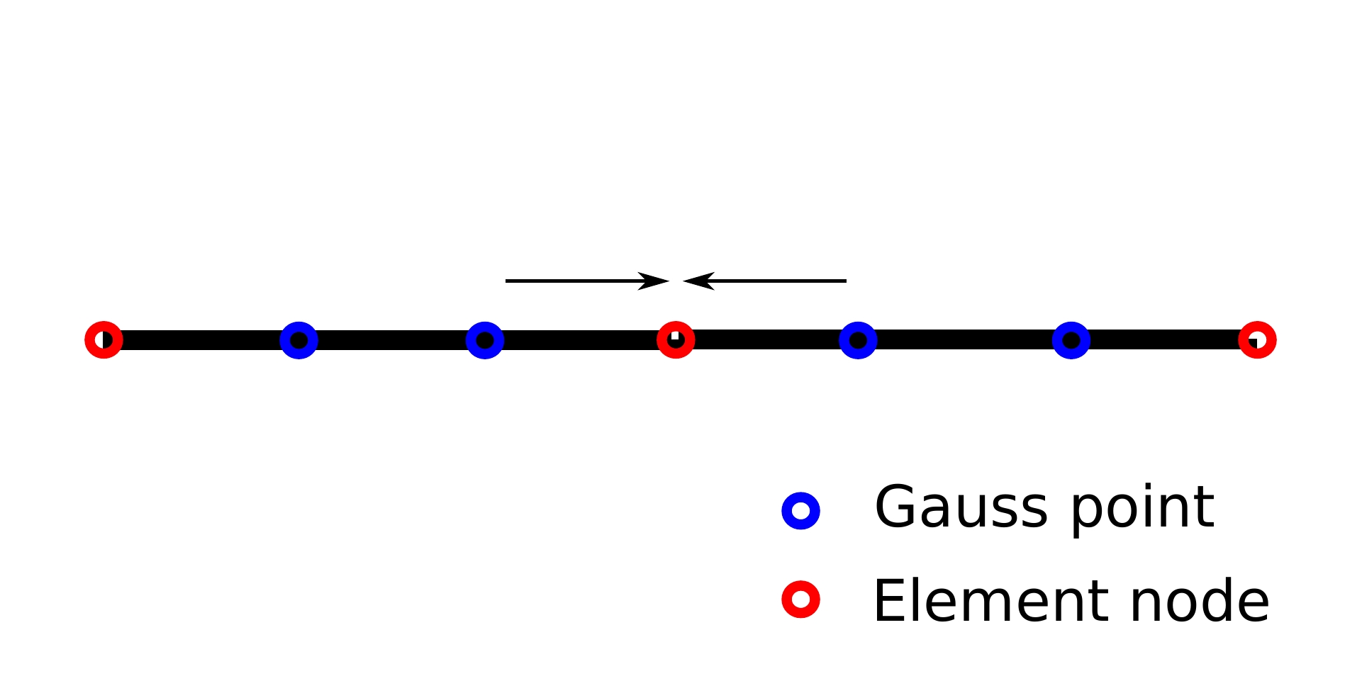

Mass flux calculation
Here is a sketch that shows how we calculate the molar flux at the node.
display(Image(filename="./sketch_molar_flux_calculation.jpg", width=100))
jpeg

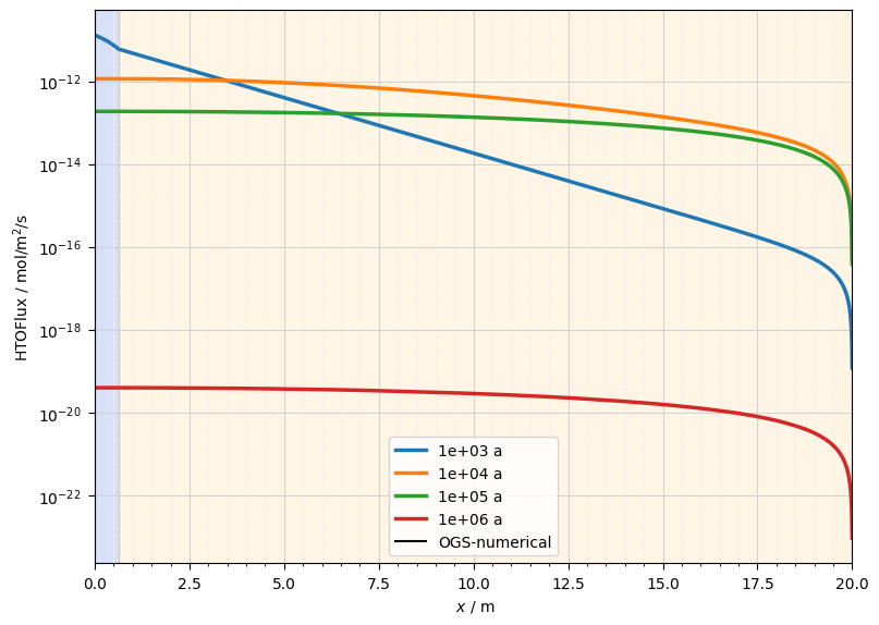

Additionally, we compute the molar flux profiles at $t$ = 10$^3$, 10$^4$, 10$^5$, and 10$^6$ years. The implementation of molar flux output can be viewed at this link.
HTO_flux_var = ot.variables.Scalar("HTOFlux", "mol/m$^2$/s")(click to toggle)
fig = plot_results(ms_MLD, HTO_flux_var)
fig.axes[0].set_yscale("log")
