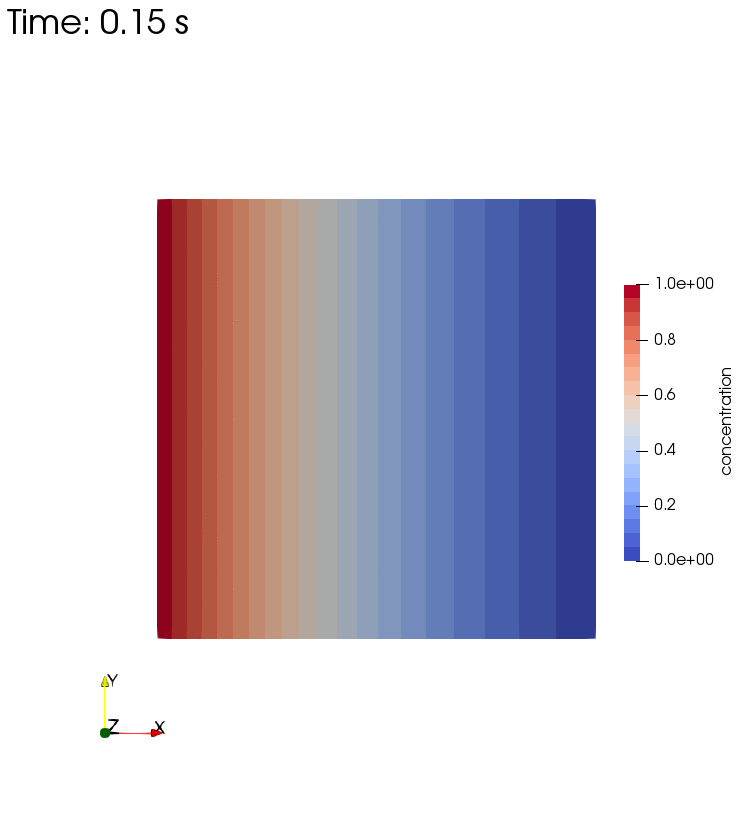

Diffusion only / Diffusion and Storage
Left side boundary conditions for these two setups are pressure $p=0$ and concentration $c=1$. The Diffusion only setup results in the final state of the Diffusion and Storage setup. For the former, retardation is set to $R=0$, while for the latter, $R=1$.

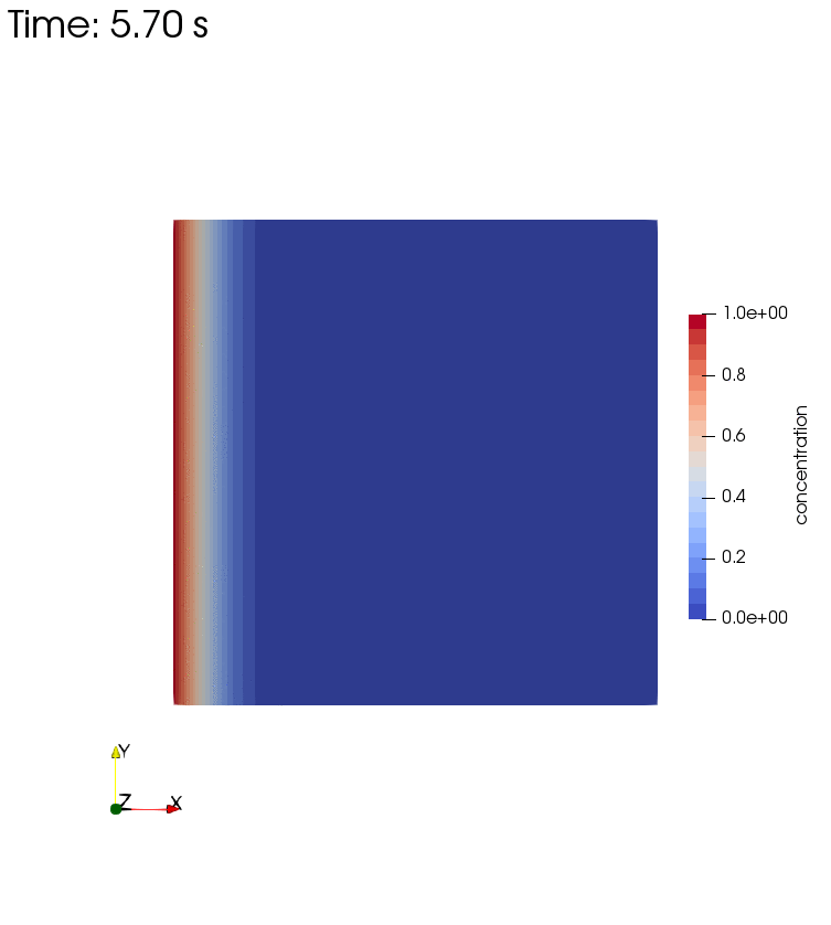

Diffusion, Storage, and Advection
Left side boundary conditions for this setup are pressure $p=1$ and concentration $c=1$.

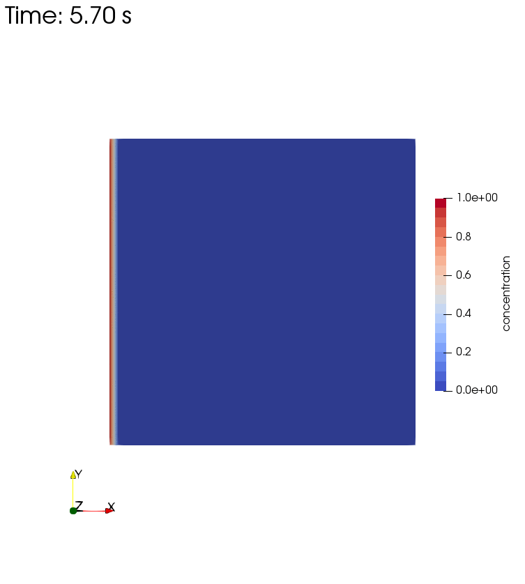

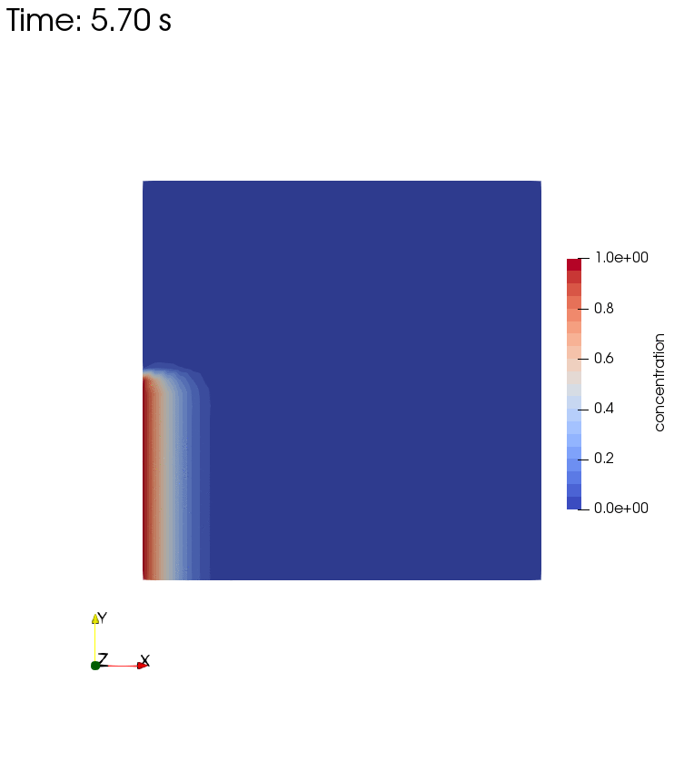

Diffusion, Storage, Advection, and Dispersion
Left side boundary conditions for these setups are pressure $p=1$ and concentration $c=1$. The latter is once given over the full left side, and in a second setup over half of the left side. Longitudinal and transverse dispersivity is $\alpha_l = 1 m$ and $\alpha_t = 0.1 m$.
- The Diffusion, Storage, Advection, and Dispersion project file
- The Diffusion, Storage, Advection, and Dispersion Half project file

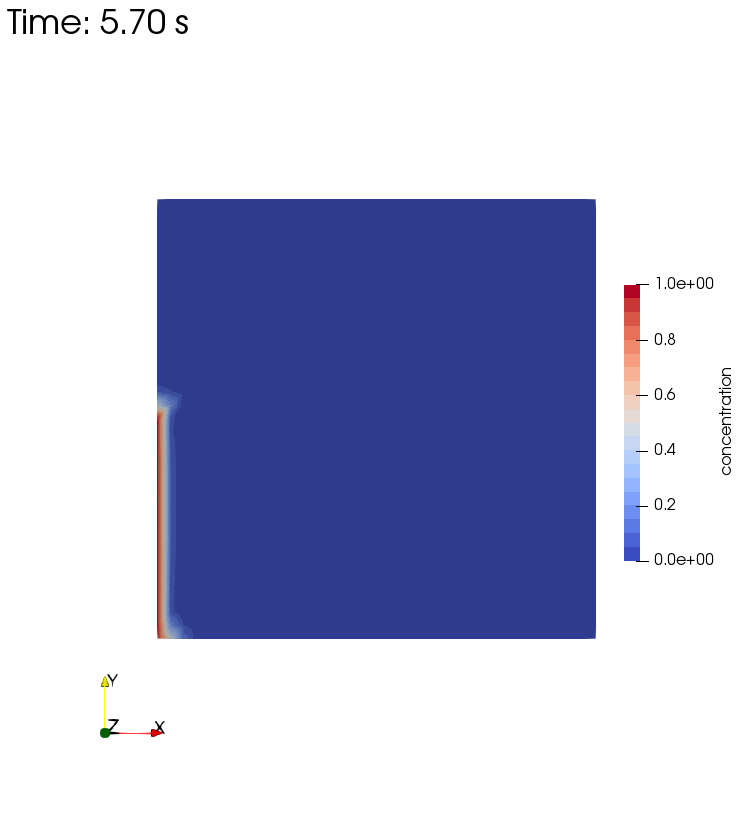

Diffusion, Storage, Advection, and Decay
Left side boundary conditions for this setup are pressure $p=1$ and concentration $c=1$. Decay rate is $\theta = 0.001 s^{-1}$.
