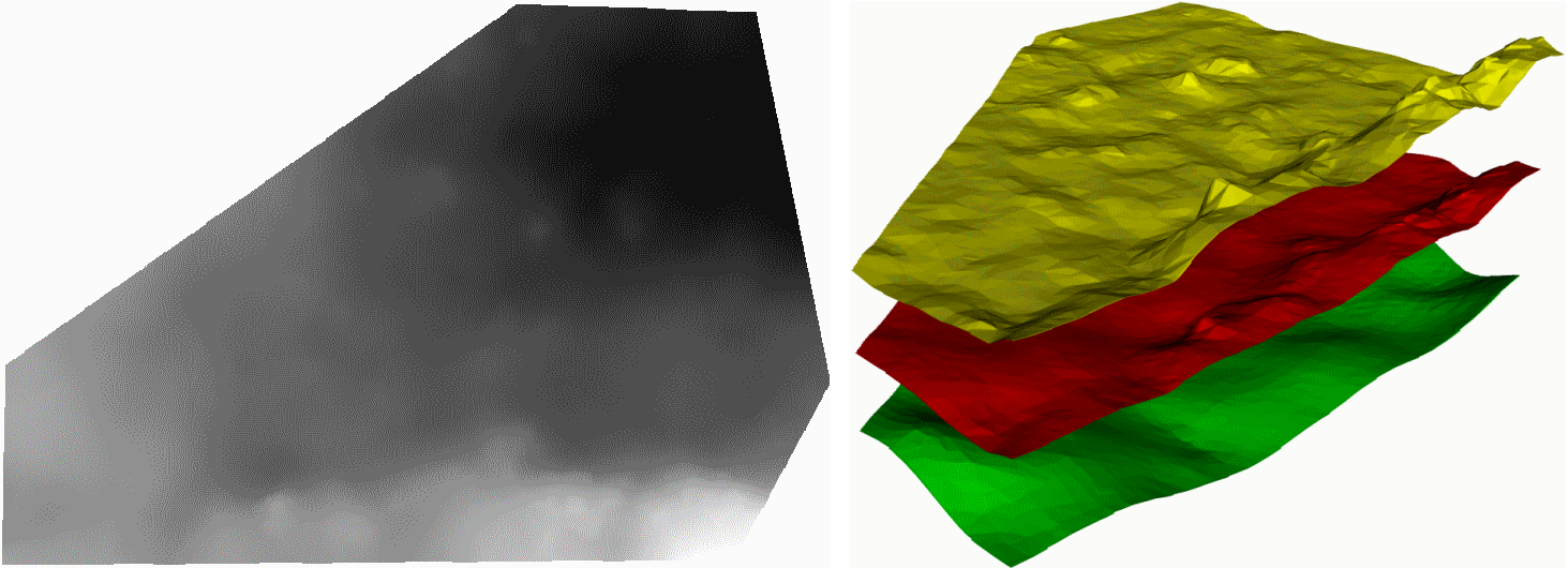

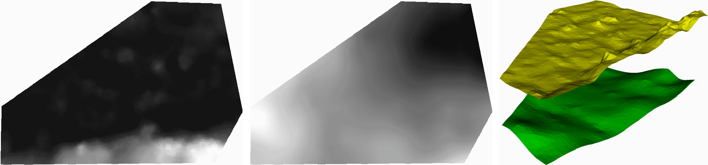

Input data:
Command:
createIntermediateRasters --file1 raster1.asc --file2 raster2.asc -o output.asc -n 1

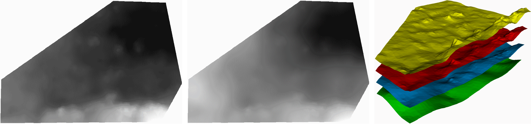

Command:
createIntermediateRasters --file1 raster1.asc --file2 raster2.asc -o output.asc -n 2
n>1
multiple rasters are created at equidistant distances between the two input rasters. For n=2
, two new rasters are generated, represented here in red and blue.
