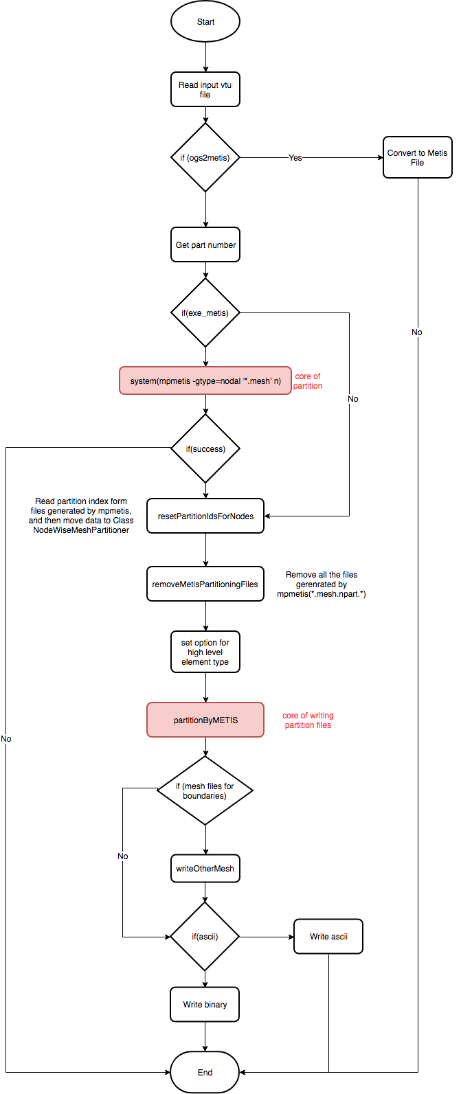

partmesh is an OpenGeoSys parallel simulation model preparation command line tool. It is used to generate partitioned mesh from VTU files. In the background mpmetis will be used to get a partitioned index for nodes, and then write the partitioned data and properties in binary files suitable for parallel simulations.
Workflow of the partmesh command line tool
