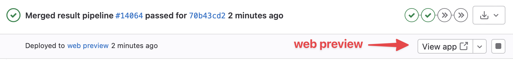

  • A preview is also generated during Continuous Integration: View app button on MR widget
