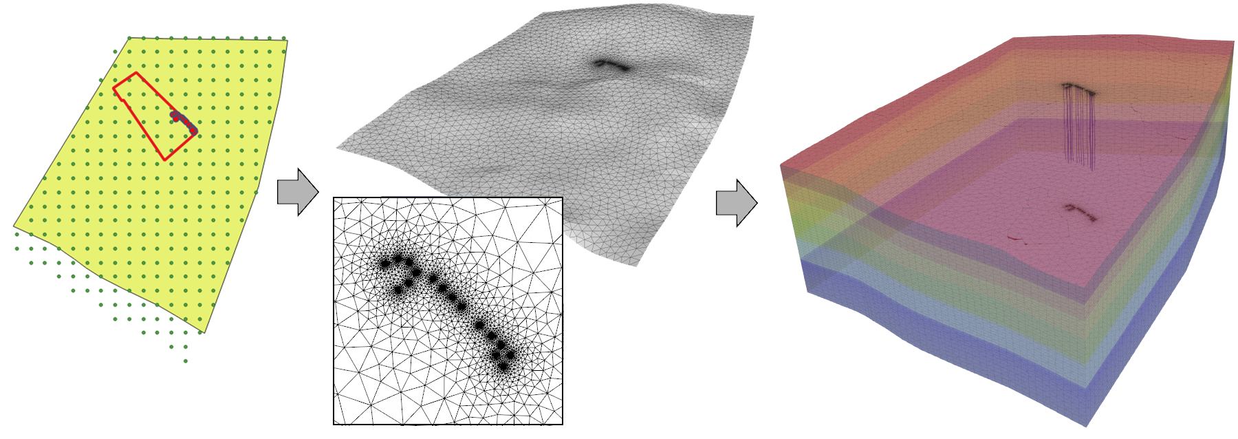

NOTE: If some boreholes are given at the beginning of the meshing process, it is recommended to use the OpenGeoSys DataExplorer – Manual / Download . At first, the nodes for boreholes can be integrated into the mesh, when the mesh is generated from a geometry. For this purpose, the boreholes and the boundaries of the geometry need to be imported in DataExplorer. Then this mesh can be used to create a 3D mesh, either with the DataExplorer or with createLayeredMeshfromRaster , which then can be used for integrating boreholes. This procedure is useful because the mesh is generated in a way that the coordinates of the boreholes are nodes in the mesh. Otherwise the borehole’s coordinates need to be adjusted according to a existing mesh. This process is schematically depicted in Fig.1, below.
Mesh generation process
Fig.1 A schematic to visualize the methods of the tool. It does not refer to the upper example.
