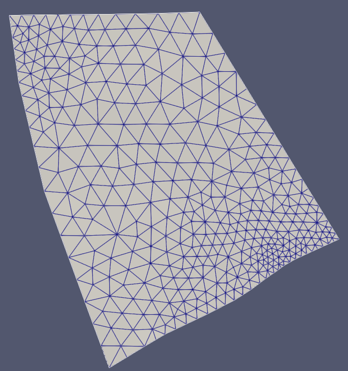

Mapping the input mesh to a digital elevation model (DEM).
B-z B-x
Fig. 1 Both images show the INPUT mesh from two different point of views. The upper image shows the view along the z-axis. The lower image shows the view along the x-axis.

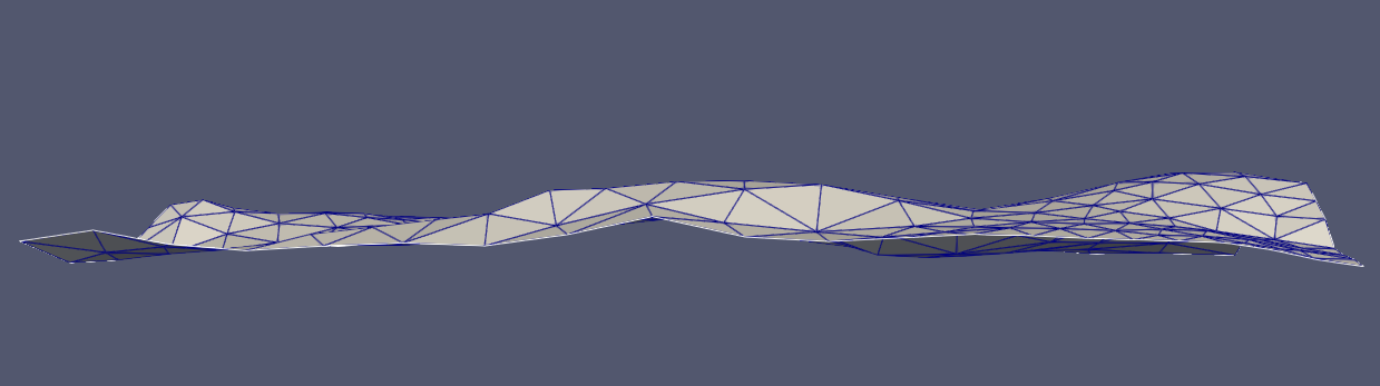

MeshMapping -i Berlin.vtu -o Berlin_mapped.vtu -r DEM.asc
The command above maps the mesh Berlin.vtu to the mesh Berlin_mapped.vtu according to the elevation given in DEM.asc. Differences can be seen comparing Fig.1 and Fig.2, especially comparing the lower images.
B-map-z B-map-x-scale10
Fig. 2 Both images show the OUTPUT mesh from two different point of views. The upper image shows it viewing along the z-axis. The right image shows it viewing along the x-axis. To increase the visibility of the elevation, z-values are scaled by factor of 10.
