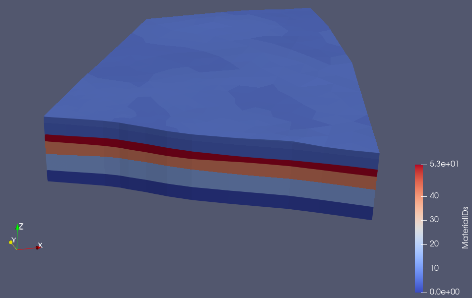

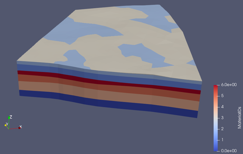

  1. In this example we compress/condense the list of material IDs. The input mesh has a list of material IDs of [0,4,5,6,14,42,53]. Then we call the –condense option (-c) to compress this list to [0,1,2,3,4,5,6].
editMaterialID -i mesh_newID.vtu -o mesh_newID_c.vtu -c
output:
[2023-02-23 16:20:21.688] [ogs] [info] Mesh read: 2915 nodes, 4609 elements.
[2023-02-23 16:20:21.688] [ogs] [info] Condensing material ID...
[2023-02-23 16:20:21.688] [ogs] [info] The MaterialIDs of the input file: [0, 4, 5, 6, 14, 42, 53]
[2023-02-23 16:20:21.688] [ogs] [info] The MaterialIDs of the output file: [0, 1, 2, 3, 4, 5, 6]
Material ID replacement visualization Material ID condensation visualization
Fig.1 The upper image shows a mesh with material IDs [0,4,5,6,14,42,53]. The lower one the same mesh with material IDs [0,1,2,3,4,5,6] after applying --condense.
