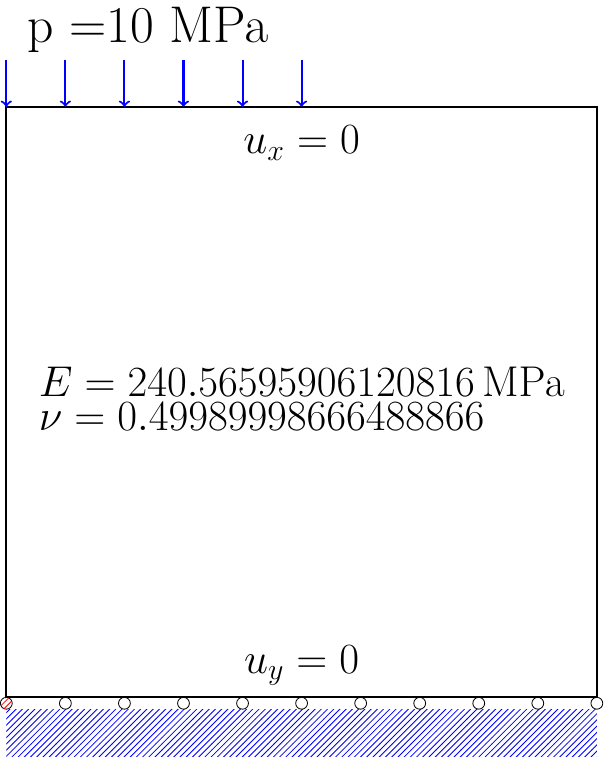

A block under compression
This is a plane strain problem. The domain size is 0.01 m $\times$ 0.01 m. The geometry and boundary conditions are shown in the following figure:
Simple test
The values of Young’s modulus ($E$) and Poisson’s ratio ($\nu$) are calculated from the specified bulk modulus of 400,889.806 MPa and the shear modulus of 80.194 MPa. The calculated Poisson’s ratio is close to 0.5, indicating that the material is nearly incompressible.

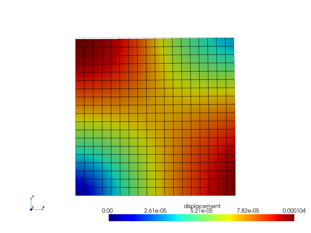

Simulation without the F-bar method
ogs_model = SingleOGSModel("RubberIndentation", use_fbar=False)
ogs_model.run_benchmark(u_max_ref=[0, -0.00010428732840299523])
 ogs -o /var/lib/gitlab-runner/builds/t1_R7hwLX/1/ogs/build/release-all/Tests/Data/LargeDeformation/FbarBenchmarksLocking -m RubberIndentation /var/lib/gitlab-runner/builds/t1_R7hwLX/1/ogs/build/release-all/Tests/Data/LargeDeformation/FbarBenchmarksLocking/modified.prj
['ogs', '-o', '/var/lib/gitlab-runner/builds/t1_R7hwLX/1/ogs/build/release-all/Tests/Data/LargeDeformation/FbarBenchmarksLocking', '-m', 'RubberIndentation', '/var/lib/gitlab-runner/builds/t1_R7hwLX/1/ogs/build/release-all/Tests/Data/LargeDeformation/FbarBenchmarksLocking/modified.prj']
Without F-bar, the obtained maximum displacement of RubberIndentation is [ 0.         -0.00010429] m.

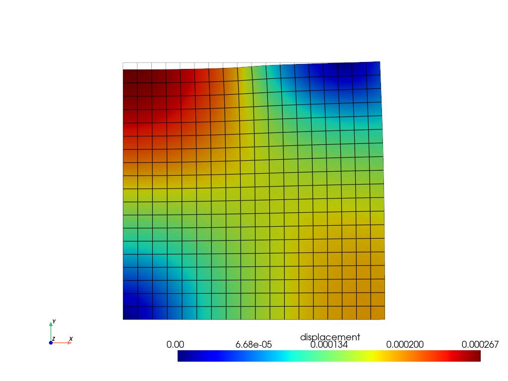

Simulation with the F-bar method
ogs_model = SingleOGSModel("RubberIndentation", use_fbar=True)
ogs_model.run_benchmark(u_max_ref=[0, -0.00026707547768988984])
With F-bar, the obtained maximum displacement of RubberIndentation is [ 0.         -0.00026708] m.

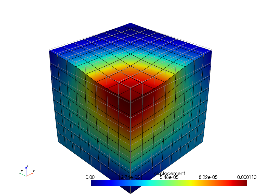

3D indentation example
Simple test This example analyzes the deformation of a block ($0.01\times 0.01 \times 0.01\,\text{m}^3$) under indentation. As shown in the figure, a uniformly distributed pressure of 40 MPa is applied to one-quarter of the top surface. On the symmetry surfaces, the displacement in the normal direction is fixed, while on the bottom surface, the vertical displacement is fixed. The material parameters are the same as those used in the previous example.

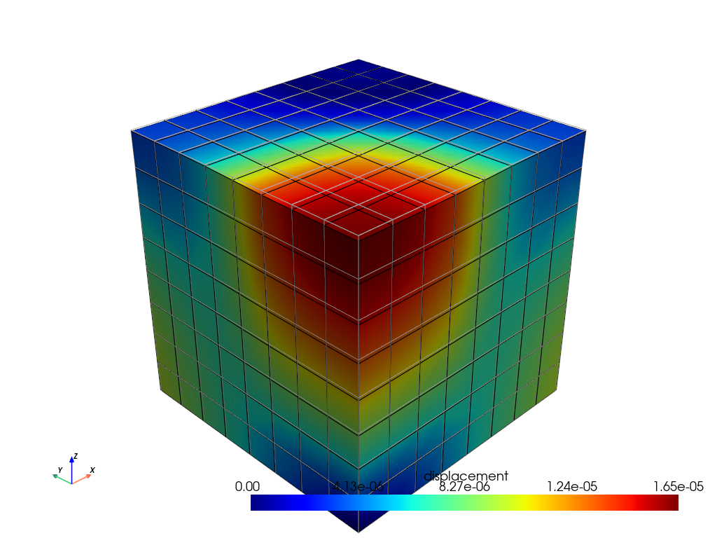

ogs_model = SingleOGSModel("Indentation3D", use_fbar=False)
ogs_model.run_benchmark(u_max_ref=[0, 0, -1.6534484343296282e-05])
 ogs -o /var/lib/gitlab-runner/builds/t1_R7hwLX/1/ogs/build/release-all/Tests/Data/LargeDeformation/FbarBenchmarksLocking -m Indentation3D /var/lib/gitlab-runner/builds/t1_R7hwLX/1/ogs/build/release-all/Tests/Data/LargeDeformation/FbarBenchmarksLocking/modified.prj
['ogs', '-o', '/var/lib/gitlab-runner/builds/t1_R7hwLX/1/ogs/build/release-all/Tests/Data/LargeDeformation/FbarBenchmarksLocking', '-m', 'Indentation3D', '/var/lib/gitlab-runner/builds/t1_R7hwLX/1/ogs/build/release-all/Tests/Data/LargeDeformation/FbarBenchmarksLocking/modified.prj']
Without F-bar, the obtained maximum displacement of Indentation3D is [ 0.00000000e+00  0.00000000e+00 -1.65344843e-05] m.
ogs_model = SingleOGSModel("Indentation3D", use_fbar=True)
ogs_model.run_benchmark(u_max_ref=[0, 0, -0.00010953948059235105])
With F-bar, the obtained maximum displacement of Indentation3D is [ 0.          0.         -0.00010954] m.

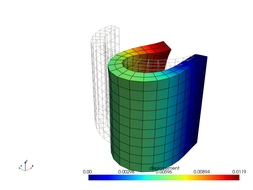

ogs_model = SingleOGSModel("ThickCylindricalShell", use_fbar=False)… (click to toggle)
ogs_model.reset_time_step_size(0.3, 4)
ogs_model.run_benchmark(u_max_ref=[0, -0.01192143, 0.00029815])
 ogs -o /var/lib/gitlab-runner/builds/t1_R7hwLX/1/ogs/build/release-all/Tests/Data/LargeDeformation/FbarBenchmarksLocking -m ThickCylindricalShell /var/lib/gitlab-runner/builds/t1_R7hwLX/1/ogs/build/release-all/Tests/Data/LargeDeformation/FbarBenchmarksLocking/modified.prj
['ogs', '-o', '/var/lib/gitlab-runner/builds/t1_R7hwLX/1/ogs/build/release-all/Tests/Data/LargeDeformation/FbarBenchmarksLocking', '-m', 'ThickCylindricalShell', '/var/lib/gitlab-runner/builds/t1_R7hwLX/1/ogs/build/release-all/Tests/Data/LargeDeformation/FbarBenchmarksLocking/modified.prj']
Without F-bar, the obtained maximum displacement of ThickCylindricalShell is [ 0.         -0.01192143  0.00029815] m.

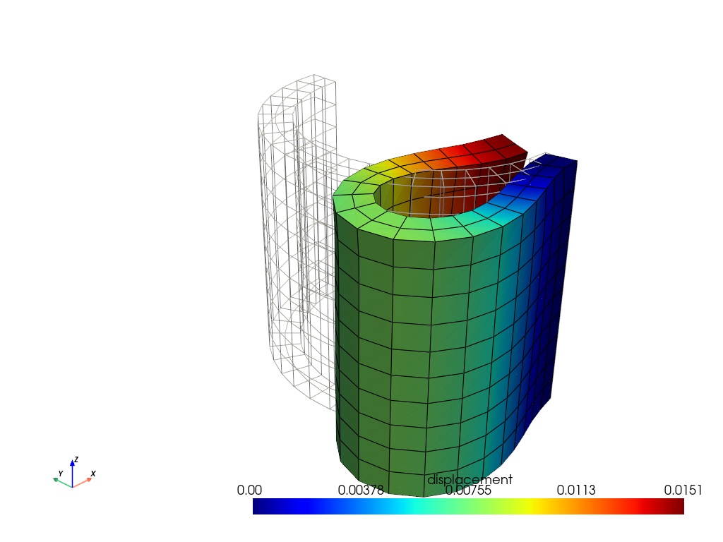

ogs_model = SingleOGSModel("ThickCylindricalShell", use_fbar=True)
ogs_model.run_benchmark(u_max_ref=[0, -0.01510393, 0.00022727])
With F-bar, the obtained maximum displacement of ThickCylindricalShell is [ 0.         -0.01510393  0.00022727] m.
