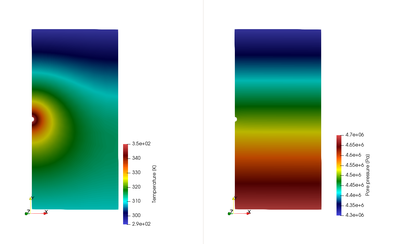

As the reference results, the temperature and pressure distributions in the domain at the time of 18 years are shown in the following figure, in which the thermal convection effective can be seen clearly.
