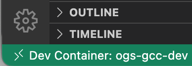

  • Press F1 and type reopen in [container], press ENTER.
This takes now some time as the container is downloaded from the registry. Once finished you should see the following in the bottom status bar:
VS Code status bar
VS Code status bar shows that we are connected the container ogs-gcc-dev.

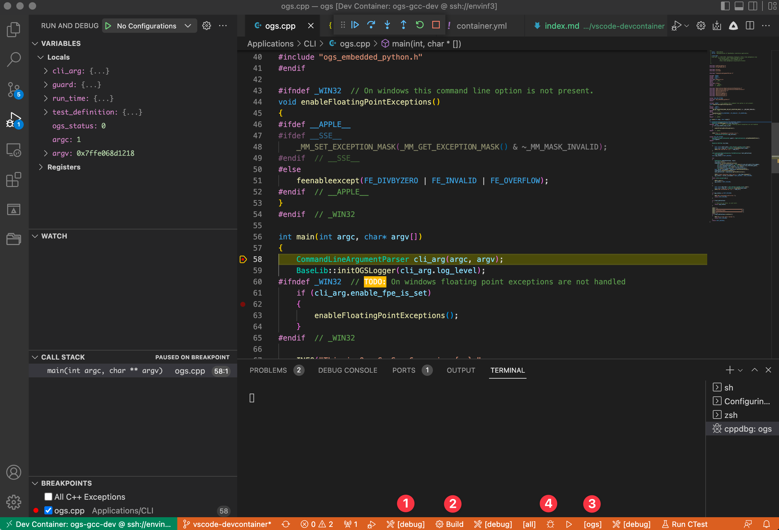

As an example use case we configure, build and debug the ogs executable.
CMake configuration is handled by using CMake presets which can be selected from the bottom status bar in VS Code. See the Configure and build with CMake Presets in Visual Studio Code for details.
In the editor:
  • Open ogs.cpp
  • Set a breakpoint in the first line of the main()-function (around line 58) by clicking on the left gutter in the editor window (a red dot marks the enabled breakpoint).
In the CMake sidebar:
  1. Under Configure Select the debug preset: Hover over the current preset, then click the pen icon. A drop-down list appears where you can select the preset. Alternatively you can open the command palette and invoke the CMake: Select Configure Preset command.
  2. Click the Build button (also available in the status bar at the bottom).
  3. Under Debug select the ogs target.
  4. Click the bug icon.
After some seconds the status bar color changes orange to indicate an active debugging session:
VS Code debugging session
Active debugging session: Execution stopped at line 58 in ogs.cpp. Step over lines with the Debug toolbar buttons on top. See local variables on the left.

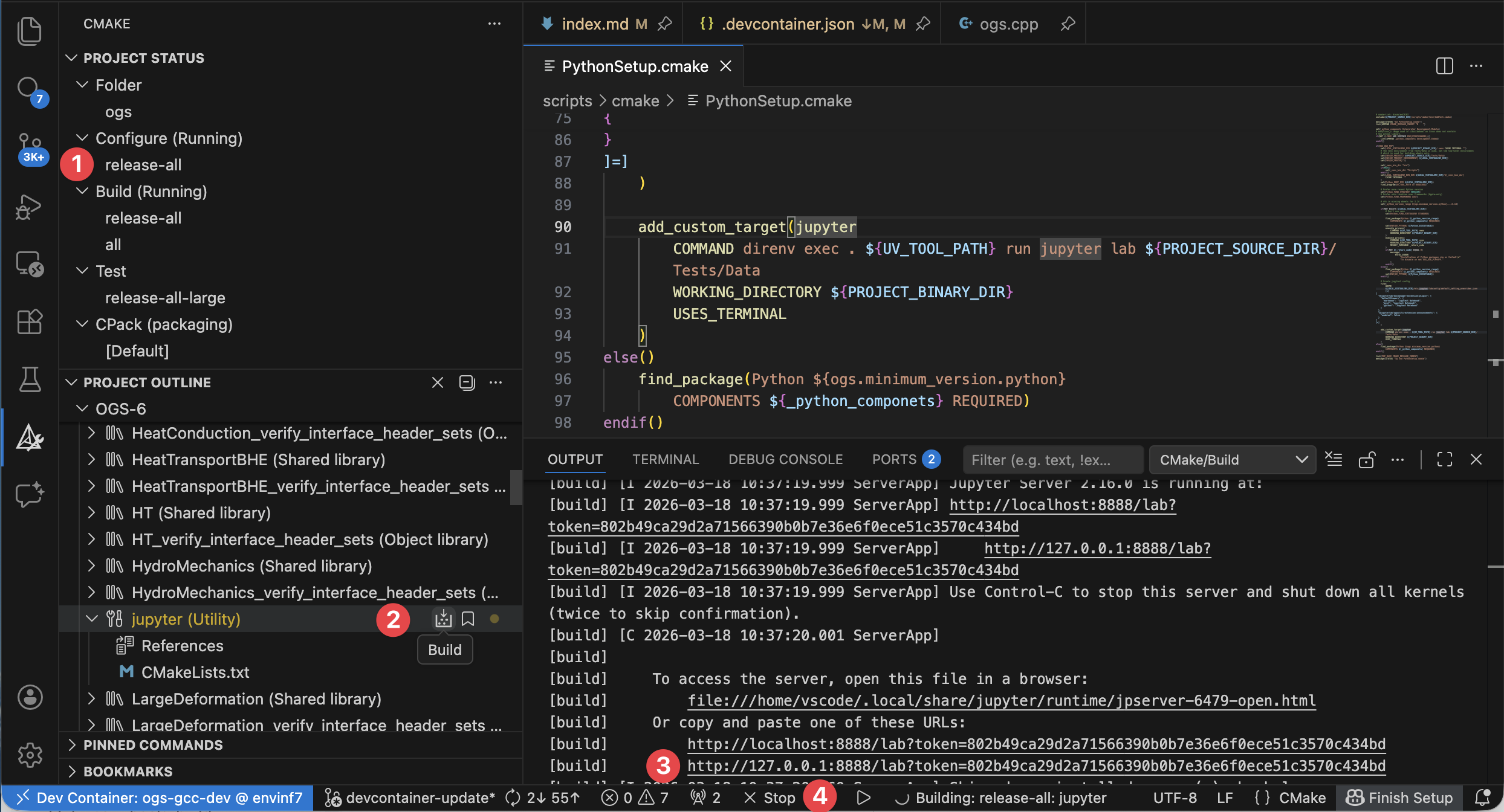

Run Jupyter Lab
In the build directory (make sure to have OGS_USE_PIP=ON or use the release-all CMake preset) build the jupyter-target or graphically:
  1. Make sure to have configured with OGS_USE_PIP=ON, e.g. by using release-all preset.
  2. Build the jupyter-target in the Project Outline.
  3. Control-click the printed URL in the Output window.
  4. When done, stop the Jupyter server by cancelling the build.
