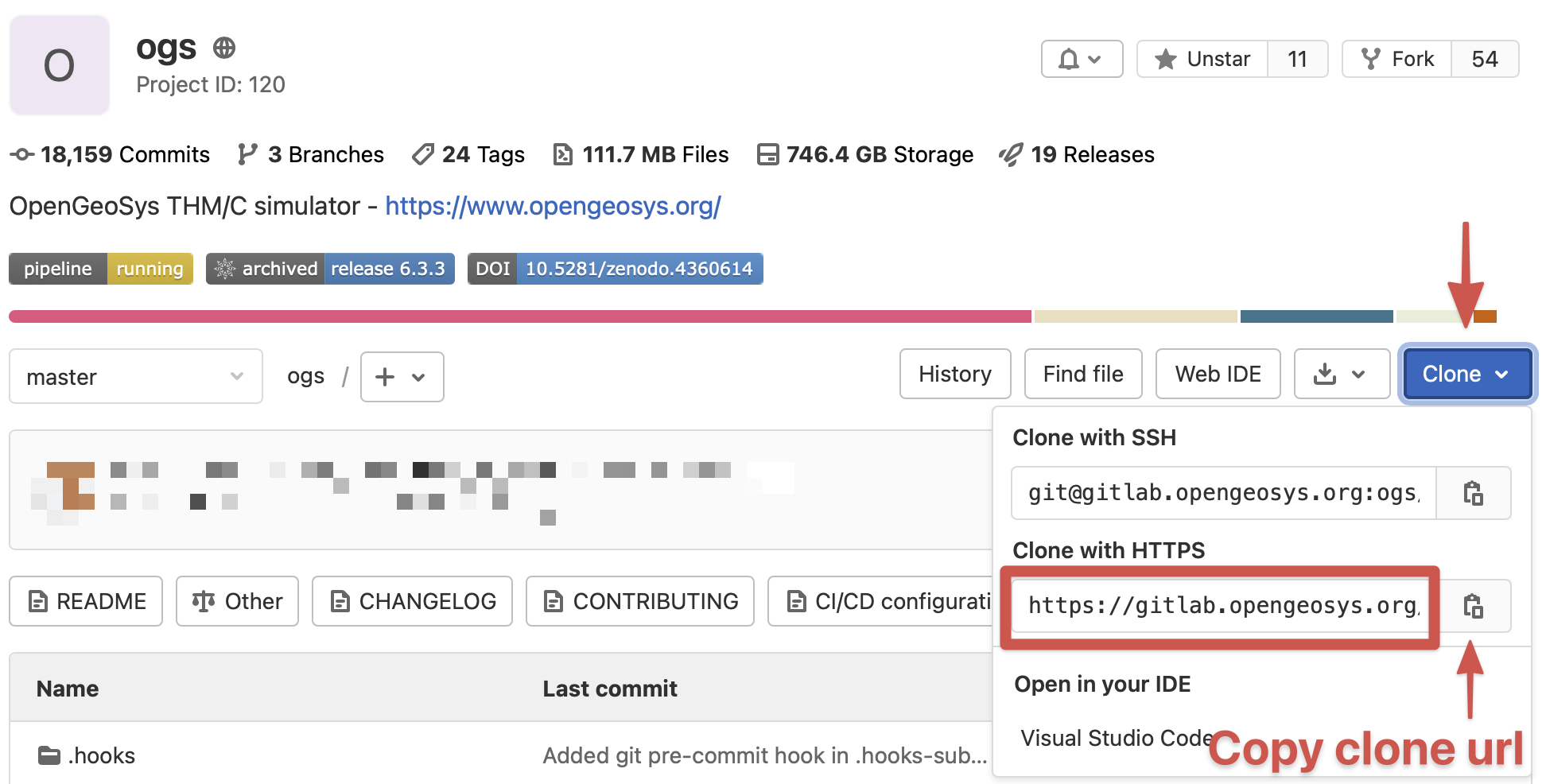

First you need to get the clone URL:
Getting the git clone URL from the GitLab web interface
