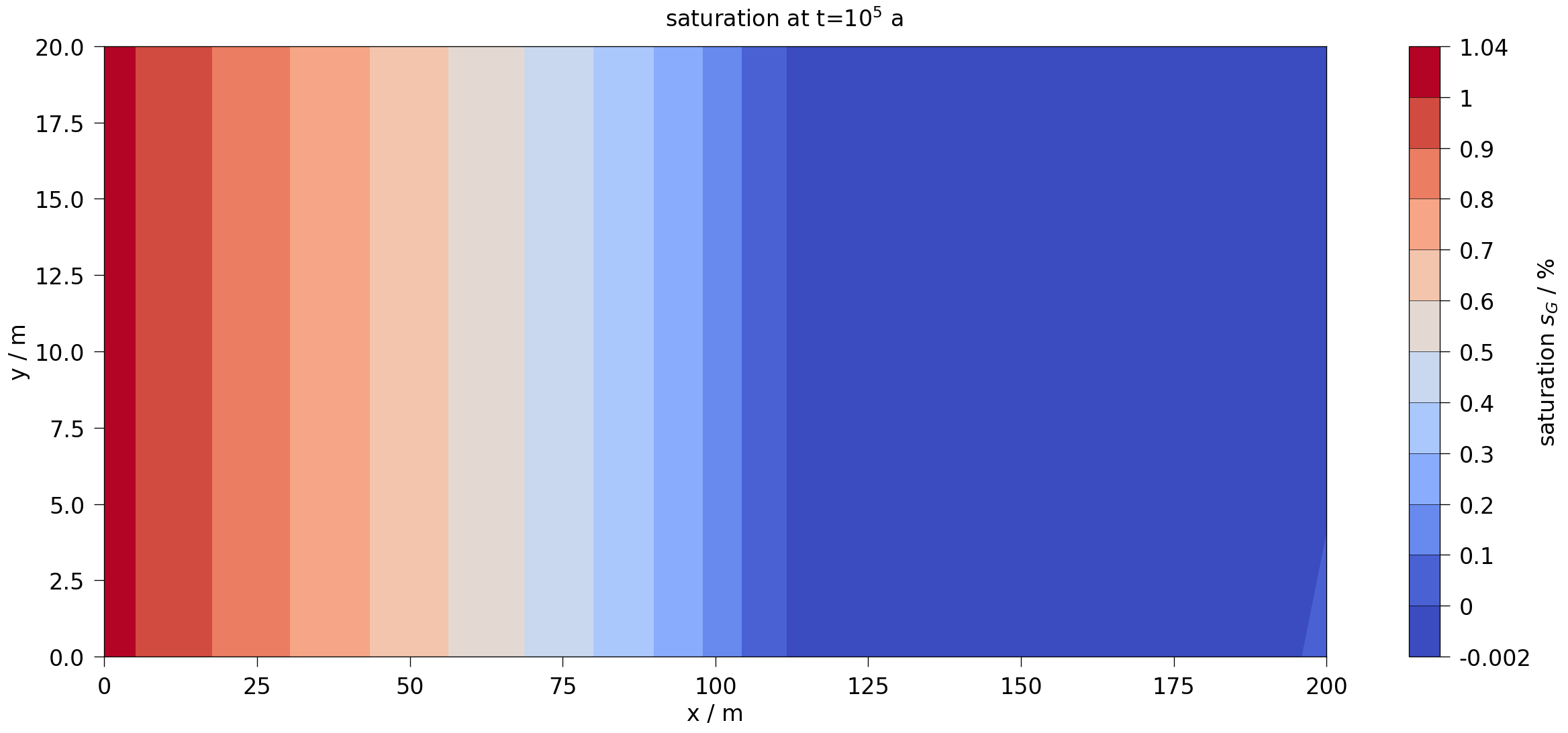

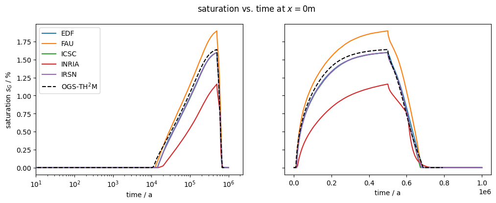

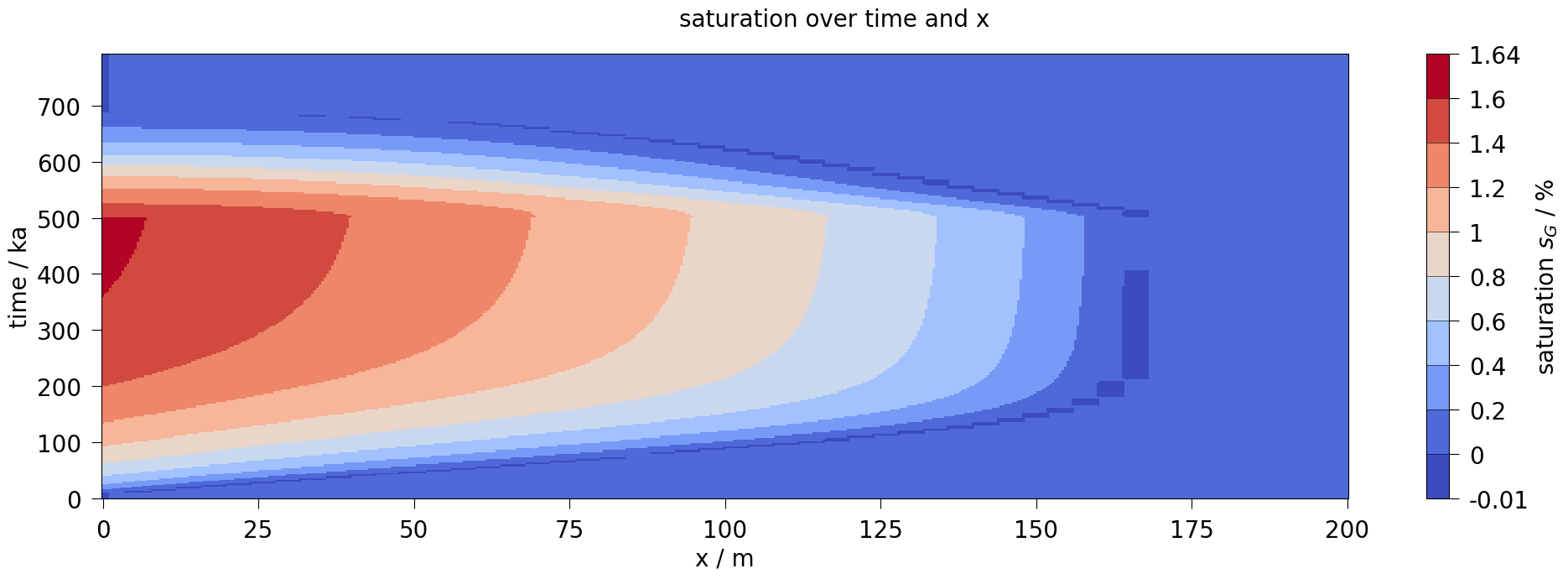

Saturation
plot_results(var=saturation, ref="sG", max_err=0.15)

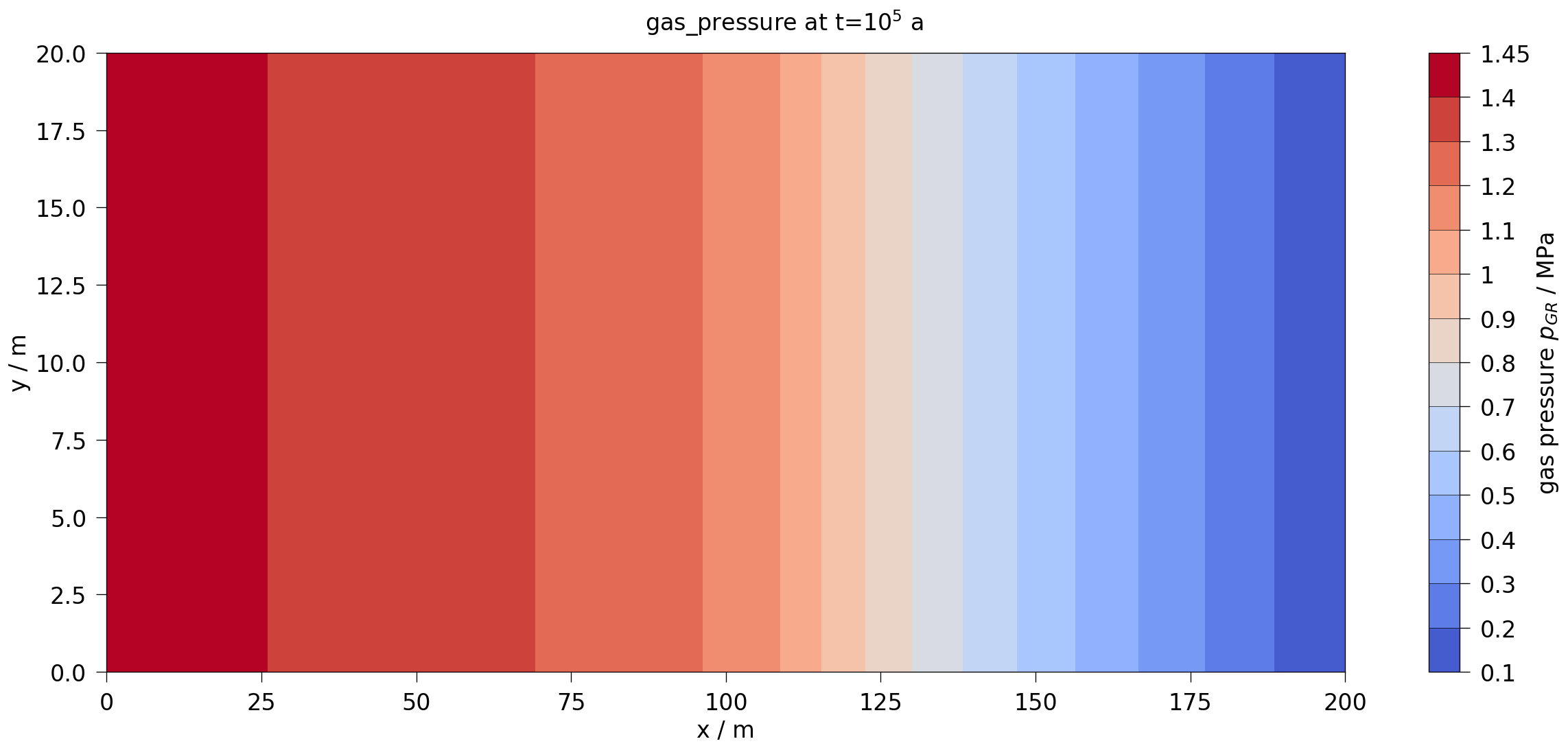

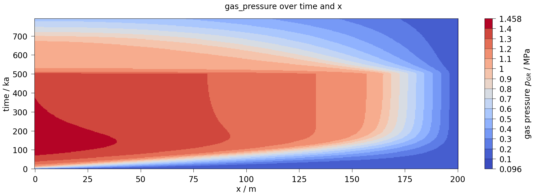

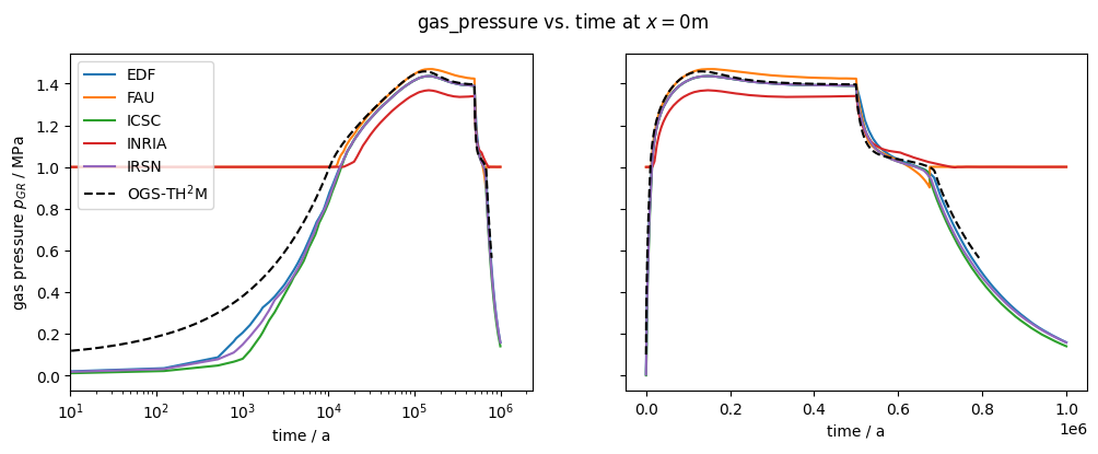

Gas pressure
plot_results(var=gas_pressure, ref="pGR", max_err=0.35)

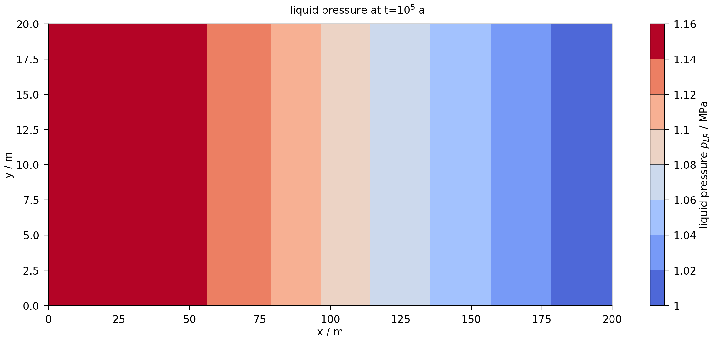

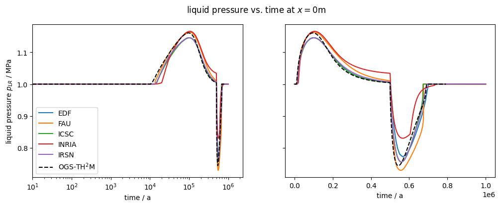

Liquid pressure
plot_results(var=liquid_pressure, ref="pLR", max_err=0.1)
After about 10,000 years, the dissolution capacity of the liquid phase is exhausted and a separate gas phase is formed. From this point on, an increase in water pressure can be observed. This is shown in the liquid pressure plot by comparison with the results shown in Bourgeat et al. (2013).
Regarding the accuracy (especially during times t<10,000 years), it should be noted that the reference graphs from the original paper were digitised manually; in the paper, the graphs were only linearly plotted (like those shown here in the right column), so no real statement can be made about the accuracy of the results for times t<10,000 years.
The comparison of the time evolution of the water pressure, gas pressure und gas saturation shows that the numerical solution calculated by OGS6-TH2M is very close to the results shown in Bourgeat et al. (2013). Both the time of formation of the gas phase (approximately at t=15,000 a and the shape and magnitude of the resulting pressure rise and pressure drop due to switching off the source term are within the differences of the reference solutions.
It can be concluded that both the transport and the phase transition behaviour of the TH2M process have been successfully derived and implemented. The self-controlled appearance and disappearance of a free gas phase should be emphasised.
